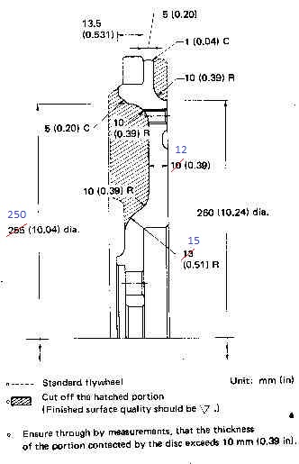

I lightened my flywheel. See attached jpeg. The blue text are the dimensions I used. Its good enough for street use.
The 225mm and 240mm flywheels are the same weight, but the disc and the pressure plate for the 240mm clutch is slightly heavier.

Like Cliff said, A lightened flywheel makes the engine more responsive. Probably the most bang for your buck on a standard engine.
