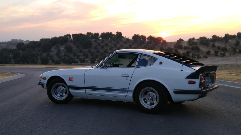

April 7, 20187 yr comment_546843 I too would go with having them turned but you may find the cost of turning them very close to buying new ones. If you have Advance auto out there check their price then go to retailmenot.com and get a 30% coupon code. Its been 8 years ago but just basic rotors were $20 each after the discount. And if I remember right that was what charged per rotor for a cut. I bought drilled and slotted from amazon but like Zed said it was for looks. You can see mine through the wheels I have. Painted remanufactured calipers red, it all looks good. The ceramic pads I used got rid of the horrible squeal all Zs I've owned have. I'll find my thread on that when u get my laptop out in the morning. Some good info on replacing the races, how to get the old ones out and seat the new ones DIY style. Torque value too. Link to comment https://www.classiczcars.com/forums/topic/59830-need-advice-on-brake-rotors-for-72-240z/#findComment-546843 Share on other sites More sharing options...
