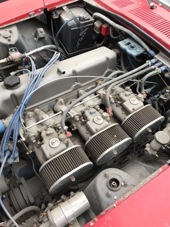

April 10, 20187 yr Author comment_547068 Might post this pic up on the more technical side of the forums... the shiny new stainless steel line is the “choke” that the previous owner did. But upon further inspection, it’s literally routed with the throttle cable, so you pull the choke and it will pedal the throttle and vice versus ? Link to comment https://www.classiczcars.com/forums/topic/59834-74-260z-looking-for-ny-tri-state-shop/#findComment-547068 Share on other sites More sharing options...
April 10, 20187 yr comment_547072 That engine compartment's got my name all over it. At least the battery does!!! Wish I knew more about the Webers. Do the Webers even HAVE a real choke system? @240260280 would know. He's spent a bunch of time on them. Link to comment https://www.classiczcars.com/forums/topic/59834-74-260z-looking-for-ny-tri-state-shop/#findComment-547072 Share on other sites More sharing options...
April 11, 20187 yr comment_547087 2 hours ago, Captain Obvious said: Wish I knew more about the Webers. Do the Webers even HAVE a real choke system? @240260280 would know. He's spent a bunch of time on them. No, Some have have a second "mini carburettor" that feeds air and gas directly into the manifold in parallel with the main throats... very over kill. Most just pump the pedal for a few squirts of raw gas from the accelerator circuit before cranking in cold weather. Link to comment https://www.classiczcars.com/forums/topic/59834-74-260z-looking-for-ny-tri-state-shop/#findComment-547087 Share on other sites More sharing options...
