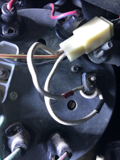

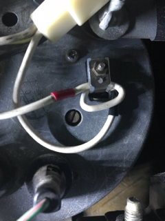

Good news Guys, Ian at Pertronix had the answer! On the back of the Tach there is a white wire that is looped and fastened via a plastic block, metal bracket and 8mm nut.IMG_3038.JPG
Ian’s instructions were to unloop the wire one loop at a time. As you can see there was only one loop. So I pushed the wire with the black band through the plastic block to make the loop larger. IMG_3039.JPG
The Tach now revs through the entire range. At least up to 5200 where I decided to stop. Will have to wait for her to get on the road before checking it up to redline!!! :)
Thanks for all your input and I hope this info helps others!
