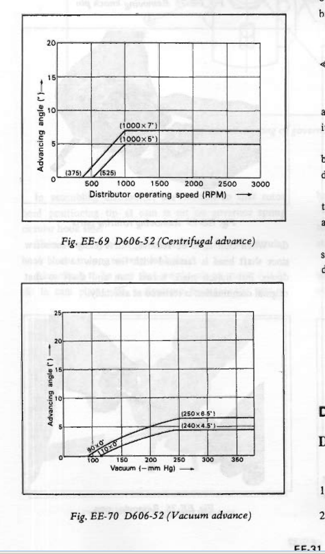

Every FSM has the distributor curves in the Engine Electrical chapter.  And the curves aren't specific to the distributor, they are tied to the combinations of parts.  There are no "Weber" curves.
Here's 1972, for example.  A good starting point.
