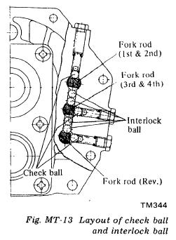

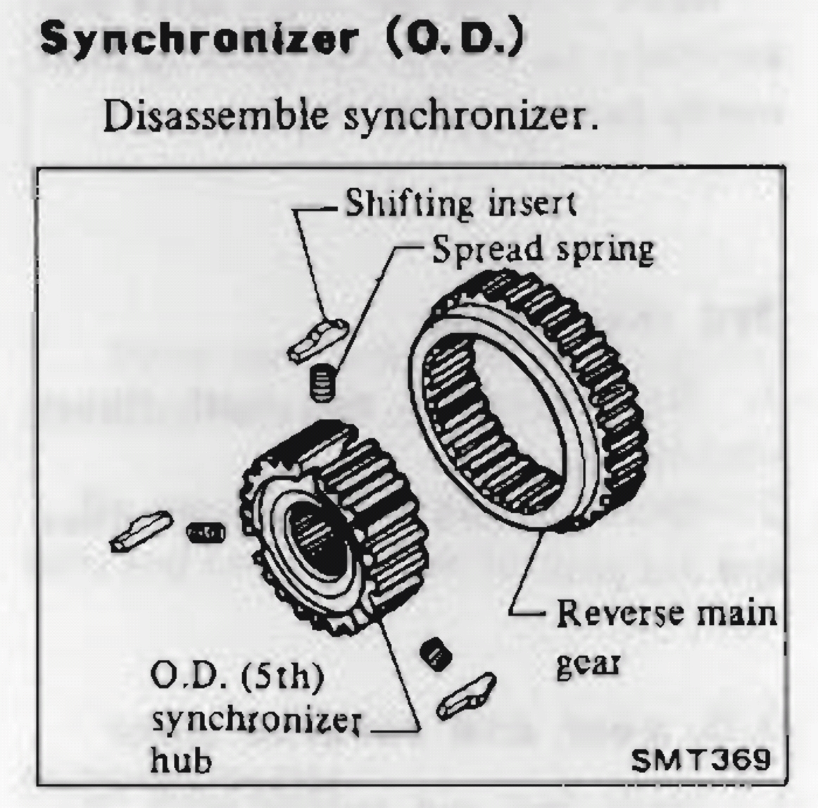

April 17, 20186 yr comment_547566 Yes it makes sense. It sounds a lot like to detents are reversed or a lot of free play on the rear hub or maybe a loose retainer plate on the adapter plate. Al (Cal Dat llc) has a bit of a reputation for hit and miss rebuilds. He gets quite a bit of attention from his customers on the forums. Did your second mechanic strip it down completely or just open the casing and found a couple of issues, fixed them and put it back together? In your last post you mention "feeling the gears meshing", but most of what you are feeling is the selector ball checks clicking into place and the inserts in the synchronizer hub clicking into the coupling sleeve. Could he have forgotten the springs behind the inserts? If you are not feeling that, I would remove the the two side ball check caps and check if the lower spring has colapsed or something like that. All the springs are the same length, but the top cap for 1st & 2nd is longer. You can get to these fairly easy by climbing under the car. Link to comment https://www.classiczcars.com/forums/topic/59877-i-need-some-help-with-my-5-speed/?&page=3#findComment-547566 Share on other sites More sharing options...
April 17, 20186 yr comment_547572 here is a short video describing how the shift insert should look and how the 5th should go in and out of gear. Link to comment https://www.classiczcars.com/forums/topic/59877-i-need-some-help-with-my-5-speed/?&page=3#findComment-547572 Share on other sites More sharing options...
