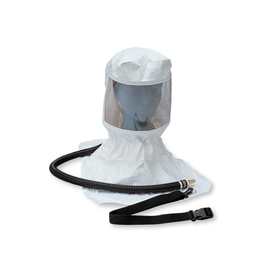

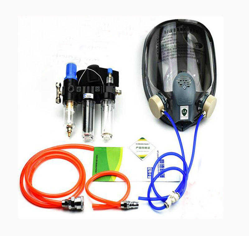

Well supplied air for positive pressure masks start at $50 on ebay right up to $1600  but it wouldn't be hard to buy a painters hood like the 1st pic and put together a small regulator off of a T valve like the 2nd pic that would tap into the main compressor hose.  Hook all that onto a hip belt and start spraying.  As long as you have 5-10 psi of air coming into the hood there would be no problems with paint fumes.  The main hose would continue on to a small regulator just before the paint gun.  Doable?
The end result would look sort of like this, https://www.amazon.com/Function-Supplied-Respirator-Cartridge-Included/dp/B07D8R1338/ref=sr_1_3?ie=UTF8&qid=1544933506&sr=8-3&keywords=Supplied+Air+Respirator
but made with better quality parts.

The real issue with using the compressor for an air supply is compressor oil. The air needs to be filtered and run through an oil remover to make it suitable for breathing. The other thing is the compressor intake needs to be pulling air from a safe area. Not near any exhaust ports or pulling fumes into it. It's the filtration on these systems that make them expensive. I have a fresh air mask but usually use the respirator as it's so much easier and I don't have 2 hoses to keep out of the paint. When I do a big spray I use the fresh air mask. It is much nicer because there is no inhaling effort compared to pulling through a cartridge and the air is cool in the hood so it helps reduce sweating in the booth and dripping in your fresh paint :angry:
The ones that feed the gun and mask off one line are really nice systems although the air will only be as cool as the compressor supplying it.
