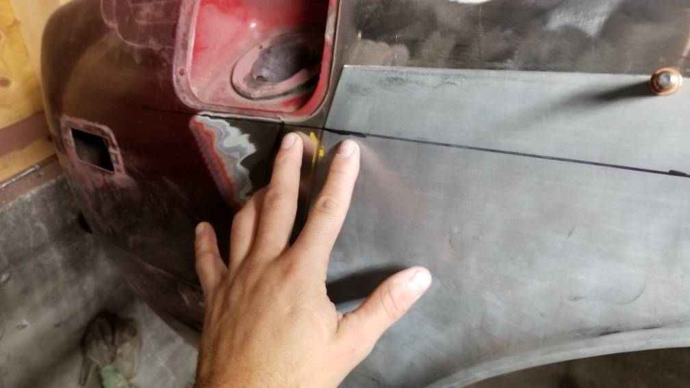

October 30, 20186 yr Author comment_560632 Fitted the patch and put the door in temporary to check. Everything lines up pretty good. Im thinkin tomorrow is cut n tack day! Nervous but what the Hell eh haha. There is a slight not dent but wave, on on spot ot the original. Right where the previous flares were riveted in in one spot. I'll see how she goes and deal with it once things are stitched together. Worst case... Bondo. I post a b4 and after tomorrow. The crease in the dog leg is sharp wherr as the rocker is a gentler bend. I'll have to dress that a bit with a hammer try and shrink it. The factory side lower door edge is actually more similar to the sharper finish of the quarter patch. I'll probably settle some where in between Sent from my SM-N950W using Tapatalk Link to comment https://www.classiczcars.com/forums/topic/59909-where-to-go-with-this-rusthole/?&page=6#findComment-560632 Share on other sites More sharing options...

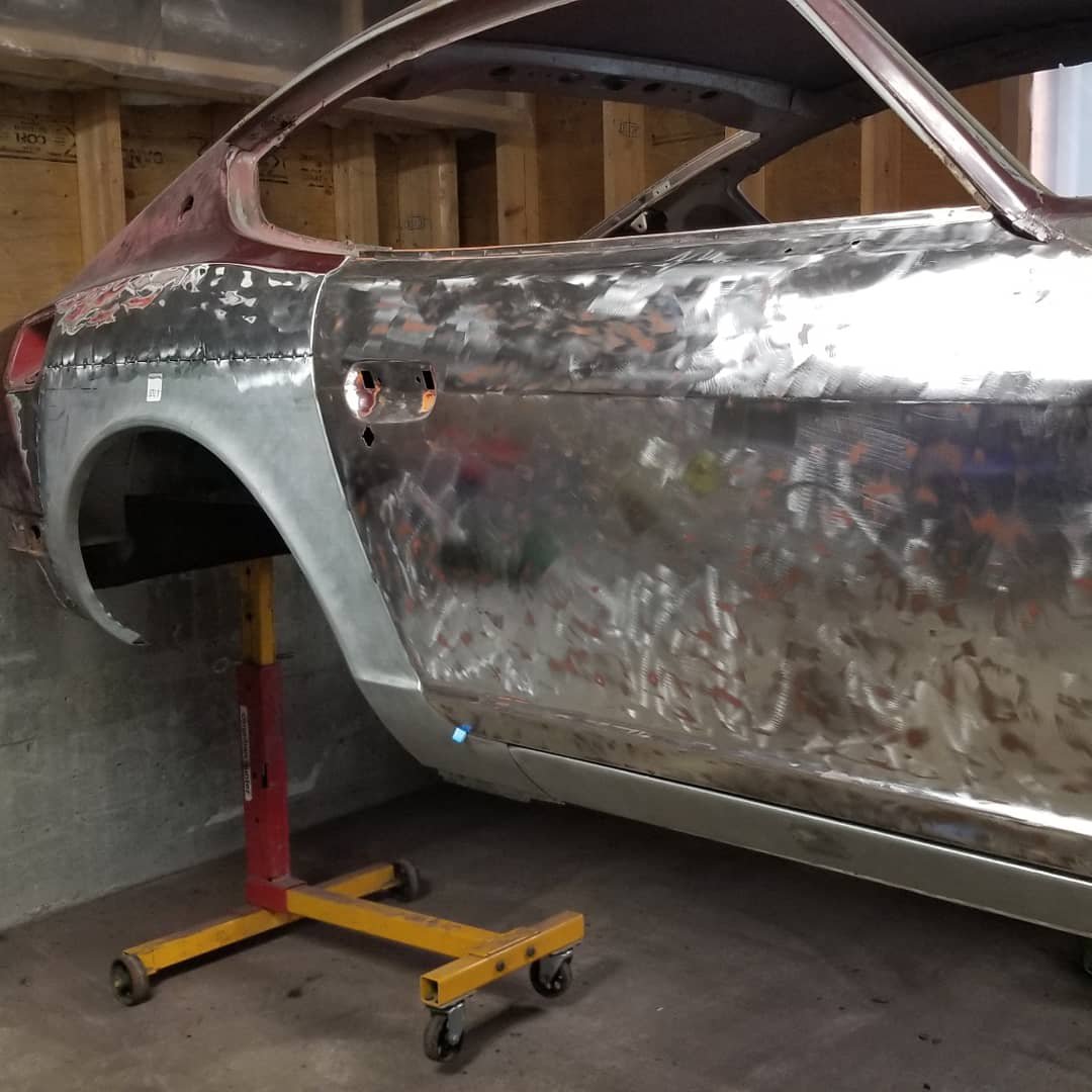

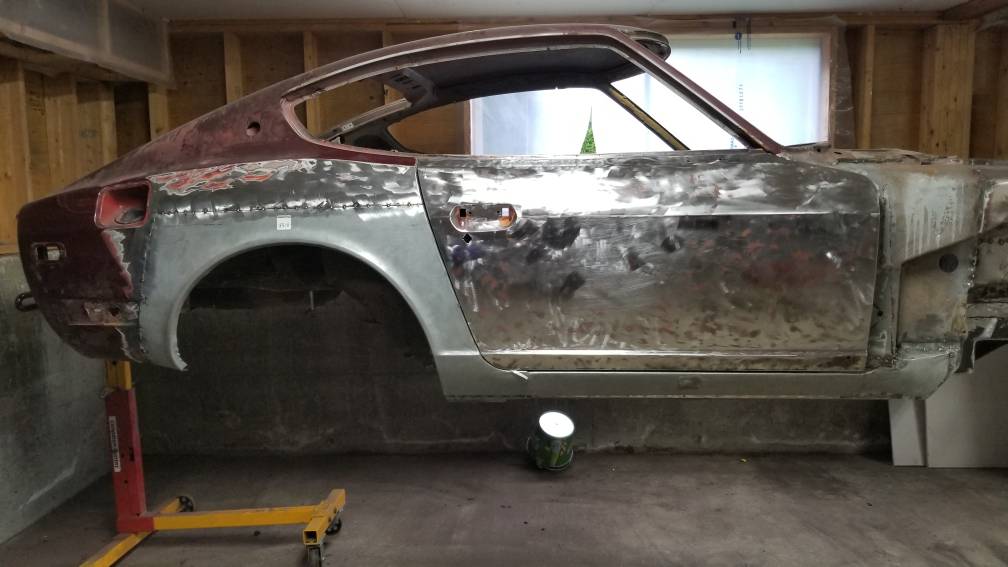

October 30, 20186 yr Author comment_560669 Just get to work and things happen. Fit in there real good. Im very happy. The door is just sitting in there so alignment is half arse but I had to check for lines and continuity. Sent from my SM-N950W using Tapatalk Link to comment https://www.classiczcars.com/forums/topic/59909-where-to-go-with-this-rusthole/?&page=6#findComment-560669 Share on other sites More sharing options...
October 30, 20186 yr comment_560671 You're getting there. Keep it up Link to comment https://www.classiczcars.com/forums/topic/59909-where-to-go-with-this-rusthole/?&page=6#findComment-560671 Share on other sites More sharing options...

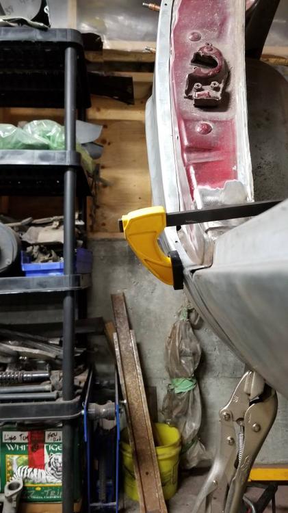

October 30, 20186 yr comment_560679 You really should have a stringer attaching both of your rotisserie engine stands together, even a 2x4 clamped on to both sides would do the trick. It puts a lot of strain on your mounting bolts, your work looks great. How do you like the Tabco panels? Link to comment https://www.classiczcars.com/forums/topic/59909-where-to-go-with-this-rusthole/?&page=6#findComment-560679 Share on other sites More sharing options...
October 30, 20186 yr Author comment_560682 grannyknot! i have one ha ha i just forget to attach it. ill do that tonight, good eye. Considering they are my first patch panels i cant truly comment but in terms of this job the seem decent. needed some flexing so it laid nice against the original. also the creases arent as sharp as factory and the body line under the gas tank filler is hardly there. I creased it a bit but couldnt go much past the back third. ill try and recreate it a bit on the door side with filler i guess Link to comment https://www.classiczcars.com/forums/topic/59909-where-to-go-with-this-rusthole/?&page=6#findComment-560682 Share on other sites More sharing options...
