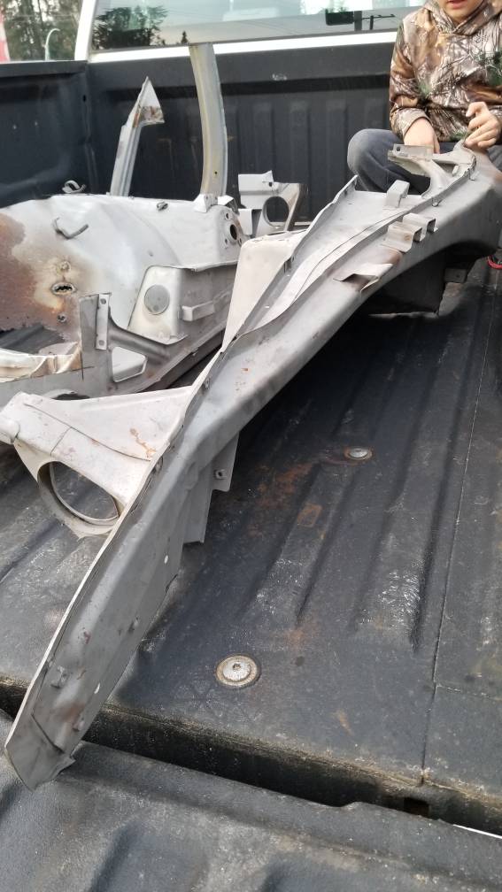

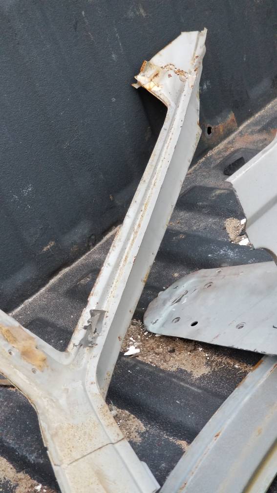

November 13, 20186 yr Author comment_561505 Score! Upper bulkhead problem solved, headlight wings solved, a pillar solved. All for the price of 40 bucks! Sent from my SM-N950W using Tapatalk Link to comment https://www.classiczcars.com/forums/topic/59909-where-to-go-with-this-rusthole/?&page=8#findComment-561505 Share on other sites More sharing options...
November 13, 20186 yr comment_561508 5 hours ago, Elliott000 said: I wanna strip the whole car as mentioned but don't really want to 2k prime it then have to clean the paint off in repair areas and re spray..... Should I just strip prep and spray then cut out and fix whatever is left after? Or buy the por15 prep or similar and trust that coating it leaves on is good to not flash off and rust a bit while I tackle the other side? (I've committed to full paint strip) That is a tough one, depends on how long you think it will take you to get to the last area that needs repair, you could mask off all the areas that need repair work and 2k prime the rest of the car. Whoa, just the pics of your score, what a score! Link to comment https://www.classiczcars.com/forums/topic/59909-where-to-go-with-this-rusthole/?&page=8#findComment-561508 Share on other sites More sharing options...
November 13, 20186 yr comment_561511 Looks like parts off a 280... nice! Link to comment https://www.classiczcars.com/forums/topic/59909-where-to-go-with-this-rusthole/?&page=8#findComment-561511 Share on other sites More sharing options...
November 13, 20186 yr Author comment_561513 She was an early 260. Im hoping/assuming they are the same on that outer bulkhead area hahaSent from my SM-N950W using Tapatalk Link to comment https://www.classiczcars.com/forums/topic/59909-where-to-go-with-this-rusthole/?&page=8#findComment-561513 Share on other sites More sharing options...

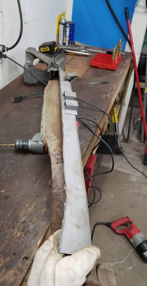

November 13, 20186 yr Author comment_561554 Good to hear patcon and everyone. I think im gunna polish off the metal work on the passenger side, etch it and the roof then epoxy er up! I'll spin the car around and focus on the driver side for a few months after that. Last night I couldn't wait so I started in on drilling out the Weldon the peices I got. Today I'll line things up and start fitting them. Paying close attention to forward back so the hood isn't wonky! Sent from my SM-N950W using Tapatalk Link to comment https://www.classiczcars.com/forums/topic/59909-where-to-go-with-this-rusthole/?&page=8#findComment-561554 Share on other sites More sharing options...
