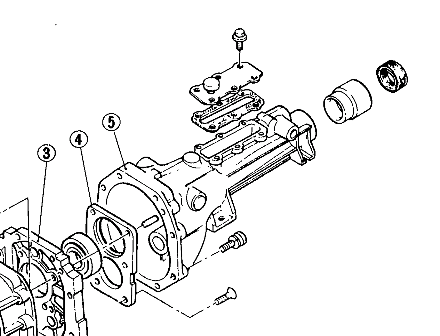

The 4 speed is easy to identify. It has an breather plate on top of the rear extension with six M6 bolts holding it in place. See the jpeg for details.
The 5 speed doesn't have the breather plate. You can easily identify the two "wide" or "close" ratio version by following the instructions in the pdf.

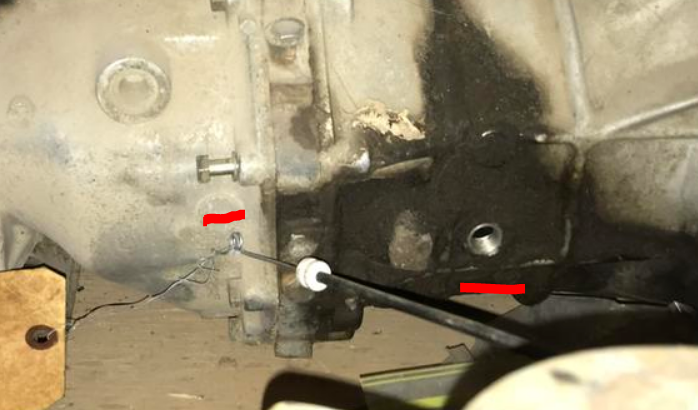

Alright I tried the pictures again.  Thank you for the replies.  Based on the information I've gotten it looks like I have a 4 speed series B.  Is there anything else I should know?

Those 4 speeds are a dime a dozen.  Almost can't give them away, believe it or not.  Looks like someone has tried to get in to yours.
