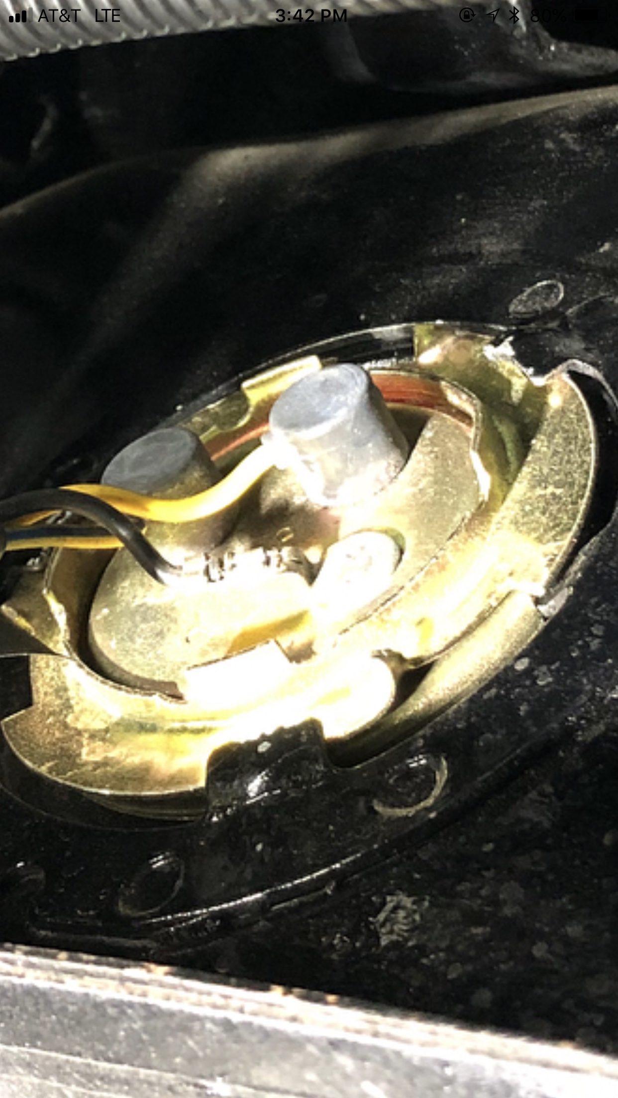

So, I follow a lot of Z guys in Japan on Instagram, check out these connectors for a fuel sender, I like the shape of the rubber cover.
 anyone seen anything like this? Mine are super stiff, and I cant get a good connection on the sender, seems to be finicky.
The original picture is what 280 senders electrical connectors look like. They are not designed to be taken off or to be removable.
The 240 senders had the slide on terminals and could be better insulated and water proofed by the rubber caps referenced above.

I used female spade connectors and slathered them with liquid electrical tape. Those look a helluva lot better than my jimmy rig.
Hows the fit of the spade over it? does the tape do all the holding?
I honestly don't remember how tight they fit but if they were loose I'm sure I squeezed tighter with pliers. The liquid tape worked out great. It sealed everything, adding some waterproofing for any chance of getting caught out on a rainy day.

Do you have the looking connectors?  That's what I put the female spade connectors on, for my 240.  280s are different.
Top is the one I'm talking about.
