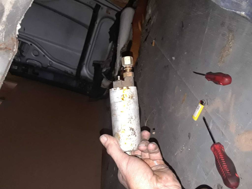

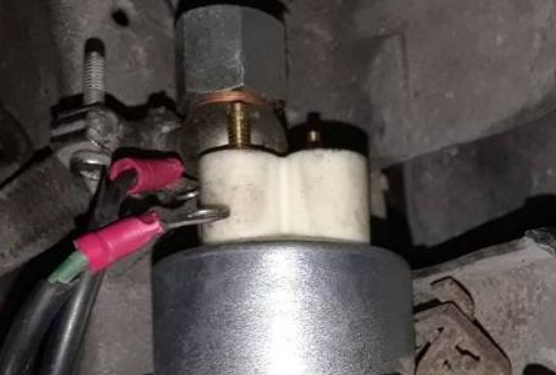

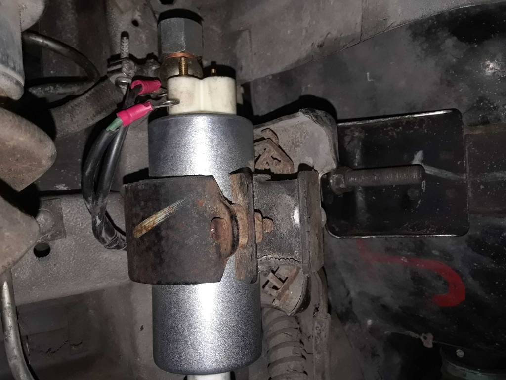

Sorry got busy with work haven't checked up on this thread till now I'm using an inline pump similar to the one on the car the first photo is what came off the car the second what's on it15251306034401525130662982

Sorry here it is1525130662982.thumb.jpg.090d4cbc27e2b6d64ae03d772b93a86e.jpg

It's not showing the first picture I sent it only showing numbers so just in case here is the original pump1525130603440.jpg

The new eyelets show that it's possible that you have it wired backward.  If you look very closely I think that you'll find a + and a - molded in to the ceramic (or plastic.  Whatever the white material is) where the wire terminal studs are.  The green wire goes to +.
I'll try flipping them
