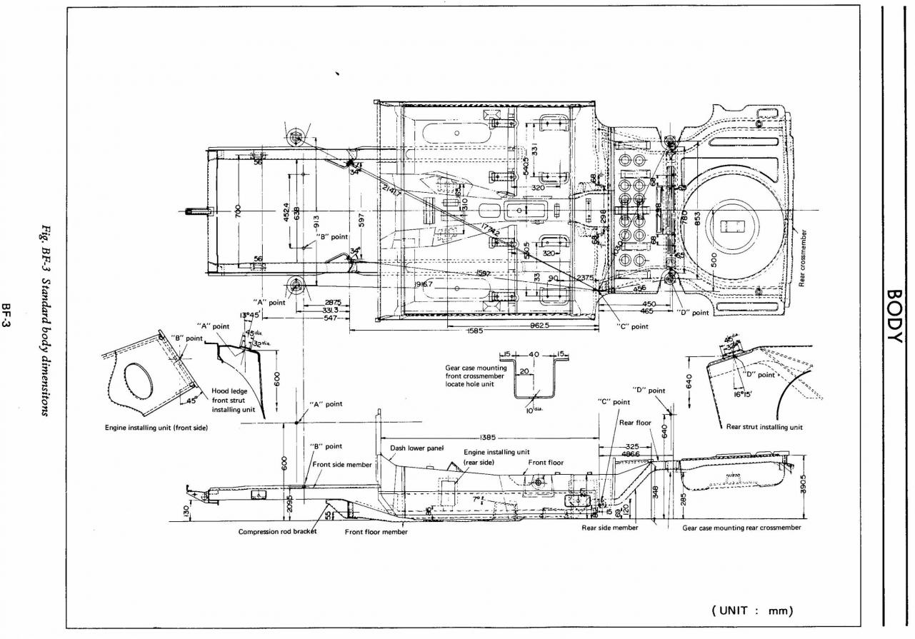

This would suggest the door sills are parallel to the datum line.
When you work on a frame rack. The rack can be assumed to be the datum line. So you measure to the rack. If your concrete floor is very flat you could use that. The floor in my shop is not that flat (>1/16"). Strings might work if they are tight enough not to sag. A nice long metal straight edge might be better. A piece of angle iron or tube stock. I have a laser level but I don't think I would trust it to be accurate enough for this kind of work...

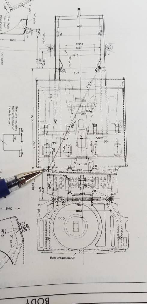

I leveled the car with 6" blocks and a straight edge across the door/rocker sills which are straight. The tops of the rear strut towers aswell as the rear trunk deck are all level aswell at this position so that's positive. Moving forward, the existing frame rail accross to where the old one was is level but things are about 3/16 out of whack at the very front so she's got a bit of a twist to it. I'll have to check the manual later today and see where all the datum measurements line up. I think what I will do is hang a fixture ill make under the car and that will be my zero mark then ill install the frames as needed. I'll also try to figure out a true center line. It has suffered some damage at the front so I'd like to triple check everything. On the datum topic. Where is the "position c" physically on the car, in the picture with measurments. There's multiple holes and such under there haha.
Patcon thanks for all the input. I agree on that drawing showing that the sills can be my level plane. That being said, thier "zero" appears to be the sheet metal floor? That's a tough one because I've replaced the floors therefore it will likely be a couple mm difference than stock. I think with the engine frames I want to be bang on. Just trying to figure out what to call zero then add the measurements to my level plane on top of thier numbers

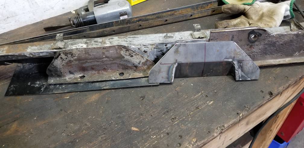

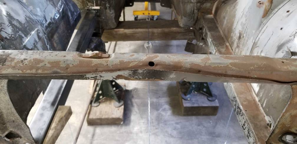

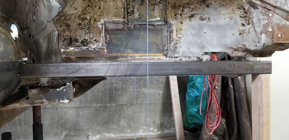

Made the new recesses for the cross member. Ill be triple measureung and comparing tomorrow before I center punch any holes. I'll probably cut in the sub frame connectors too and then weld it on the bench. I've got a center line and plumb bobs off the strut towers for reference measurement. BUT i do have a discrepancy of 7mm or about 5/16 of an inch on the dimension between towers. I think tomorrow I will fab a bar and bolt it in there to hold em at the 913mm spec while I build all this20180502_192836.jpg1525314643638.jpg1525314691539.jpg
