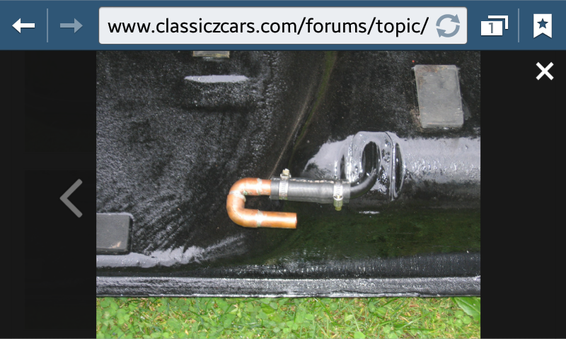

Posted (edited)
Here's where I got the idea. Instead of sweating copper fittings I used two 90 degree pex fittings with a small section of hose in between to make a 180 turn around. Used regular hose clamps, pex crimp rings won't work on rubber hose. LOL
Here's an informative thread with some good solutions, part numbers and many photos. You'll have to copy and paste. It didnt work as a hyper link. Edit #2. It works now.
http://www.classiczcars.com/forums/topic/17542-treating-insideoutside-of-gas-tank-with-por15-products-and-removing-evaporation-tank/

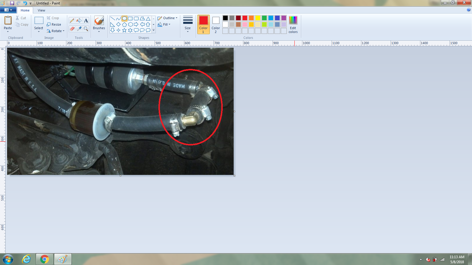

Posted
16 hours ago, SoCalJim said:
I catch myself doing the same thing at times.  Thanks!
I apologize for forgetting to do this earlier but here is a picture that should give you the basics of what I did on the 5/8" evap hose on top of my fuel tank, the 180 degree bend.
3/4 PEX elbow fits 5/8" fuel hose nice and snug, use the worm clamps like in this picture.  I laid the old hose on the floor and copied the bend with the new hose and PEX fittings.
If you need anything else let me know.  Cliff
