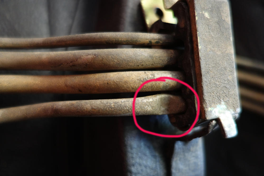

I'm putting a 78' 280z back together for someone who completely disassembled it and put it in boxes some 5 years ago.  I've never seen this car before but It's on a rotisserie and has been painted so really the hardest part is trying to find which part is in which box and figure out what is missing or needs replacement.  The first problem I've run into is the fuel piping which was slightly deformed and bent from being off the car and moved around. When putting it on I noticed a "kink" in what I believe to be the Evaporation line near the fuel pump.  I've used a compressor and air does blow through it but I'm wondering whether or not I should repair or replace it.  Am I correct that it is an Evap line and Any suggestions as to repairing it?

I think that may be the fuel return line .  I believe all the evap lines go to the evap tank on the right rear of the car by filler tube.  My opinion would be to replace the line.  You are inviting future problem and it will be easy to do it now than later.  Download the 1978 FSM and it will tell you everything you need to know.

That is the vapor vent line. If it passes air, it's probably fine the way it is. But if you get energetic, you might just smoosh the outward bump back in a little. That might help open up the ID a tiny bit more. If it bugs you.
Evap, Vapor, same thing , right??  I meant well but It's been a crazy day. Thanks for the correction CO.
The owner would rather not replace even though it looks to be a pretty good ding.  I think he's tired of throwing money.  I thought about the smoosh but before I put the jaws on it and test my strength I was thinking about just cutting and replacing the damaged section with fuel line.  Since it's vapor it shouldn't have much pressure.
I am going to second CO's proposal, but without even the "smoosh" to make it more round.  It's just a vapor line.  It might even be the one with a check valve in it, and the check valve is probably the main constriction.
Have you checked operation of that pump?  If it's original, it's old.
It does have the check valve, but it still bugs me a little.  Believe it or not fuel pump actually looks better than when I found it in the box. I've done a lot of cleaning/refreshing of the visible parts because I hate to put dirty stuff back on to a car.   The wiring harnesses have several amputations so Im not sure anything is going to work.  And I Haven't even seen the engine yet.  But as soon as I get a battery near it,  I will check the pump.  I'm told the car has sat like this for the last five or so years and I'm not sure as to what the owners final desire for it is, ie: sell or drive. The owner handed it off to one of his employees and told him to just get it done.  I'm doing , repairing and replacing as I go.
You have an odd form versus function dilemma.  If function wins then leaving a smooshed steel line is best, I think.  Better than a piece of rubber line with hose clamps, isn't it.  If you're going for form, then you have to replace the whole thing or use flare fittings to connect the ends of a steel pipe patch piece.  Can't see how rubber hose with hose clamps is better than any option.
Just conversing.  I used compression fittings on my EFI fuel line.  That's an option also.  Looks clean, and is solid.  Doesn't require flaring tools.  Got them from McMaster Carr.

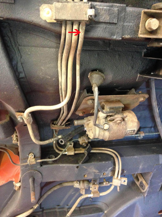

The evap system uses that goofy check valve-ish device between the tank and the carbon can. You can see that device hanging out in this pic, near the bottom:
On the tank side of that check valve, there could be some pressure buildup (due to a purposely high "cracking pressure"). But on the carbon canister side, there should never be any measurable pressure in that line.
Point is... If it passes air, you should be OK. Smoosh it a little, or just let it be. The LAST thing I would do is cut it and introduce more leak points in the system.
