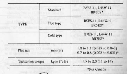

SteveJ Posted June 9, 2018 Share #27 Posted June 9, 2018 Here is the 78 ignition system per the FSM. Here is the 76 Ignition system per the FSM. I would say that your assumption is correct. The wiring breakdown on EE-25 of the 78 FSM also does not show a ballast resistor. 1 Link to comment Share on other sites More sharing options...
Zed Head Posted June 9, 2018 Share #28 Posted June 9, 2018 I had a 78 parts car and it did not have a ballast. I think that it was the first "high energy" ignition system used on the Z's. They even upped the spark plug gap. Except for Canada. Maybe Canada still had the old system. 1 Link to comment Share on other sites More sharing options...

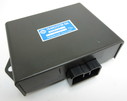

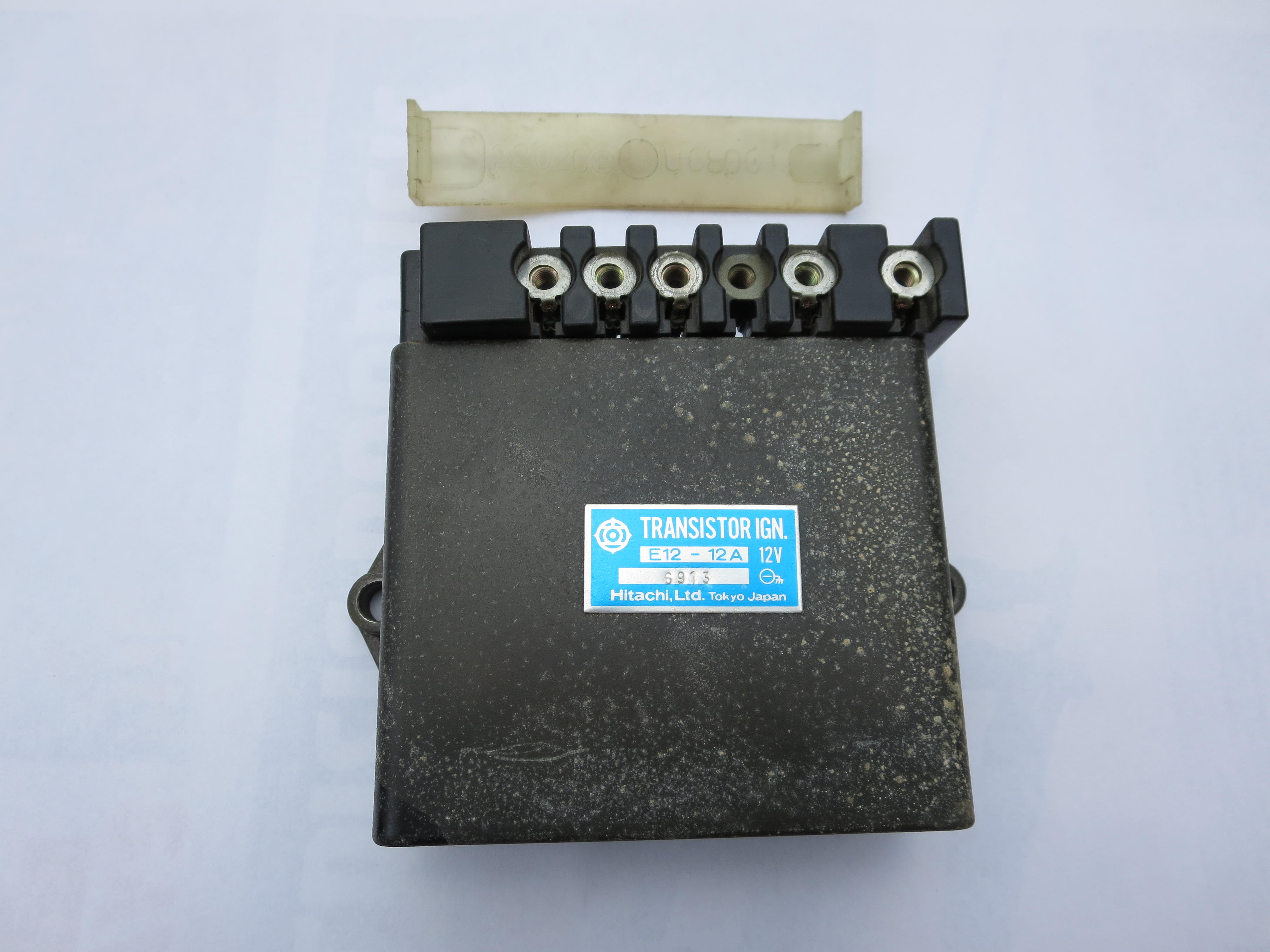

EuroDat Posted June 10, 2018 Share #31 Posted June 10, 2018 They went to 12v coils in 7/77 or there abouts, Im going from memory here. The TIU would then be the E12-27. The E12-27 has a 6 pin plug with 5 wires. The earlier 77 models used the E12-12A with 6 screw terminals for the single pick-up distributor in the Californian models. The Fed models used the E12-13 with dual pick-up distributor. It has 7 screw terminals. Both the E12-12A and the E12-13 use a ballast resistor. Link to comment Share on other sites More sharing options...
EuroDat Posted June 10, 2018 Share #32 Posted June 10, 2018 This is a photo of the earlier Californian "6 terminal" E12-12A This is the 78 model E12-27 with the terminal block. Greg, if you have this one you don't need a ballast resistor. It should have a 12 volt coil. Link to comment Share on other sites More sharing options...
gwri8 Posted June 10, 2018 Author Share #33 Posted June 10, 2018 Yes, it has the E12-27. I knew something was different when I saw it, hence the query. I had a 06/77 parts car and it still had the E12-12A. The depth of Z knowledge in this forum is truly amazing. Anybody have any lotto ticket advice? ? 1 Link to comment Share on other sites More sharing options...
