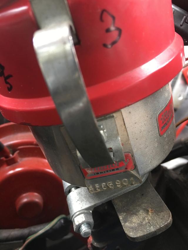

My Z uses the 270/339 combination and I think they are still available. I called Mallory last Friday about determining which cap/rotor to use and they had me read them the part number on the distributor. To be sure you are getting the right cap and rotor, look for a 7 digit part number etched on the distributor tag just below one of the two cap retaining clips.
Same part numbers here. Got the rotor. Cap arrives in a week. Thanks
