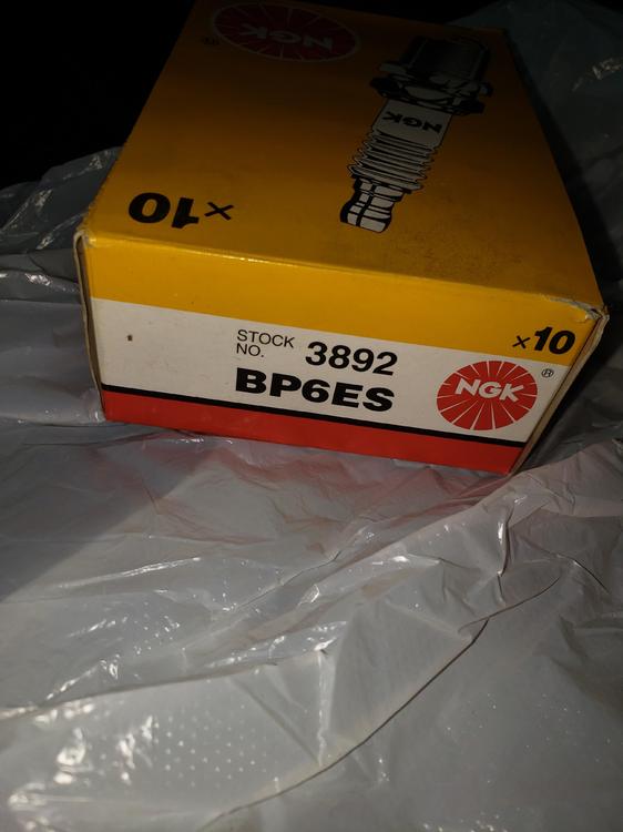

September 26, 20186 yr comment_558245 Well then i would need to close the terminals inside the spark plug boot with a pair of long nose pliers and open them at the other end where they are fasten to the distributor cap. Anyway i bought a new set of spark plugs which will be gapped to .032 Link to comment https://www.classiczcars.com/forums/topic/60072-misfiring-while-cruising/?&page=7#findComment-558245 Share on other sites More sharing options...
