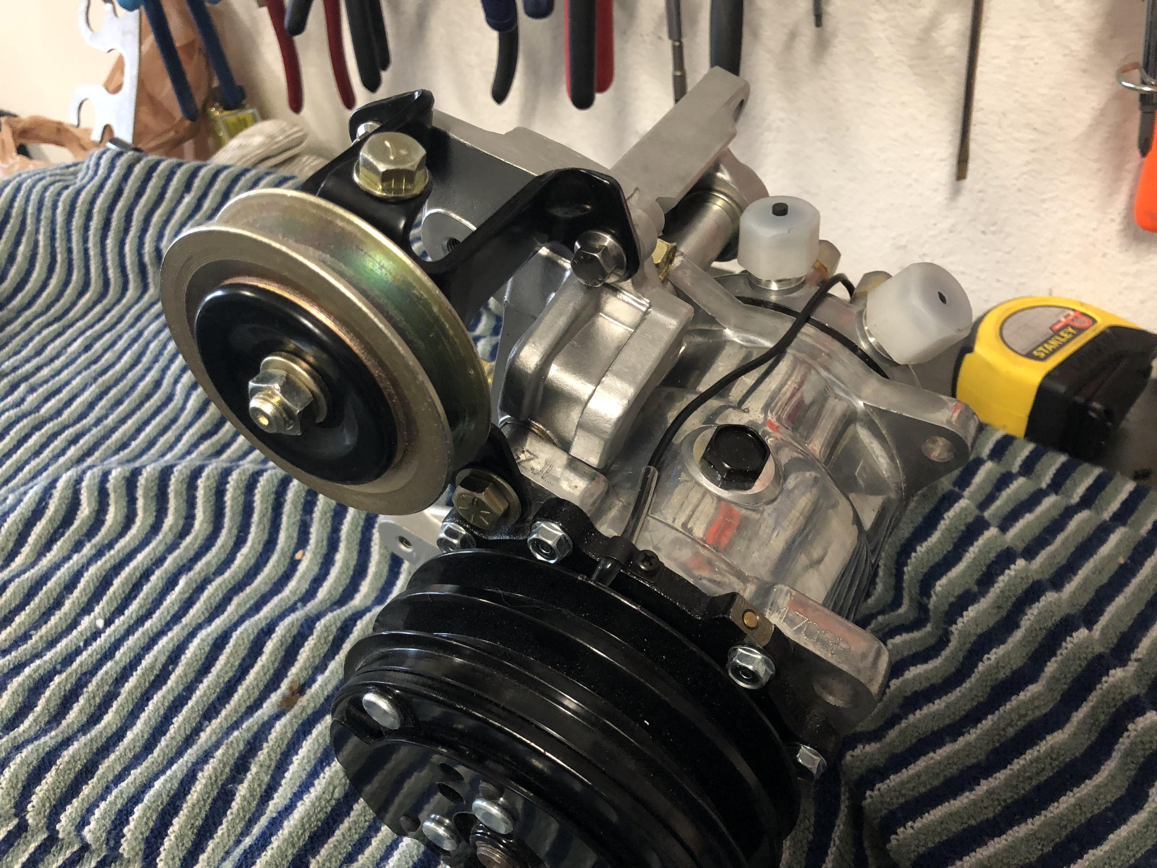

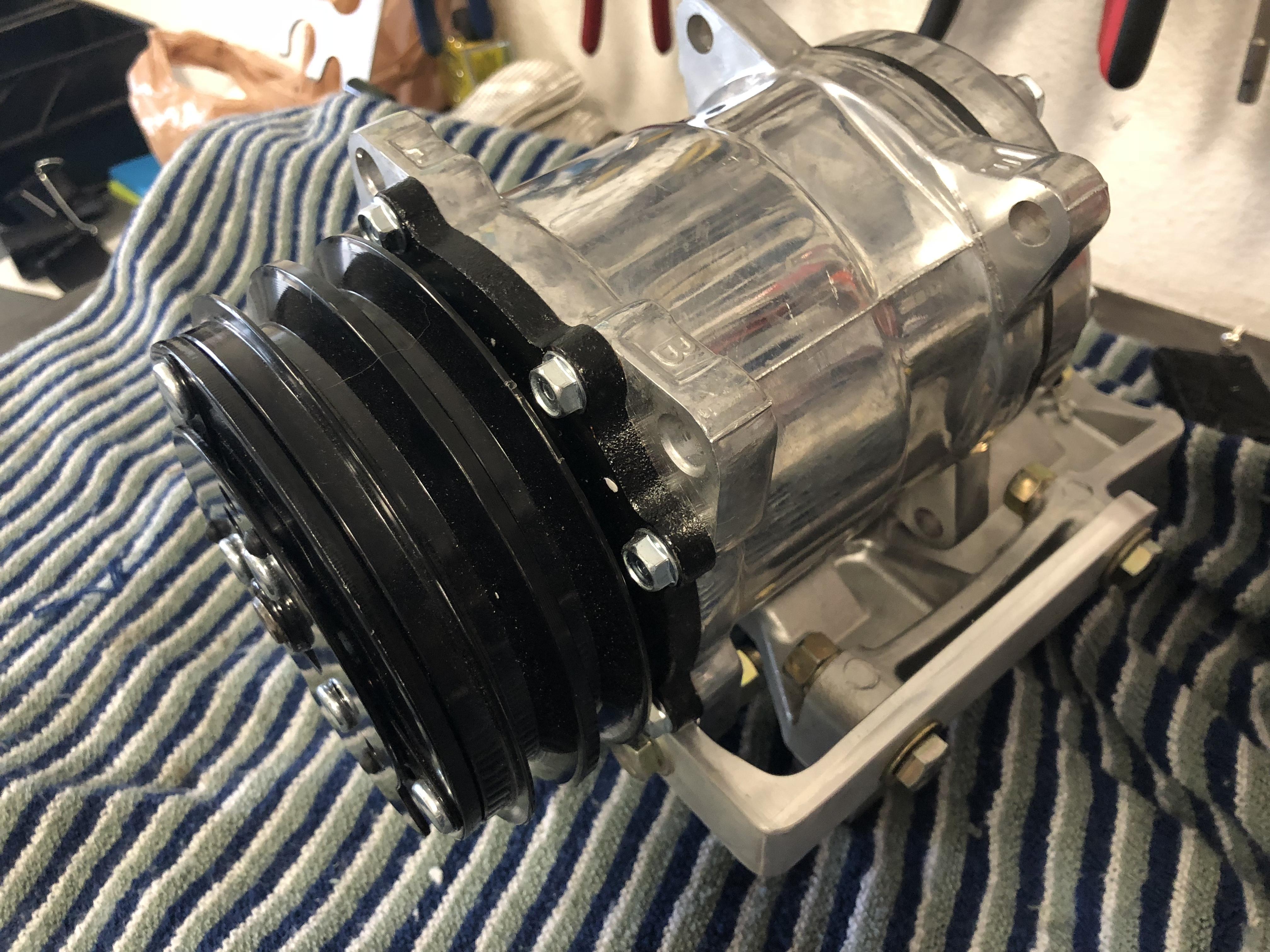

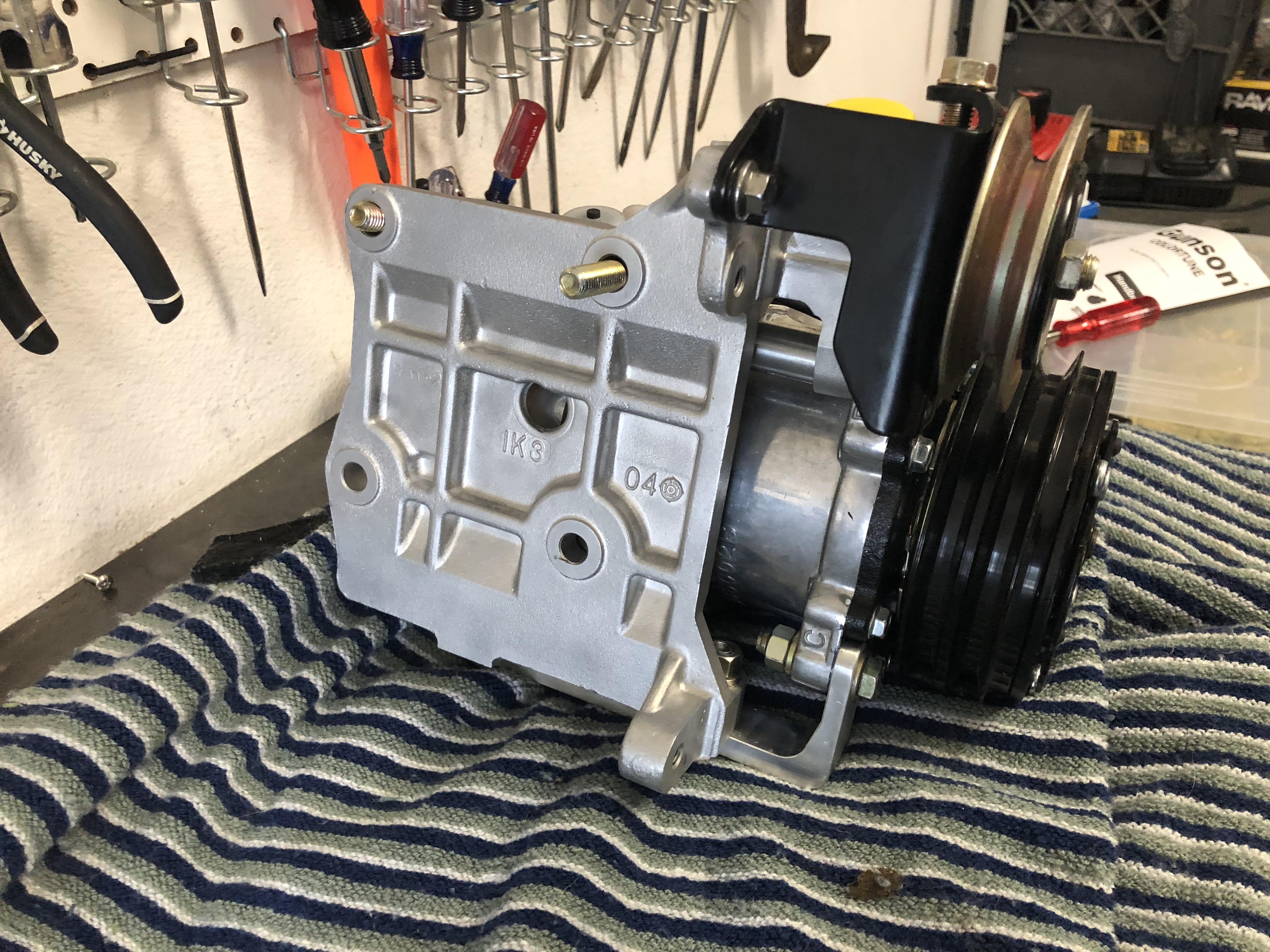

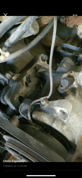

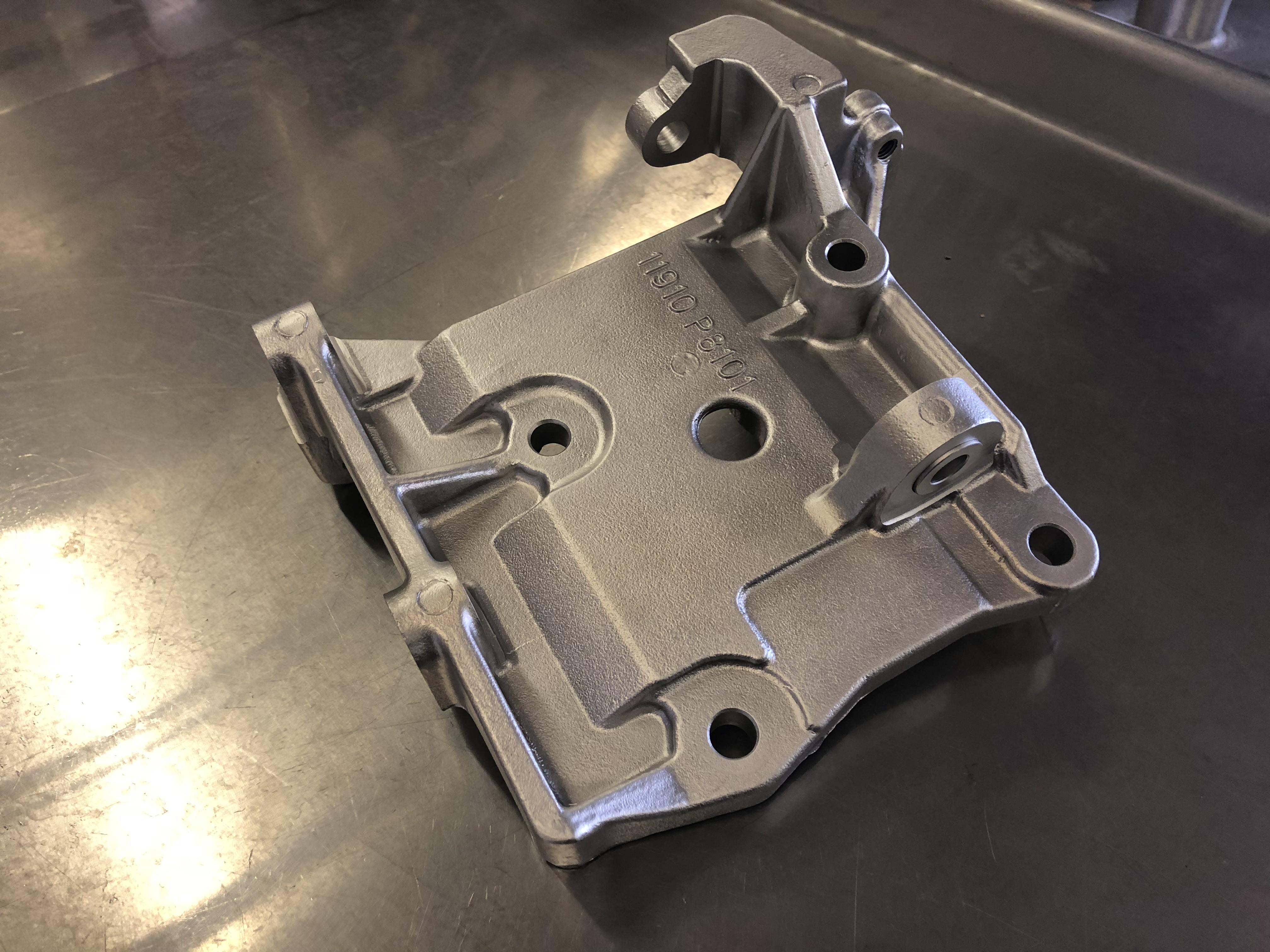

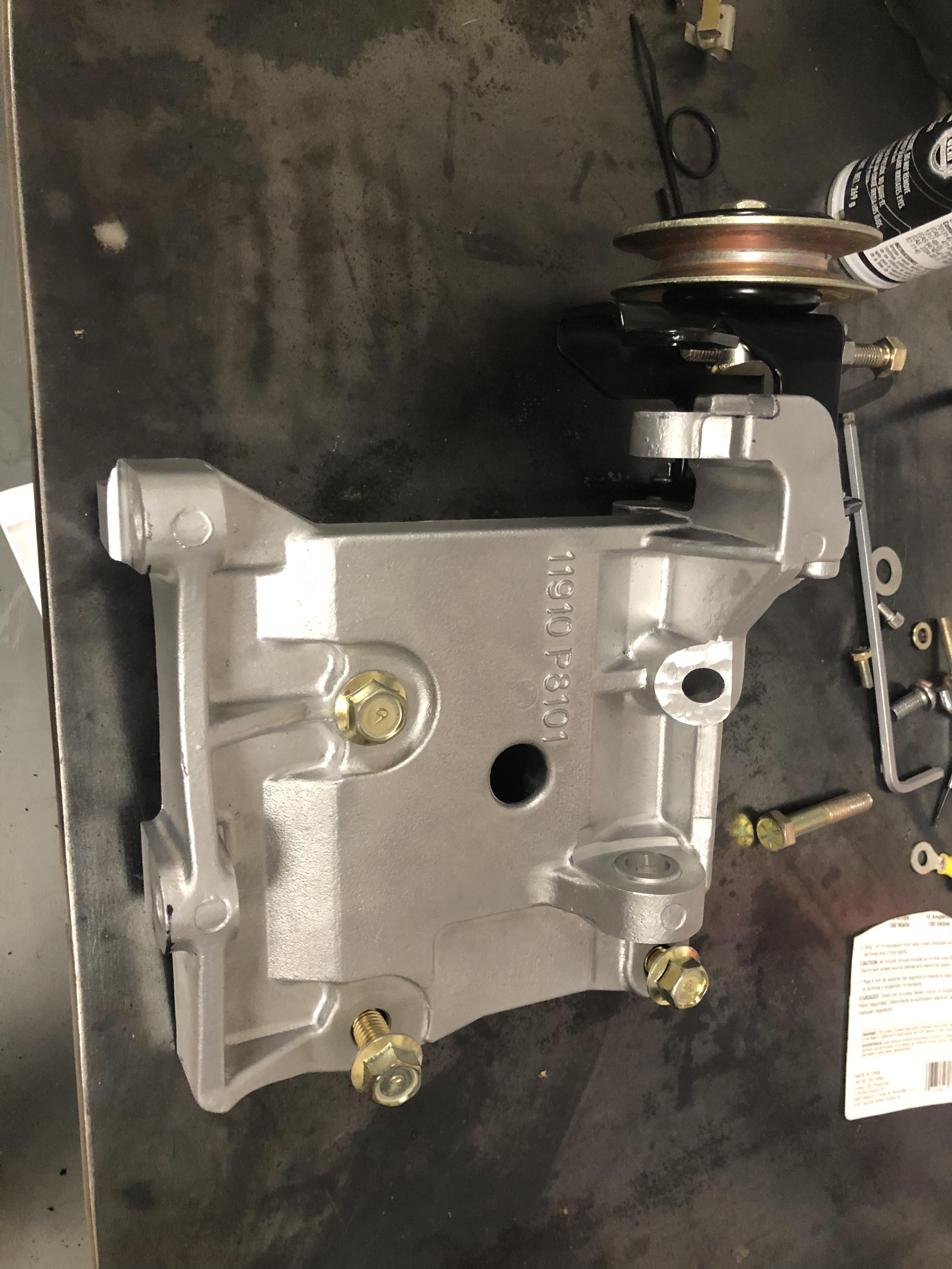

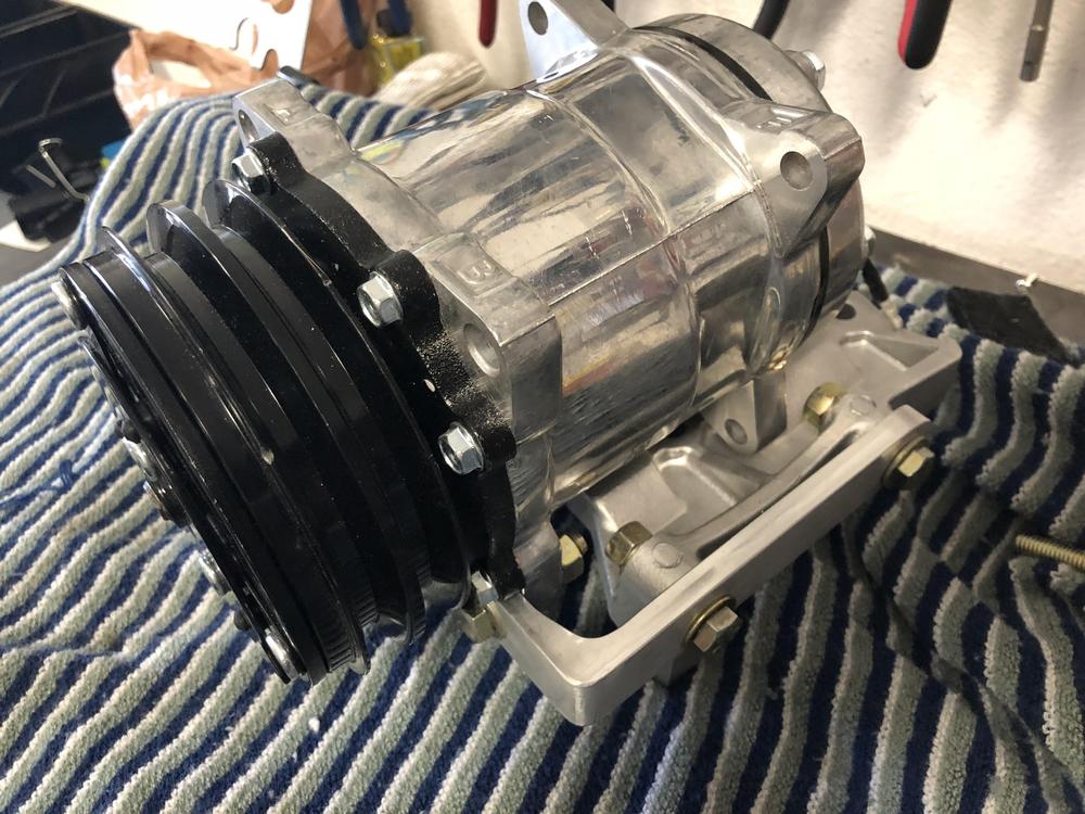

Posted May 24, 20186 yr comment_549736 So I have been working on this for a while. For reference I have a series 1 with dealer installed AC. It’s a giant York compressor shoved above the smog pump. It was in the way of everything. So hard to work around. I decided it had to go. Most of the sanden ac brackets are steel and don’t use an idler. I really like the idea of an idler to tension. I also love the 280zx aluminum ac bracket. My original plan was a 280zx compressor. But they are pretty speedy. So I ditched the whole idea and started the concept to adapt a sanden ac compressor with a v pulley. I had a buddy fabricate some new brackets and boom. Everything lines up. I vapor blasted the mount, got the pulley zinc’d and same with the hardware. Plus the rest is powder coated black and a new bearing. Then got a sanden off eBay for like 100$. It was supposed to be zinc’d but came powder coated. Oh well. Should bolt right up. I will reuse all my lines but one. Which got too close to exhaust. The rest are still in great shape. Hopefully it work! A few of the pictures have the idler bolt installed wrong. I have since fixed it. Link to comment https://www.classiczcars.com/forums/topic/60085-sanden-ac-compressor-on-a-280zx-mount/ Share on other sites More sharing options...

May 25, 20186 yr comment_549780 That compressor mount setup looks great, I would really like to do something similar. I do not yet have a ZX bracket to look at, what needs to be done to adapt it to the Sanden compressor? Link to comment https://www.classiczcars.com/forums/topic/60085-sanden-ac-compressor-on-a-280zx-mount/#findComment-549780 Share on other sites More sharing options...
May 25, 20186 yr Author comment_549785 I ended up buying a dryer. I believe this is as close to the original as possible. Four Seasons 33280 Filter Drier https://www.amazon.com/dp/B000CSYQXW/ref=cm_sw_r_cp_api_i_i6acBb9G2MYNT The bracket needed some machining, then some spacers and a bolt on bracket. Not too much work. I was going to design a full new bracket with an auto idler but decided the Zx bracket was so close might as well adapt it. Plus side if the compressor dies I can always buy another 75$-150 one. Link to comment https://www.classiczcars.com/forums/topic/60085-sanden-ac-compressor-on-a-280zx-mount/#findComment-549785 Share on other sites More sharing options...
