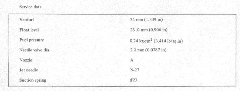

2 hours ago, 240260280 said:
240z needle valve is 2.0mm (below).
I can not find data for 260z.
Thanks! This is exactly what I need, 2.0mm/0.0787"
