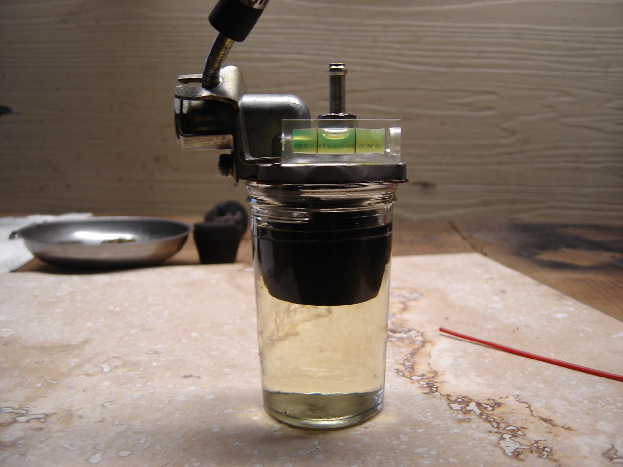

I haven't read all the post but I found my low float level after running up a very long and steep mountain.  About half way up it started running on the back carb, half power.  I cut the wheel and rolled it perpendicular with the road, cranked on it a few times and it cleared right up.  Went about another mile, same thing.  I went back down and it ran great the rest of the way home.
After a week I had the floats set right and it runs fantastic now all the way to 6,000-6,5000 rpm.
Sorry if already told this but it's the best thing I've done to my SUs.
Cliff
Yeah, I toyed with float levels a bit, even made them higher than stock and still no benefit. I like your off vehicle float adjustment.
