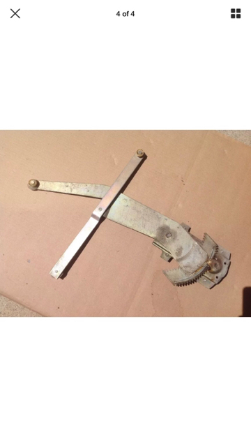

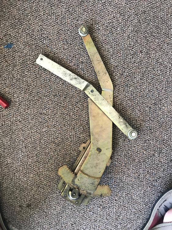

Posted May 29, 20186 yr comment_550009 My passenger side window on my 240 won’t close properly, is the guide supposed to be straight? And is the plastic piece that holds the window broken? Sent from my iPhone using Classic Zcar Club mobile Link to comment https://www.classiczcars.com/forums/topic/60107-window-guide/ Share on other sites More sharing options...
May 30, 20186 yr comment_550057 Those parts look correct, best I can tell Link to comment https://www.classiczcars.com/forums/topic/60107-window-guide/#findComment-550057 Share on other sites More sharing options...
May 30, 20186 yr comment_550060 The long guide is factory curved, but that plastic piece is supposed to be attached to the window frame. Yours is broken. You will find the other side of it attached to a metal bracket riveted to the window frame. Edited May 30, 20186 yr by zKars Link to comment https://www.classiczcars.com/forums/topic/60107-window-guide/#findComment-550060 Share on other sites More sharing options...
May 30, 20186 yr comment_550068 I used JB weld to get the plastic back onto the window, then just grease it to reassemble.Make sure the regulator is all straight before you install it or it’s never gonna fit. Sent from my iPhone using Classic Zcar Club mobile Link to comment https://www.classiczcars.com/forums/topic/60107-window-guide/#findComment-550068 Share on other sites More sharing options...
