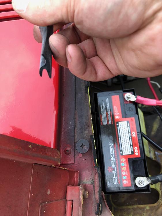

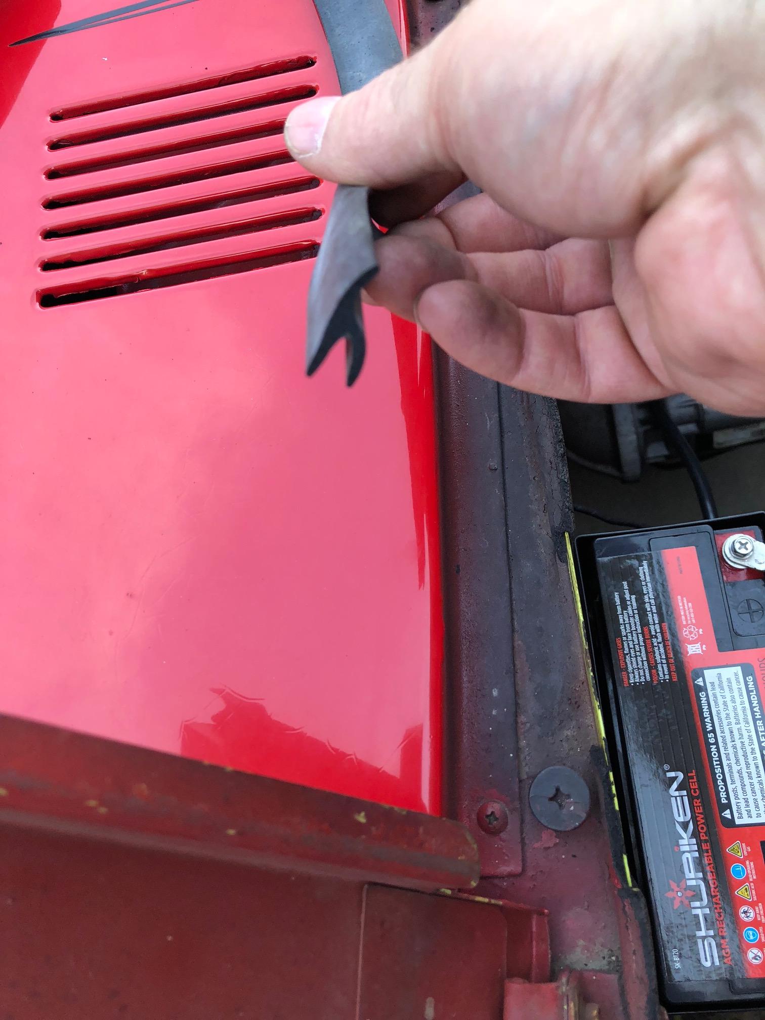

I purchased a complete weatherstripping rubber seal kit from zcardepot.com.  By process of elimination, I believe I've located the Cowl Hood Weatherstrip per the attached pictures.  The p/n's on the individual kit pieces don't match zcardepot.com's website p/n's so it hasn't been a very straight forward task ... anyway, my question is, should the seal be positioned in the forward position (fig 3) or aft position (fig 1)?  The original seal doesn't have the upper flat rather it was just a "u" shape that was fitted snug to the metal upright angle (fig 2)

Thanks for the replies ... reached out to zcardepot.com this last week and it is indeed the seal for the hood/cowl.  The first pic is the recommended direction.  I'll need to trim a couple inches and use some adhesive with a couple clamps as it sets as recommended previously.  Cheers!
