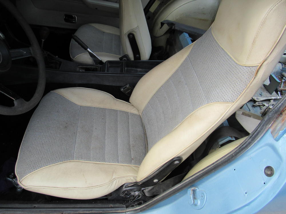

June 6, 20186 yr Author comment_550550 OK guys how the heck do you get this panel out without breaking it, how did they get it in? Starting in 74 Nissan stopped offering White as an interior colour and switched to Off White, I have also seen this colour called Beige and Ivory. My question is has anyone bought these seat covers from MSA and what do they really look like? Is there anywhere else that makes a stock looking Off White with the fabric in the middle? http://www.thezstore.com/page/TZS/PROD/40-2651 Link to comment https://www.classiczcars.com/forums/topic/60126-just-what-the-doctor-ordered-1977-280z/?&page=2#findComment-550550 Share on other sites More sharing options...

June 7, 20186 yr comment_550561 That interior! Link to comment https://www.classiczcars.com/forums/topic/60126-just-what-the-doctor-ordered-1977-280z/?&page=2#findComment-550561 Share on other sites More sharing options...
June 7, 20186 yr comment_550583 tough era to live thru... Link to comment https://www.classiczcars.com/forums/topic/60126-just-what-the-doctor-ordered-1977-280z/?&page=2#findComment-550583 Share on other sites More sharing options...
