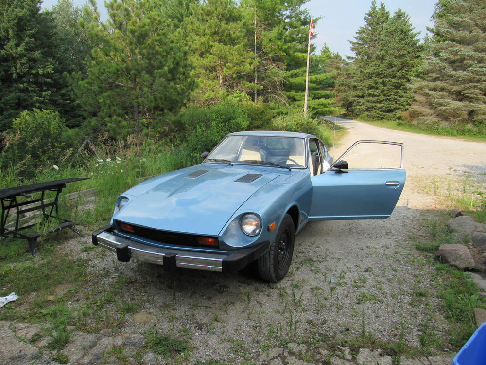

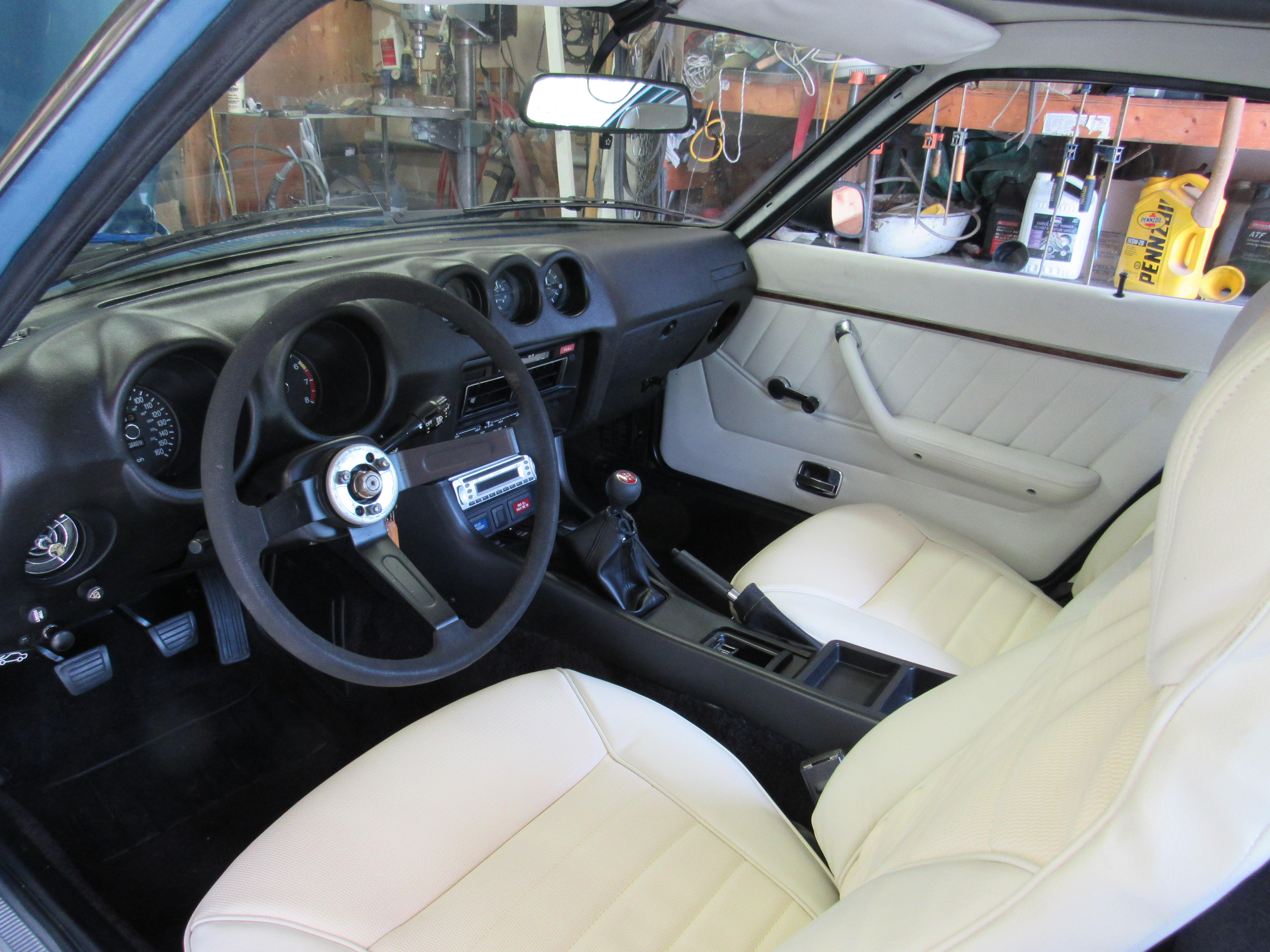

July 26, 20195 yr Author comment_580508 She's road worthy! Just took it out for an illegal run up my back road and it was beautiful. I had forgotten how nice a stock car is, so tomorrow I need to tweak the wheel alignment on the front and torque down the control arm bolts. I was hoping the rear end was going to sink a bit more and that 2 mile drive did the trick. Link to comment https://www.classiczcars.com/forums/topic/60126-just-what-the-doctor-ordered-1977-280z/?&page=23#findComment-580508 Share on other sites More sharing options...

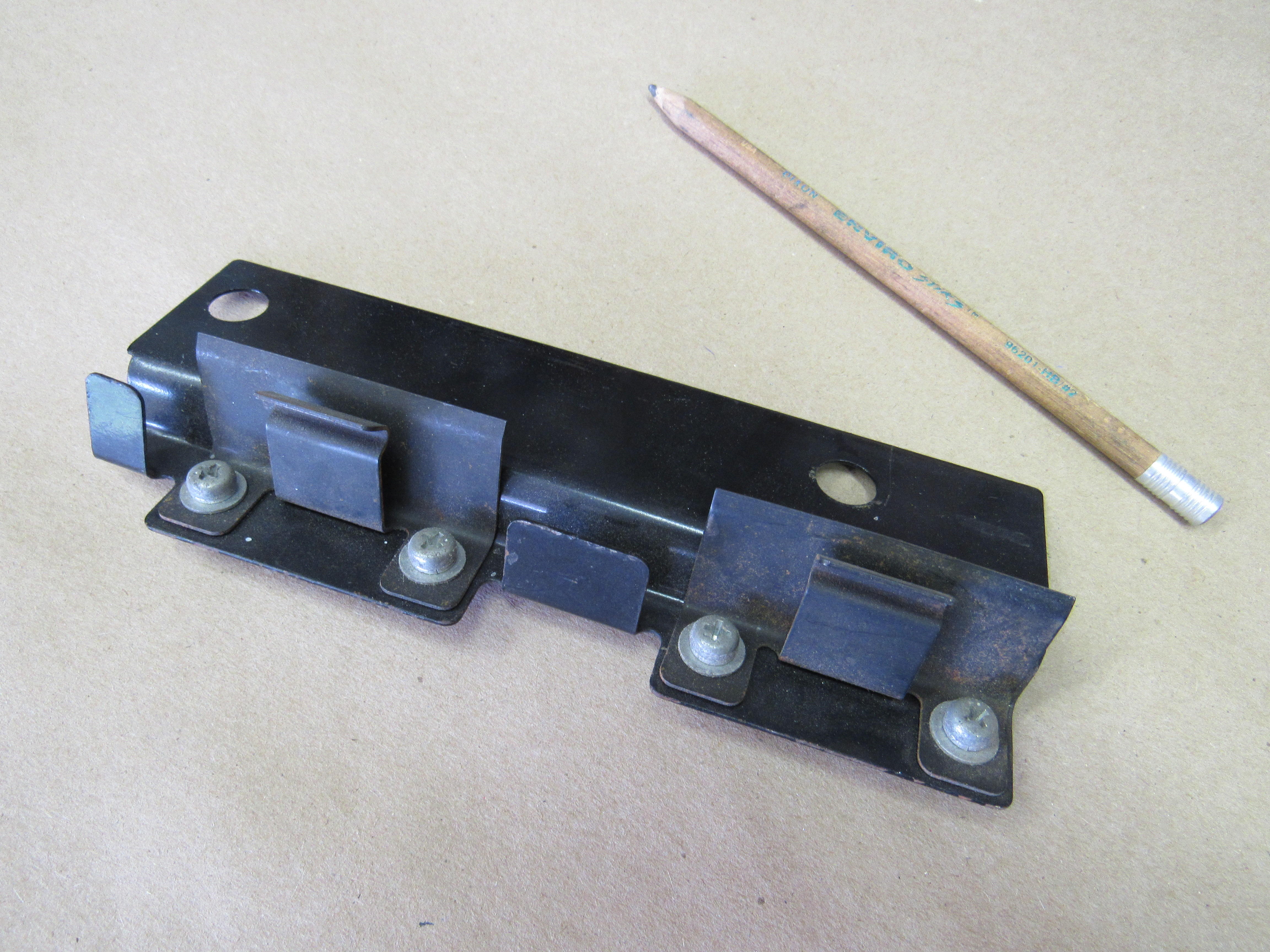

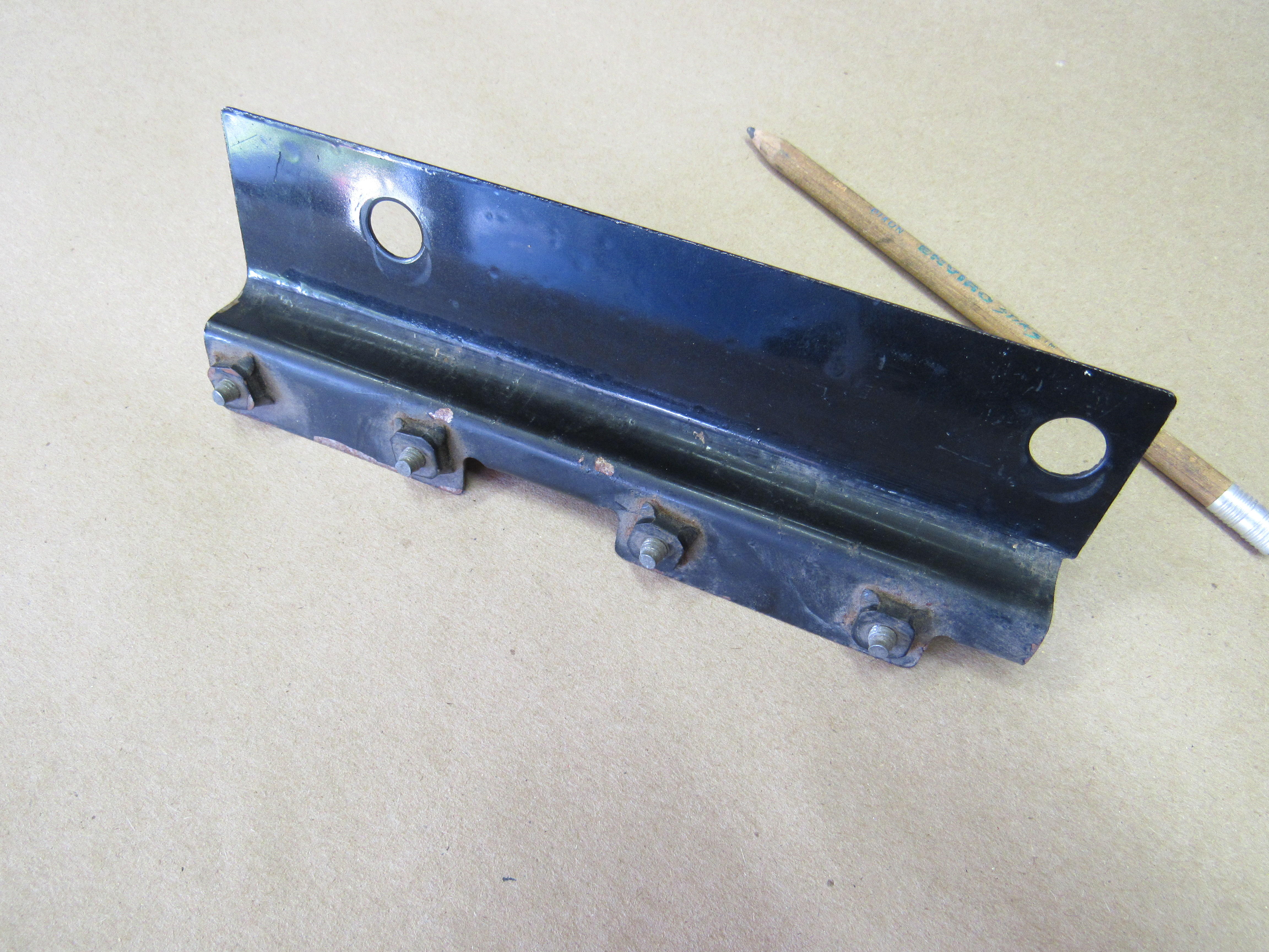

July 27, 20195 yr Author comment_580602 Last part in the box to be installed, any ideas? I thought it was somewhere under the dash on the P/S but can't find any logical spot for it. Link to comment https://www.classiczcars.com/forums/topic/60126-just-what-the-doctor-ordered-1977-280z/?&page=23#findComment-580602 Share on other sites More sharing options...
July 27, 20195 yr comment_580616 That's an odd piece. I wonder what the clips are supposed to hold. I agree with somewhere under the dash. After dinner, I'll do some spelunking in my car. Link to comment https://www.classiczcars.com/forums/topic/60126-just-what-the-doctor-ordered-1977-280z/?&page=23#findComment-580616 Share on other sites More sharing options...

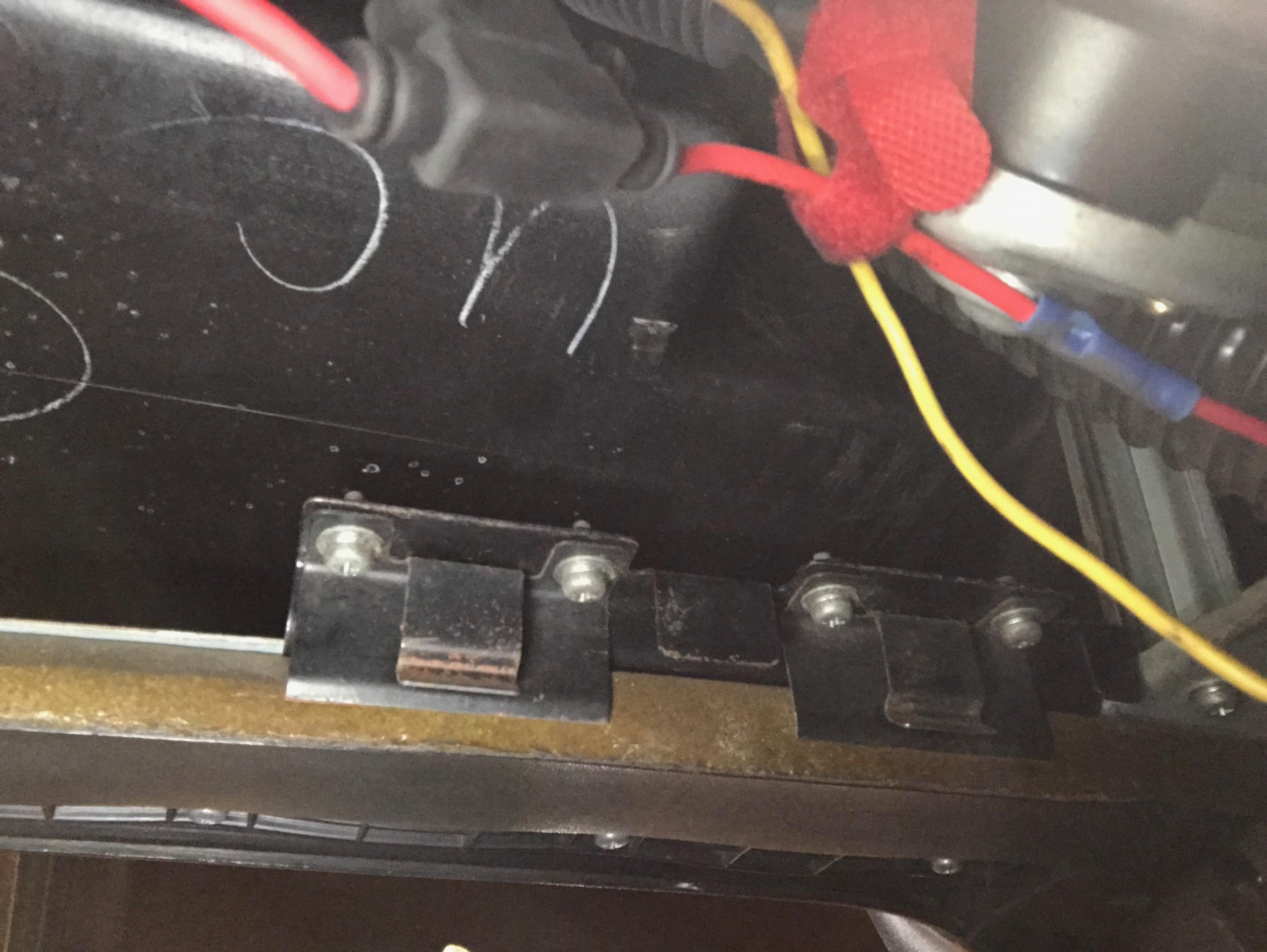

July 28, 20195 yr comment_580624 Sad to say that I could not find it anywhere on my car. I searched under the passenger and drivers side dash and around the tail light area with not even a hint. I even looked for it on a photo from a 78' I did last summer, granted it was missing parts to begin with. The screws and patina look correct, but I have no recollection or idea where its would go. Sorry... Edited July 28, 20195 yr by gwri8 added photo Link to comment https://www.classiczcars.com/forums/topic/60126-just-what-the-doctor-ordered-1977-280z/?&page=23#findComment-580624 Share on other sites More sharing options...
July 28, 20195 yr comment_580626 My guess would be a bracket that helps hold the passenger side finisher panel in place right above the passengers knees. Bolts to the bottom lip of the dash right below the glove box and the plastic finisher panel clips into it. That finisher panel is then screwed into place with a screw on each end for the final lock. I did not crawl inside my car to verify... Link to comment https://www.classiczcars.com/forums/topic/60126-just-what-the-doctor-ordered-1977-280z/?&page=23#findComment-580626 Share on other sites More sharing options...
July 28, 20195 yr comment_580633 Probably here somewhere - http://www.carpartsmanual.com/datsuns30/Datsun-Z-Index/Body-260Z-280Z/2-Seater Link to comment https://www.classiczcars.com/forums/topic/60126-just-what-the-doctor-ordered-1977-280z/?&page=23#findComment-580633 Share on other sites More sharing options...
July 28, 20195 yr comment_580640 24 minutes ago, Captain Obvious said: My guess would be a bracket that helps hold the passenger side finisher panel in place right above the passengers knees. Bolts to the bottom lip of the dash right below the glove box and the plastic finisher panel clips into it. That finisher panel is then screwed into place with a screw on each end for the final lock. I did not crawl inside my car to verify... You must be in management CO, you made me crawl! ?. Note to self, Don't eat pasta and then get under the dash..... Link to comment https://www.classiczcars.com/forums/topic/60126-just-what-the-doctor-ordered-1977-280z/?&page=23#findComment-580640 Share on other sites More sharing options...
July 28, 20195 yr comment_580644 Yup!! There it is! Thanks much for the confirmation! 4 minutes ago, gwri8 said: You must be in management CO, you made me crawl! ?. So what you're saying is that I've got people who do that for me? Haha!!! Link to comment https://www.classiczcars.com/forums/topic/60126-just-what-the-doctor-ordered-1977-280z/?&page=23#findComment-580644 Share on other sites More sharing options...
