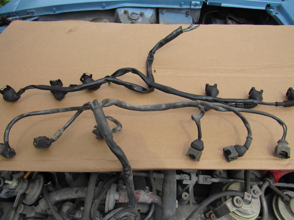

Oh, and I used VW connectors on my injectors as well, but I used a different version with end release clips instead of the one single side release. I found I liked them much better for the injectors, but I liked the side release in the other locations better. I used to have a pic posted, but photobucket extorted it out of existence. I'll get a new pic loaded up when I get a chance.

The connector caps for the fuel injectors are working but in rough condition so I was going buy new ones and splice them in but @240260280 suggested going to the wreckers and look for Audi/VW. I got enough to change every connector on the car for $10.  Passat's had all the right stuff.
That is a very nice set of connectors.  Proper spacing and everything.  You might consider using a male and female connector (Weatherpack is popular, I think) at the end that you cut so that you can just remove all six as an assembly whenever needed.  Much easier than splicing all six separately.  Looks like it was made for it.

Good idea ZH but I had them spliced in by the time I read your post.

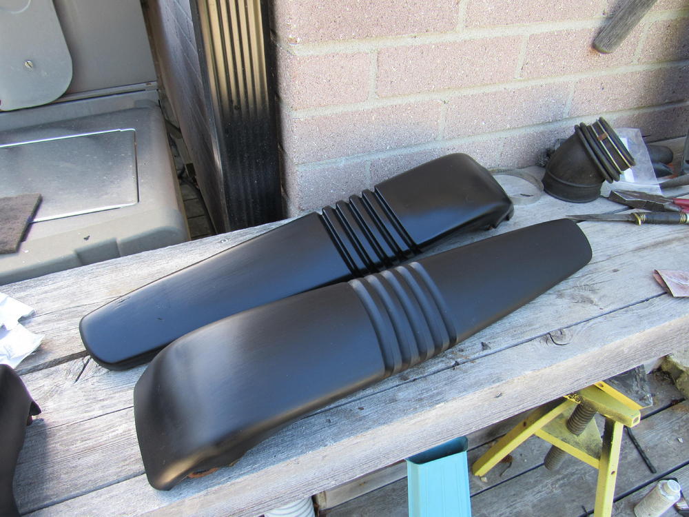

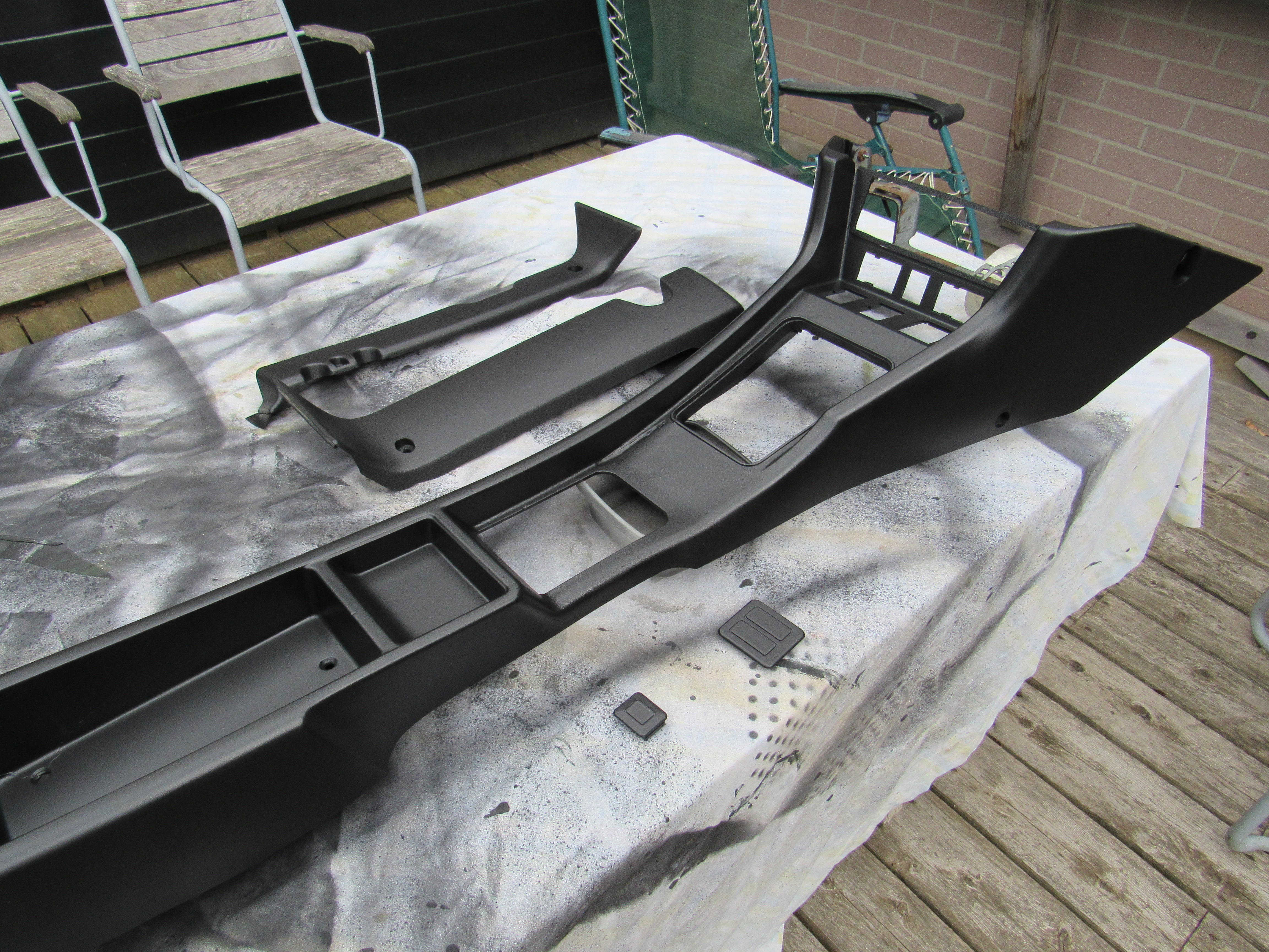

Getting some surface finishing done, console was lightly sanded with 240 grit a 2 coats of SEM Landau black,

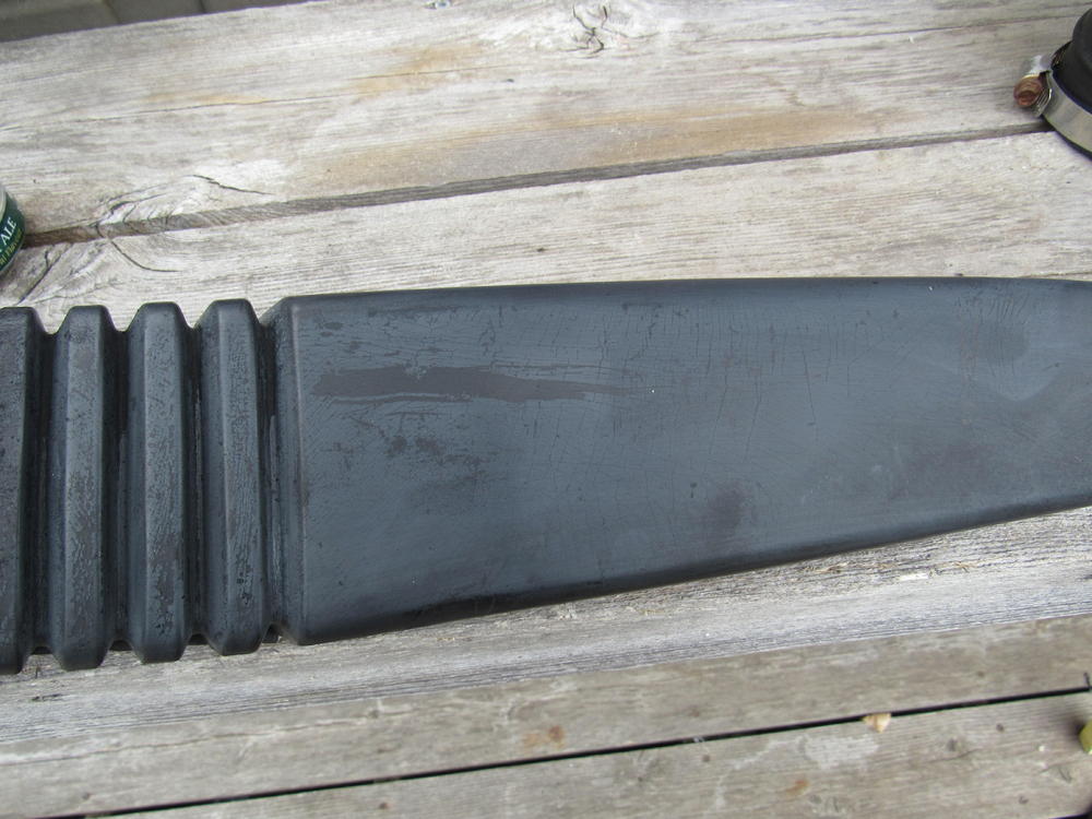

All of the bumper rubber looks pretty sad, can't tell if a PO painted them at some point or that is just age but sanded all the rubber with 240 grit them burnished with the 3M Grey scuff pads then a couple of coats of Auto Glim tire dressing,
