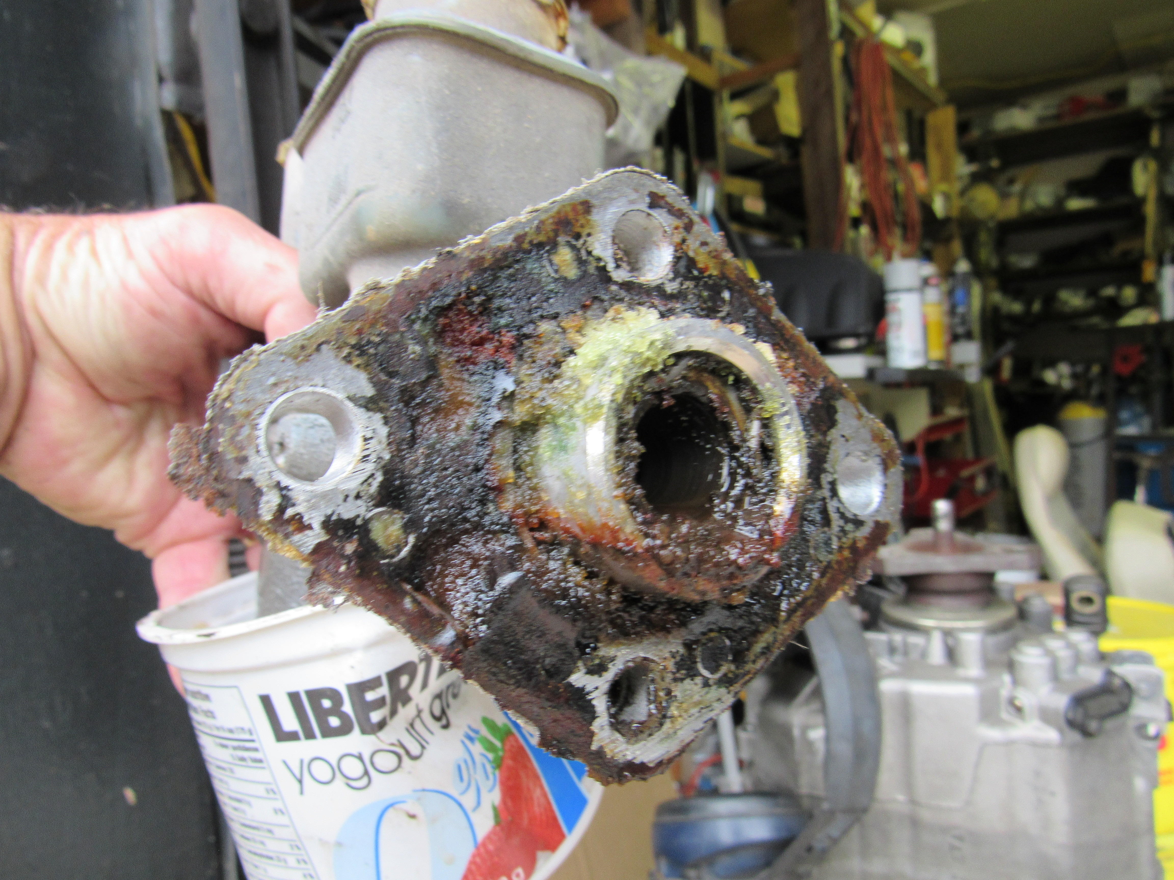

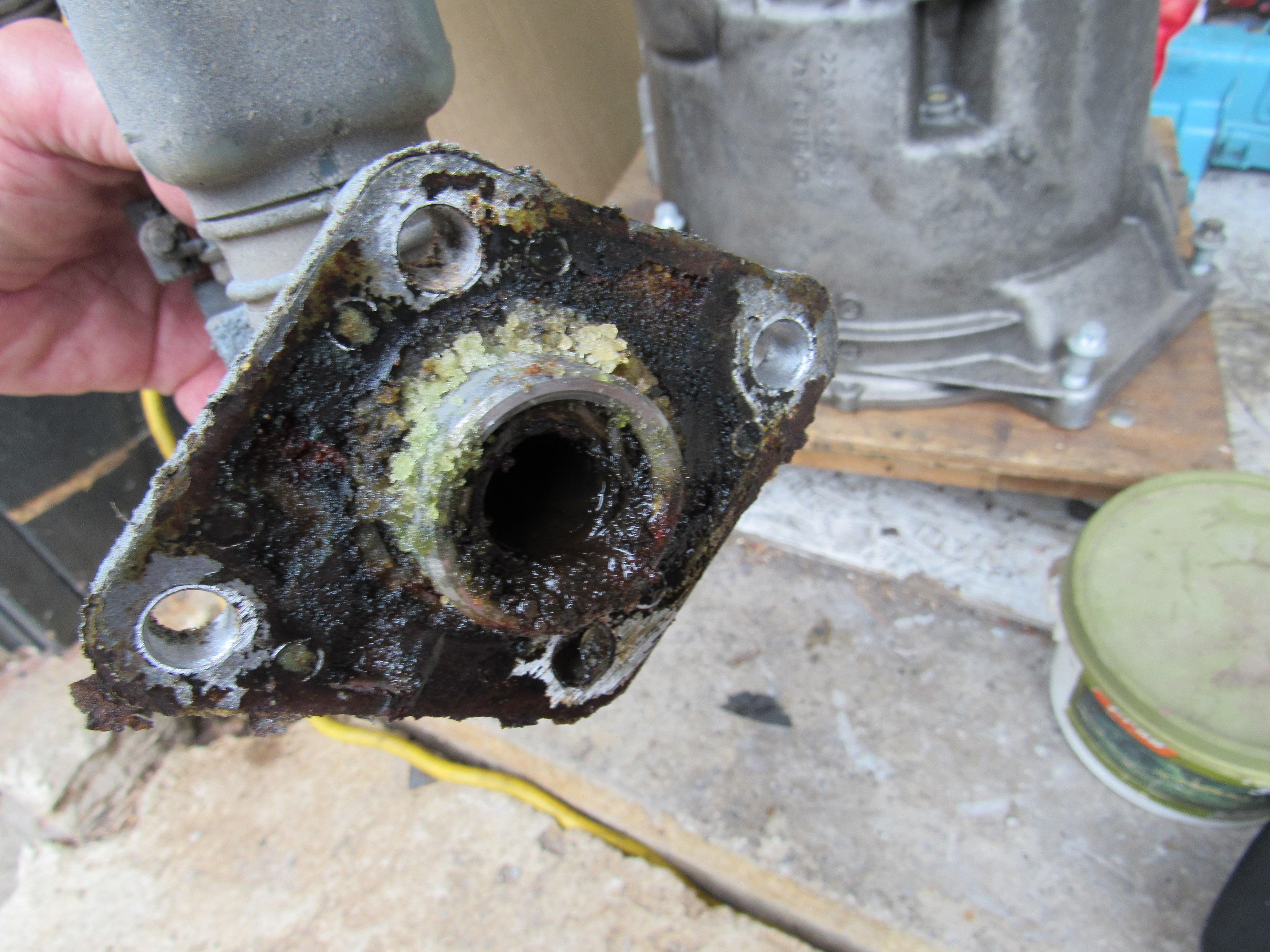

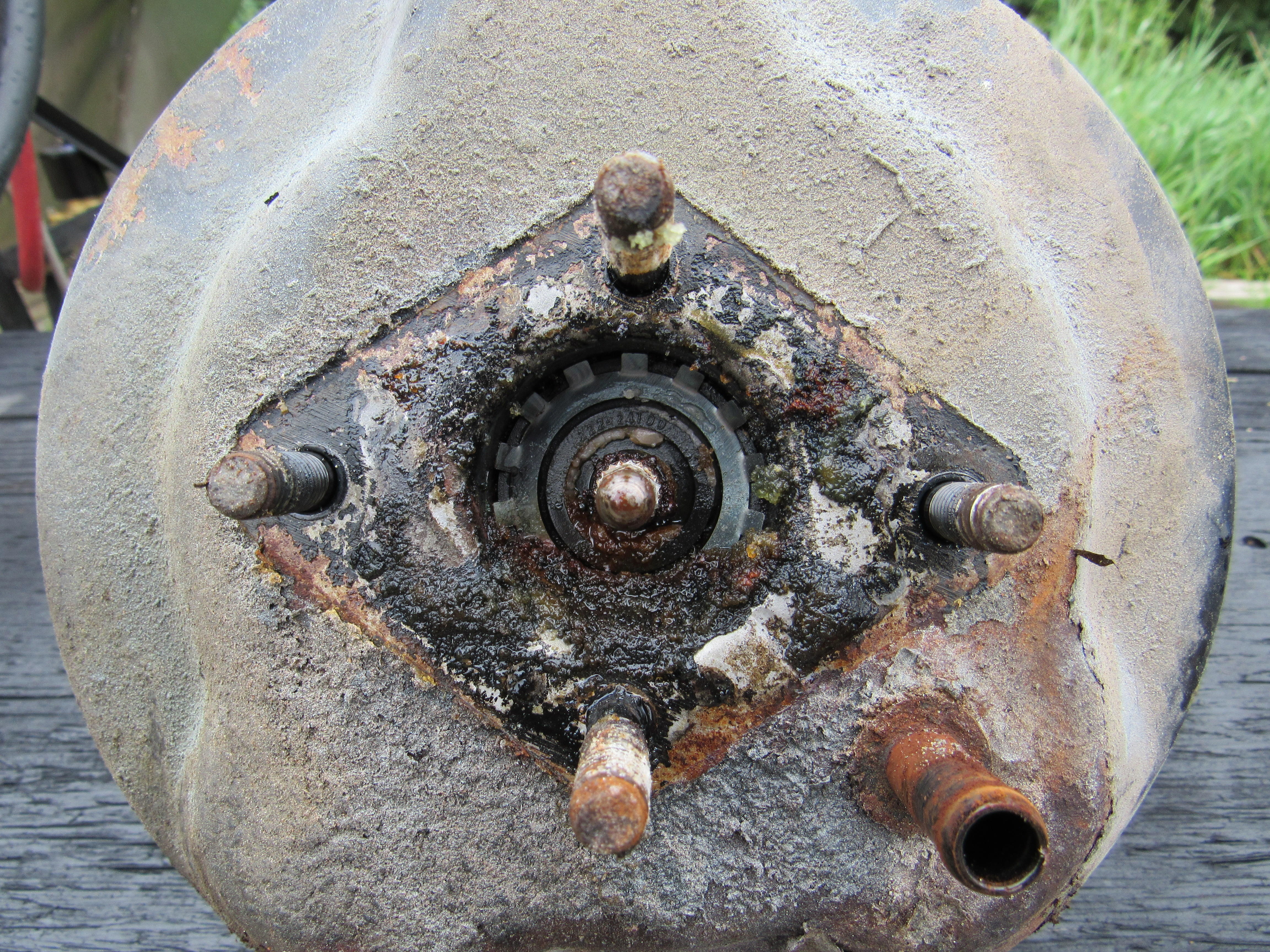

56 minutes ago, grannyknot said:
I got into the Brake Master, booster and proportioning valves today, hope you are not eating while reading this, pretty sure I'm the first one to remove the brake master.
Dude! That's pristine!
Strangely enough when I disassembled the master cylinder and cleaned out all the sludge/crap, the walls of the bore looked pretty good, but I'll lobe it on to the junk heap, a new M/C is only $90 so hard to argue with that. I can just imagine what the wheel cylinders and clutch slave are going to look like ?
It looks terrible, but that sludge might have protected the system against corrosion and pitting. Fingers crossed.

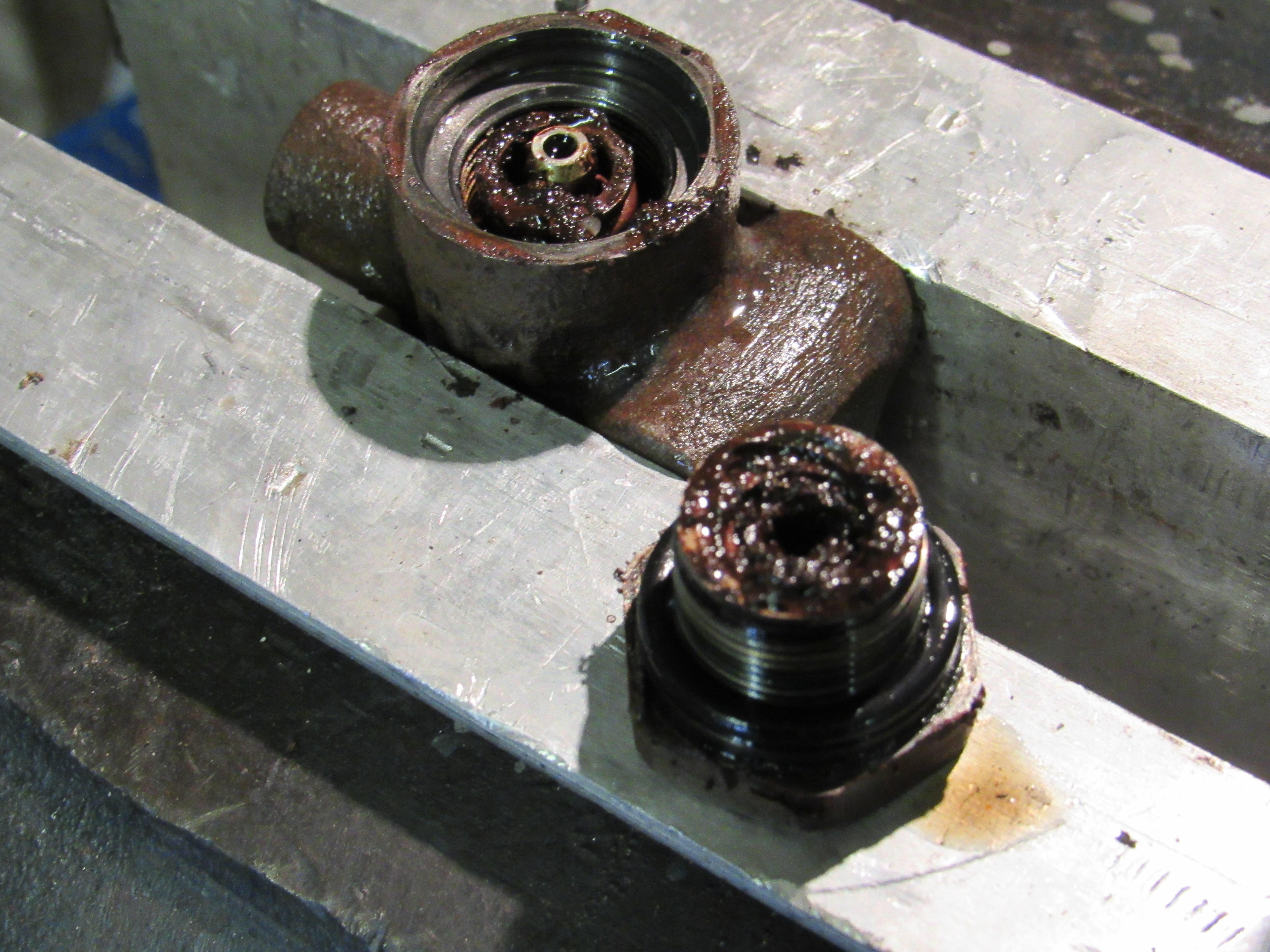

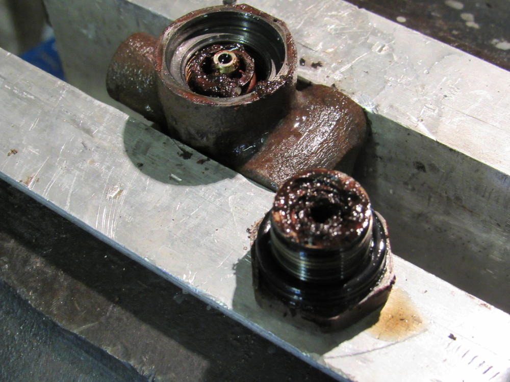

You can buy a simple seal kit for the early 240Z proportioning valve. It has a couple of parts that fit this one. Unfortunately I don't think anyone makes a kit for these.
The brake switch is an easy fix, if the bore is not pitted. I cleaned mine by cutting a slot in a plastic tube and a strip of fine emery paper.
Just went thru the same thing , but my 77 wasn’t as narley . The bore was pristine and the seals were very pliable - I’m going to run it. The calipers and wheel cylinders will get changed .
