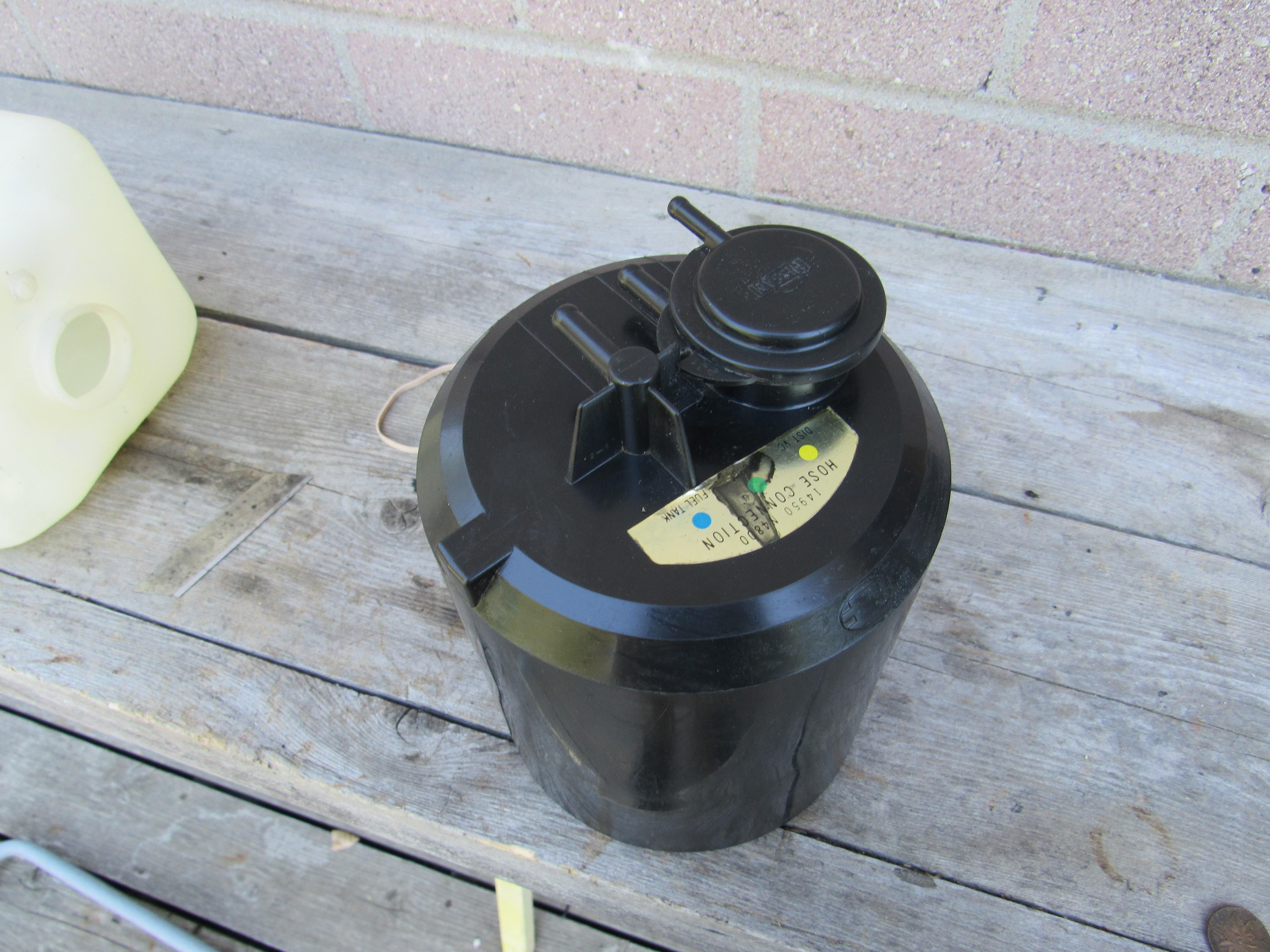

This tucks in under that bar running across from left to right. MSA sells it. It's the only "canister" filter I've ever replaced on my 77. I'm not sure that the charcoal one can be cleaned. Good question though.
Carbon Canister Filter, 70-89 Z/ZX
Code: 18-9061
Price:$13.98
Code: 18-9061
Price:$13.98

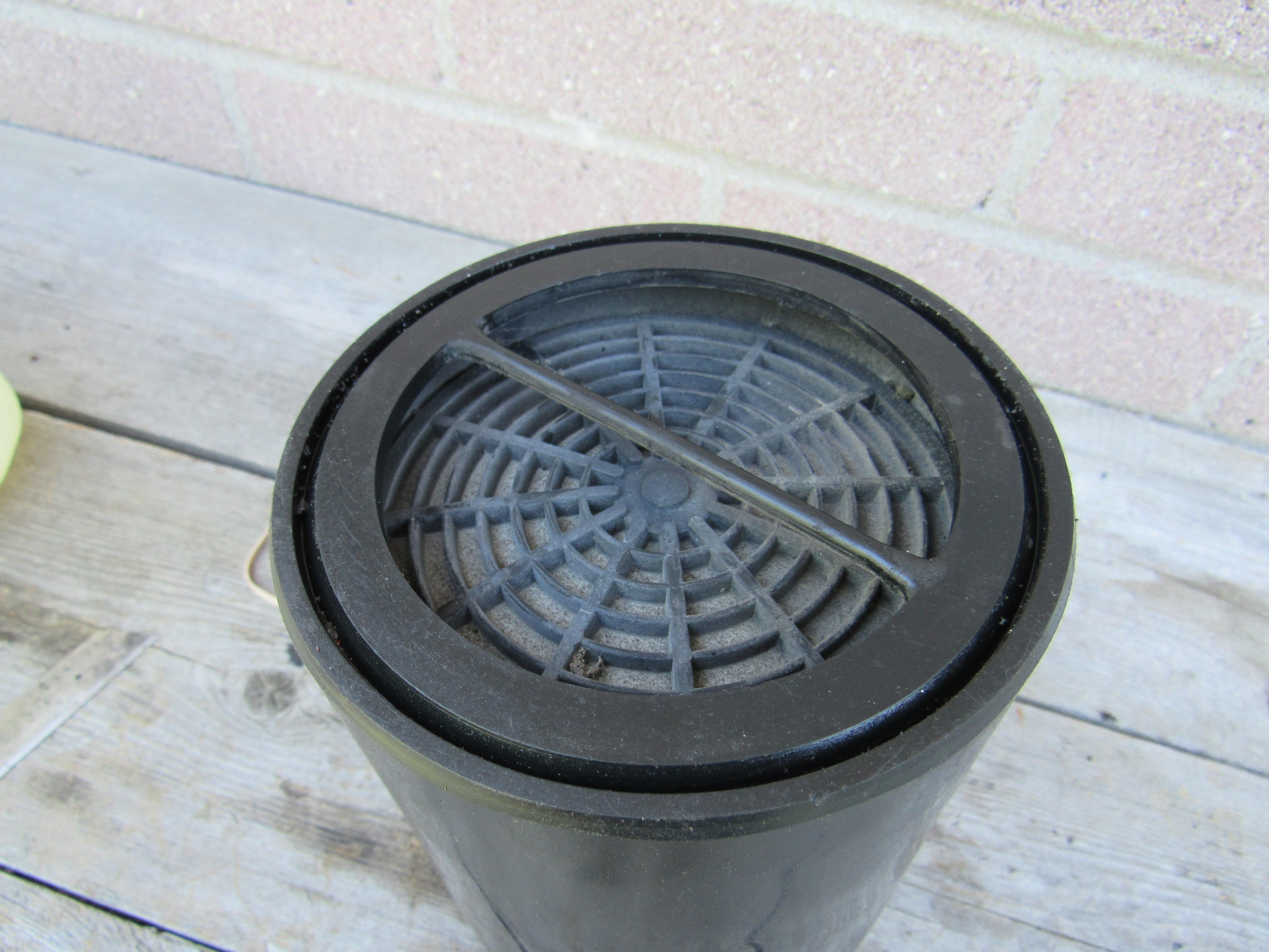

So that yellow pre-filter is missing from my canister, I wonder how long it has been gone.  I might try to drip some ABS solvent in that seam around the outside to see if that cap loosens a bit.
Mice used your old filter to build a nest a very long time ago.
AC Delco claims to have a replacement available on Rockauto for $1.48. Look for ACDELCO part number A478C.
I've heard that Rockauto is no fun in Canada though. Shipping costs are high?
And forgot... I think dripping ABS solvent down into that crevice is a really risky move. I think that if it wasn't securely glued before you do that, it most certainly will be afterwards!   LOL

I read this on an aquarium maintenance site for cleaning carbon filter:
1. Run warm water through the charcoal to rinse out impurities if using loose charcoal. If using charcoal cartridges, allow warm tap water to run through the cartridge for several minutes.
2. Hold the rinsed charcoal up near your ear. If you hear a sort of subtle crackling or popping noise emanating from the charcoal, place it back into the filter. If you hear nothing, the charcoal is no longer activated and should be replaced with fresh carbon.
So maybe try back flowing warm water by pumping it into the outlet on the top with valve held open by vacuum.
If it has inhaled oil over the years, some soapy water may help remove the coating on the charcoal.
