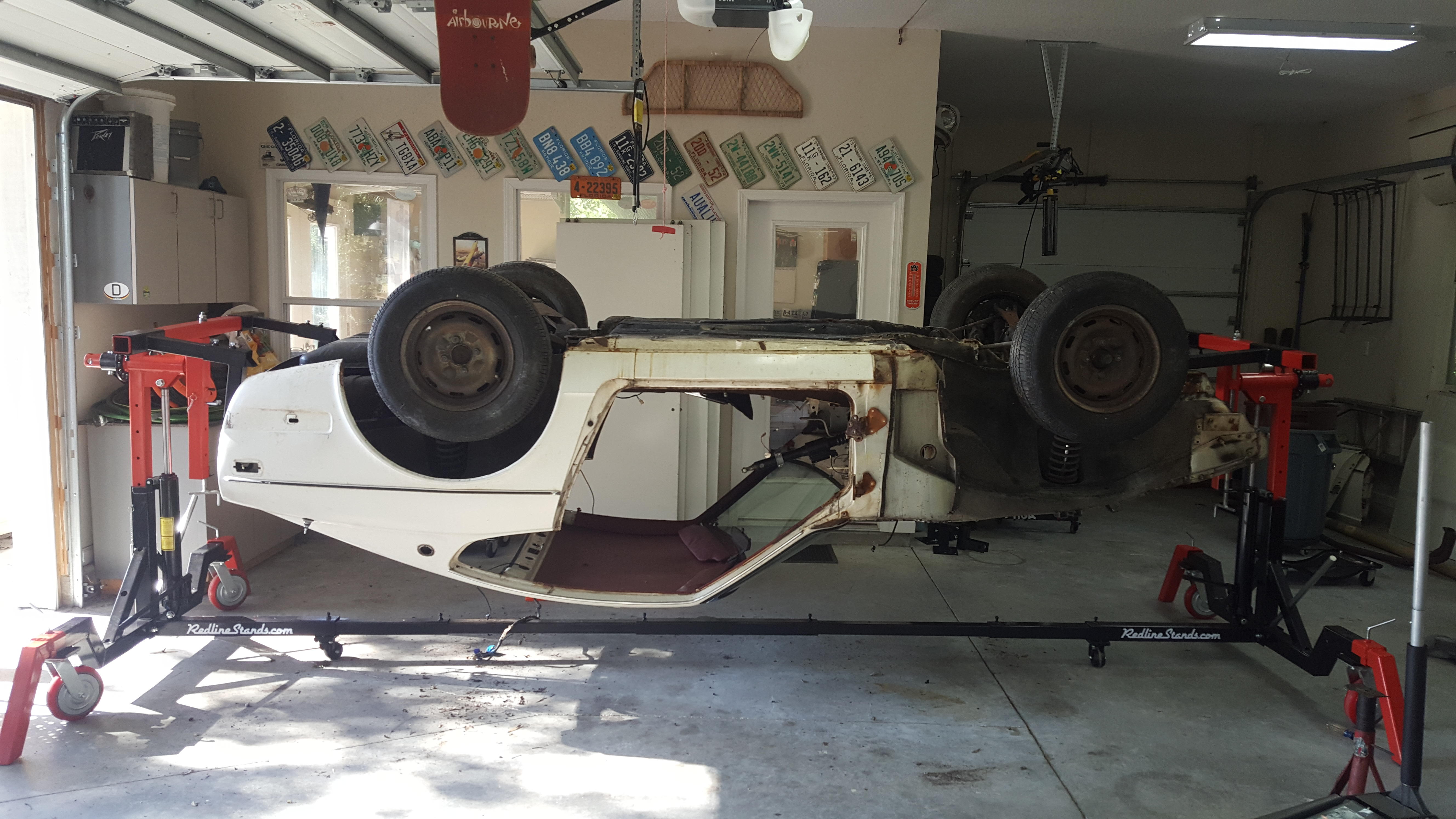

December 10, 20186 yr comment_563430 On 6/13/2018 at 6:45 AM, gotham22 said: I really would like to do it myself. My concern is I don’t have a garage (car is always covered in the driveway).  Not sure what fire precautions I need to take welding in my driveway next to my house. I don’t have a ton of room  I actually love love trying to do new things and I have been reading up on mig welding. Plus thI satisfaction of doing something yourself is amazing.   I am a mechanic, but not a restorer, and I have decided to weld and fix all my rust issues on my 240 and fully restore it. I have the room to do it. I can see if you dont have the room to do it may make it more daunting, but where theres a will theres a way. Link to comment https://www.classiczcars.com/forums/topic/60184-rust-advice-78-280z/?&page=12#findComment-563430 Share on other sites More sharing options...
December 10, 20186 yr comment_563431 10 minutes ago, DC871F said: I am a mechanic, but not a restorer, and I have decided to weld and fix all my rust issues on my 240 and fully restore it. I have the room to do it. I can see if you dont have the room to do it may make it more daunting, but where theres a will theres a way. My apologies if we covered this somewhere else, but I don't like to hang the car with all the suspension on it. It nearly doubles the weight of the car and adds a lot more stress on the attachment points. My 2 cents Link to comment https://www.classiczcars.com/forums/topic/60184-rust-advice-78-280z/?&page=12#findComment-563431 Share on other sites More sharing options...
December 10, 20186 yr comment_563433 32 minutes ago, Patcon said: My apologies if we covered this somewhere else, but I don't like to hang the car with all the suspension on it. It nearly doubles the weight of the car and adds a lot more stress on the attachment points. My 2 cents We did, and you put a little fear in me so its all good now. I looked at the attach points and nothing moved. Link to comment https://www.classiczcars.com/forums/topic/60184-rust-advice-78-280z/?&page=12#findComment-563433 Share on other sites More sharing options...
