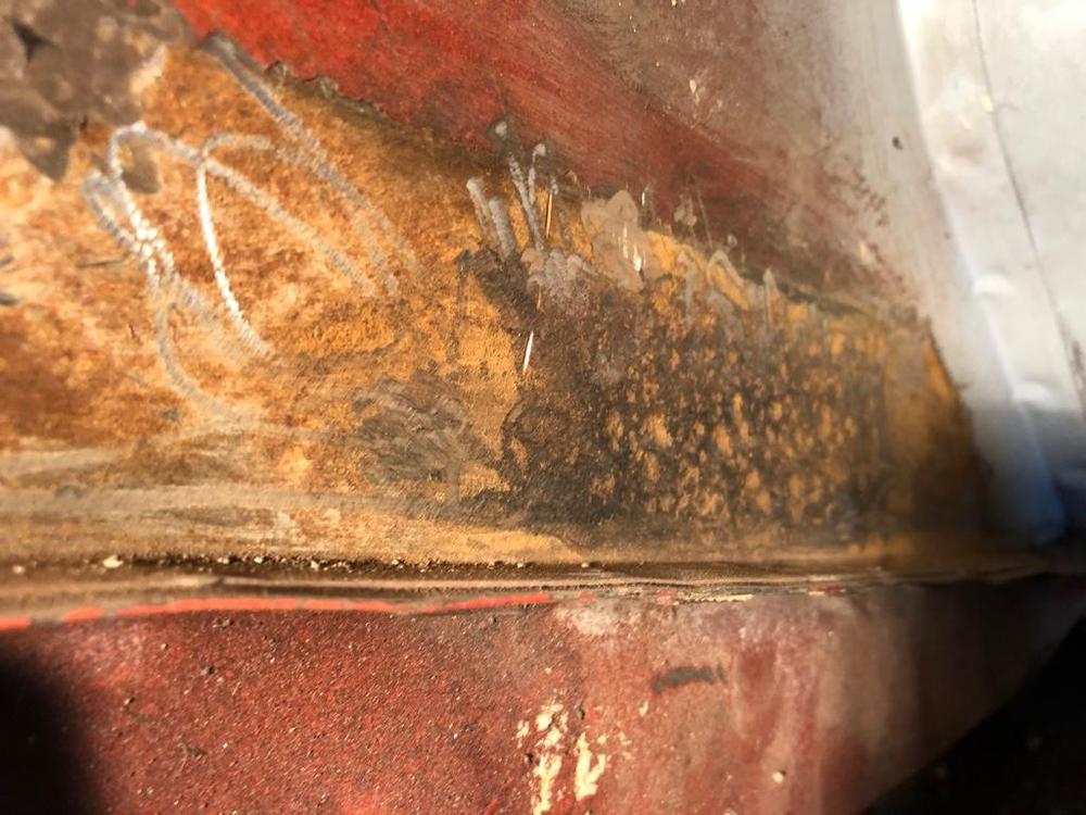

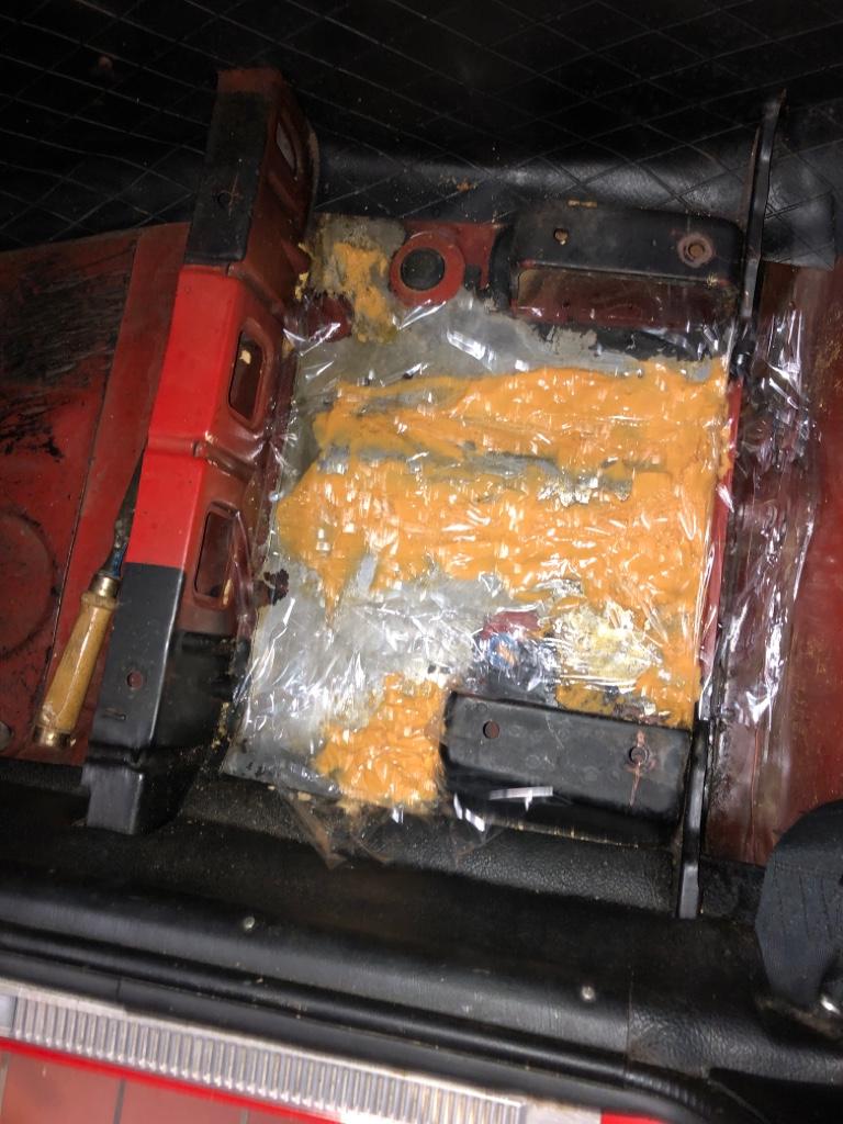

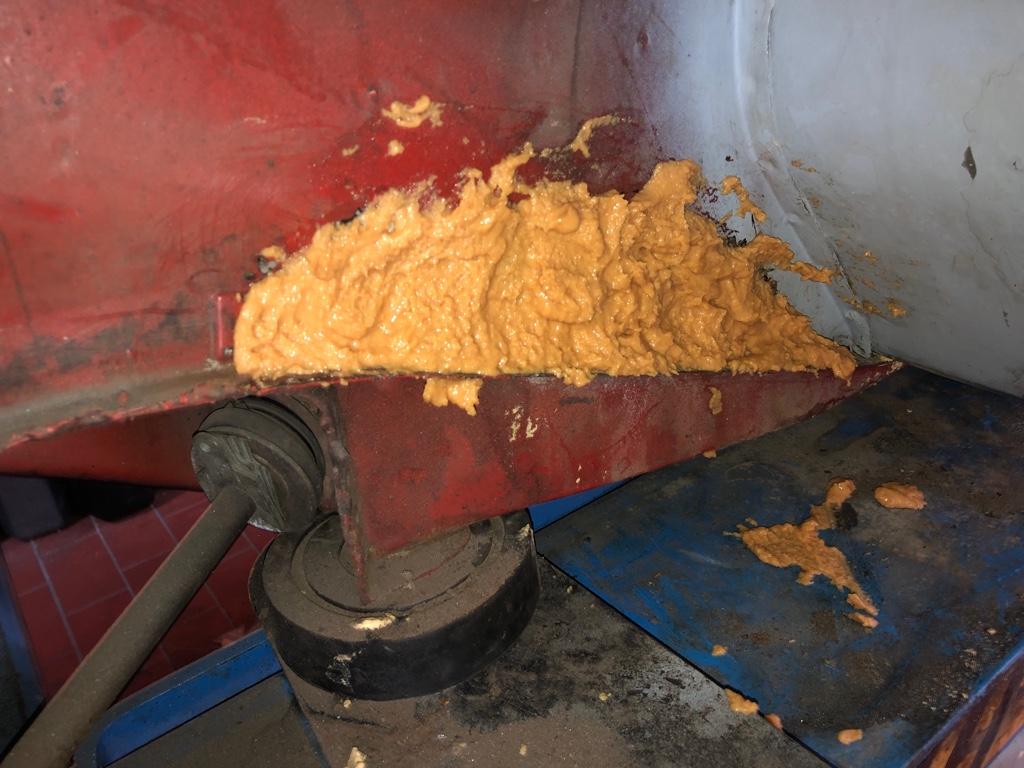

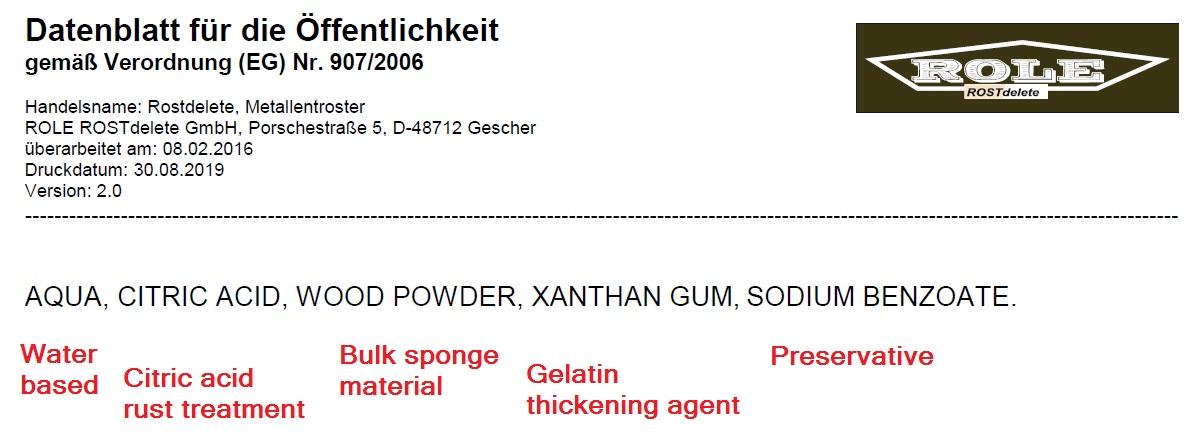

There is a scooter shop in England that sells it, https://www.scooter-center.com/en/rust-remover-rostdelete-1000g-7676573
but the shipping isn't cheap, haven't been able to find any distributors in NA yet.  Citric acid isn't that hard to get a hold of,  maybe I'll try some garage chemistry?
Honestly I'm not sure any garage chemistry is even warranted. My read on the whole thing is all that stuff is (is) a rust converting acid suspended in a bulky spongy gelatinous base material that slows down evaporation. The preservative is necessary because the citric acid will harbor critters over time and "spoil" (probably smell bad and lose effectiveness).
But the point is.... It's a rust converting acid in a gelatinous bulk material to slow evaporation. I believe there are lots and lots and lots of phosphoric acid based materials on the market available at this side of the globe.
My (own untested) suspicion is that I bet the phosphoric based stuff would work better, but is less safe to use and potentially worse for the environment. I suspect the citric acid based stuff is uber-safe and all that. From the list of ingredients, it looks like you could eat it. But that doesn't mean it works better, and in fact, most times the worse something is for you and the environment, the better it works.
Is there some reason people would believe that citric acid based compound would be more effective?
