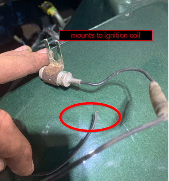

May 2, 20213 yr Author comment_620923 Guys, anyone know how to fix the BCCD wire? Or do I need to find a new solenoid? Also, thought I'd share a tip. I needed to do some touch up painting in the engine bay. I bought a Master Airbrush Model G22 on amazon. It was 25 bucks and it works great. I highly recommend Link to comment https://www.classiczcars.com/forums/topic/60184-rust-advice-78-280z/?&page=22#findComment-620923 Share on other sites More sharing options...
May 2, 20213 yr comment_620928 I’ve got two that are not quite as separated and I’ve thought about getting/using some liquid electrical tape Edit: I can’t remember the brand I used before for something different, but it was thick and dried to a soft rubber consistently kinda like RTV/silicone. I thought about using Plasti Dip and just noticed they make a electric tape version.Sent from my iPhone using Tapatalk Link to comment https://www.classiczcars.com/forums/topic/60184-rust-advice-78-280z/?&page=22#findComment-620928 Share on other sites More sharing options...
May 3, 20213 yr Author comment_620981 thanks mailnome, I will give it a try. Hoping the wire itself still works. fingers crossed Link to comment https://www.classiczcars.com/forums/topic/60184-rust-advice-78-280z/?&page=22#findComment-620981 Share on other sites More sharing options...

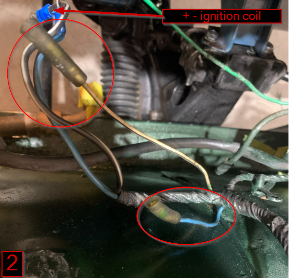

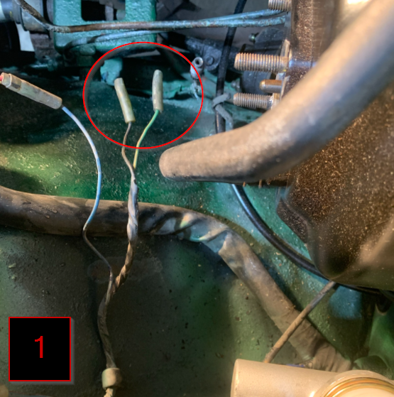

May 10, 20213 yr Author comment_621374 Making great progress getting all the engine parts back together. Ran into a couple of wiring questions, hope you guys can help 1. I have two bullet connectors near the brake master cylinder and I do not know where they connect to 2. where do the white and blue wires with bullet connectors go to? 3. this wire is broken and I am not sure where it goes Link to comment https://www.classiczcars.com/forums/topic/60184-rust-advice-78-280z/?&page=22#findComment-621374 Share on other sites More sharing options...

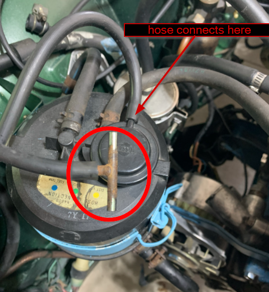

May 10, 20213 yr Author comment_621376 One more question regarding the charcoal canister. Does anyone know what connects to this t-fitting? Link to comment https://www.classiczcars.com/forums/topic/60184-rust-advice-78-280z/?&page=22#findComment-621376 Share on other sites More sharing options...
May 10, 20213 yr comment_621378 The distributor's vacuum advance and the ported vacuum source on the bottom of the throttle body. Ported (throttle blade controlled) vacuum runs both of those. Edited May 10, 20213 yr by Zed Head Link to comment https://www.classiczcars.com/forums/topic/60184-rust-advice-78-280z/?&page=22#findComment-621378 Share on other sites More sharing options...
May 10, 20213 yr comment_621379 Mine's a '77 with a ZX distributor so no help with the last two questions and a maybe on #1 at the brakes. My green/yellow stripe goes to the proportion valve down low. Mine is unhooked and I'm almost positive it was done so the brake light inside the gauge would go off. There was another wire under the passenger's seat I unhooked to finally get it to quit burning. I check the fluid all the time and rarely drive it but when I do it has good braking for that old of a car. Not a big fan of caution (idiot) lights on the dash. Fuel, temp and oil pressure is all I care about. 👍 2 hours ago, gotham22 said: Making great progress getting all the engine parts back together. Ran into a couple of wiring questions, hope you guys can help 1. I have two bullet connectors near the brake master cylinder and I do not know where they connect to 2. where do the white and blue wires with bullet connectors go to? 3. this wire is broken and I am not sure where it goes Edited May 10, 20213 yr by siteunseen Link to comment https://www.classiczcars.com/forums/topic/60184-rust-advice-78-280z/?&page=22#findComment-621379 Share on other sites More sharing options...
May 10, 20213 yr comment_621381 Closer... Link to comment https://www.classiczcars.com/forums/topic/60184-rust-advice-78-280z/?&page=22#findComment-621381 Share on other sites More sharing options...
May 10, 20213 yr comment_621382 13 minutes ago, siteunseen said: My green/yellow stripe goes to the proportion valve down low. Brake warning switch Link to comment https://www.classiczcars.com/forums/topic/60184-rust-advice-78-280z/?&page=22#findComment-621382 Share on other sites More sharing options...
May 10, 20213 yr comment_621383 4 minutes ago, grannyknot said: Brake warning switch What does it warn me of? Link to comment https://www.classiczcars.com/forums/topic/60184-rust-advice-78-280z/?&page=22#findComment-621383 Share on other sites More sharing options...
May 10, 20213 yr comment_621384 4 minutes ago, siteunseen said: What does it warn me of? That one of your brake line circuits has a leak and now you are using the other circuit to do all the braking. Link to comment https://www.classiczcars.com/forums/topic/60184-rust-advice-78-280z/?&page=22#findComment-621384 Share on other sites More sharing options...
May 10, 20213 yr comment_621385 7 minutes ago, siteunseen said: What does it warn me of? If one of the two circuits fails Link to comment https://www.classiczcars.com/forums/topic/60184-rust-advice-78-280z/?&page=22#findComment-621385 Share on other sites More sharing options...
