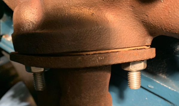

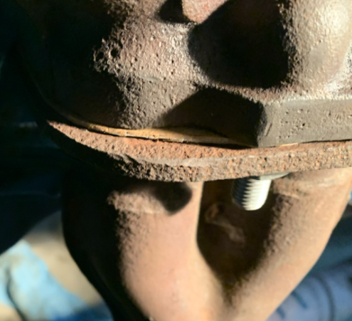

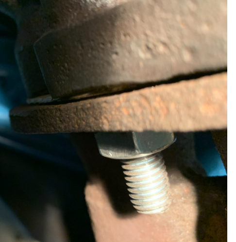

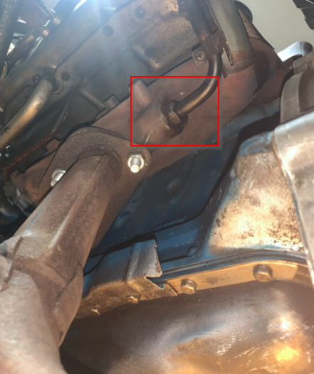

Some more info and pics.  I have an exhaust leak as I see smoke.  I cant tell if it is from the exhaust down pipe connection or possible the connection that leads to the EGR. Not sure if this is a separate issue.
Exhaust leaks can make a ticking sound. And the injectors are supposed to click. So between all that and the solid lifters going clickety-click, I can't tell if the noises on the video are a big deal or not.
I suggest look into fixing the exhaust leak(s). Rule that out and then go from there.
