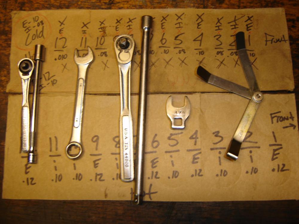

A couple of suggestions you may already know but they helped me over the years. Our motors are not straight up in the engine bay, slight tilt to the passenger's side. If you mark the center of the cam towers and use that as your up reference it'll be more precise. Also you can get two to come up at a time so that helps speed things up when you do them hot. They're spread out though so I started making a mark off list on a piece of a case box for something like beer. :rolleyes: Anyhow write it out and place it under the passenger's wiper blade and X them off as you do them. Here's a picture of what I'm talking about. Cold setting on top and the hot is the bottom one. It may help since you say the clicking is better after your second adjustment. Good luck with it, that ticking sound drive's me nuts.
