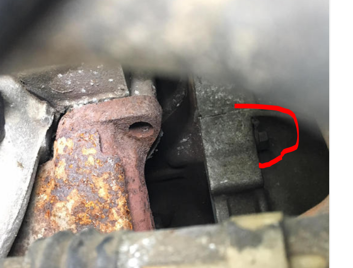

Hey guys, I am ready to pull the engine.  it is fully detached.  I have a lift bracket on the front passenger side but do not know where to connect the leveler to on the drivers side.  I read a lot of post about a bolt hole towards the firewall but I don't see it.  I see what looks like a hole where a bolt goes but it is not threaded and nothing can be attached there.  See pic.    So where can I attach the leveler to that will be string enough?
There should be a bolt with a hanger on it there.  Looks like your bolt broke off or something worse.
You could use a transmission bolt.  Same area, about the same balance.

If extracting the broken bolt wont work (or the threads are gone beyond repair) here is a trick:
Drill the bolt with a 7/16 bit, tap it in 1/4 npt, get a solid pipe plug from lows ect (the kind that is fastened with an allen key)
Now insert the plug, if its not flush with the head use a side grinder to make it flush with the head. now all that is left is to drill and tap it in 8mm.
Works great if you don't have a time sert kit.
The threads are in the head.  A stud or a bolt would be there, but they often break off.  Your worst case would be that somebody broke the casting in the head.  You'll know when you get it apart and get a better look.
