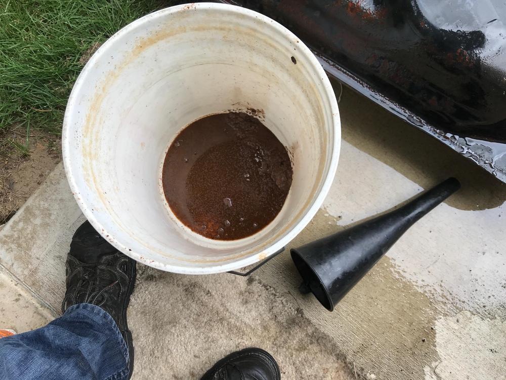

After days of trying white vinegar , agitation , SS cable to unclog the return lines I have the tank clean. I went ahead and did the POR -15 tank seal kit. This was battle but hopefully the worst I’ll see on the 77 . I still have a lot of the fuel system to go thru, but the nasty tank job is done . I bought rebuilt injectors and now need to change every piece of hose in the engine and fuel system. I told the owner that this is where the car nickel and dimes you broke. I can’t even use the original fuel clamps because of the difference in size of the braided hose diameter . There goes another 25$ !
So far I’ve bought over 1500$ worth of parts and materials to get this beast going again. And I have no idea of the true shape of the motor? By appearances and inspection I think it’s okay. There’s so much to go thru with the EFI set up that you can’t just try and start it.

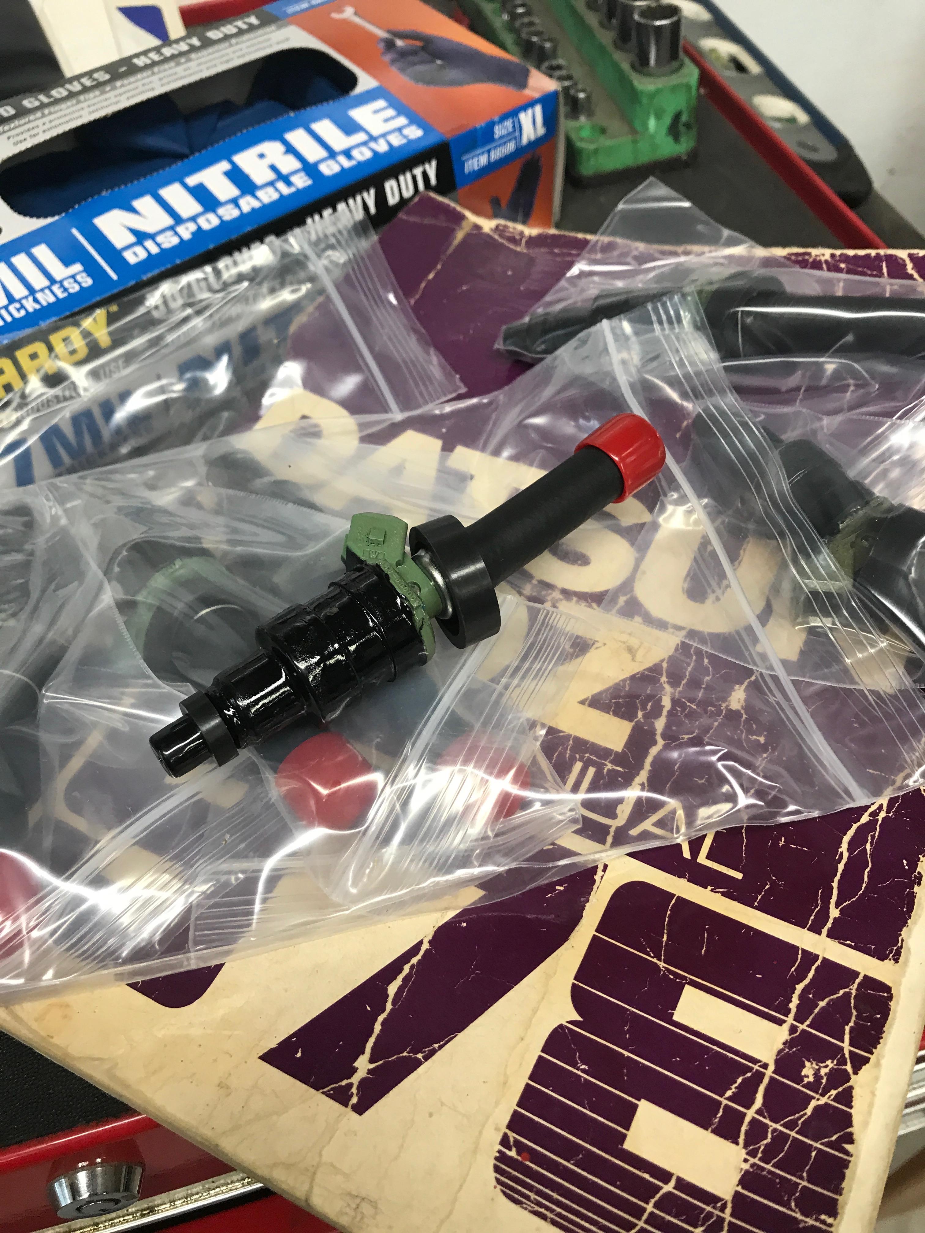

Cool projects. Clearly you'll be a busy guy! Couple of observations, comments, etc.
First, about the fuel injectors... I'm assuming that black painted injector is one of the rebuilt units? If so, I would take the paint off the nose. I don't know what kind of paint that is, but I question it's longevity in the very hot, fuel spraying environment while in use. And I don't think I want that paint dissolved or flaked off inside the engine. I'd rather have it come off first before I put the injector into service. I also wouldn't want paint where the vacuum seal is. I think I would strip the paint off as far back as to include the seal surface as well.

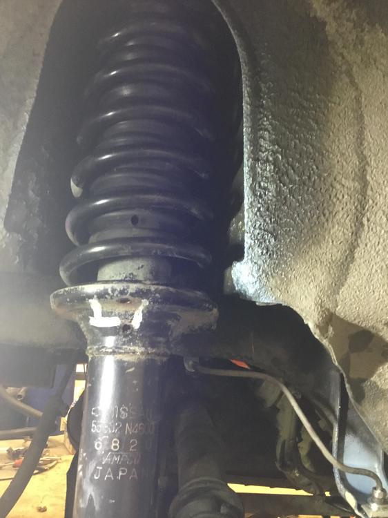

And second, I'm hard pressed to be convinced that is really just a 30K mile 77... Are you sure it's not 130K? I mean, it doesn't really matter since I'm not buying or selling, but if that's just 30K miles, it's certainly a HARD 30K.
I think it’s just neglect. The car sat outside in the elements for decades in the hot Nevada sun. Being under the car you realize that it has seen only 30k miles. The struts had/ has some kind of assembly markings( stickers)for left and right. The zinc is still pretty on the brake line brackets and hardware . I think the maintenance was done by hacks . Remember years ago when no one cared about these cars except they were a cheap import ?
Ill investigate the paint
