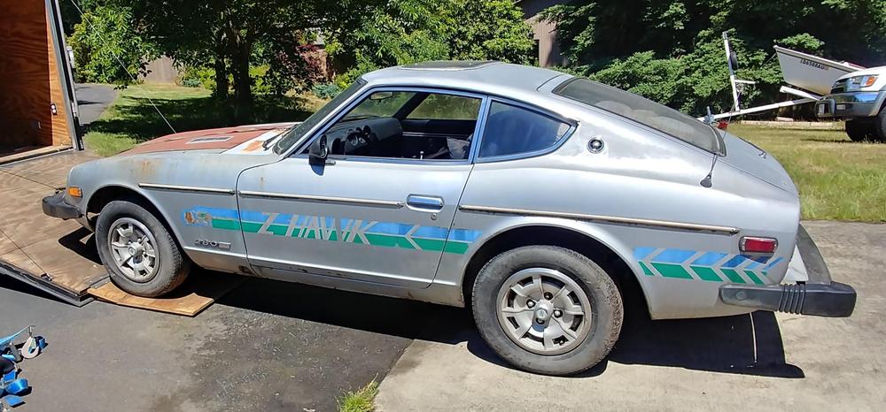

https://www.classiczcars.com/forums/topic/60307-new-280z-hawk-wish-me-luck/
I know....hate them but its what I have to work with. Somewhere on the ginormous list maybe I could remove and replace it but man, that's way down there. For now its more of "Stop any water intrusion and get it into my garage". Need to stop rust where I can.

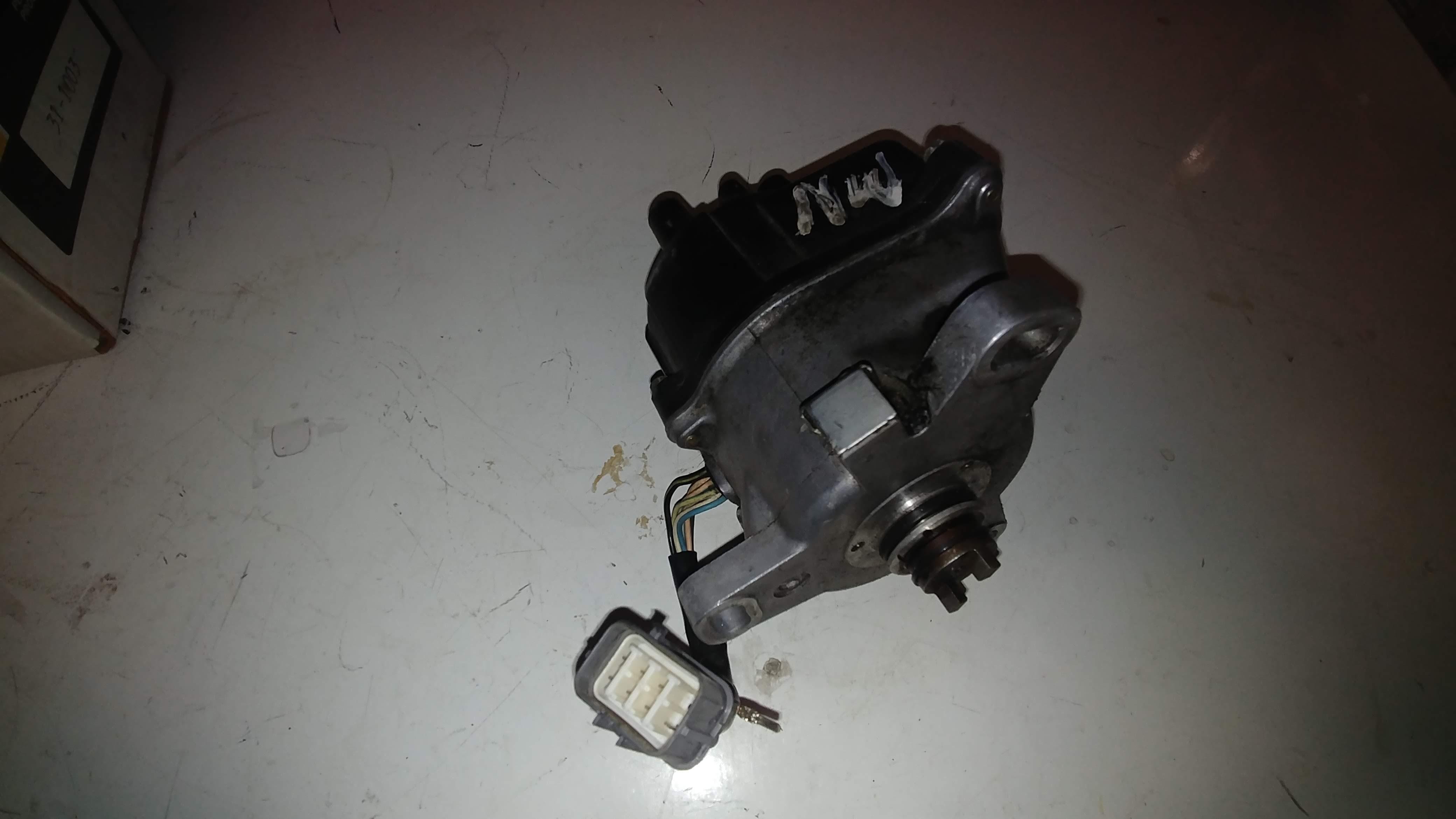

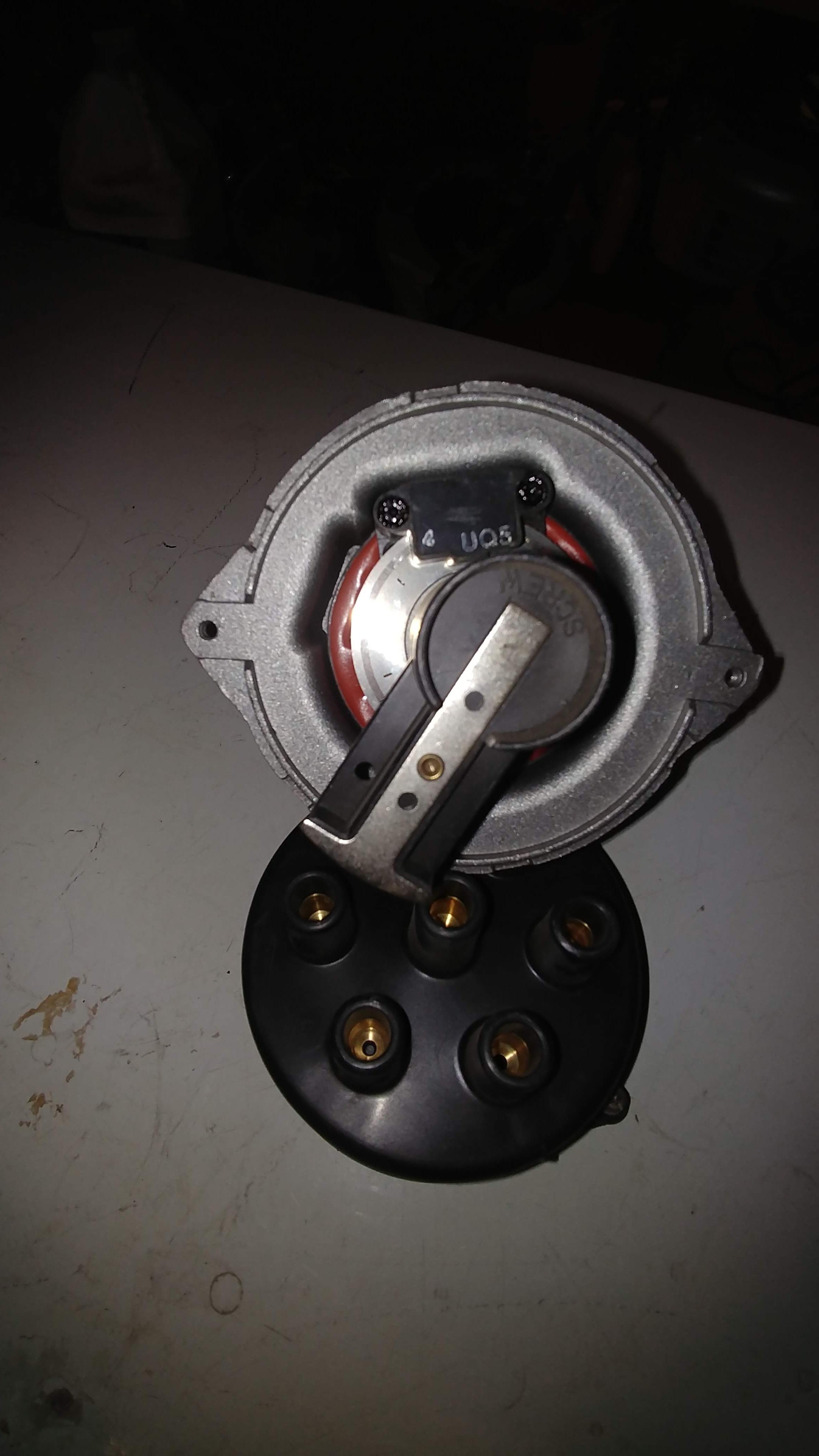

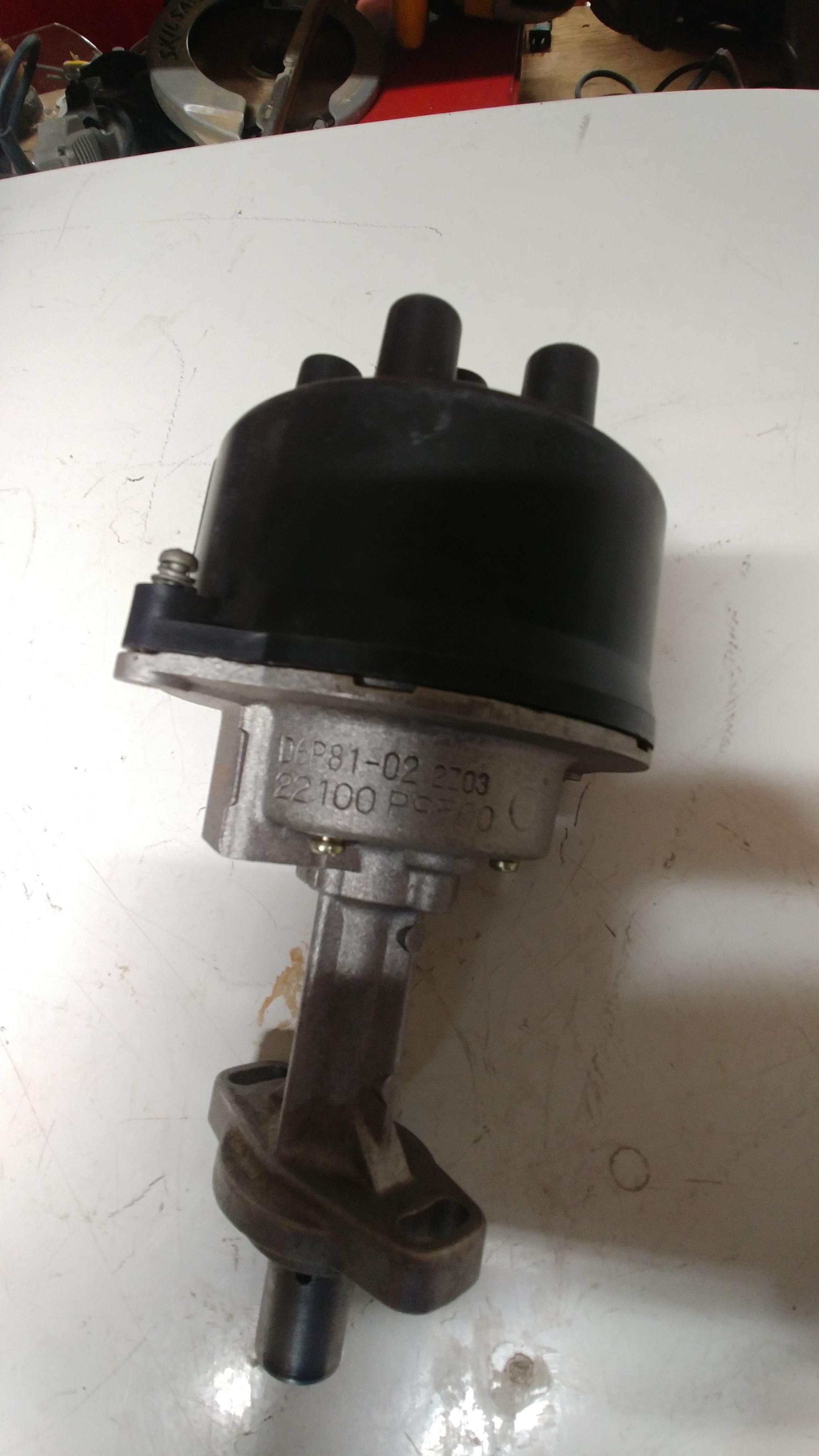

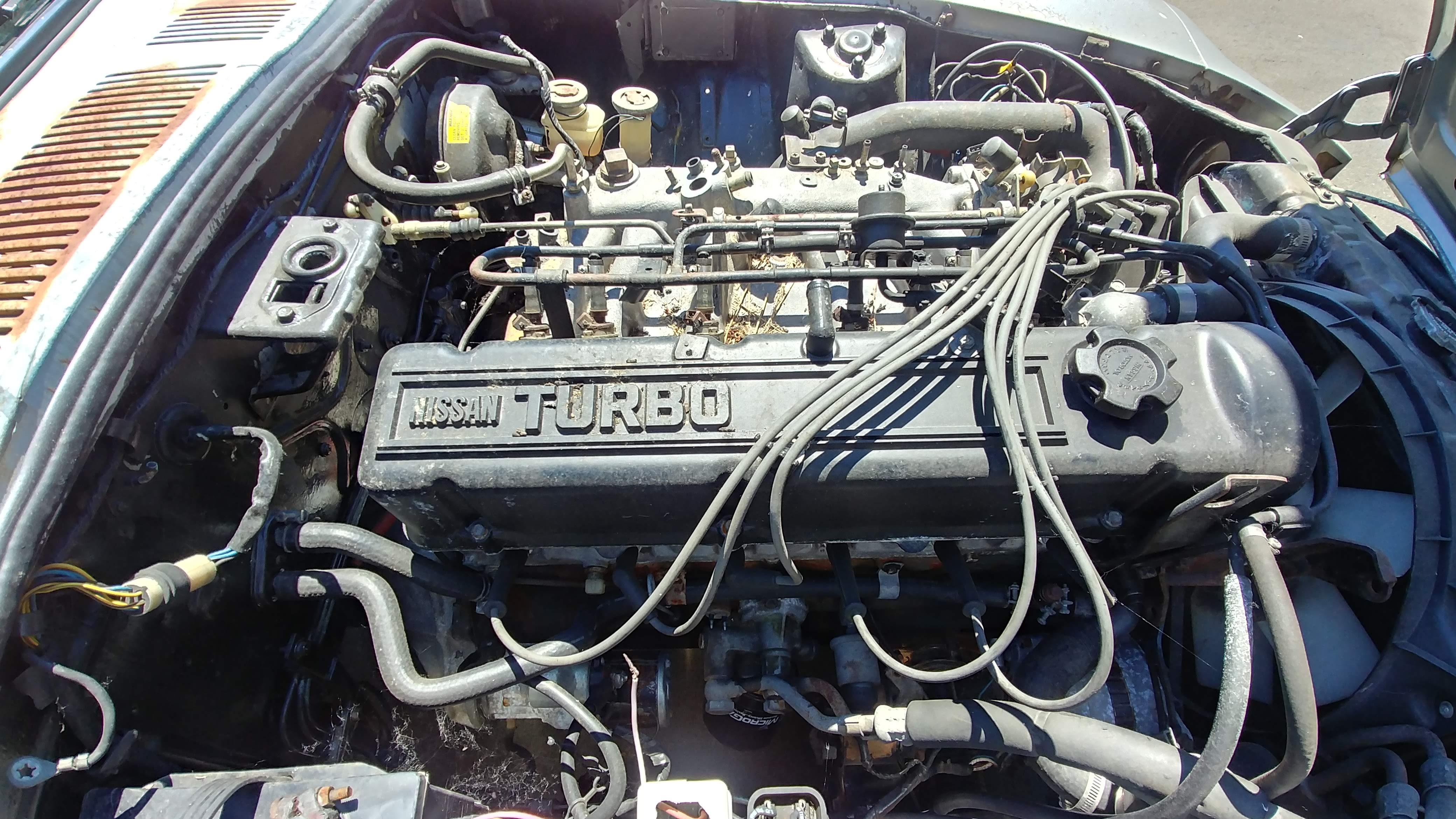

Looks promising.  I see that you said that you have a new distributor but the turbos have the CAS in the distributor.  You might make a good list of your engine parts to be sure of what you have and might need.  It looks like a complete turbo engine was swapped in, not just turbo parts.  It has an oil cooler.

Worth the challenge?
Is she worth saving? I've seen worse rust and yes I know the story of rust and there is probably more but the frame looks fine, amazingly the floor is surface rust but solid.
$500 is a win win. If you want to get out of the house then heck yeah it's worth the challenge.

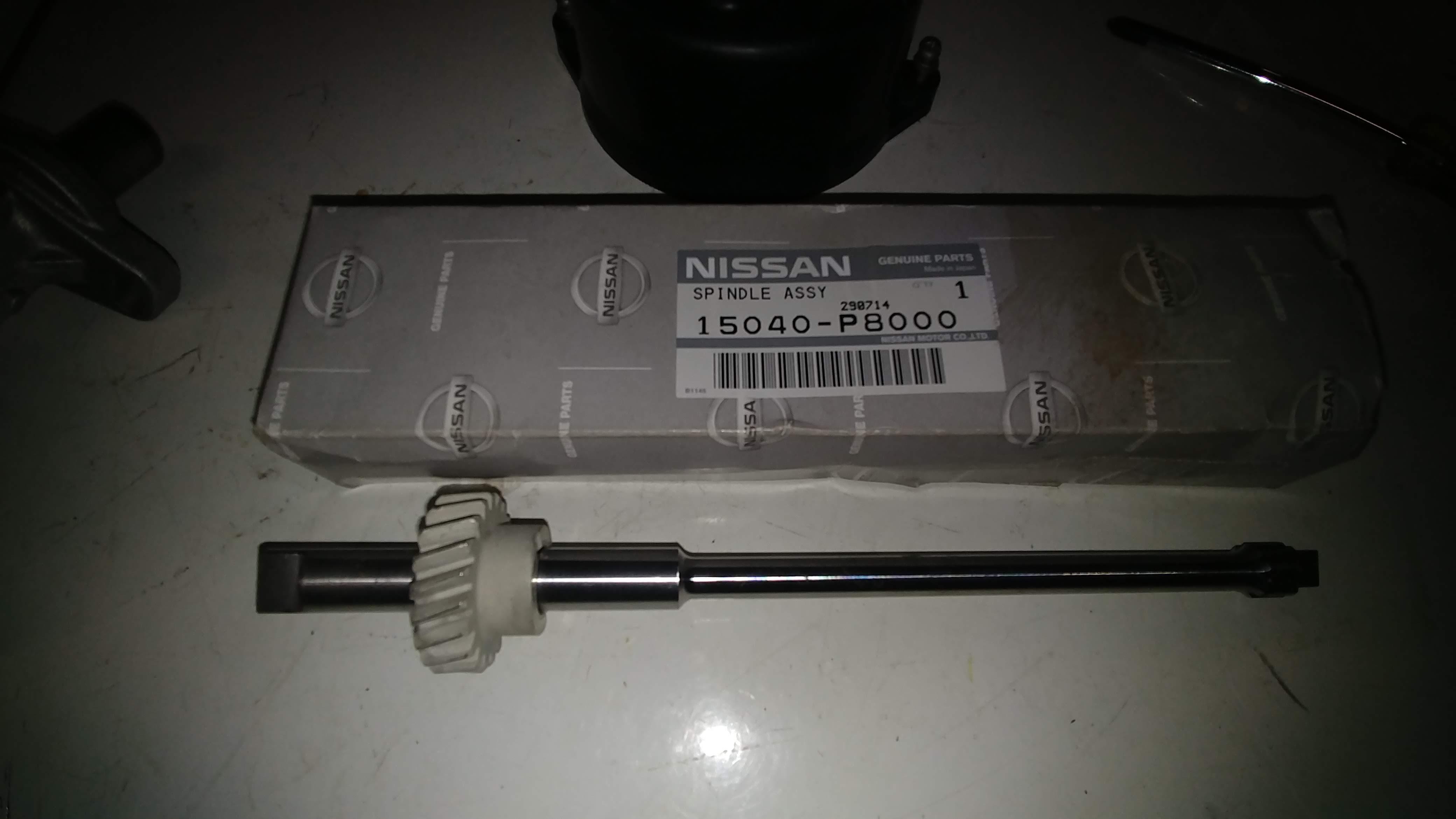

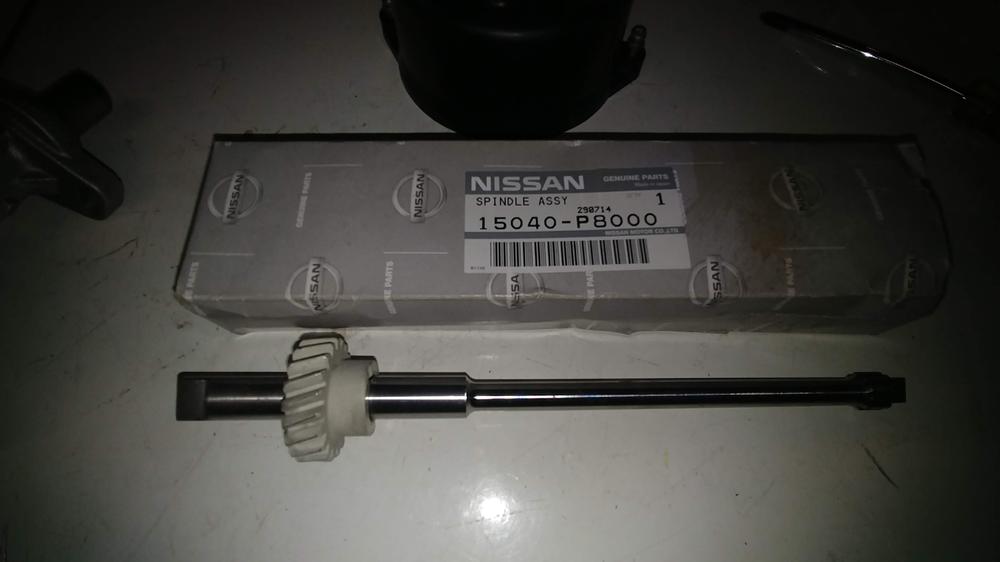

Ya not sure on the distributor. Why a rebuilt and why a oil pump shaft?? Any thoughts? I can take more pics.
Engine looks complete P90 head L54 block ( I believe).
Thanks for help.

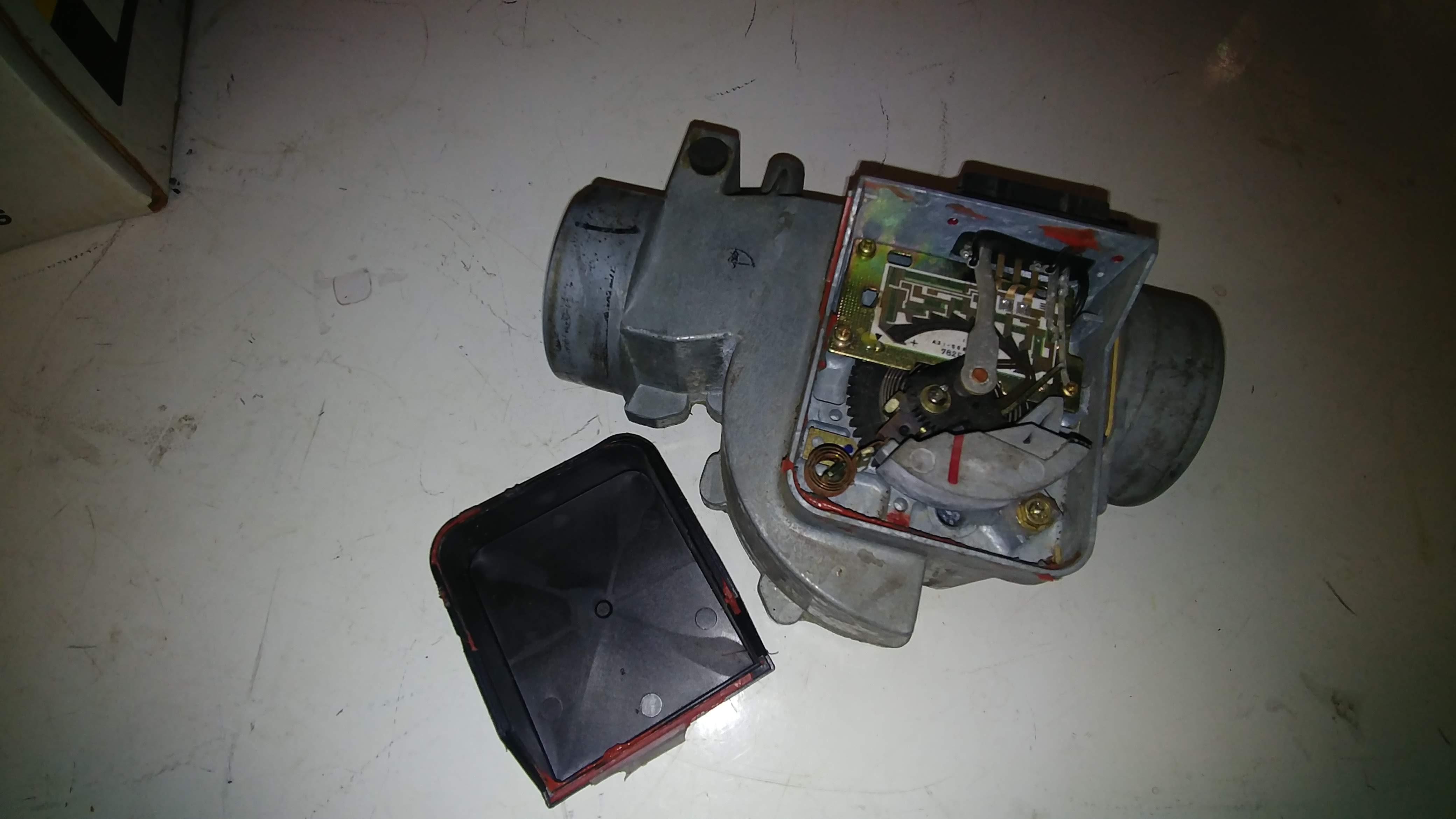

More loose parts from box.
Any thoughts?
I feel like rookie for asking but pic2 is like a flapper almost like MAF but not. Why is it opened? I've read some thread about transferring parts from the L28et engine to the 280z when swapping but I thought it was when trying to use original wiring harness. Not sure.

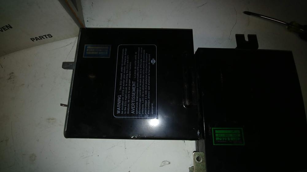

I have 2 ECUs.
