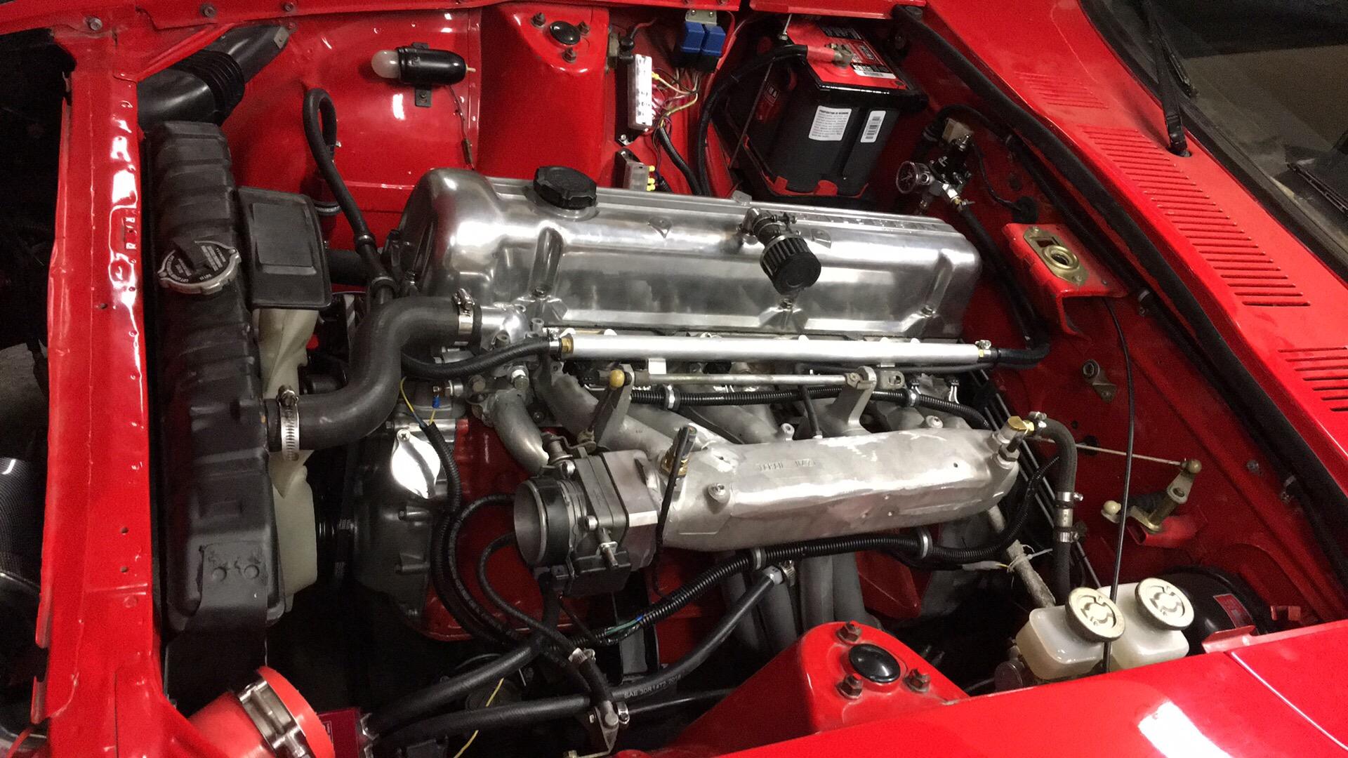

Some good news or let's say additional news on this Z. I know the previous owner through someone at work and was able to ask some questions, which they nicely answered.
I think there is some more good news in this. The engine was running fine before swap, clutch / flywheel new.

Intake Manifold. Much is pulled.
    This one I can’t really answer as its been years since I’ve seen what we took off and didn’t. But we did pull most of the emissions because the plan was to delete the codes when we converted to megasquirt.

Cool. My point is there would be no shame whatsoever to take five steps backwards before you take ten forward. Even if it means un-doing a lot of work that someone else has done before you. Especially if the backward steps make the future forward steps way easier.
I'm sure you'll get there eventually on either path, but I'm just thinking "easy".  :beer:
+1 on the captain. by the time MS is working you will THEN track all those little evil details that will eat your next year, easily. IF you score a good deal on a 280z engine just pop it in and make the car work. Why tinker for years and then realise somethings badly wrong (has happened before, rusted out under bondo/vin problems/warped chassis etc. etc.).
Considering that you will be abled to flip the engine afterwards, this might actually be cheaper than your route. Once you KNOW what works and what needs doing you can plan and tinker properly. To put into perspective, my 280z was in an ultra good condition (virtually nothing wrong) but still the engine needed boring (see, somethings always wrong) and it still took 2 years even though every piece in the car was 100% working to start with....
and you will definitely want to drive that thing WAAAY before you finish with a MS conversion
Edited by Villeman
There you go smackhq.  There will be ten opinions for every possibility.  Some people breeze through an MS installation, some never get it done.  If you have a hoist and space an engine swap is a "pop in", if you don't then it might not even be an option.  If you have good knowledge of how engine's work, you could have a set of carbs installed in a day.  Once you know the 280Z EFI system, it can be done in a day or two also, but you have to get the right parts.
How soon do you want it to be running, how well do you want it to run, what are your capabilities, how much do you want to spend or not spend, etc.  Good luck.  Pick one and go for it.  The FMS's are great educational tools, Nissan goes in to great detail about how things work.  The Engine Fuel chapters and Engine Mechanical are worth reading even if you stick with Megasquirt.  You can download them from the Resources section.
