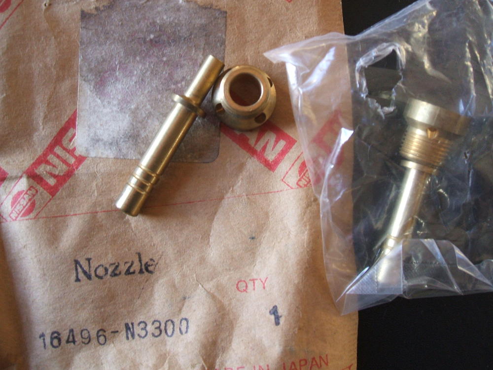

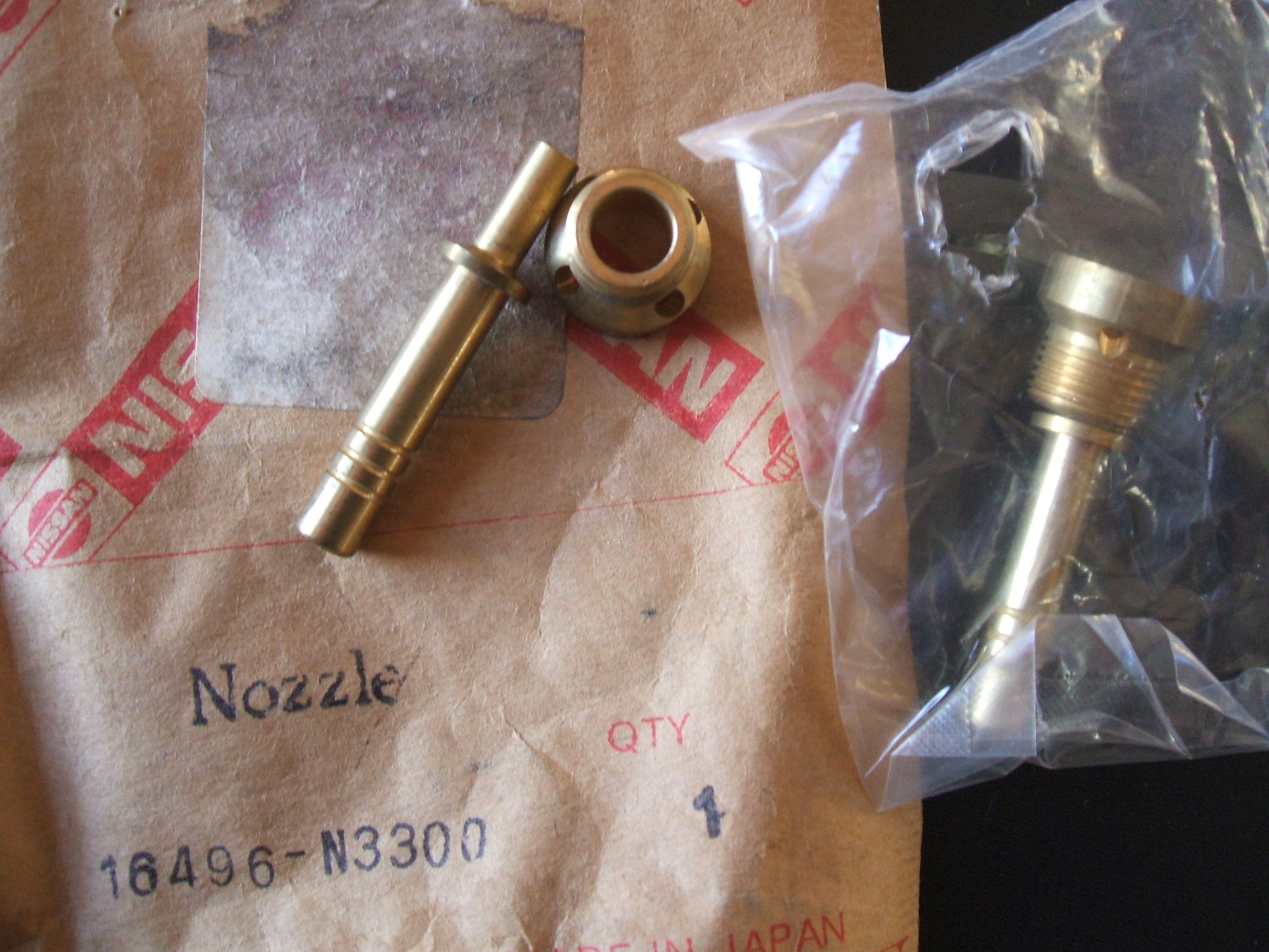

December 16, 20186 yr comment_563867 Love the pic of the NOS nozzle. Link to comment https://www.classiczcars.com/forums/topic/60309-were-bringin-back-the-flat-tops/?&page=16#findComment-563867 Share on other sites More sharing options...
December 16, 20186 yr Author comment_563875 56 minutes ago, Captain Obvious said: Love the pic of the NOS nozzle. Yes, same here. Will post pics later today of forward carb disassembly. Just had to share this quickly: I usually talk with my wife about how the car work is coming along and what I am working on. I came in from the garage yesterday afternoon and she asked me how my "Flat Bread Carbs" were coming along. So, here is a nice picture of some 'Flat Bread Carbs'.......almost as nice as a good set of 'flat top carbs'. ? Link to comment https://www.classiczcars.com/forums/topic/60309-were-bringin-back-the-flat-tops/?&page=16#findComment-563875 Share on other sites More sharing options...
