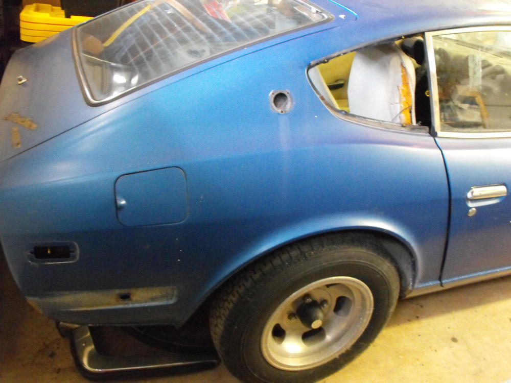

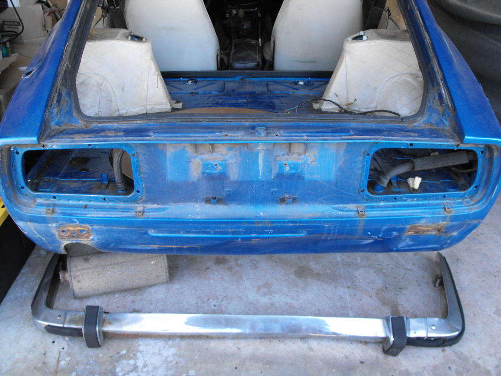

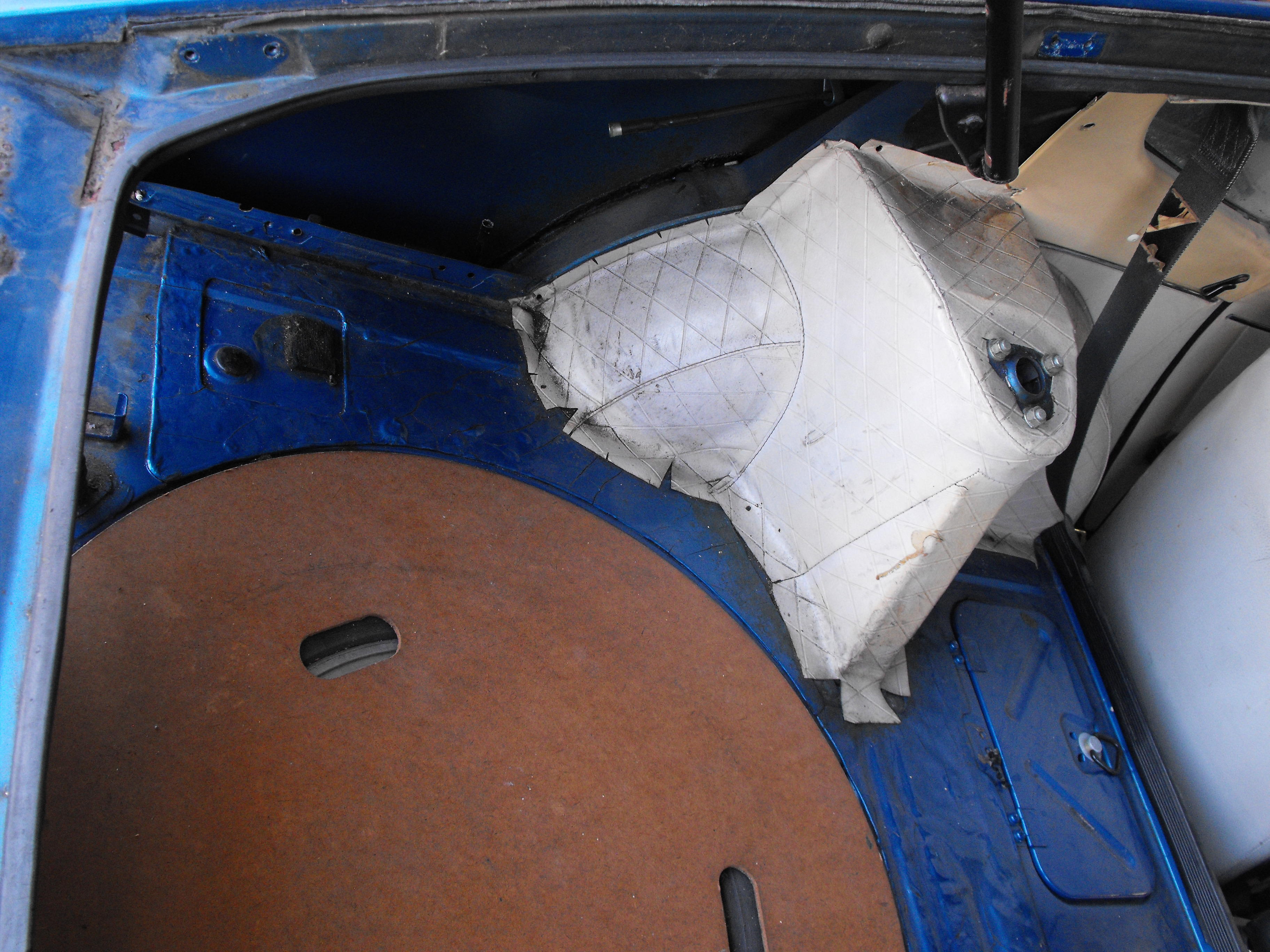

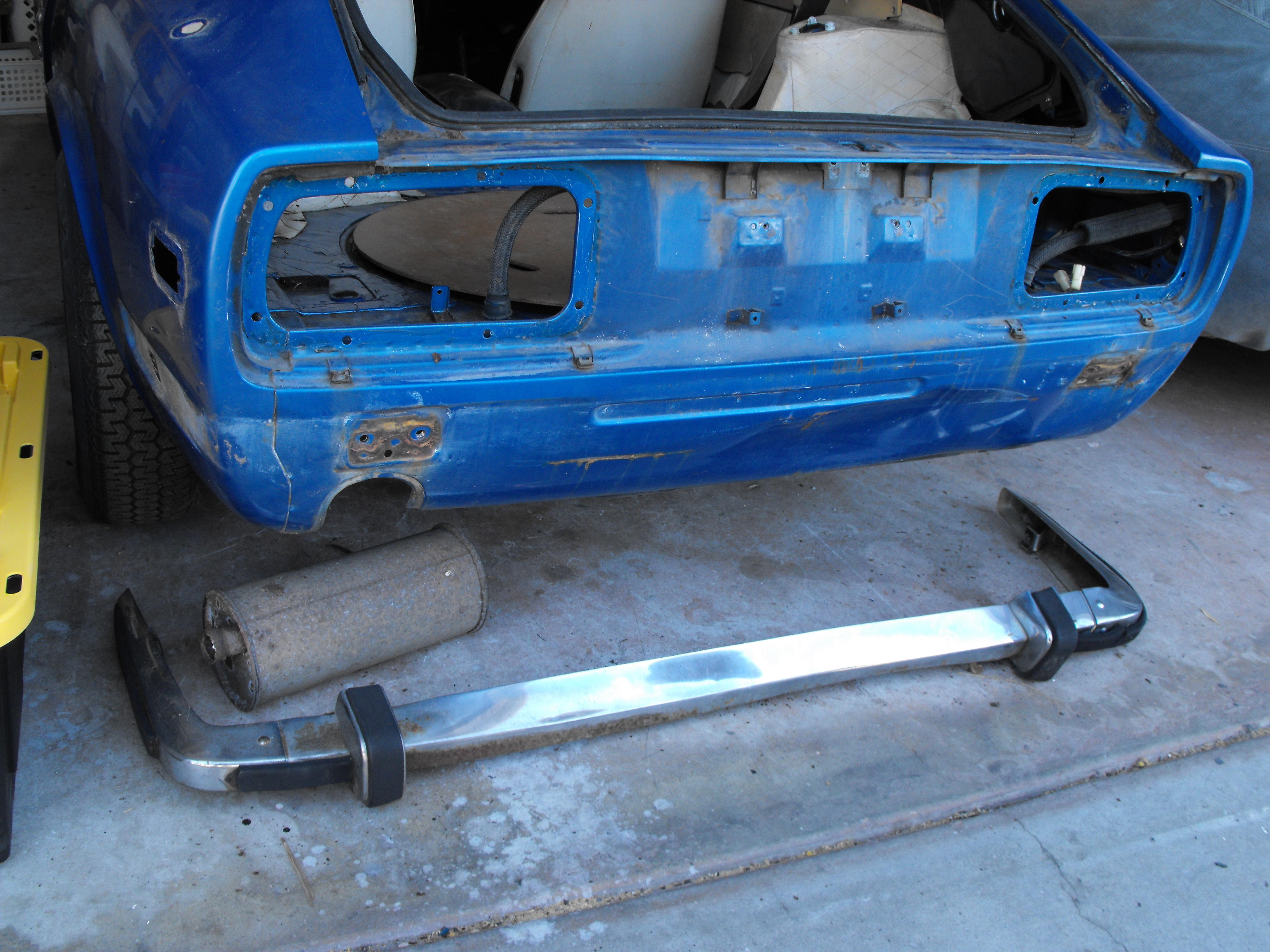

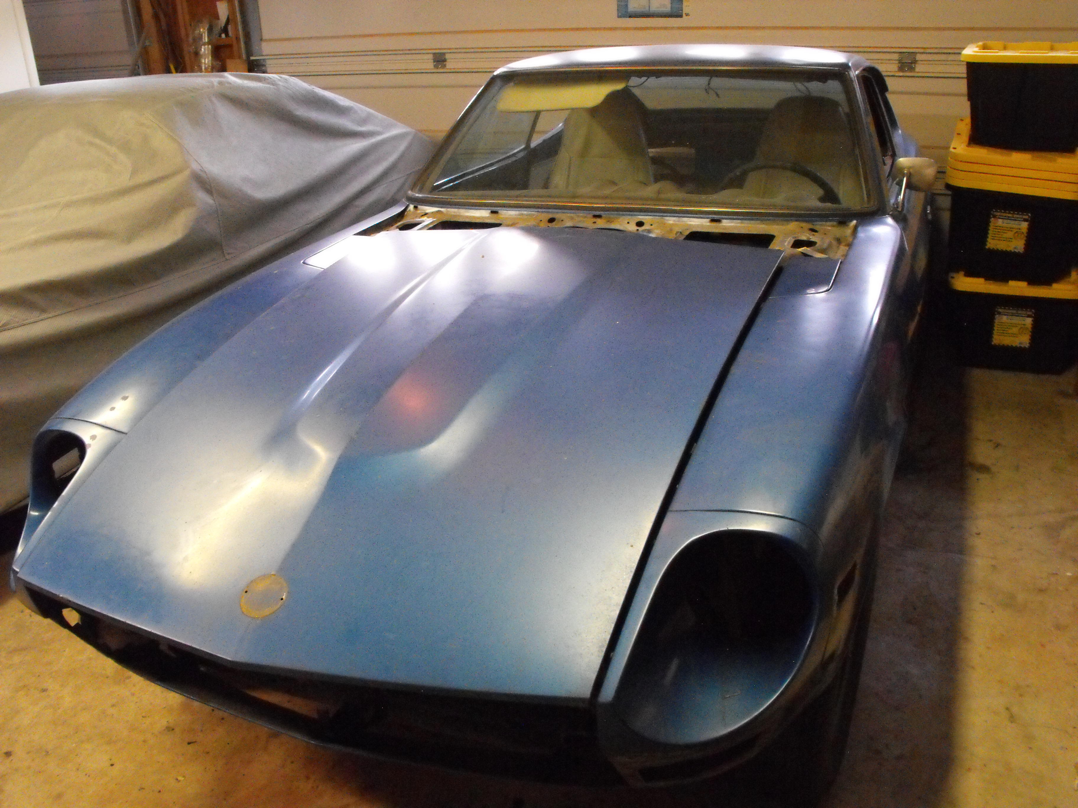

July 5, 20186 yr Author comment_552422 Got the radiator and AC evaporator out then started working on the back end. This actually cleaned up pretty nice, and the bumper and rear end damage do not look too bad. All the interior panels will need to be replaced though. They are as fragile as egg shells. The rear tail lights are in very nice shape. Here are some pics from the disassembly. Link to comment https://www.classiczcars.com/forums/topic/60309-were-bringin-back-the-flat-tops/?&page=2#findComment-552422 Share on other sites More sharing options...

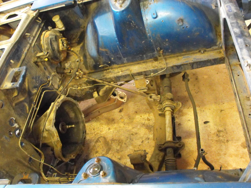

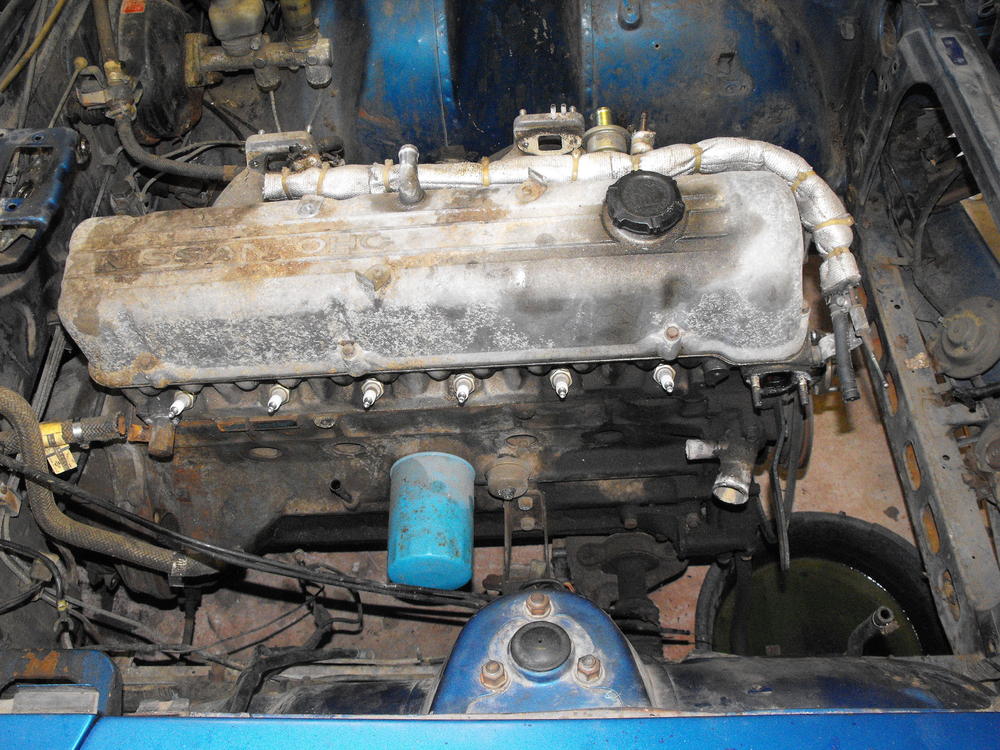

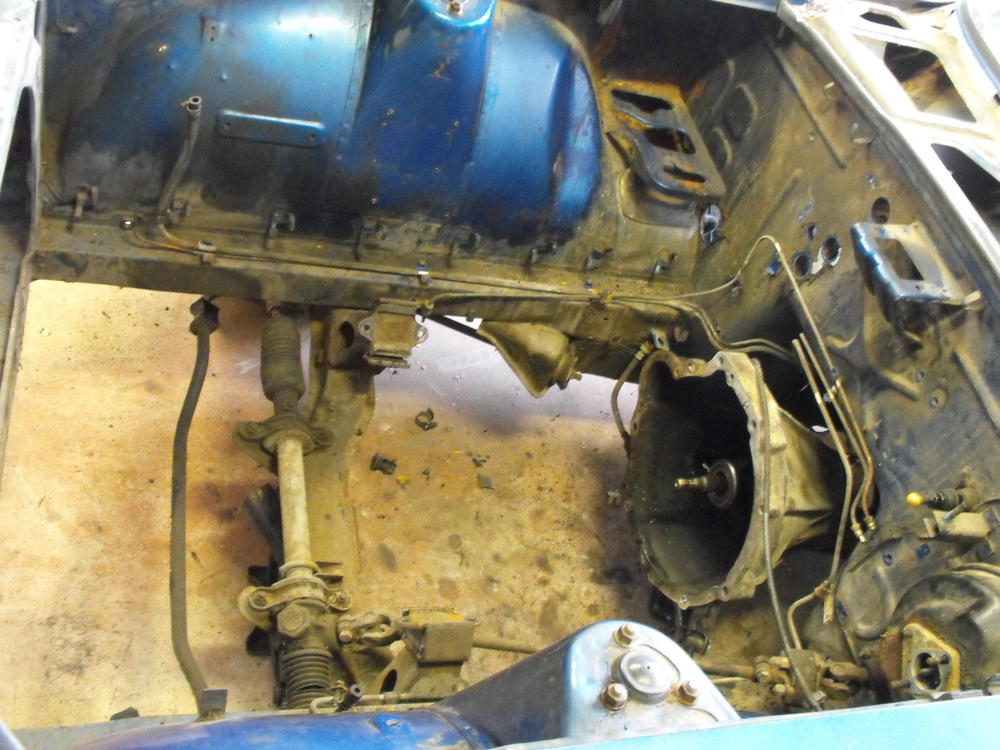

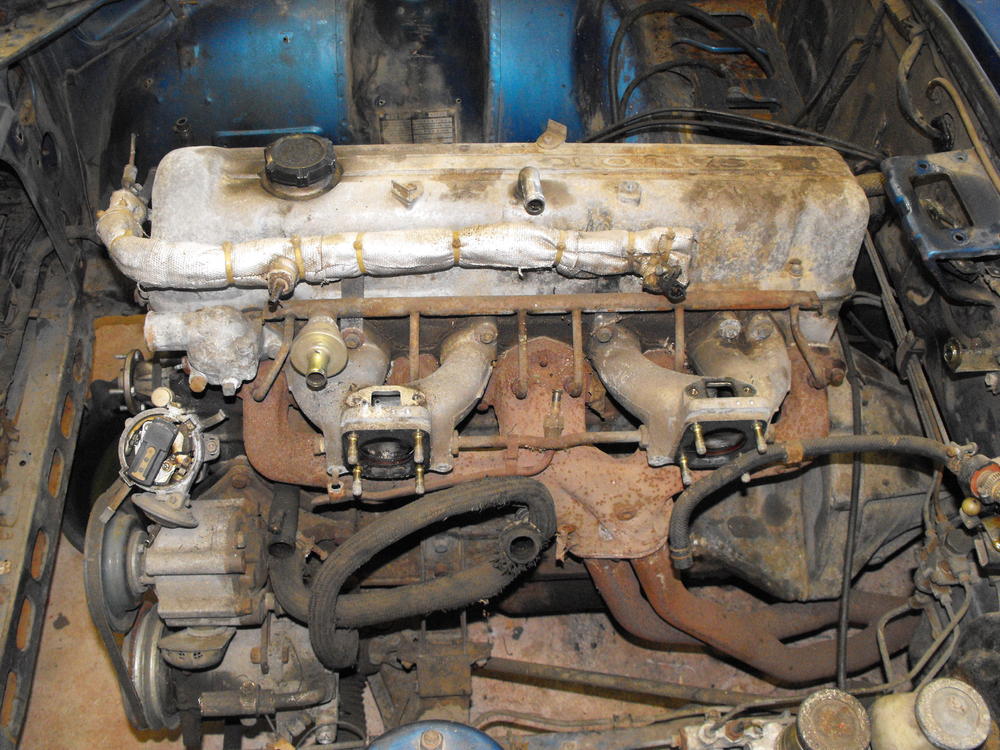

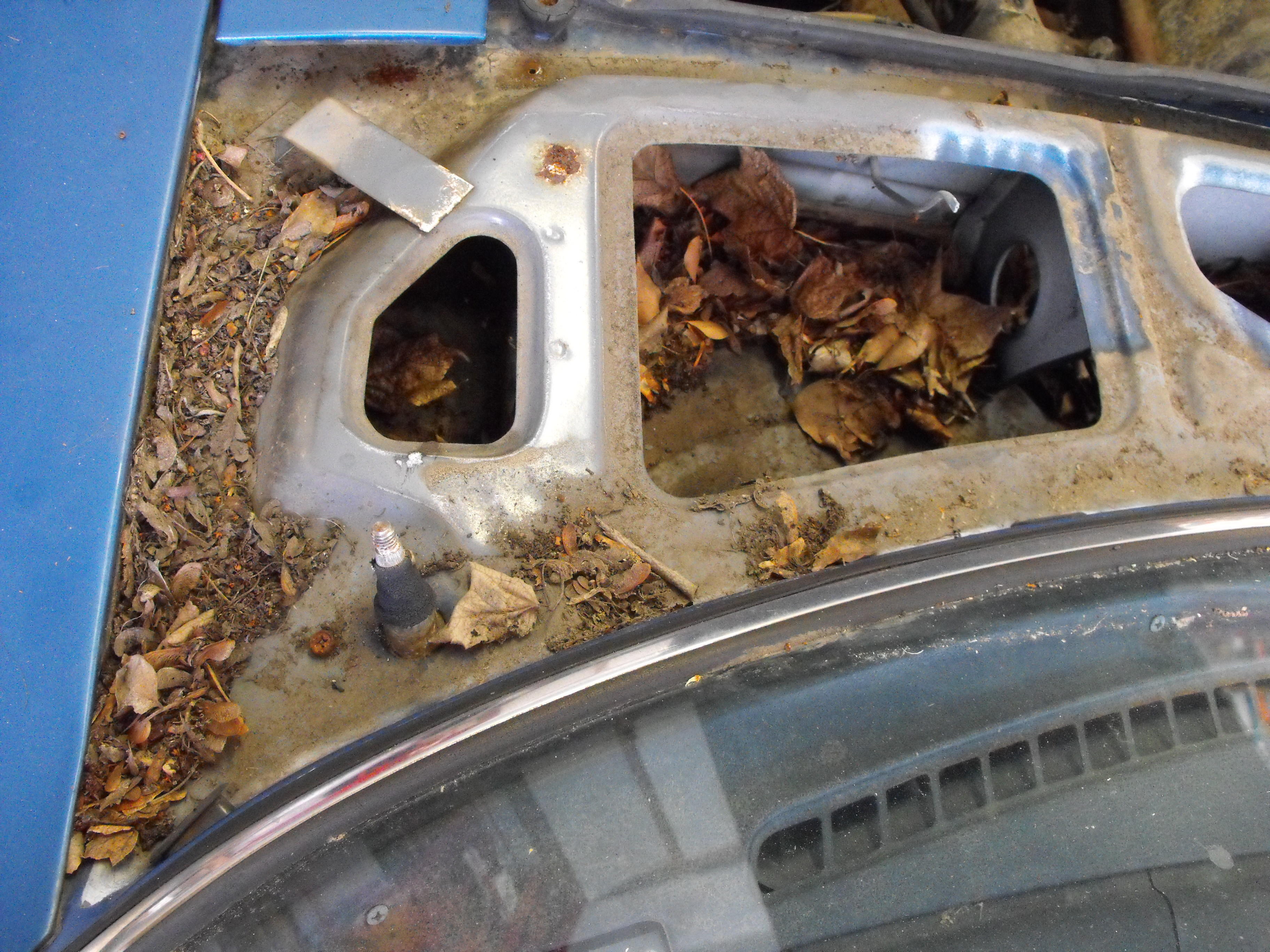

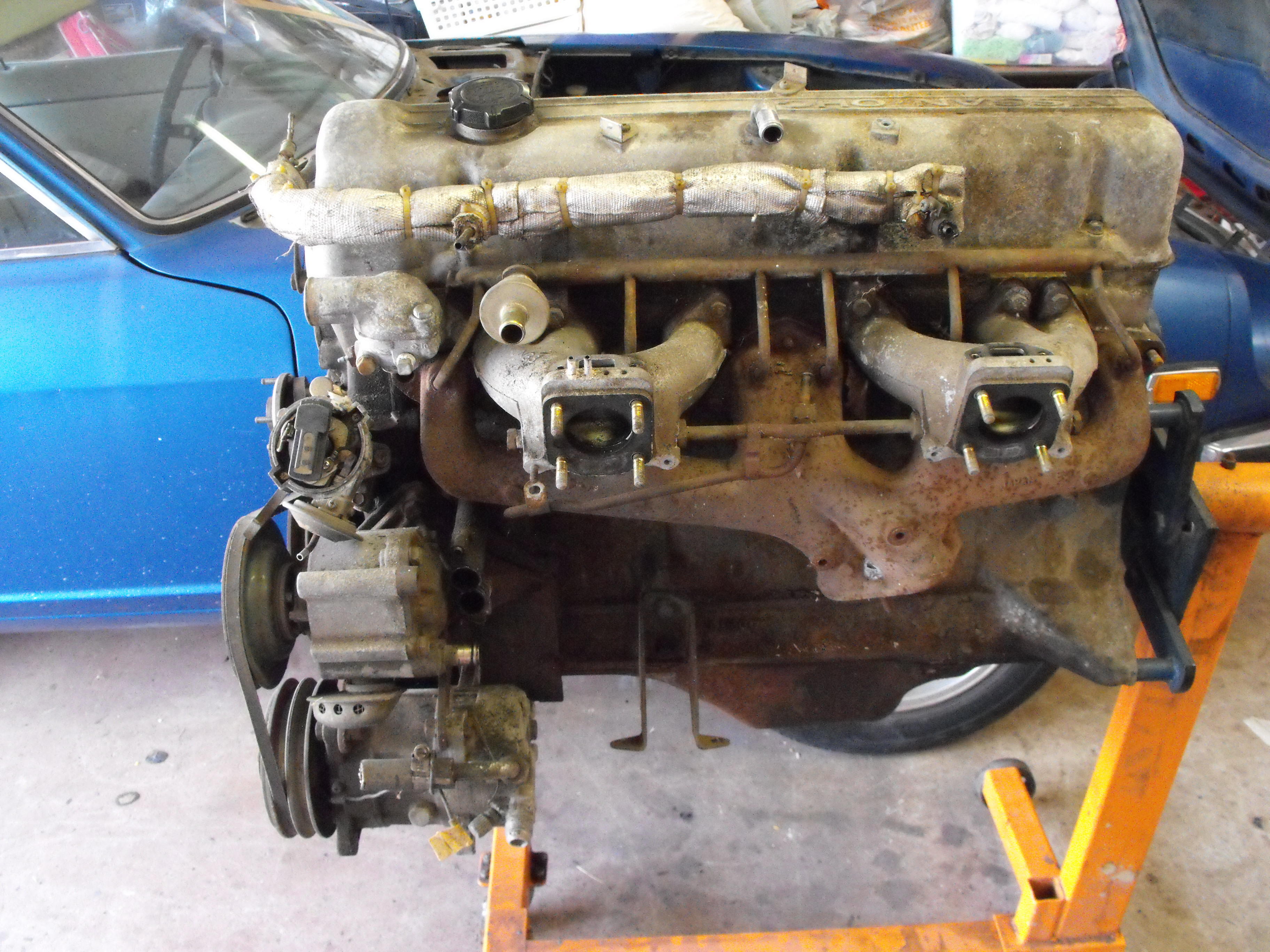

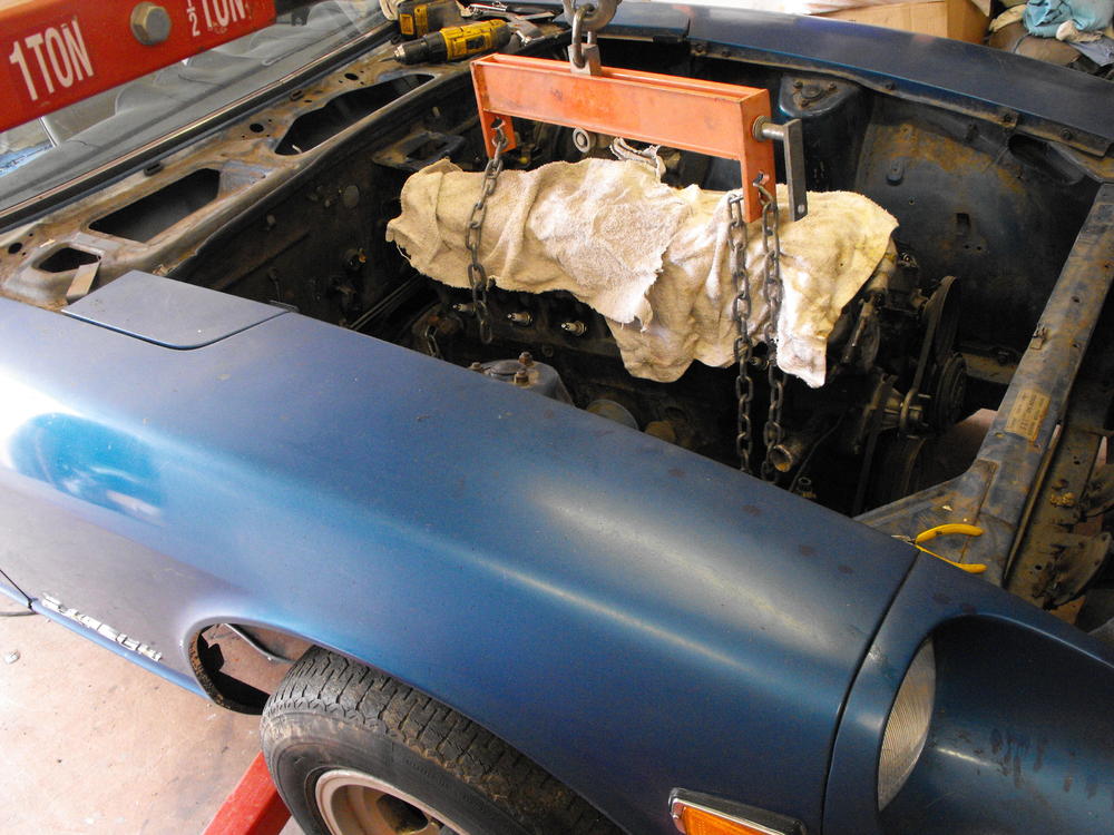

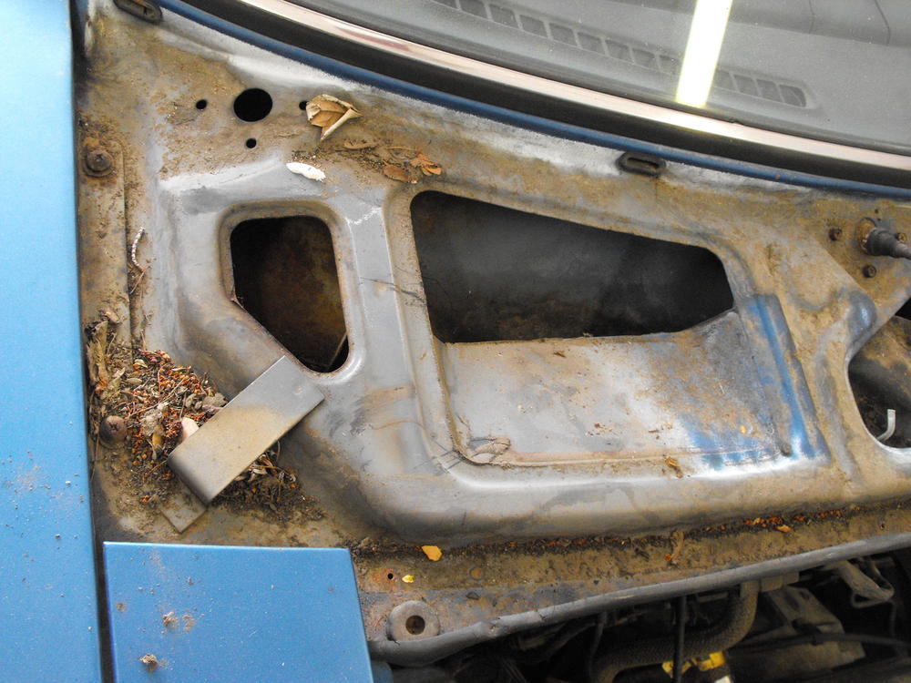

July 8, 20186 yr Author comment_552635 On 7/5/2018 at 5:29 AM, Diseazd said: ...... I love seeing these needy Z’s taken down to the bones and brought back to their original beauty. Now that you have a very detailed , “do it the right way” painter, you have the right combination to achieve concours results. ... Guy Hi Guy, good to hear from you again. Yes, having a great painter is a huge help. It is the only way that I will do the cars now. Got some more parts off of the interior of the car. Also got the engine harness out and the engine out. Will take out the trans, diff and brake and fuel lines next. Also got the wiper arms and wiper motor out. I am guessing the car was parked somewhere close to a tree at one time. That Z CSI comes in handy. If i knew my trees better, I could tell you what kind of tree it was . ? Link to comment https://www.classiczcars.com/forums/topic/60309-were-bringin-back-the-flat-tops/?&page=2#findComment-552635 Share on other sites More sharing options...

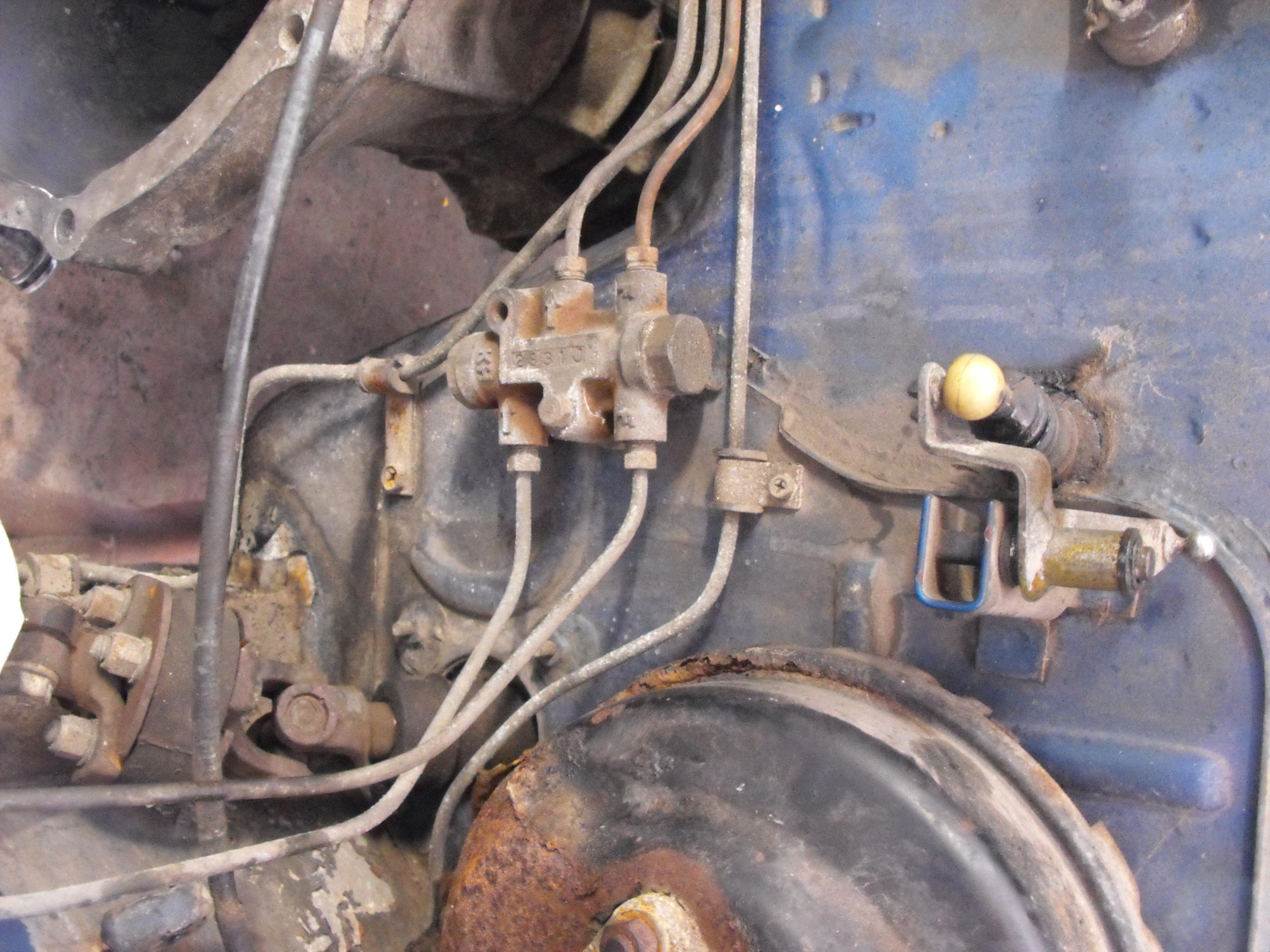

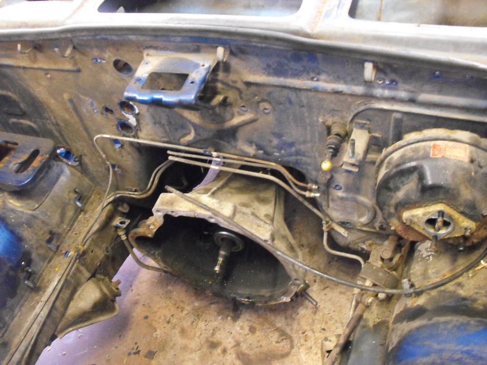

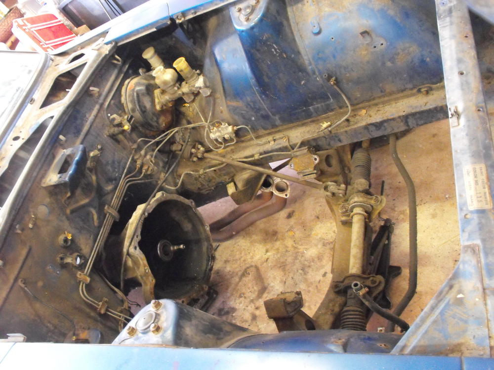

July 9, 20186 yr Author comment_552690 Spent a little more time removing parts today. It was pretty dog gone hot here so I opted not to mess with the transmission today. Instead, I removed the front end bumper assembly and lights. Also removed some of the brake components in the engine compartment. I did a quick wipe with de-greaser on the engine bay fenders and they clean up pretty nice. Will clean up a bit more once I get all of the brake lines out. Here are the latest pics. Link to comment https://www.classiczcars.com/forums/topic/60309-were-bringin-back-the-flat-tops/?&page=2#findComment-552690 Share on other sites More sharing options...
