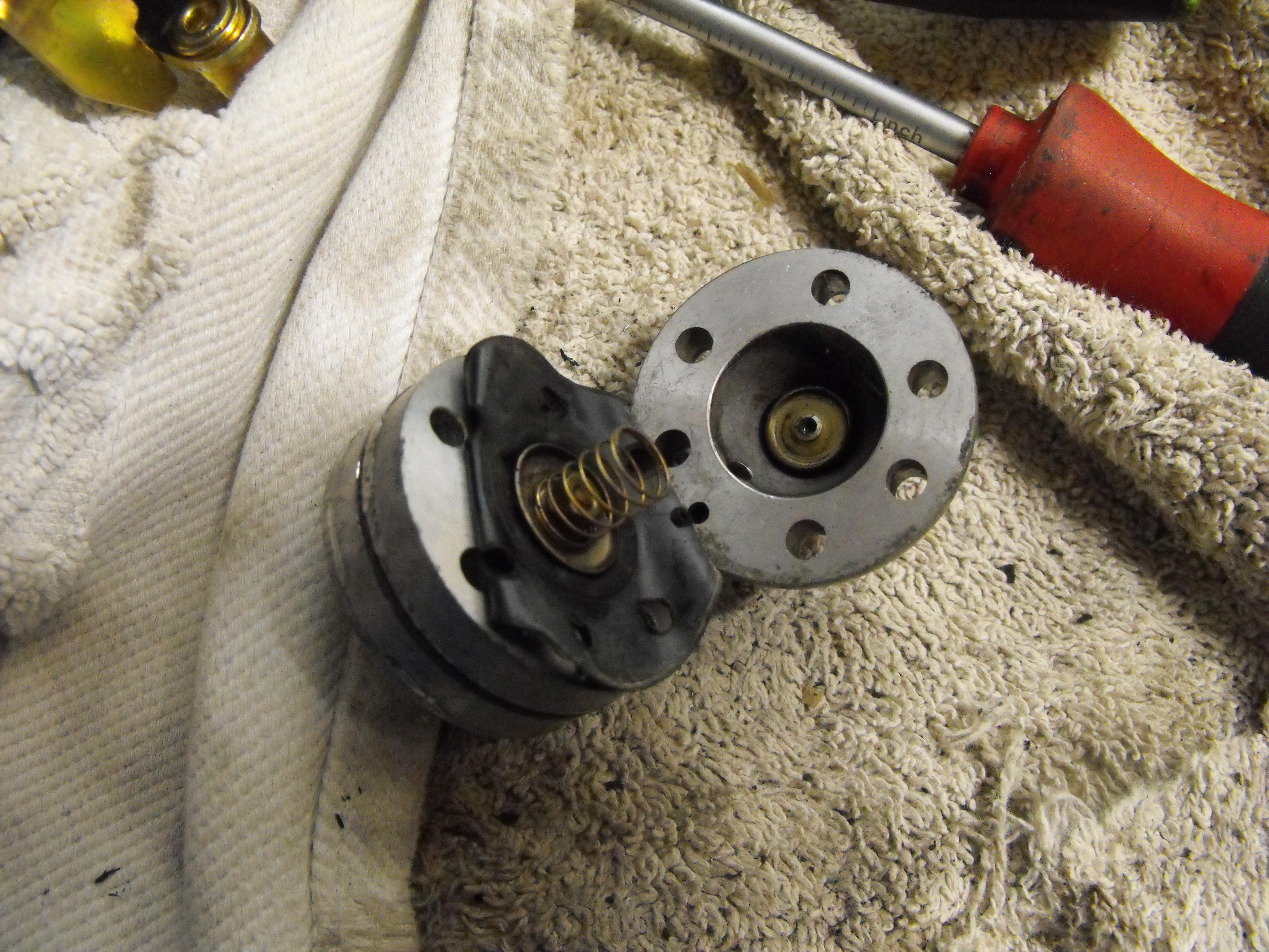

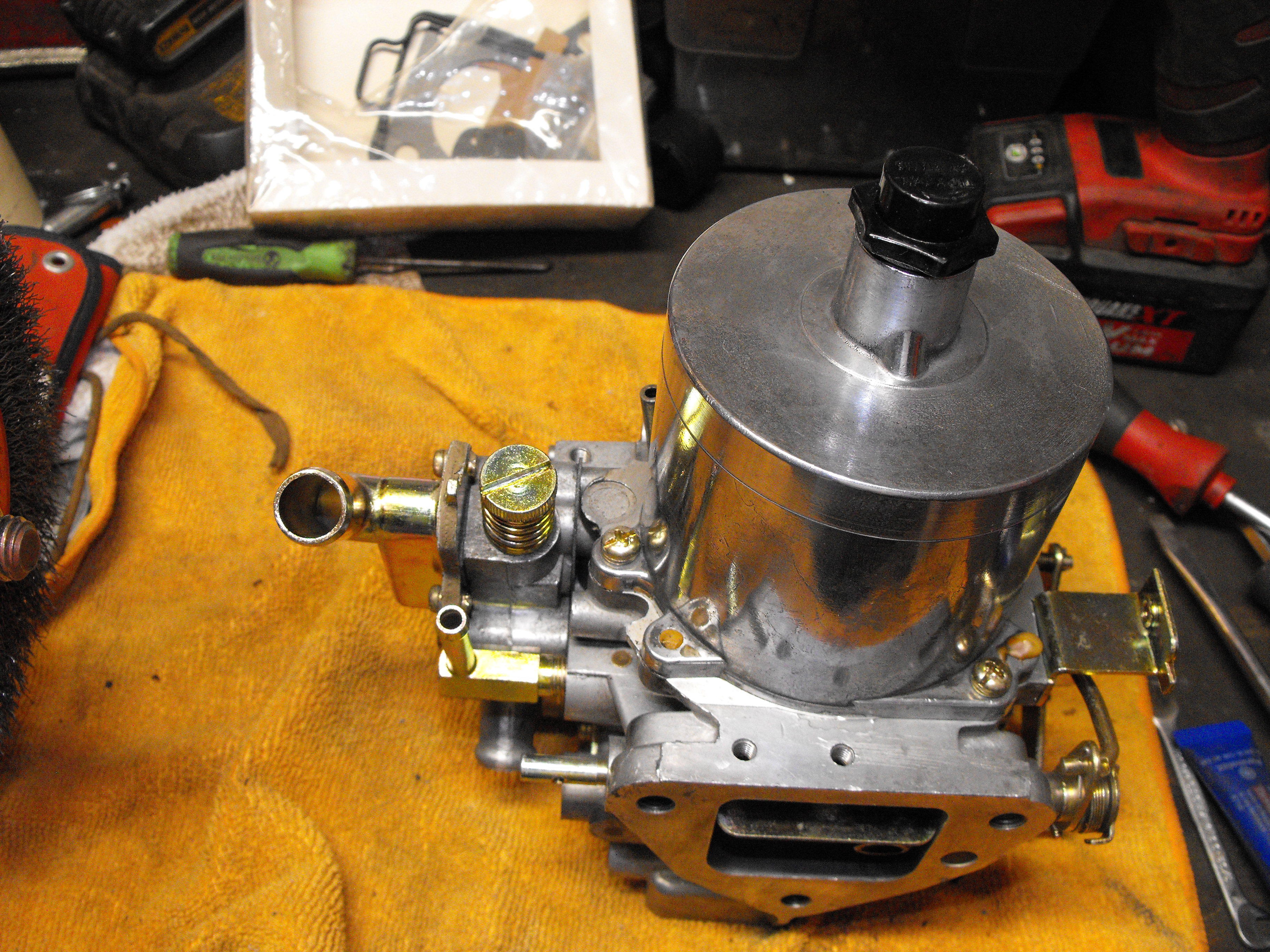

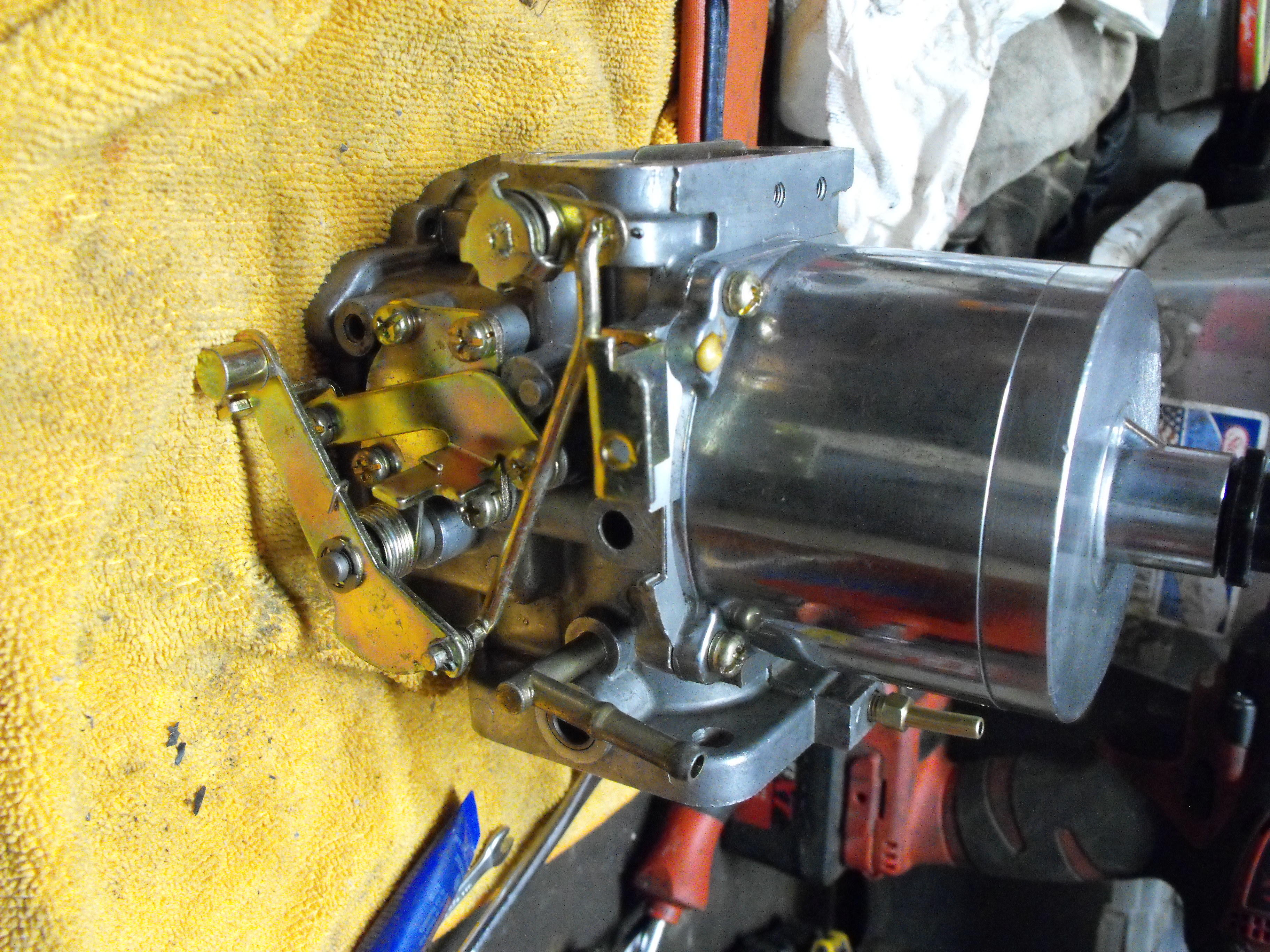

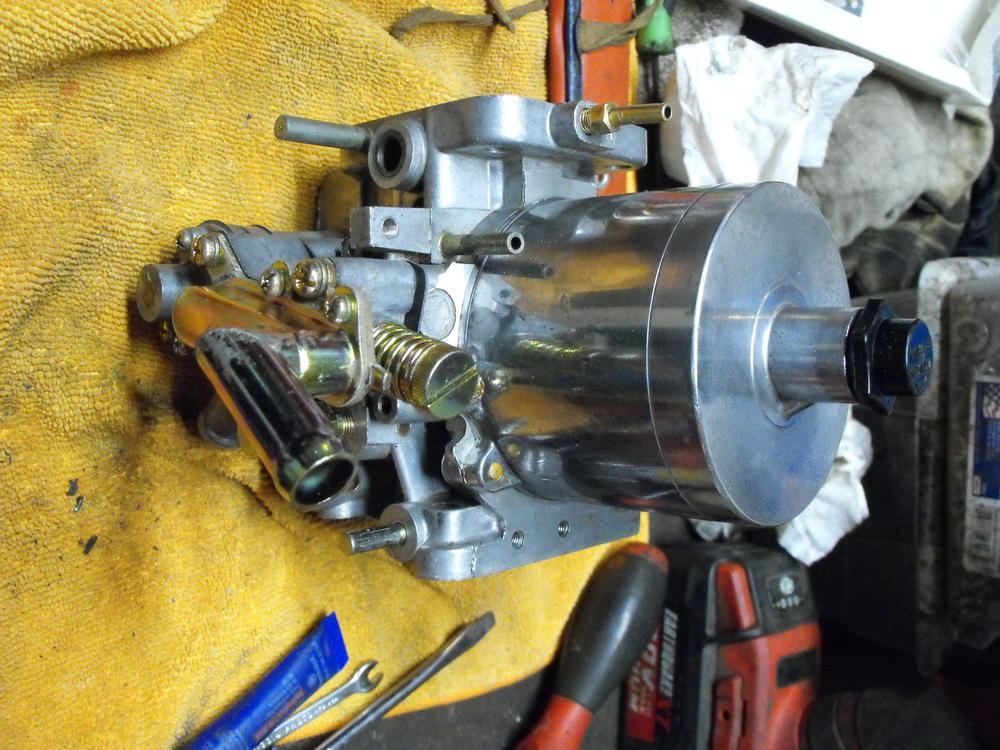

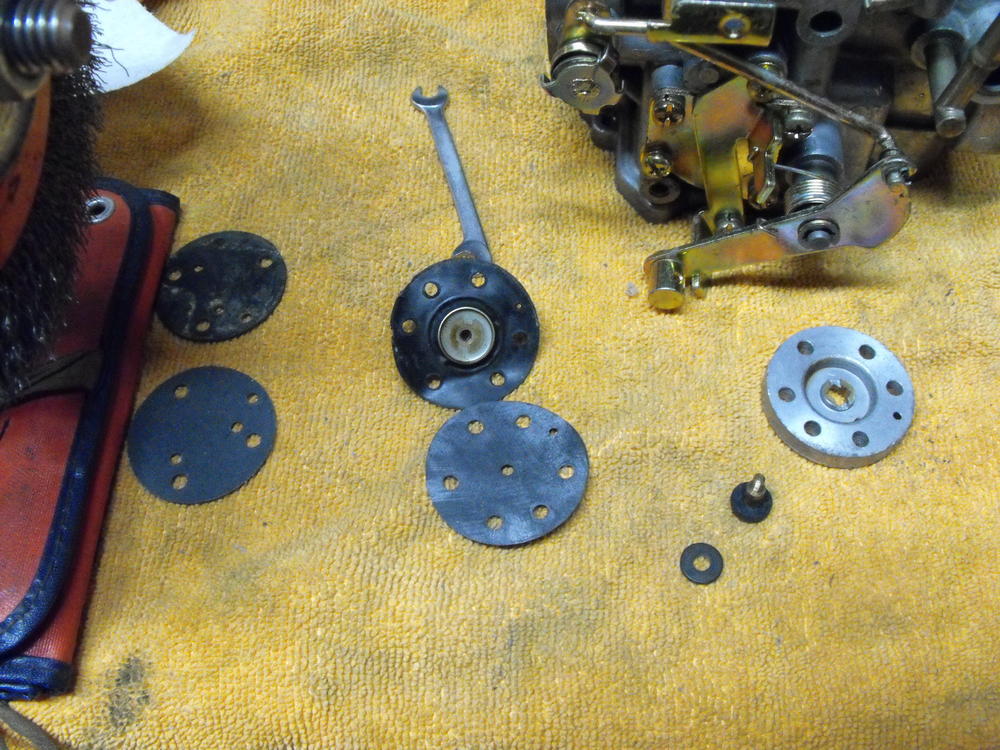

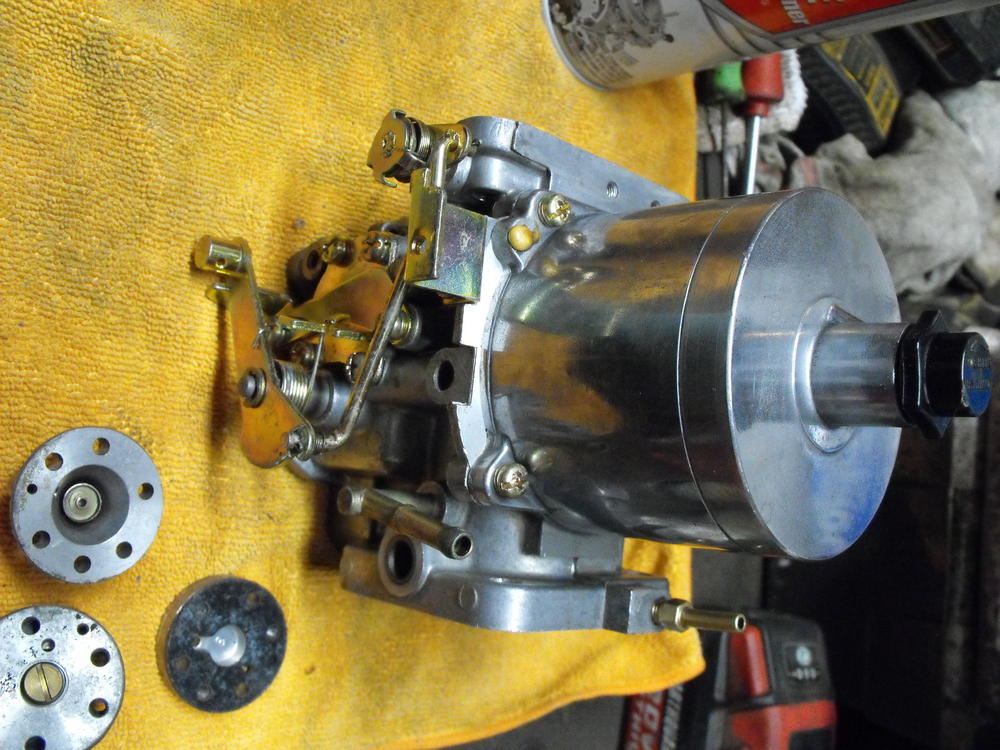

Started the carb re-assembly now that I have freshly plated parts.  This is actually a lot of fun to re-assemble using the new gasket kits.  Fortunately, I have a spare set of flat tops to look at to make sure that everything goes together right.  Also have the 'upgrade' guide.  Replaced all the gaskets on the pump assembly.  Interestingly, it looks like the original one was folded over as you can see in the last pic.  Choke mechanism works nice.  My throttle shafts are supposed to be ready tomorrow with fresh dry film lube.  Should be able to finish things out once I get those.
