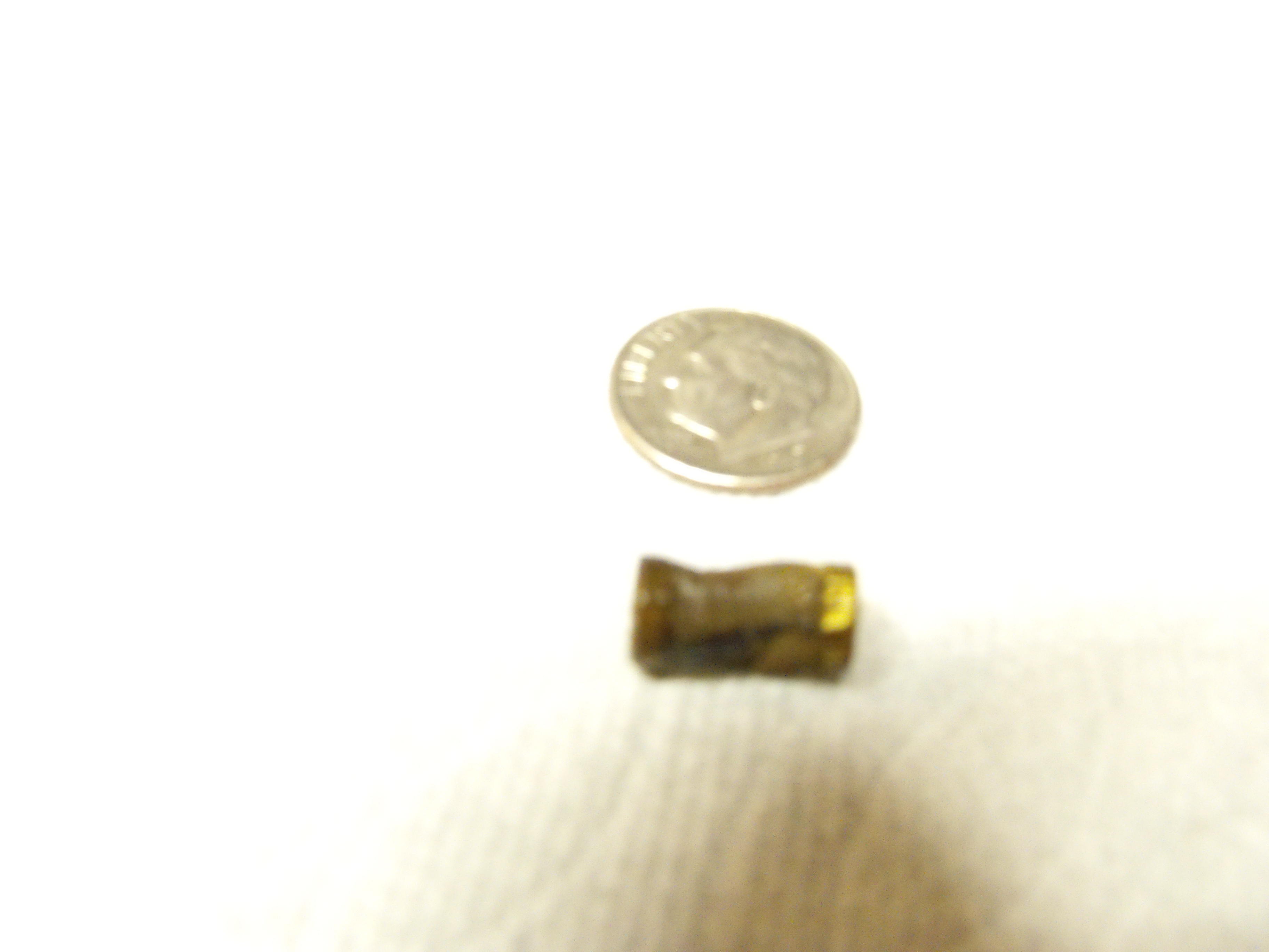

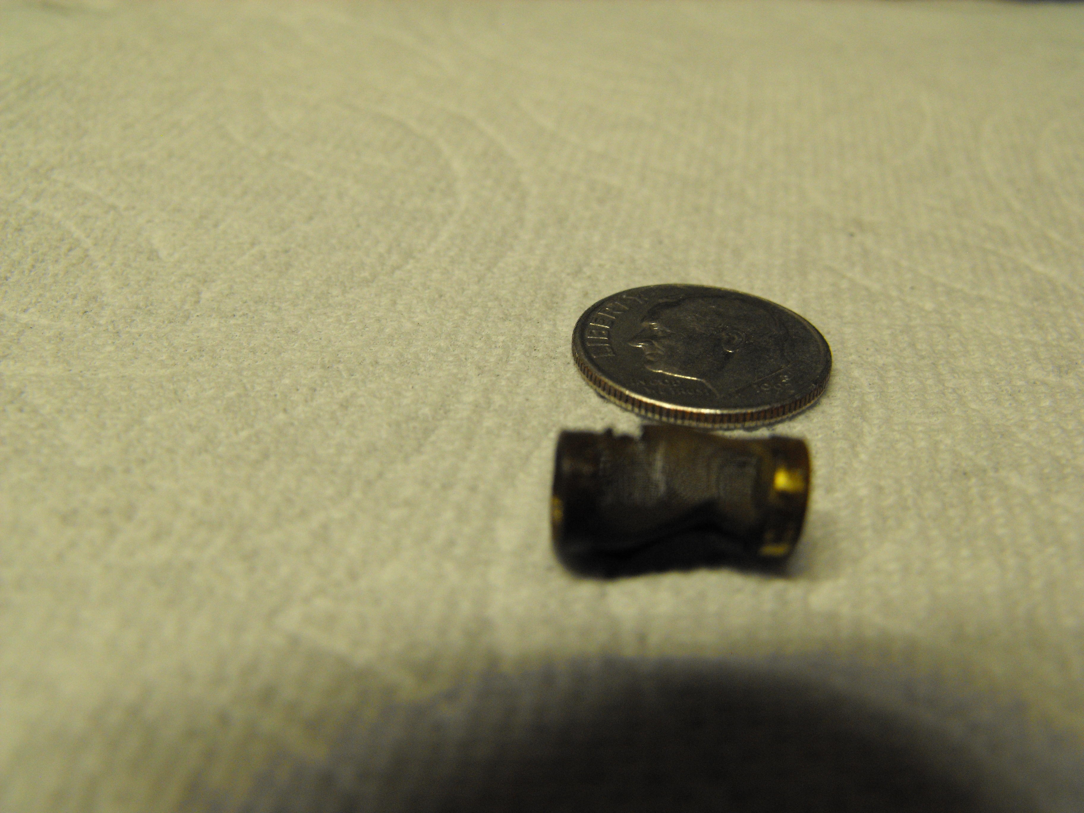

I've never found a source for replacement filters. I haven't looked hard, but in the little poking around I did, nothing turned up. Seems like they wouldn't be thaaaaat hard to make yourself.  (Famous last words, right?)
I was thinking about that actually.  I have a number of different stainless steel mesh sheets from a cancelled project at work that could possibly be used.  Will look into that.

8 minutes ago, Patcon said:
Any idea on what size screen it needs to be ? How would you handle the edges? Are they banjo screens like the earlier carbs?
The fuel filter looks like this, its very small.   I have some of this at stuff at work that seems to be somewhat similar: https://www.twpinc.com/wire-mesh-material/stainless-steel/635-mesh-t316-stainless-138
Not sure how I would handle the edges yet.

If I were to try to make filters, I would start with brass screen just like the stock filters. That way you could solder the seam just like the originals. And then you could also use some soft brass sheet to welt the ends and solder them in place as well.
I don't know what hole size would be appropriate, but McMaster has brass screen with hole sizes down to six thousandths.  >>  https://www.mcmaster.com/brass-wire-cloth  You can get a one square foot piece for about $7.50. Enough to go into production and supply filters for probably all of the flat-tops still on the road today!  LOL
