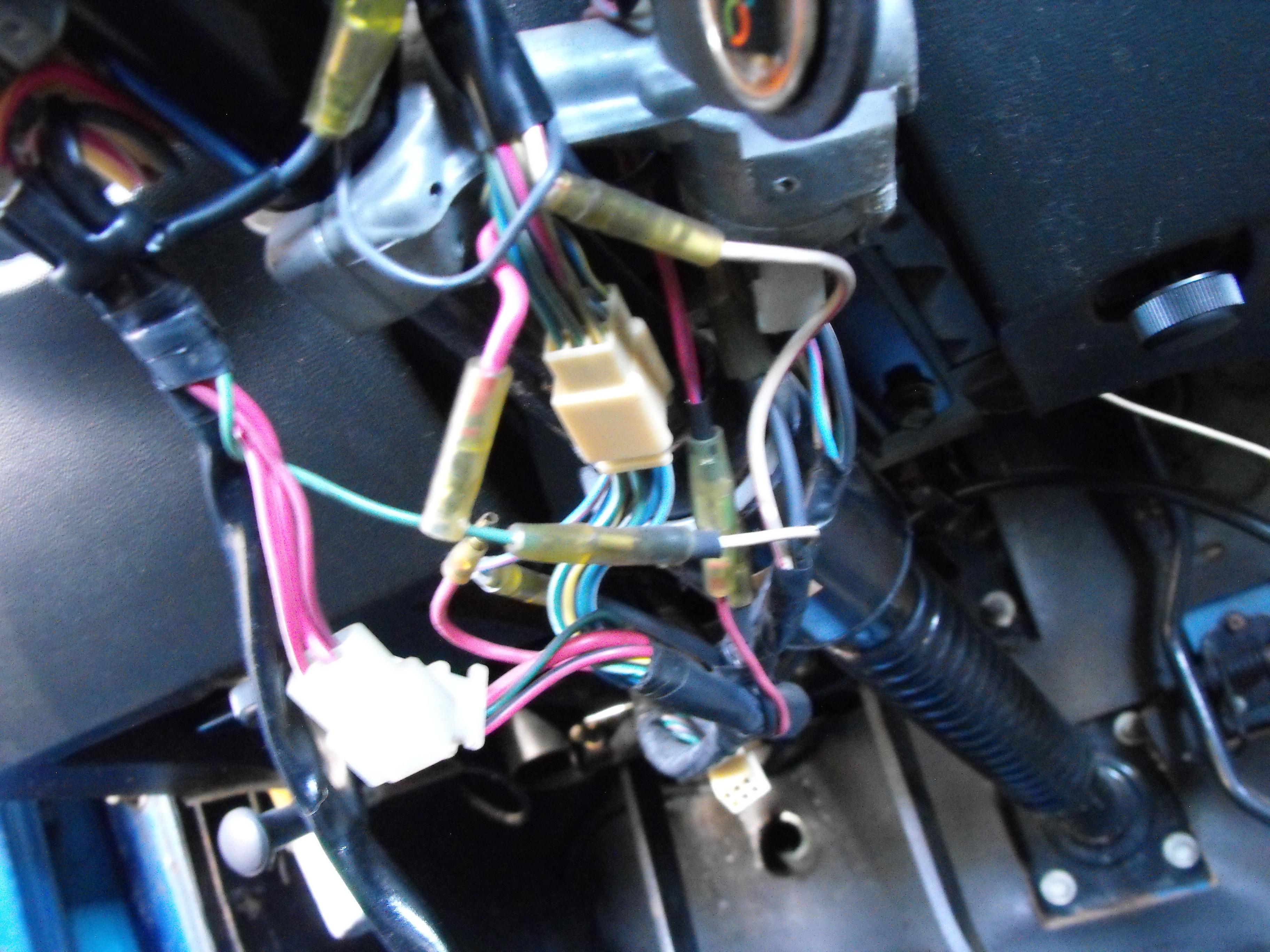

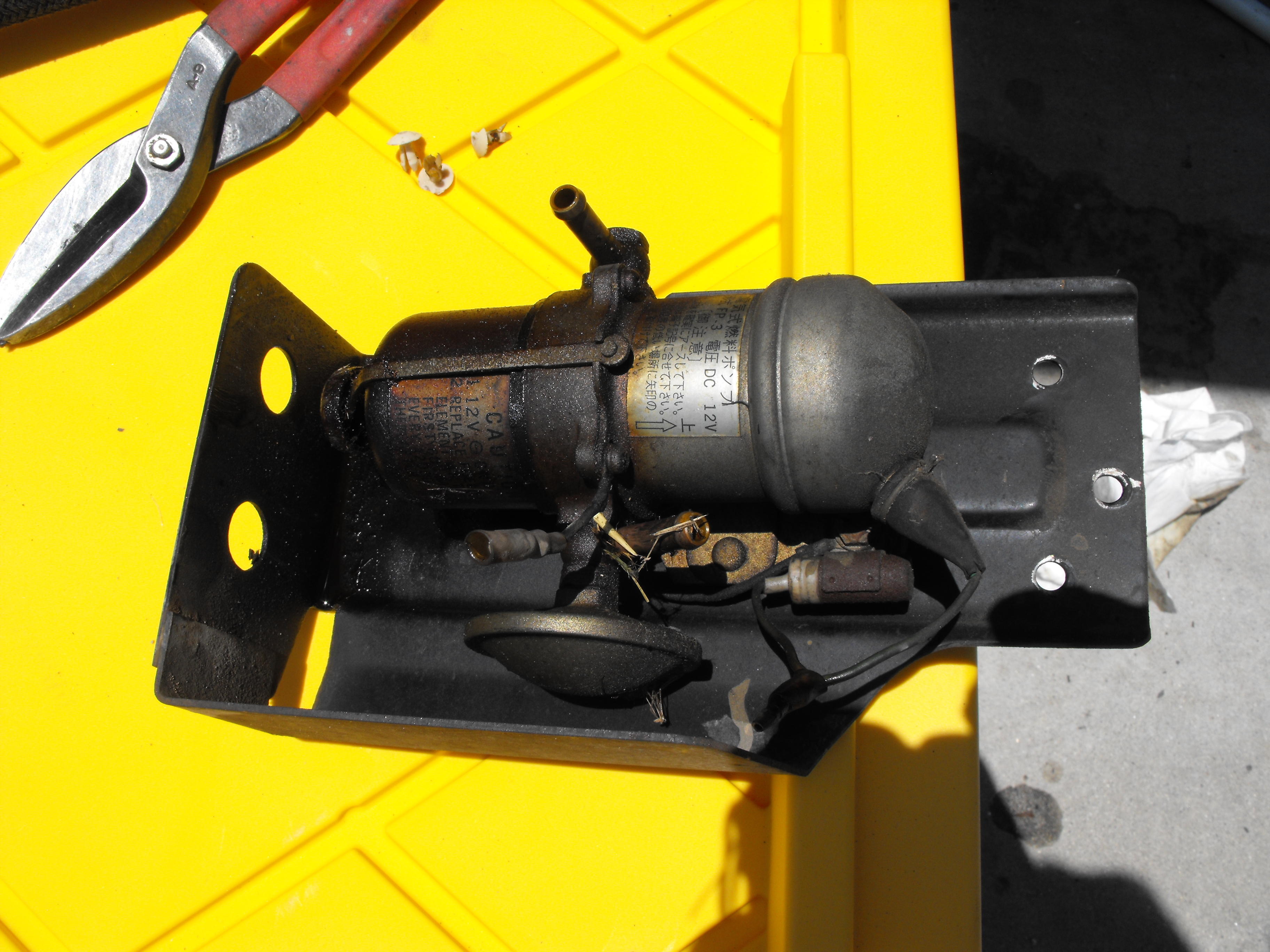

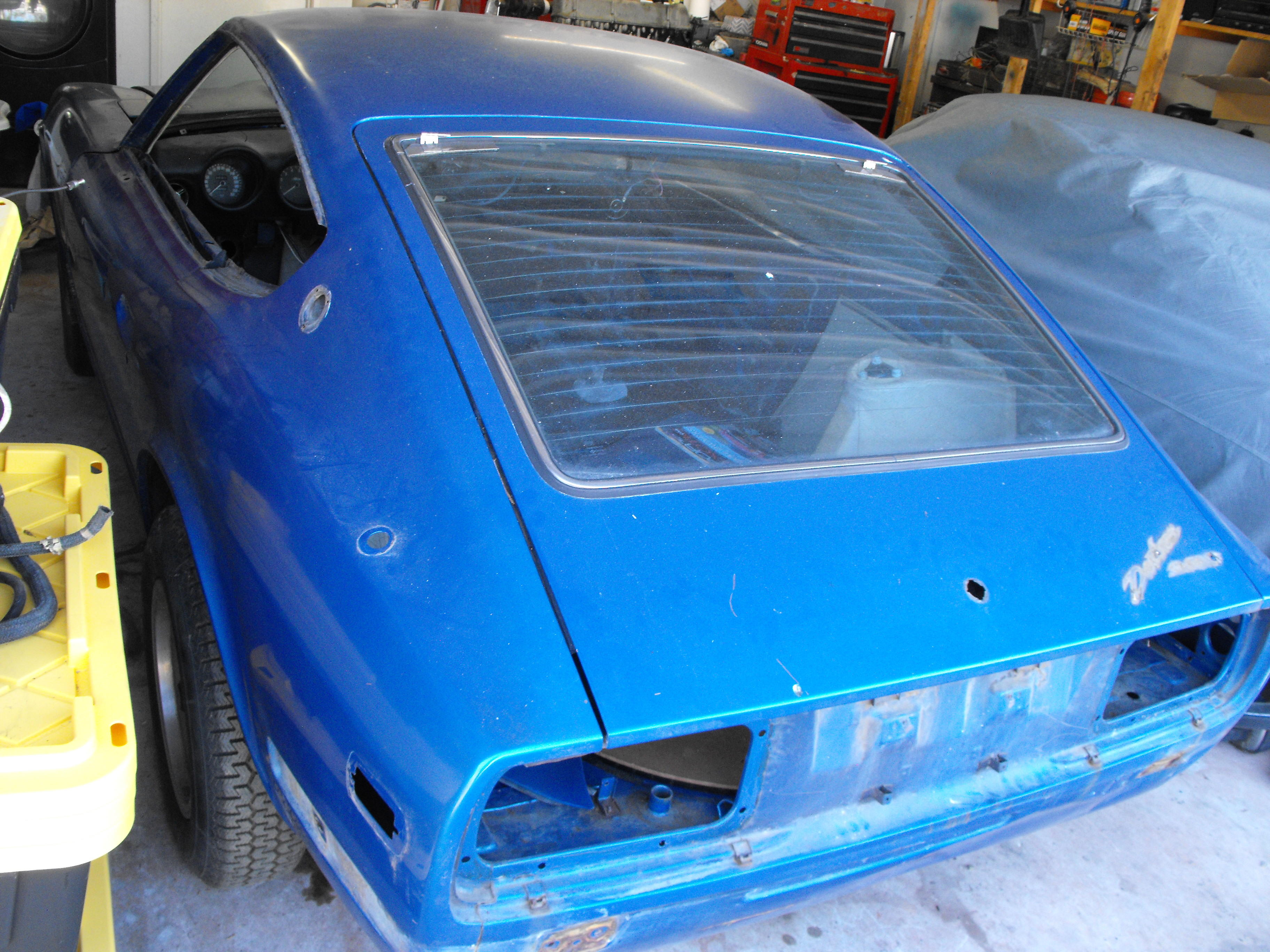

July 16, 20186 yr Author comment_553154 Got a lot of stuff removed last Thursday and today. Got the Fuel tank, fuel pump, hoses, diff, half-shafts, trans tunnel fuel and brake lines, seats and steering column removed, among other things. Took some good pics of the fuel pump since that is unique to the '73 (as opposed to the '70-72). Also took some good pics of the steering column wires because, as we know, the green wire connects to the white wire. Now I just have to remove the dash, front and rear glass and interior vinyl and that will be it for the part removal. I will clean things up and get most of the grease and dirt off before I transport the body to Miguel. I am hoping I can get this to the paint shop this Thursday. The underside was pretty dirty with caked oil, so that may take a bit of time. It's interesting to follow all the Flat Top 'banter'. It will make the final results all the more exciting once it is complete. @CHL240Z, Yes, I am keeping Miguel busy. My white Z is down there already. Now it will have company. Link to comment https://www.classiczcars.com/forums/topic/60309-were-bringin-back-the-flat-tops/?&page=4#findComment-553154 Share on other sites More sharing options...
