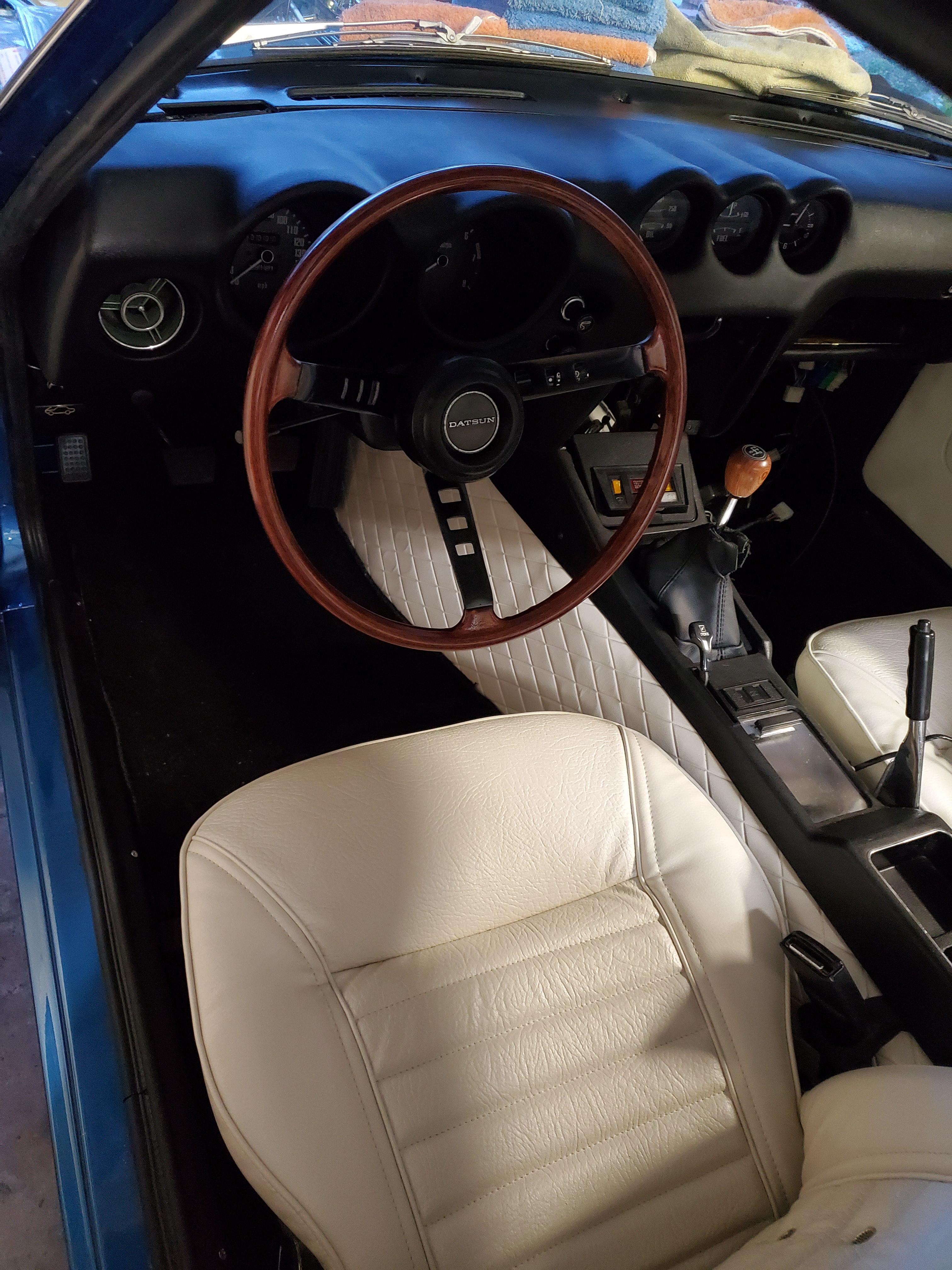

June 10, 20195 yr comment_577373 A photo of the Z from 1973 showing the steering wheel: I did not really like the "feel" of the bare steering wheel, so in 1974 or 1975 I installed a black wheel cover for a better grip. Always had a wheel cover on from then until Motorman7 took it off last year. (I believe I replaced it once during the time I had it.) So for 44 years, it had that black cover on the steering wheel. (and 170,000+ miles). That and heat during its outdoor storage period might explain why it was "dark" for Motorman7. photo from arrival at Motorman7 (the interior is looking better now...:-): Edited June 10, 20195 yr by jayhawk Link to comment https://www.classiczcars.com/forums/topic/60309-were-bringin-back-the-flat-tops/?&page=42#findComment-577373 Share on other sites More sharing options...

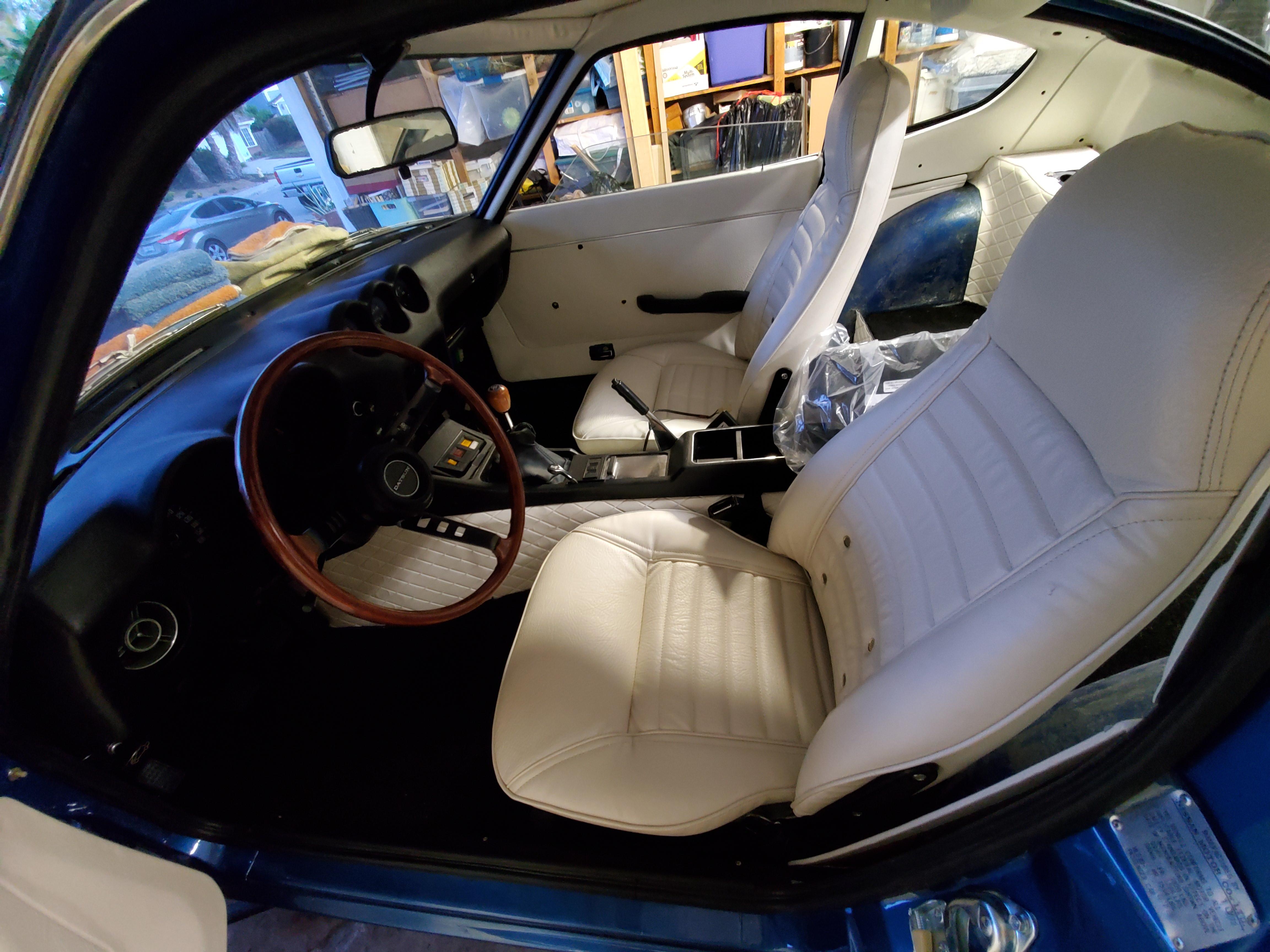

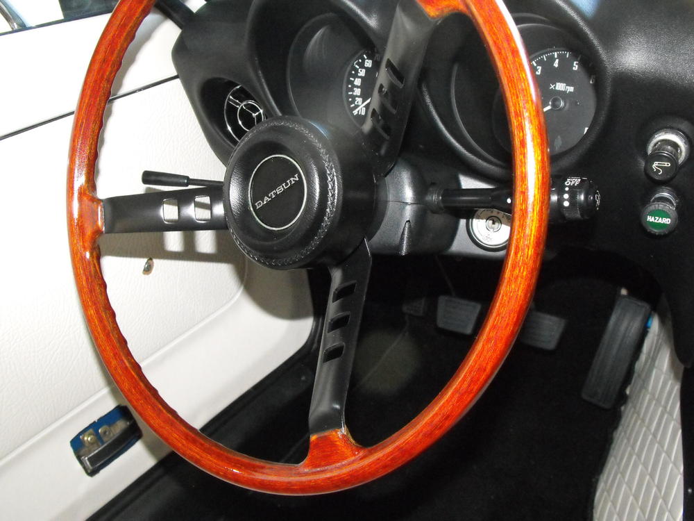

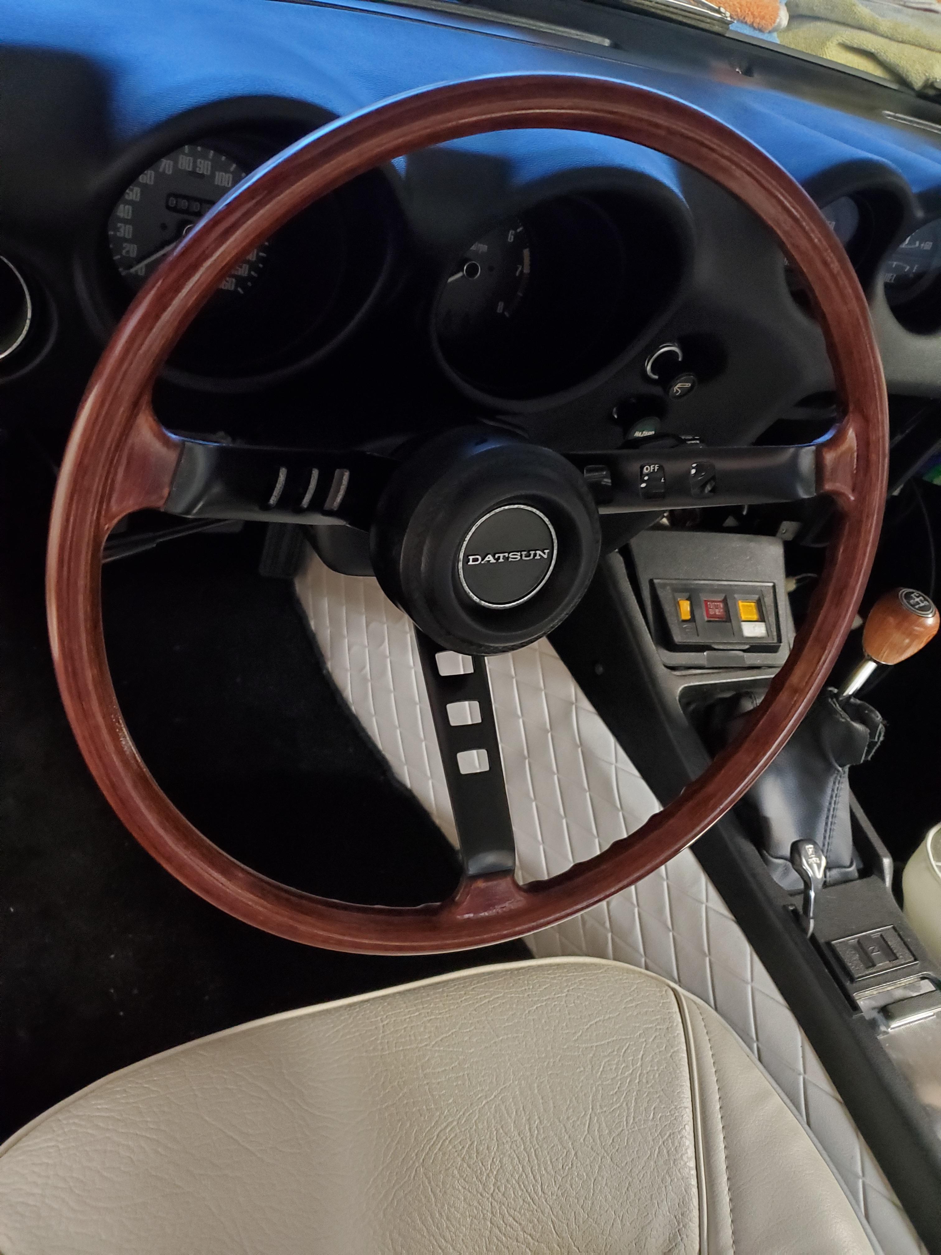

June 12, 20195 yr Author comment_577487 Got the steering wheel finished up. Link to comment https://www.classiczcars.com/forums/topic/60309-were-bringin-back-the-flat-tops/?&page=42#findComment-577487 Share on other sites More sharing options...

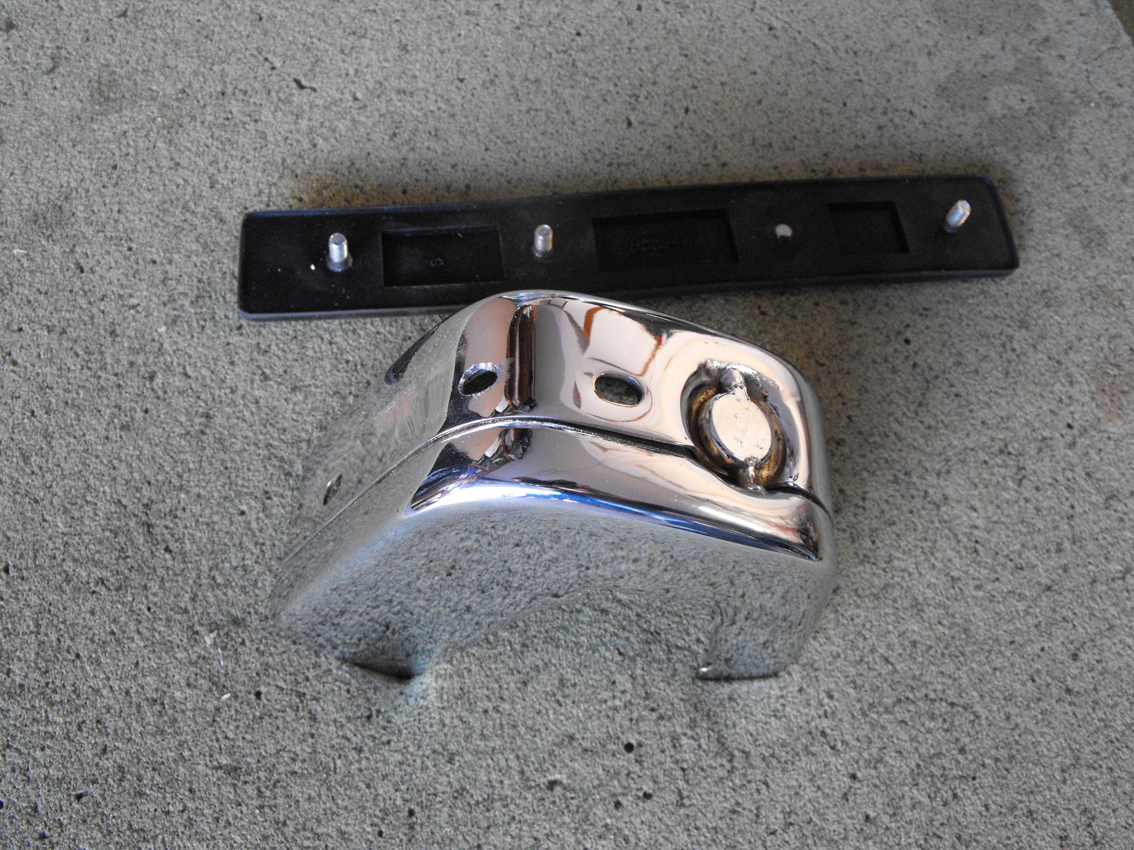

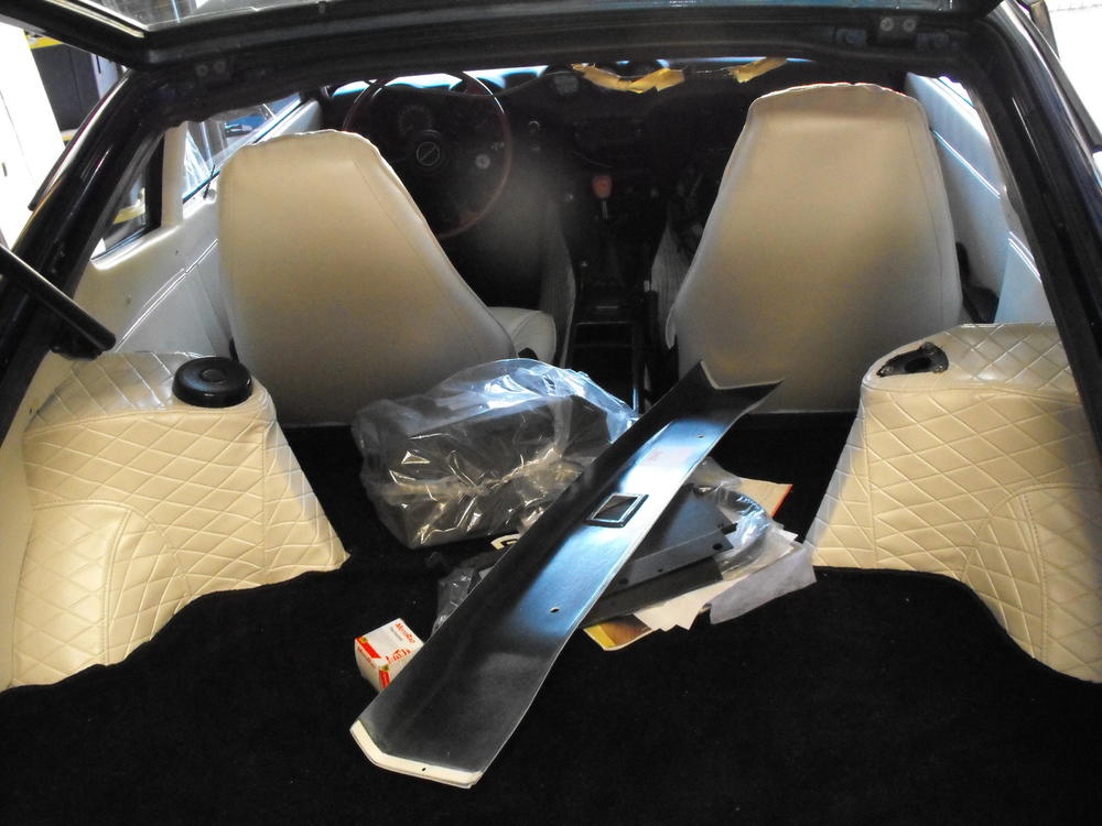

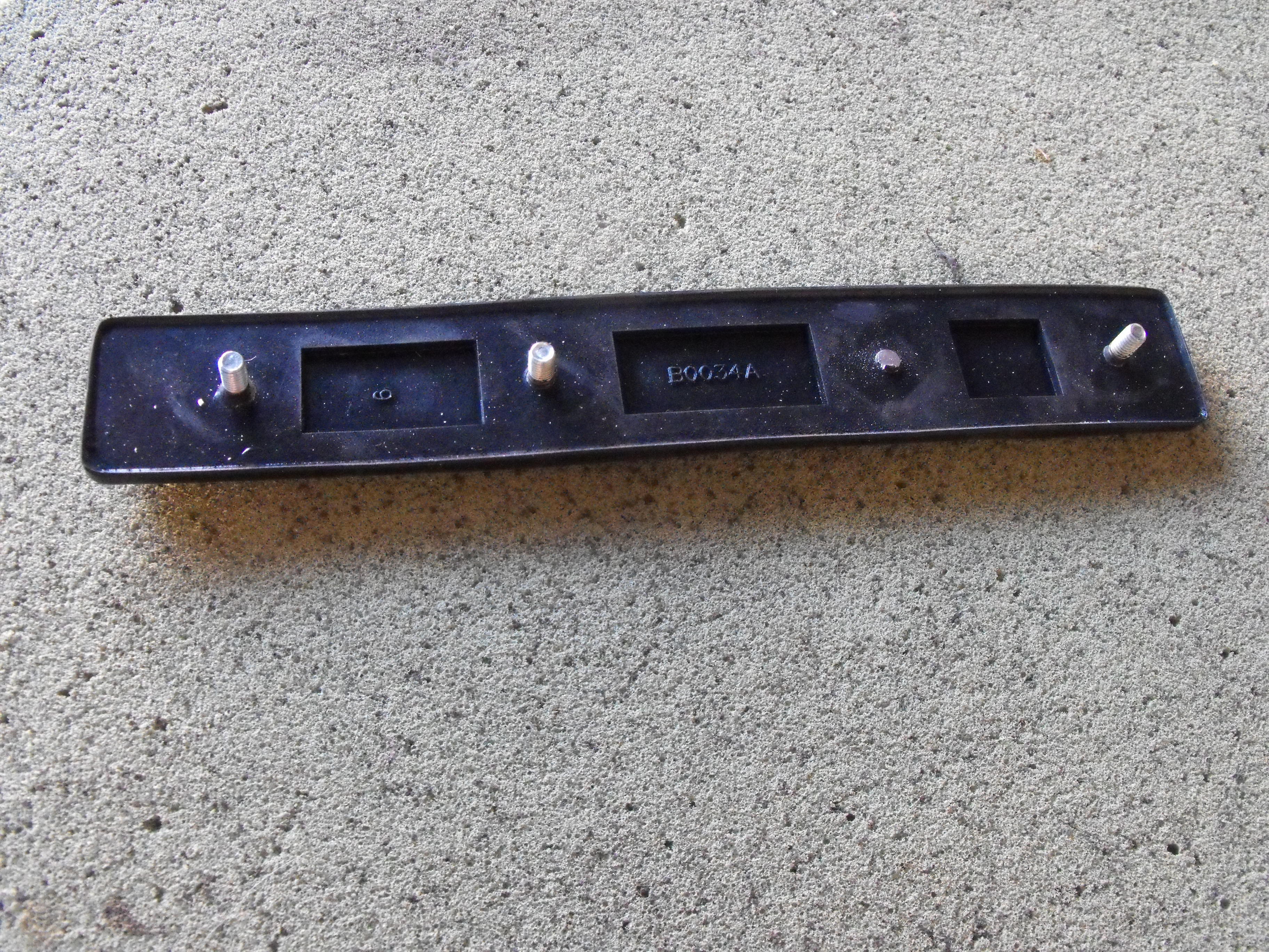

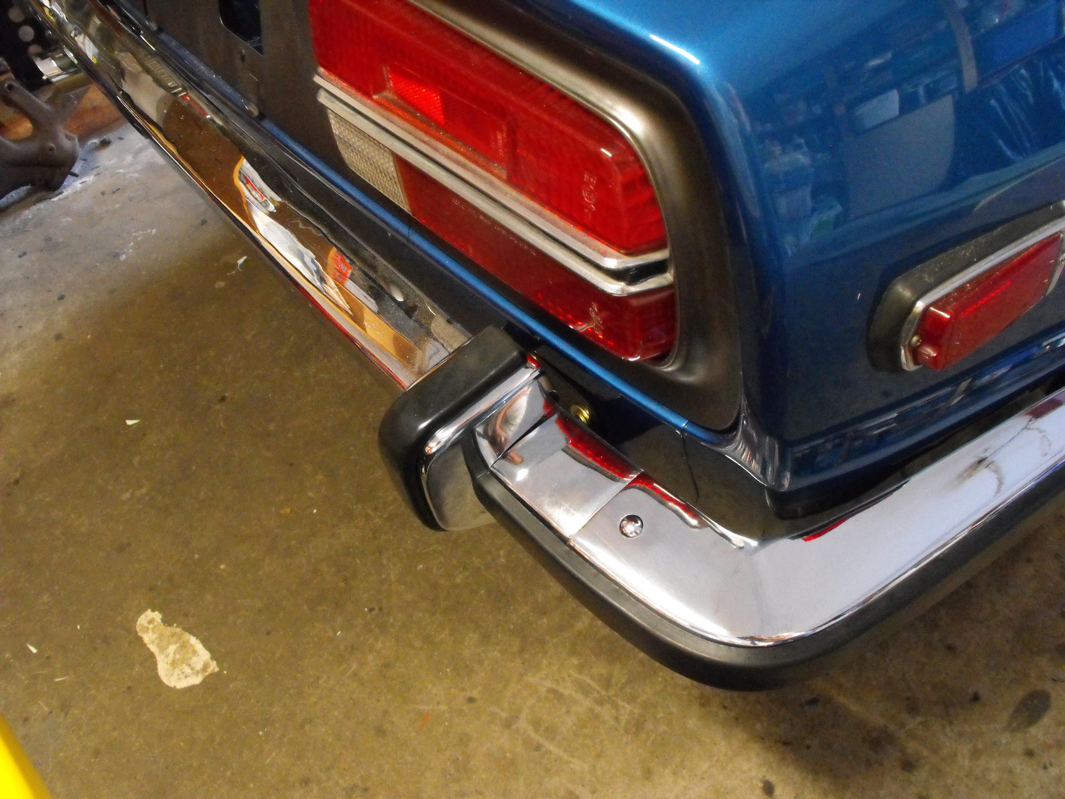

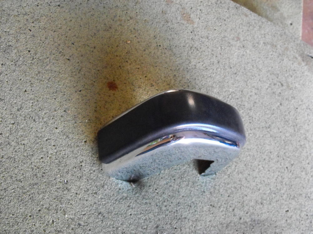

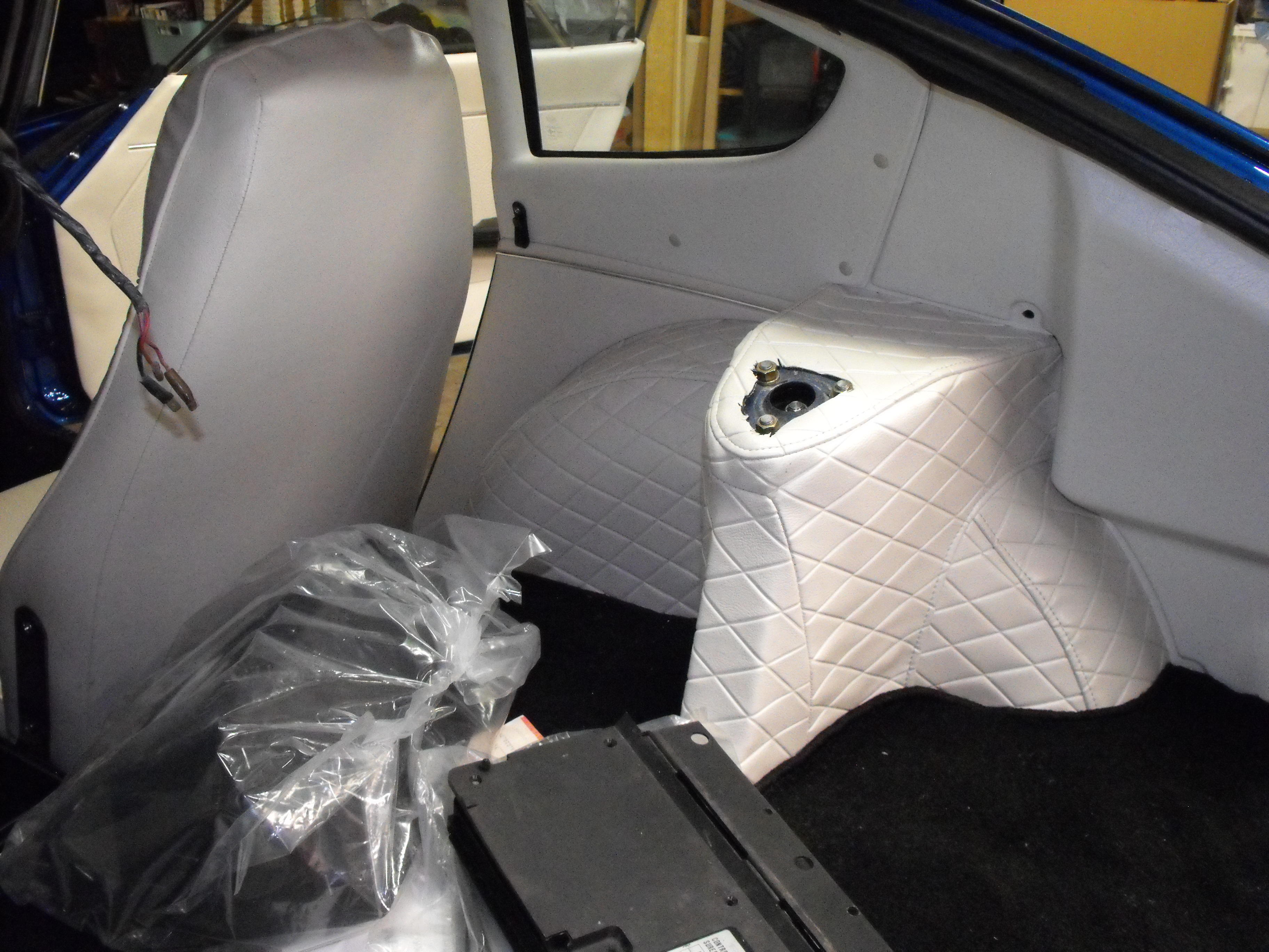

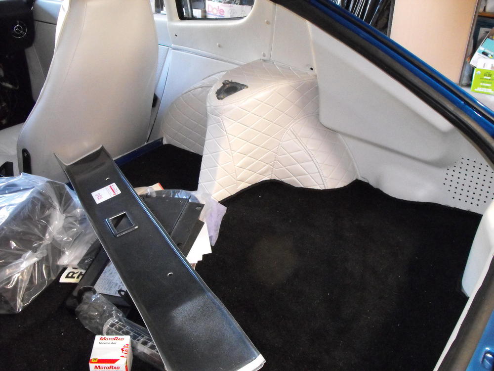

June 14, 20195 yr Author comment_577637 The rubber piece for the '73 bumperette's is impossible to find. So, I figured I would order the earlier (70-72) bumperette rubber and see how that fit. Actually, it fit pretty well. The length of the rubber strip is exactly the same and the two end studs are also in the correct location for attachment. However, there are two center studs on early rubber and just one on the '73, and the locations are different. To make the early rubber work on the '73, I cut off one of the studs (The one that sits on top of the metal stud that attaches part to bumper) and drilled a hole in the bumperette where the other center stud would land. This worked very well and am pretty happy with the results. I put in the last of the vinyl and panels (just a few final fasteners and rivets to install). I ended up going to the local auto upholstery shop to have them hem up the wheel well cover portion that had the missing hem. It took them just 10 mins and was cheap, $10. The vinyl was fairly easy to put in, the panels were again a challenge. The holes do not line up well. I will probably send a note of to the manufacturer, letting them know about this issue. The new chrome vents came in.....thanks @Zup I will pick up the last up my plating items today along with the fenders. Edited June 14, 20195 yr by motorman7 Link to comment https://www.classiczcars.com/forums/topic/60309-were-bringin-back-the-flat-tops/?&page=42#findComment-577637 Share on other sites More sharing options...
June 15, 20195 yr comment_577670 You may want to try Z Car Source of Arizona. At the time about 3 years ago, only the left was available new. I had to re-drill a few holes and flip it to the other side, the end has a slight taper. Link to comment https://www.classiczcars.com/forums/topic/60309-were-bringin-back-the-flat-tops/?&page=42#findComment-577670 Share on other sites More sharing options...

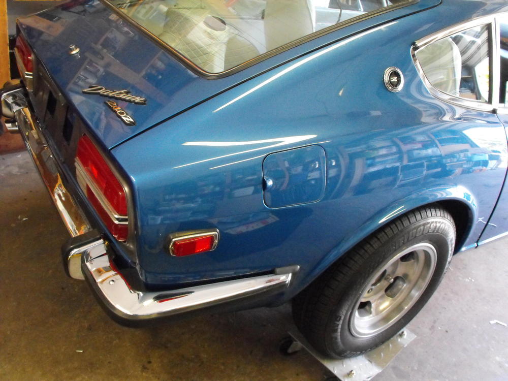

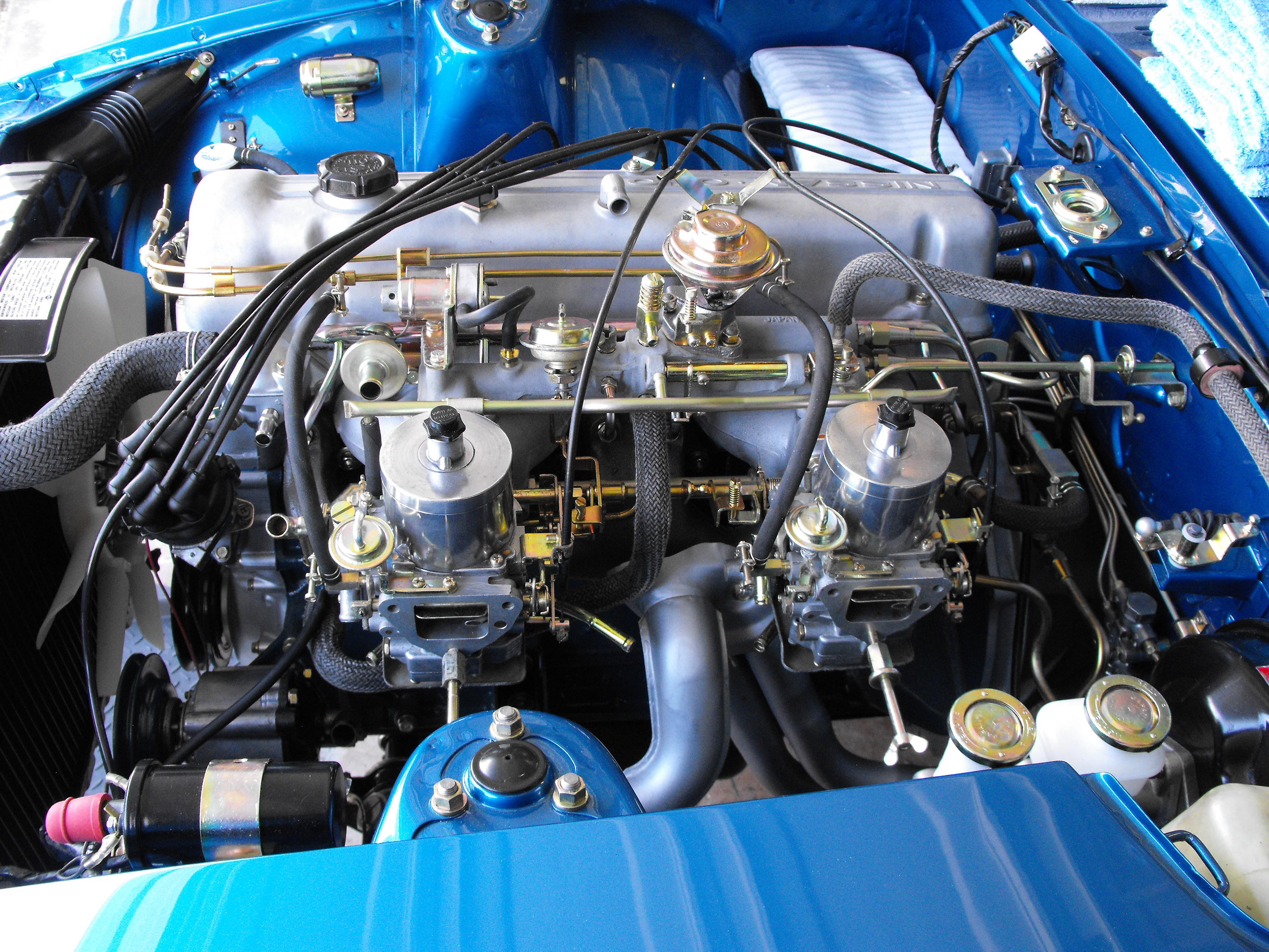

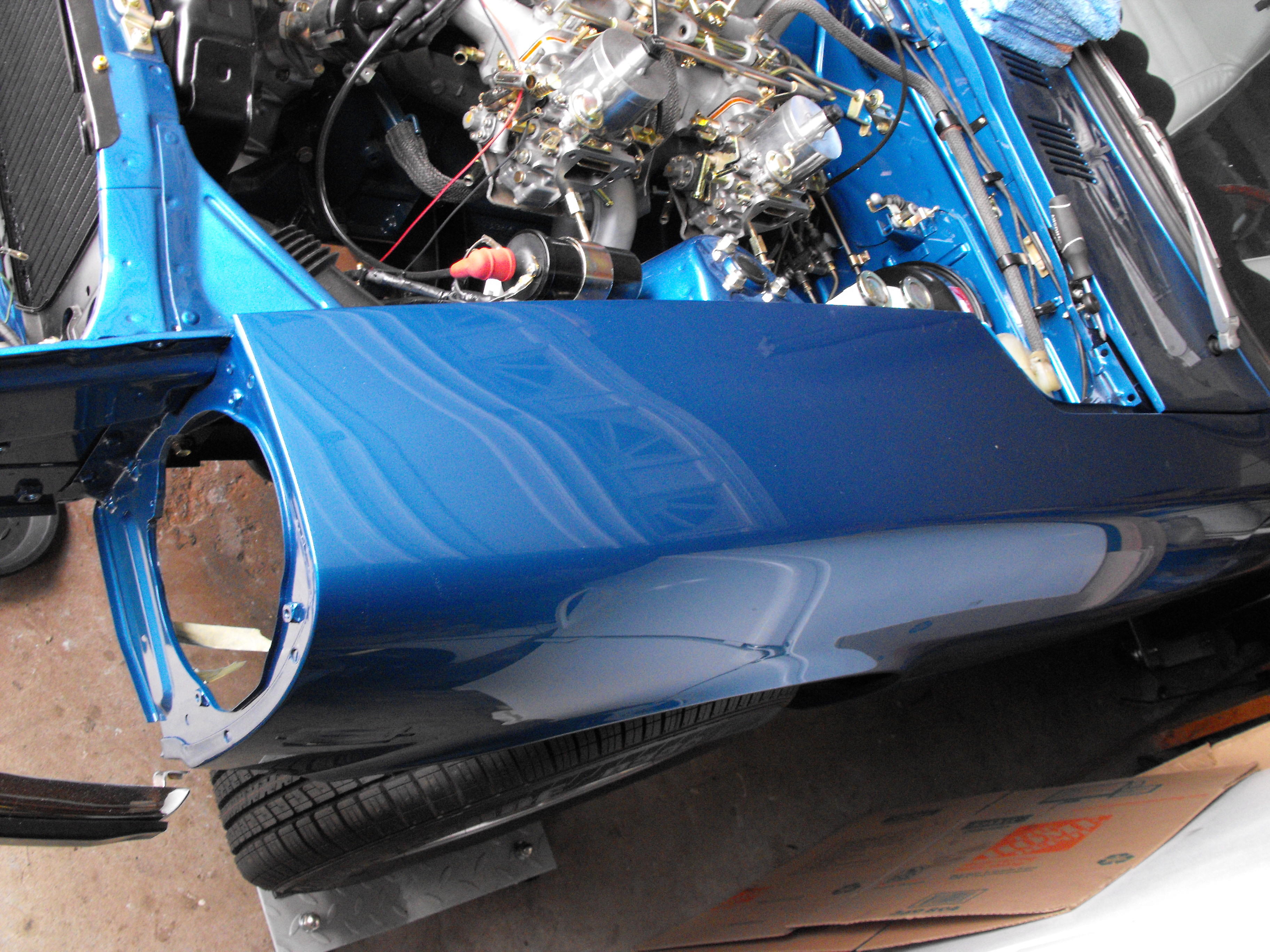

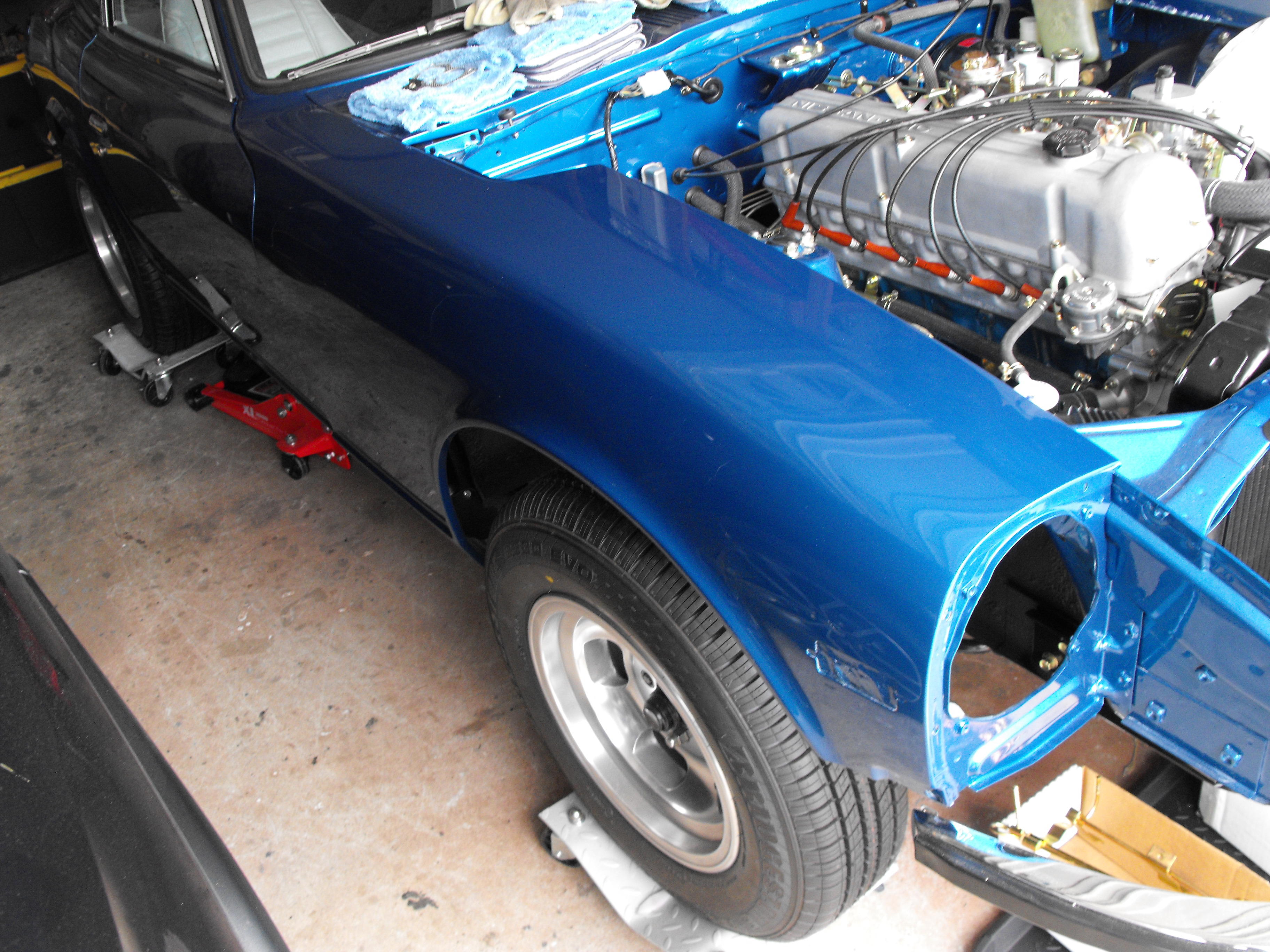

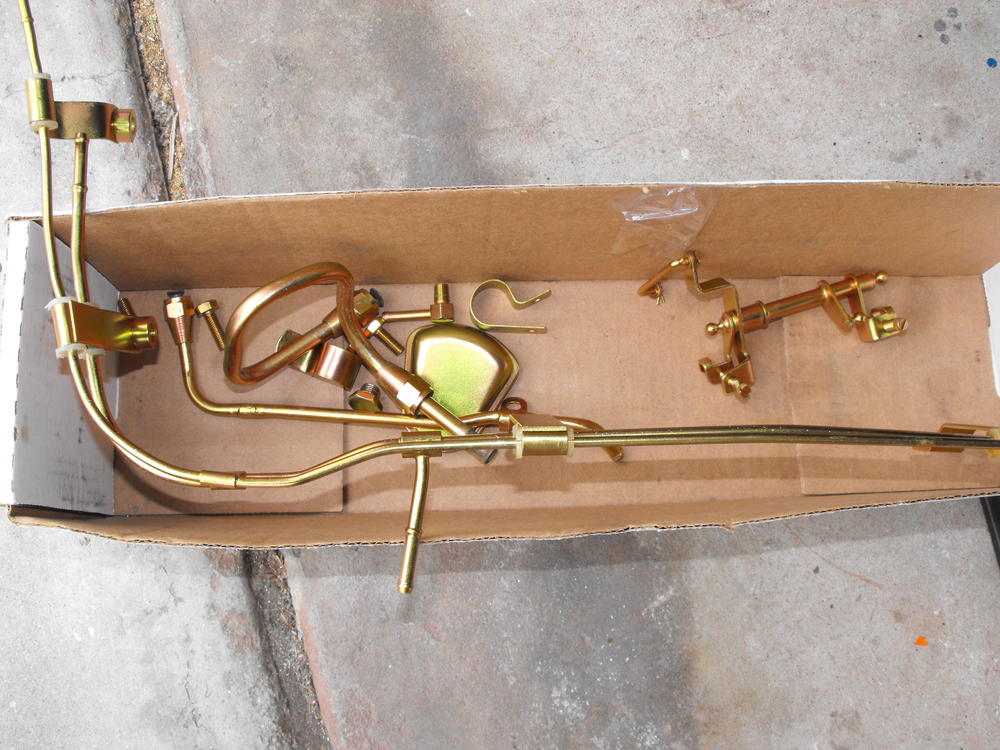

June 15, 20195 yr Author Popular Post comment_577721 Picked up the fenders, fuel door and hinges yesterday from paint shop. Fenders are just resting in place. Will probably wait till engine is done before I do actual install. Also got the last of my plated items. Will get most of the plated items on the engine tomorrow. Link to comment https://www.classiczcars.com/forums/topic/60309-were-bringin-back-the-flat-tops/?&page=42#findComment-577721 Share on other sites More sharing options...

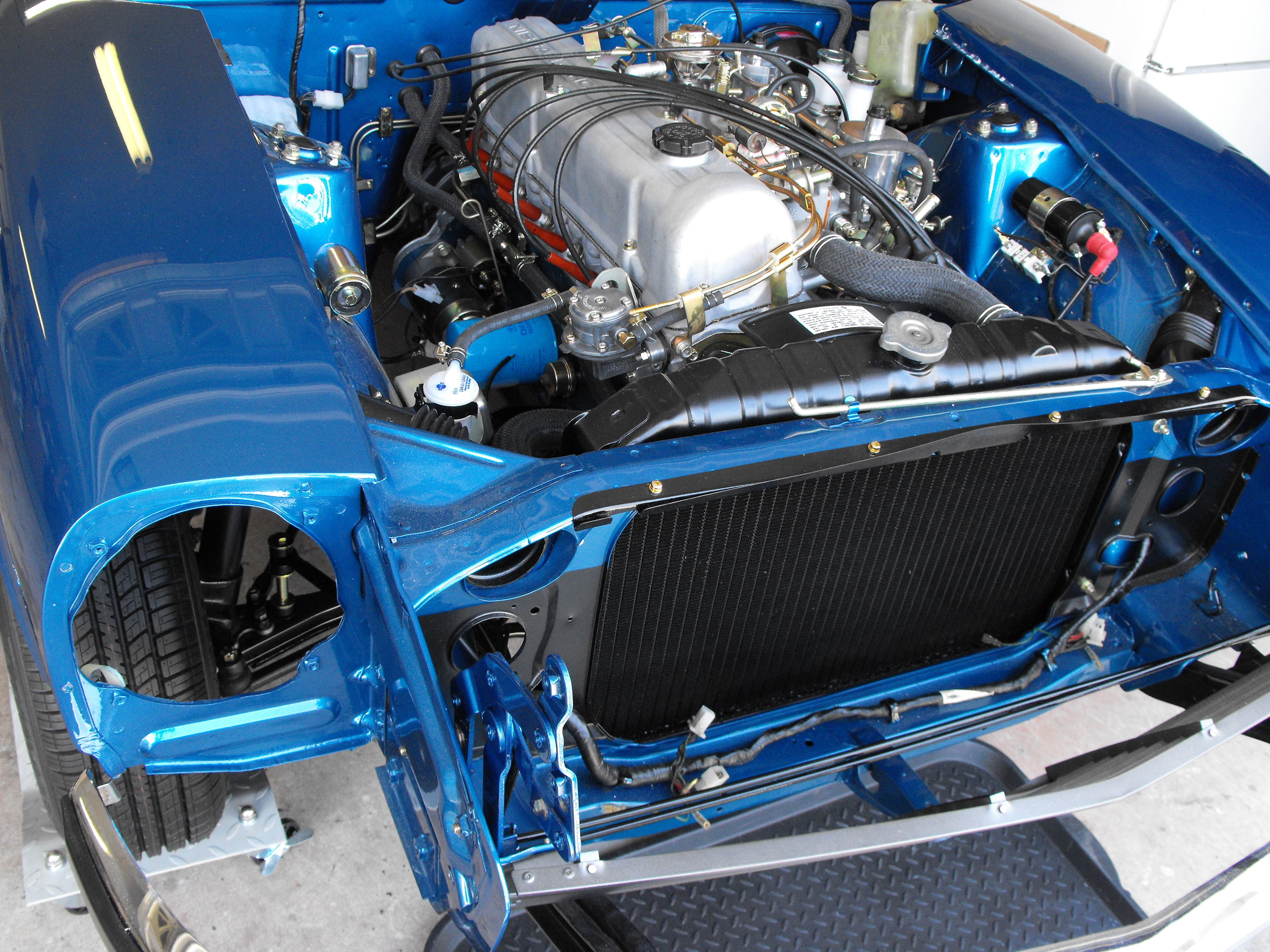

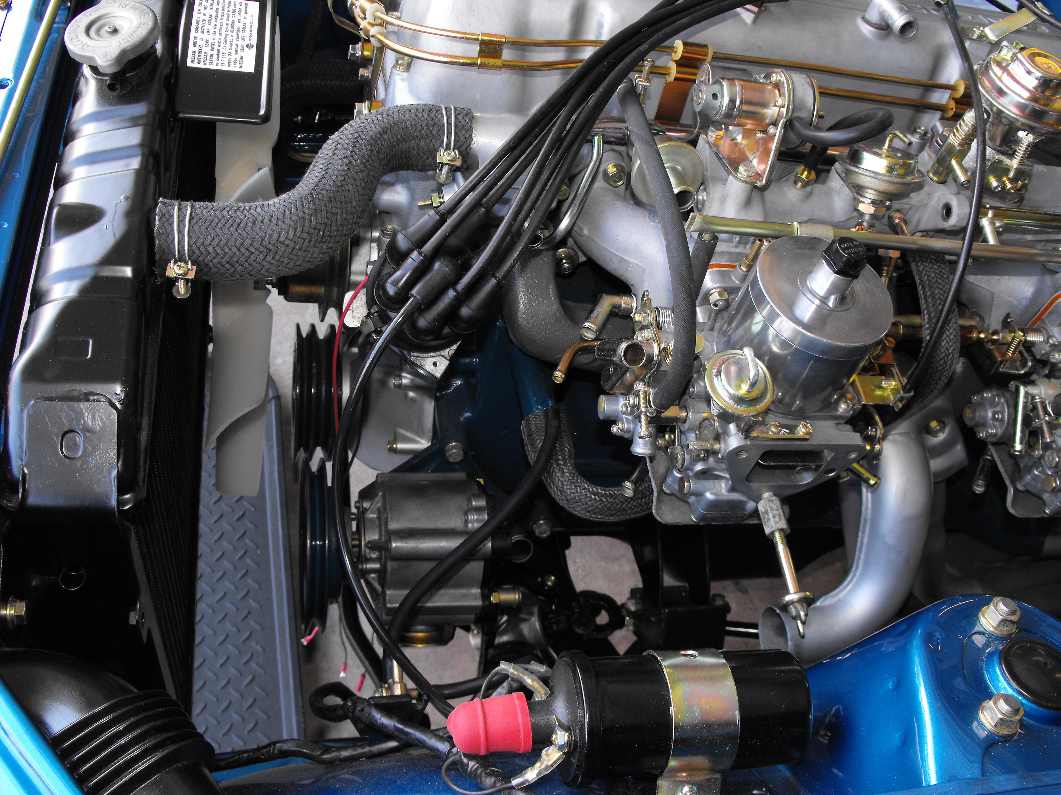

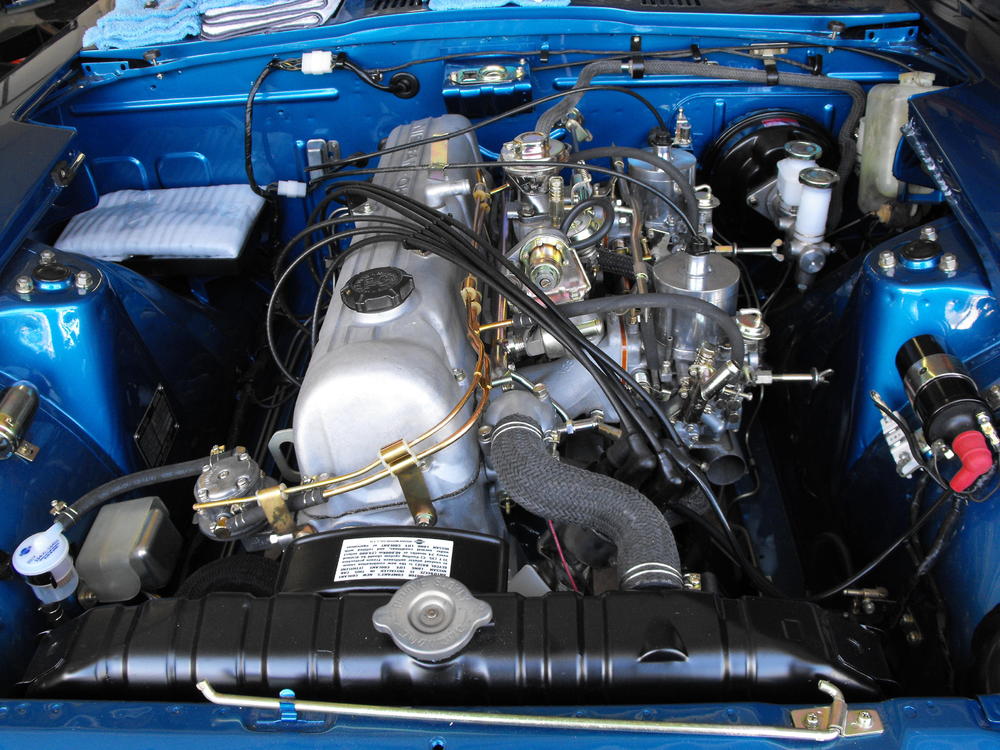

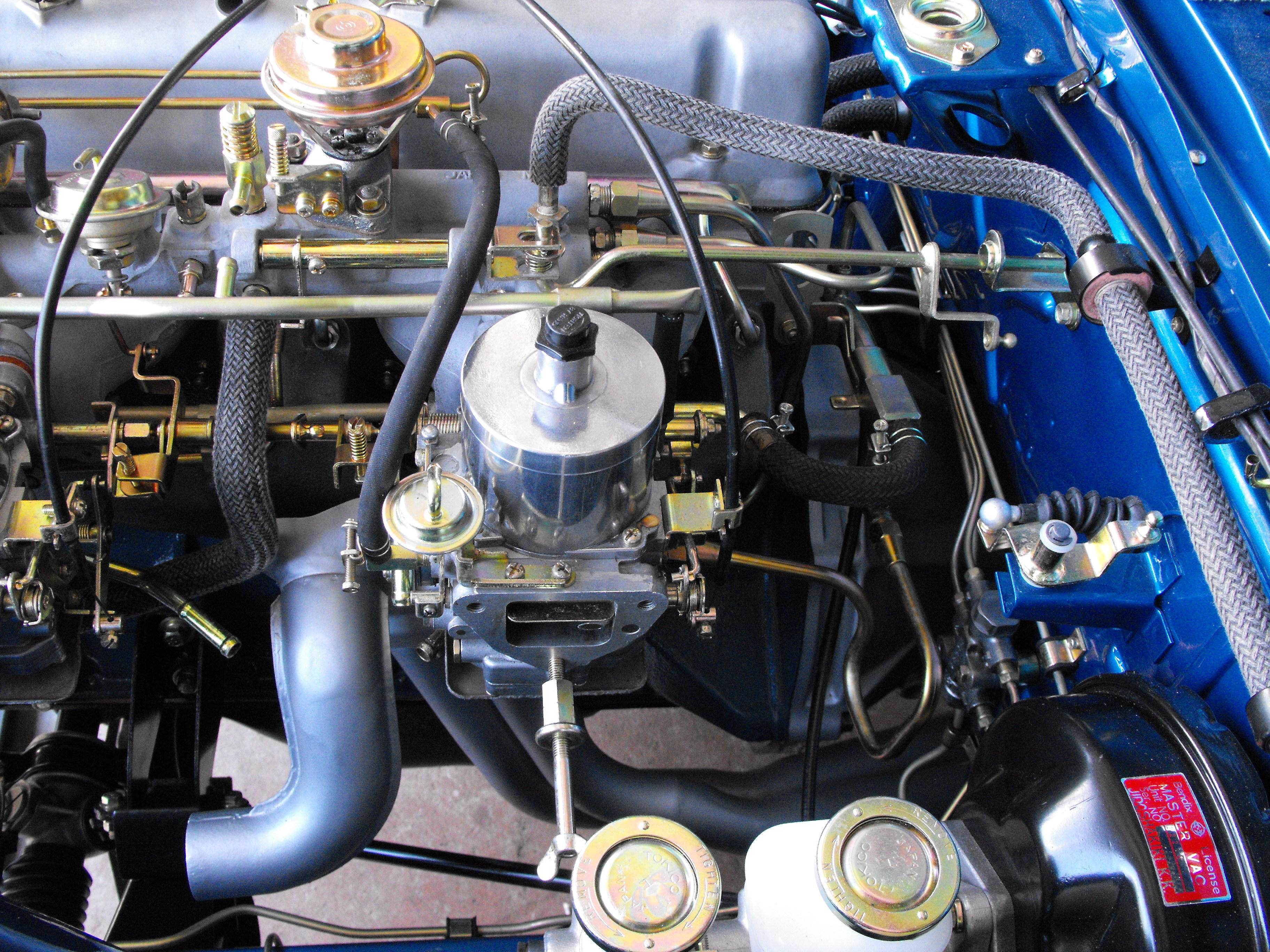

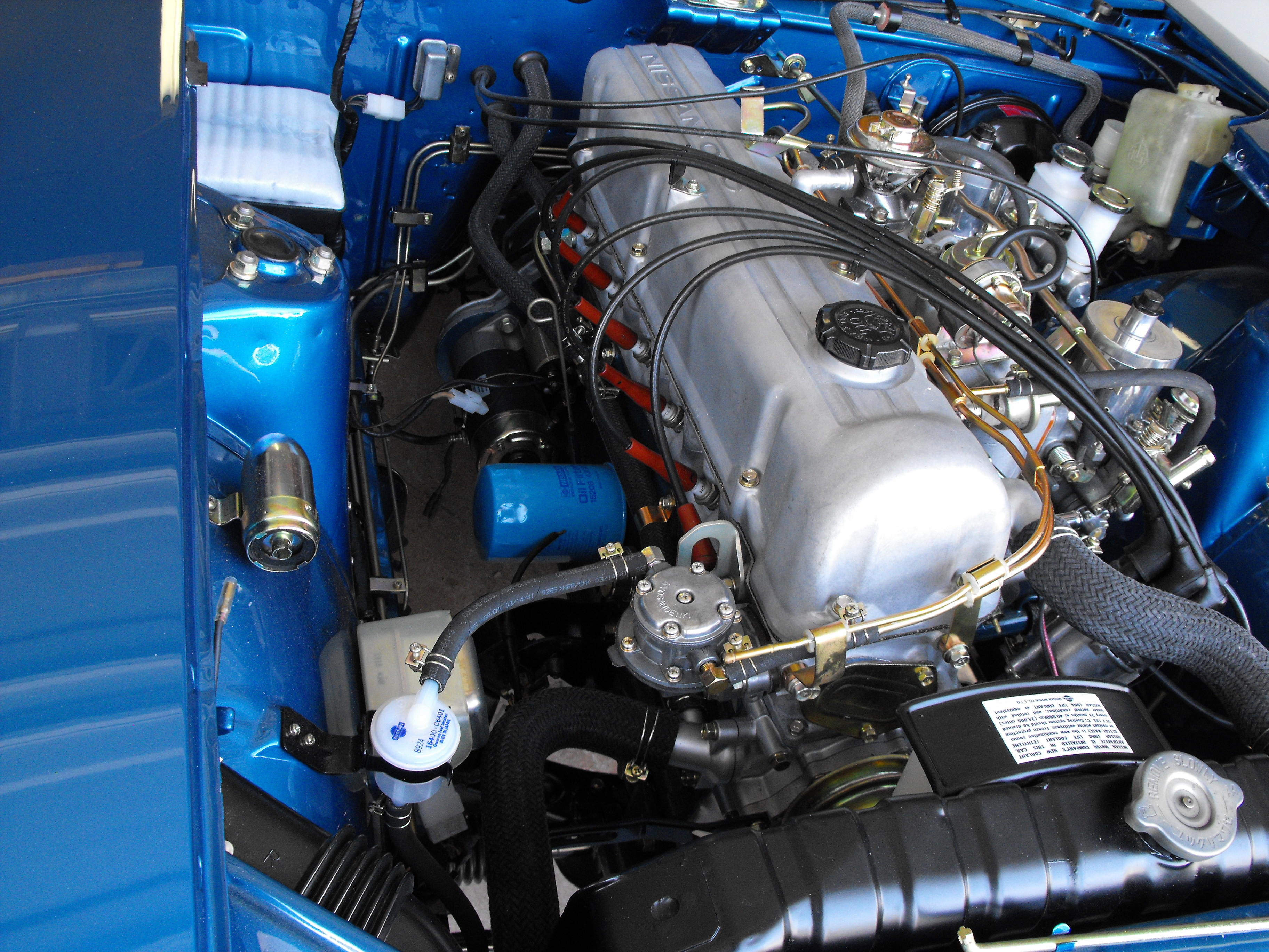

June 16, 20195 yr Author comment_577815 Installed the plated parts. Started the install of the plumbing for the flat tops. Boy, lots of tubes here. Here are the latest pics. Also installed the fuel door and hinges. Link to comment https://www.classiczcars.com/forums/topic/60309-were-bringin-back-the-flat-tops/?&page=42#findComment-577815 Share on other sites More sharing options...

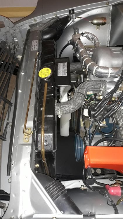

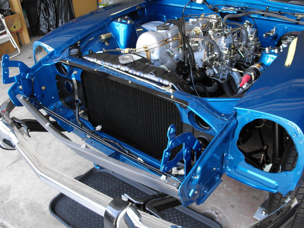

June 17, 20195 yr comment_577825 Out of curiosity, what are the 4 screws on top of the black painted radiator support used for? Link to comment https://www.classiczcars.com/forums/topic/60309-were-bringin-back-the-flat-tops/?&page=42#findComment-577825 Share on other sites More sharing options...
June 17, 20195 yr comment_577828 Looks great. Can't wait hear how it runs! Link to comment https://www.classiczcars.com/forums/topic/60309-were-bringin-back-the-flat-tops/?&page=42#findComment-577828 Share on other sites More sharing options...
June 17, 20195 yr Author comment_577832 1 hour ago, 240Z73 said: Out of curiosity, what are the 4 screws on top of the black painted radiator support used for? The four screws secure an air dam that is above the radiator. It has the hood profile on top. I am guessing it reduces airflow into the engine bay to improve cooling. I think it is unique to the '73 and '74 model years. I am unfamiliar with it and can't find it in the manuals. @Carl Beck is more familiar with this. I need to find out if I need to attach a weather strip to the top of it. I would think the weather strip would be similar to the cowl weather strip. Link to comment https://www.classiczcars.com/forums/topic/60309-were-bringin-back-the-flat-tops/?&page=42#findComment-577832 Share on other sites More sharing options...
June 17, 20195 yr comment_577833 41 minutes ago, motorman7 said: The four screws secure an air dam that is above the radiator. It has the hood profile on top. I am guessing it reduces airflow into the engine bay to improve cooling. I think it is unique to the '73 and '74 model years. I am unfamiliar with it and can't find it in the manuals. @Carl Beck is more familiar with this. I need to find out if I need to attach a weather strip to the top of it. I would think the weather strip would be similar to the cowl weather strip. Correct - the "lip" on the radiator core support is one of the items first tried by the Nissan Field Service teams working with the Local Datsun Dealership mechanics. The idea block air flow over the top of the radiator and core support - to force more of it through the radiator. Yes they had a rubber seal that mated to the hood. The one’s installed at the Dealerships were bolted on or screwed on - on later 73’s they were spot welded on at the factory as standard equipment. As far as I can see the factory started adding them around 12/72 or 01/73. Carl B. Edited June 17, 20195 yr by Carl Beck Link to comment https://www.classiczcars.com/forums/topic/60309-were-bringin-back-the-flat-tops/?&page=42#findComment-577833 Share on other sites More sharing options...
June 17, 20195 yr comment_577841 4 hours ago, Carl Beck said: Correct - the "lip" on the radiator core support is one of the items first tried by the Nissan Field Service teams working with the Local Datsun Dealership mechanics. The idea block air flow over the top of the radiator and core support - to force more of it through the radiator. Yes they had a rubber seal that mated to the hood. The one’s installed at the Dealerships were bolted on or screwed on - on later 73’s they were spot welded on at the factory as standard equipment. As far as I can see the factory started adding them around 12/72 or 01/73. A photo confirming some of Carl's information. On my 6/73 build date 240z the radiator core support to hood seal attaches to a spot welded fin which matches the rise of the hood profile. (just to the left of the hood prop rod) Edited June 17, 20195 yr by Zup Link to comment https://www.classiczcars.com/forums/topic/60309-were-bringin-back-the-flat-tops/?&page=42#findComment-577841 Share on other sites More sharing options...
June 17, 20195 yr comment_577849 12 hours ago, Carl Beck said: Correct - the "lip" on the radiator core support is one of the items first tried by the Nissan Field Service teams working with the Local Datsun Dealership mechanics. The idea block air flow over the top of the radiator and core support - to force more of it through the radiator. Yes they had a rubber seal that mated to the hood. The one’s installed at the Dealerships were bolted on or screwed on - on later 73’s they were spot welded on at the factory as standard equipment. As far as I can see the factory started adding them around 12/72 or 01/73. Carl B. My car (the subject of this thread) was mfg'd 10/72, although the V3, kit which I recall included the fuel line insulation and the electric fuel pump, was not installed until July '74. (after returning from an 8 month Navy deployment). If the "lip" was part of the V3 kit, I never realized that. But I do not know when else that would have been installed. I just found the work order where the V3 kit was installed, although it has no details about what was in the V3 kit: Link to comment https://www.classiczcars.com/forums/topic/60309-were-bringin-back-the-flat-tops/?&page=42#findComment-577849 Share on other sites More sharing options...
