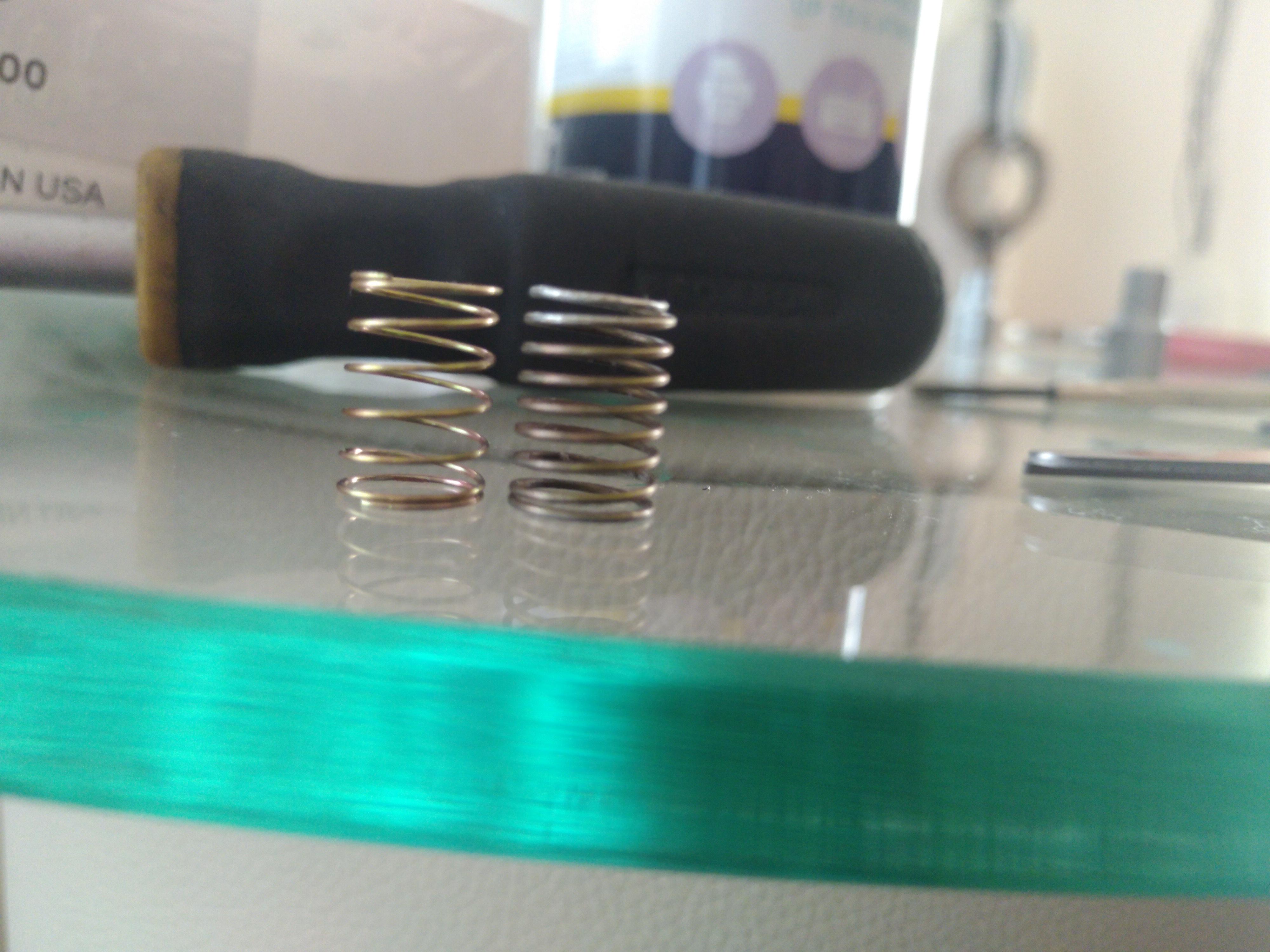

Hi I have two different power valves in my hands.  With and without green paint marks. The only difference is spring. Green marked is soft,  and valve can be closed with " lungs vacum ", the non mark is hard and can not be closed this way!  That is whay it stays opened on iddle,  and giving extra fuel,  making it Run rich. Two springs side by side
Edited by smola
Datsun changed the power valve a number of times trying to get it right. I think the "green dot" version is one of the later versions.
Here's a pic of one of my power valve springs. It looks like the one from your green paint mark version:
