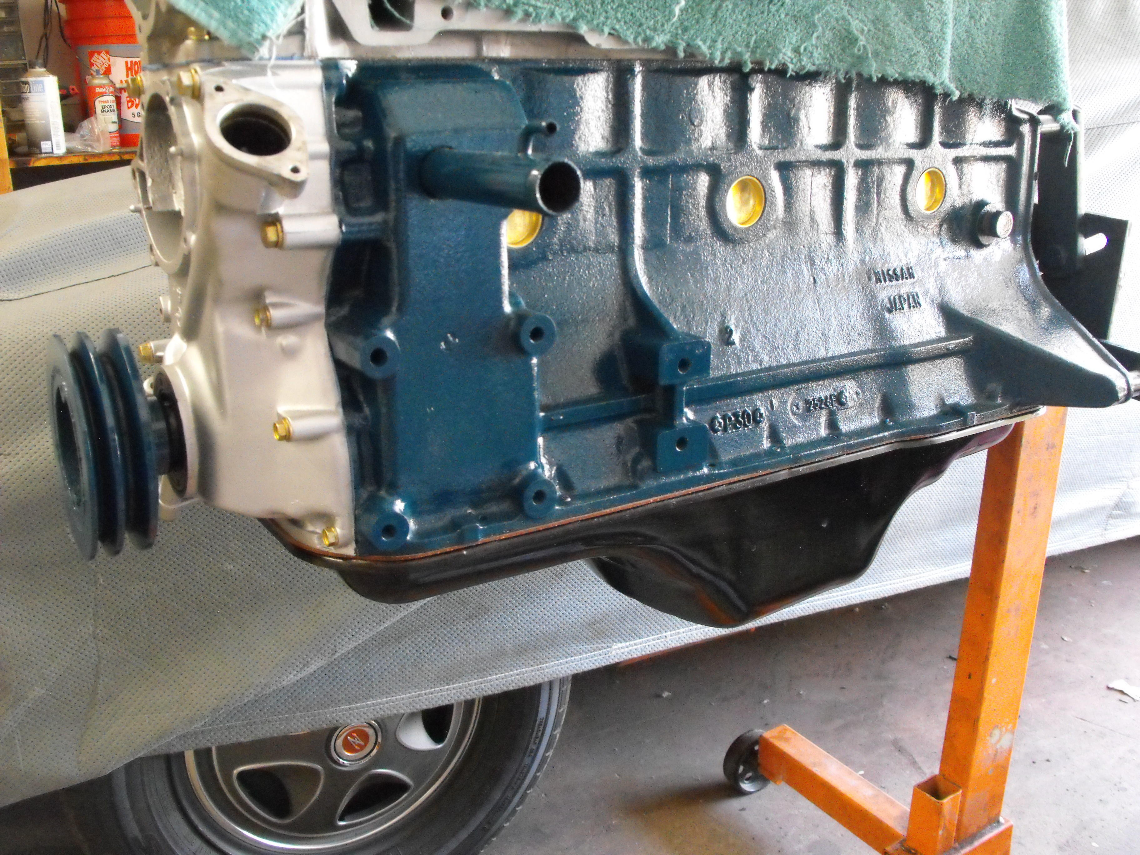

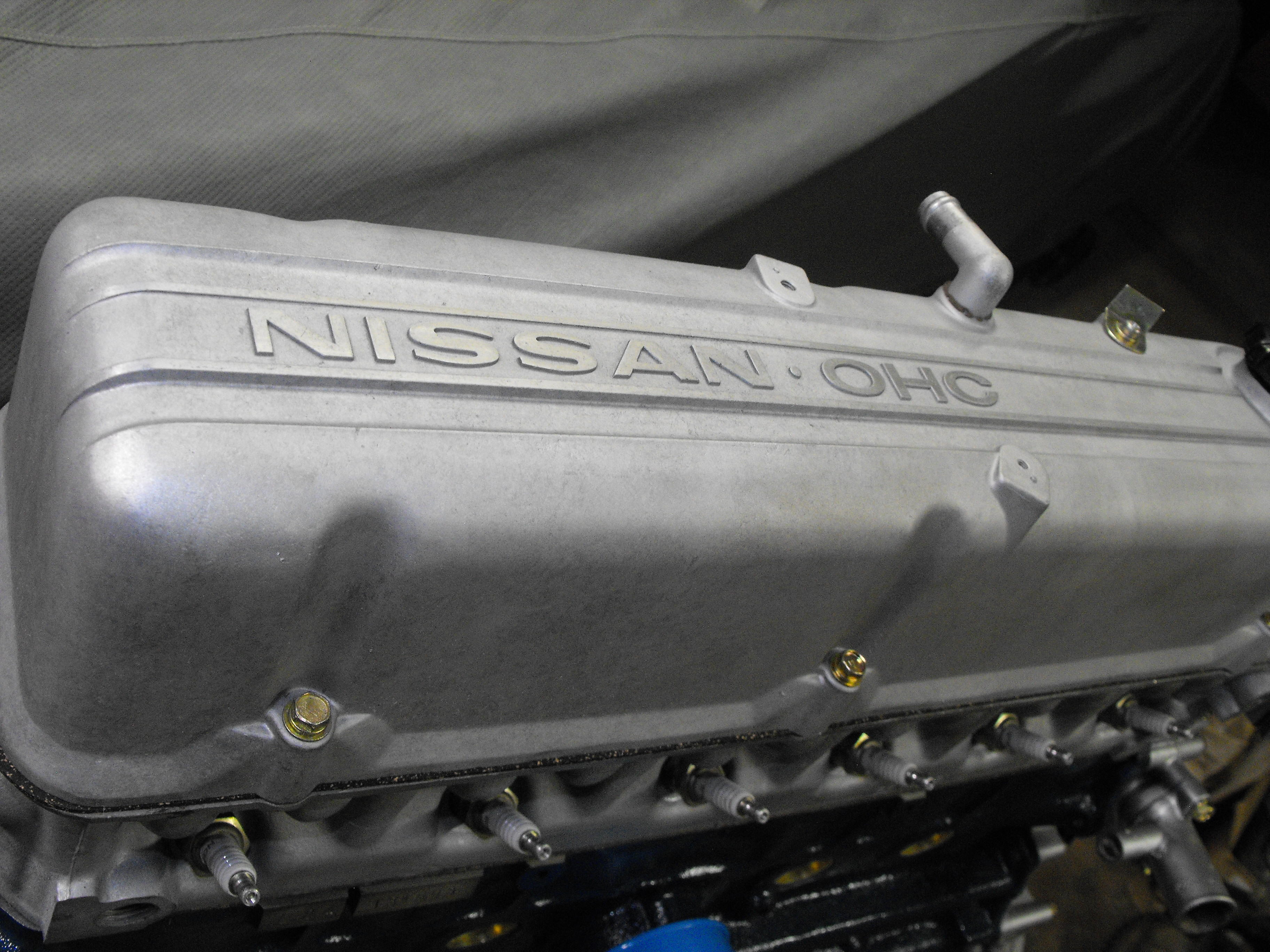

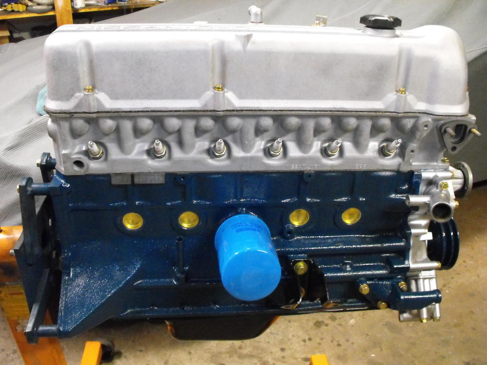

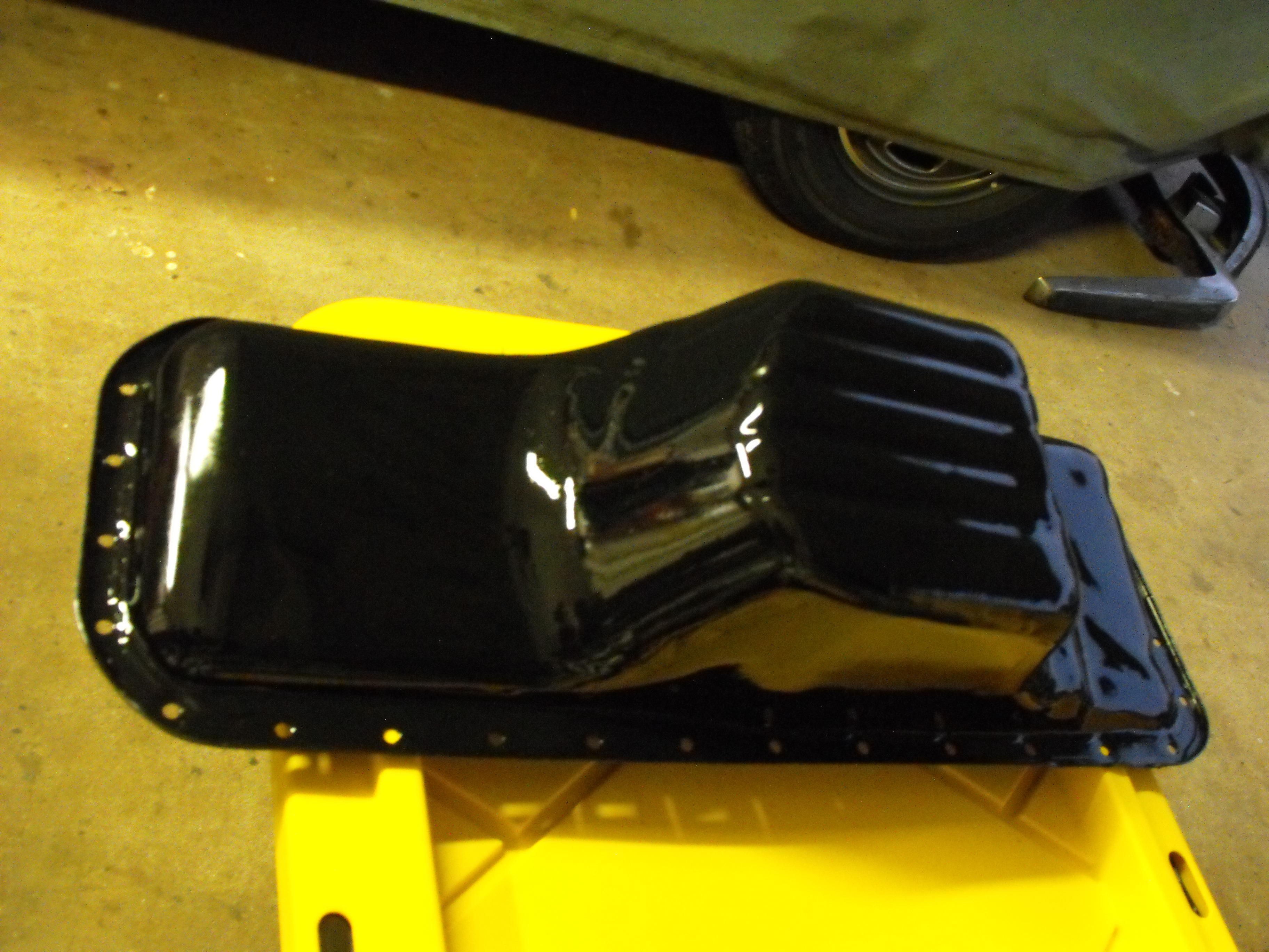

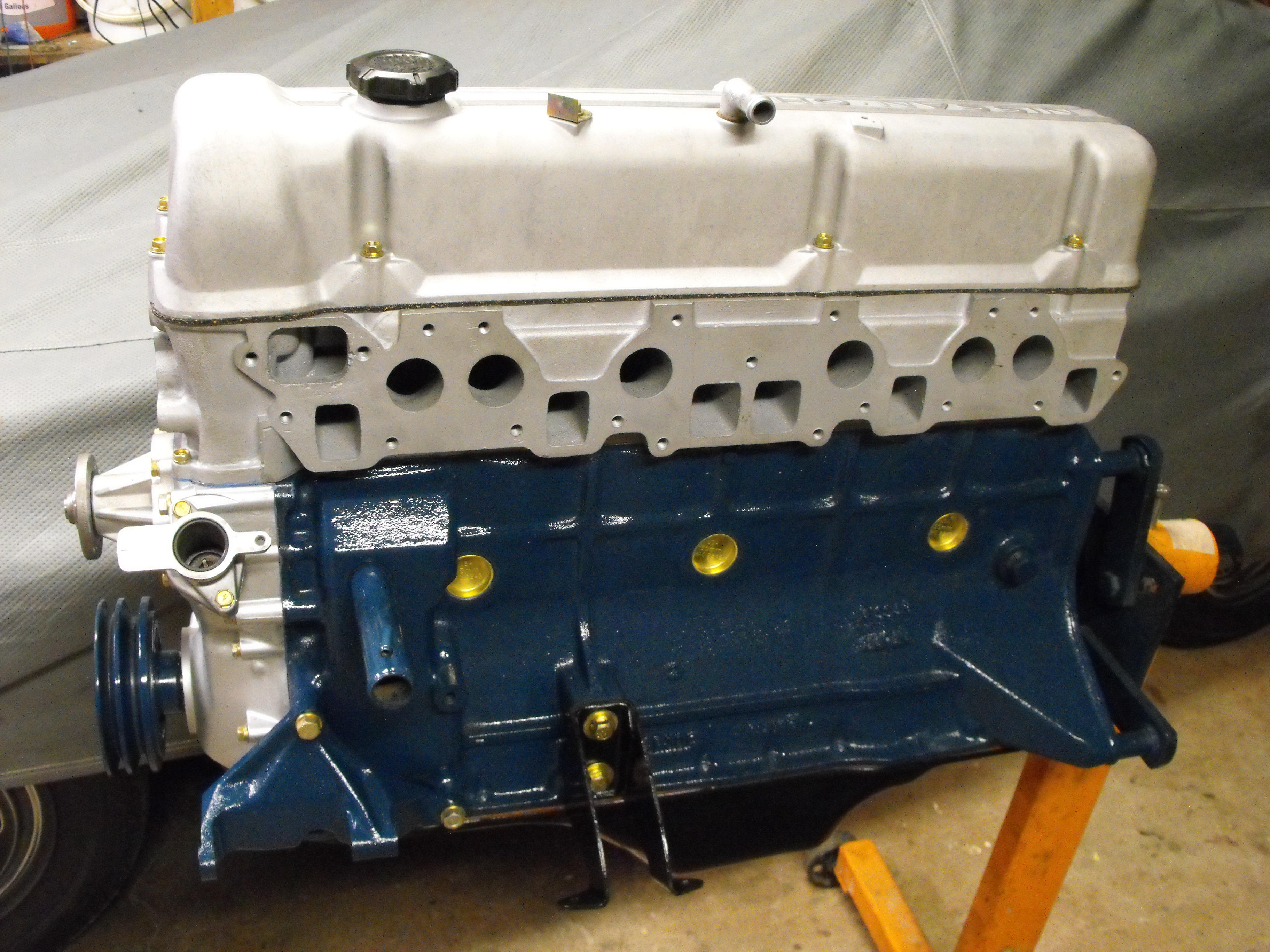

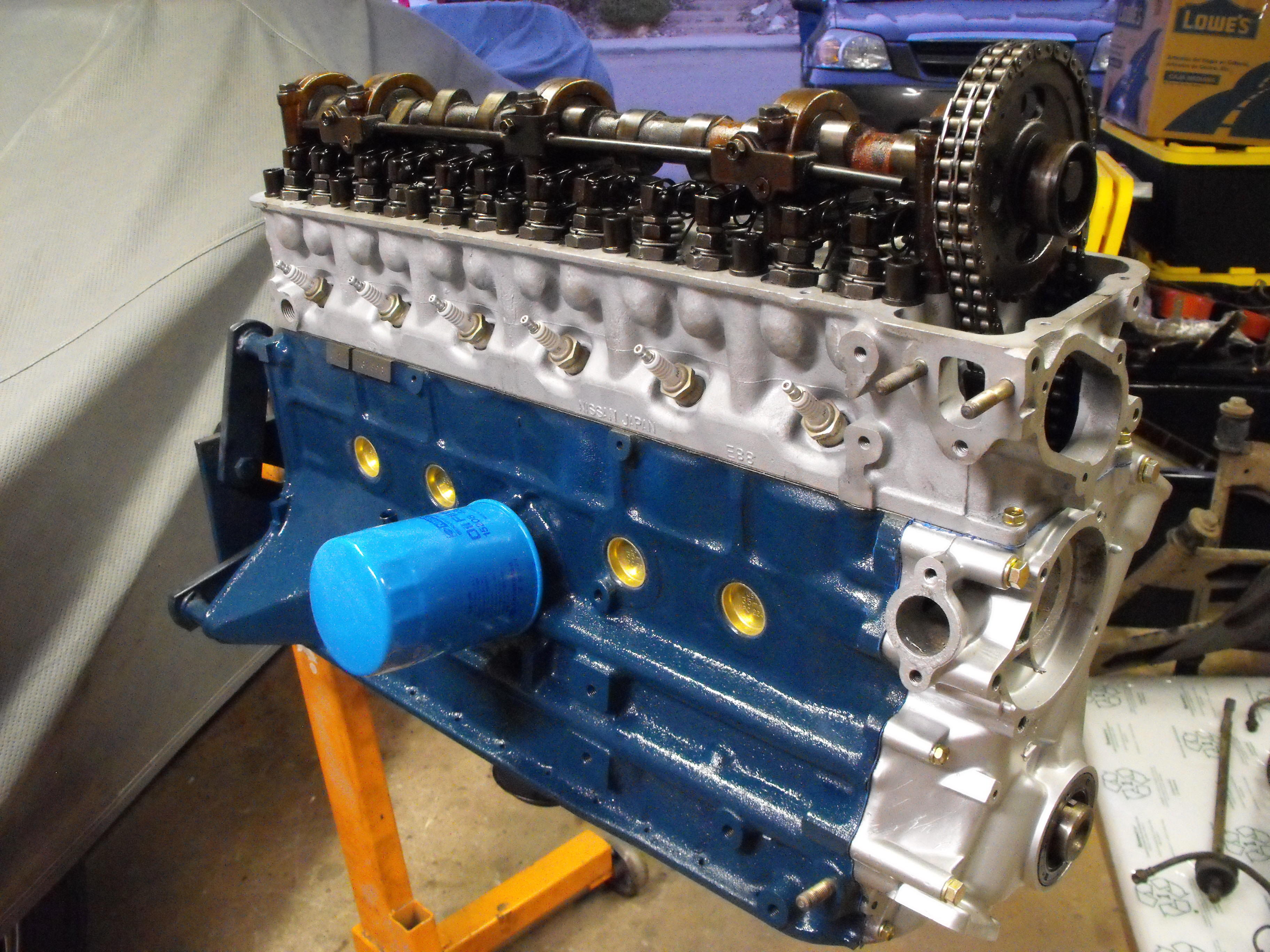

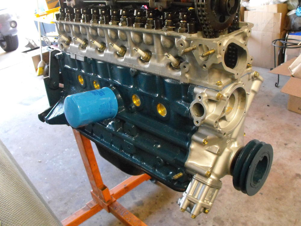

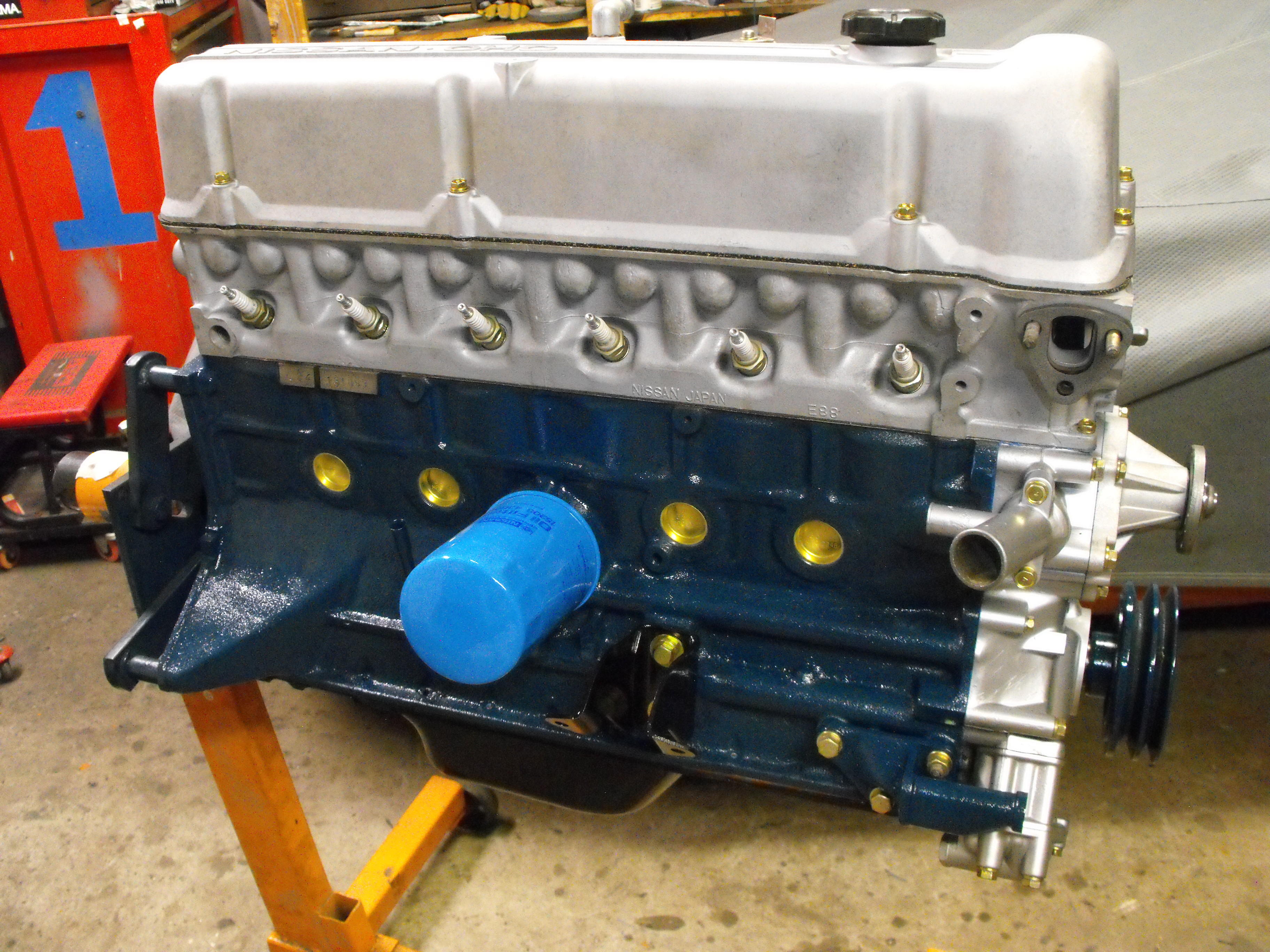

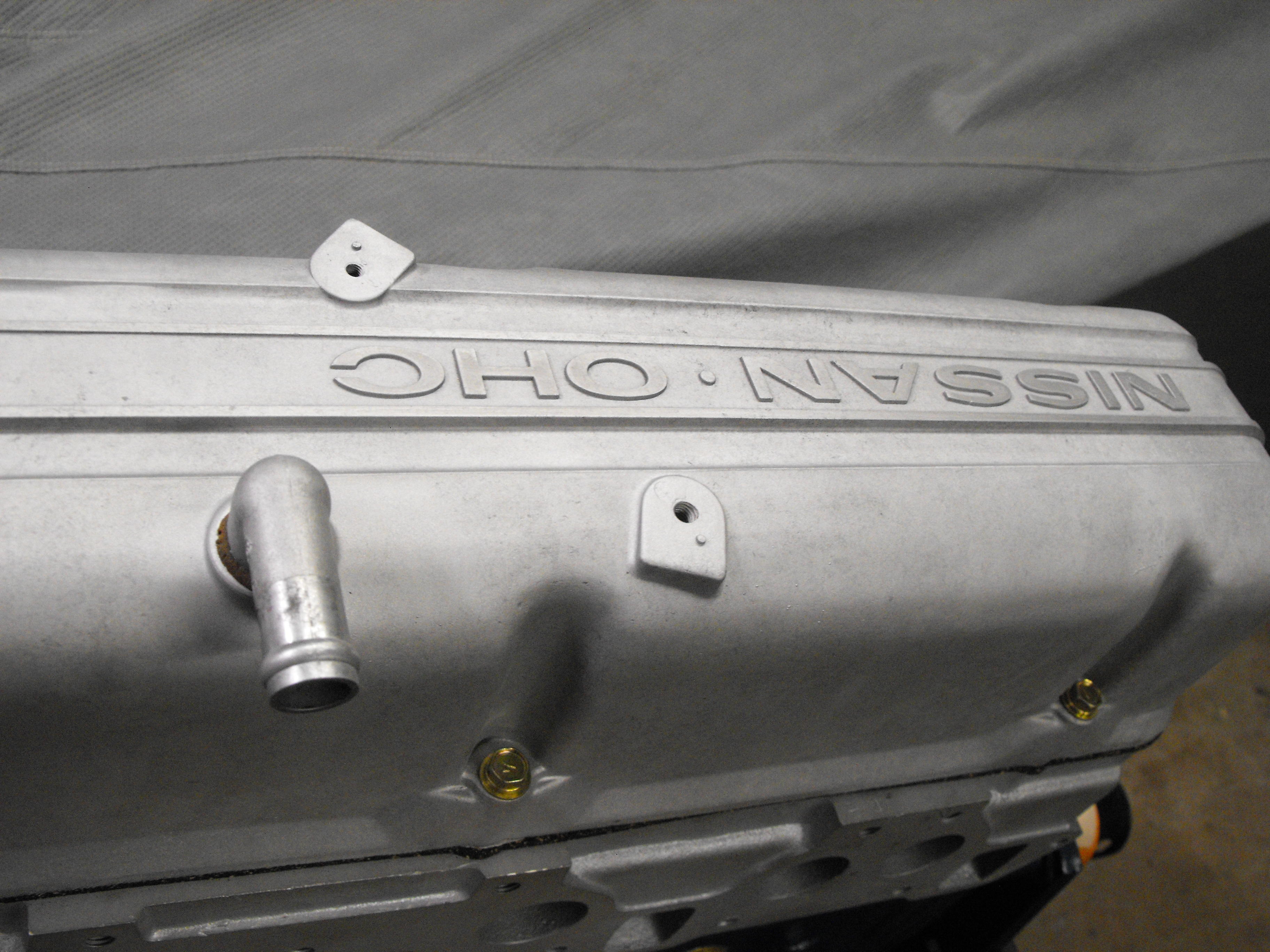

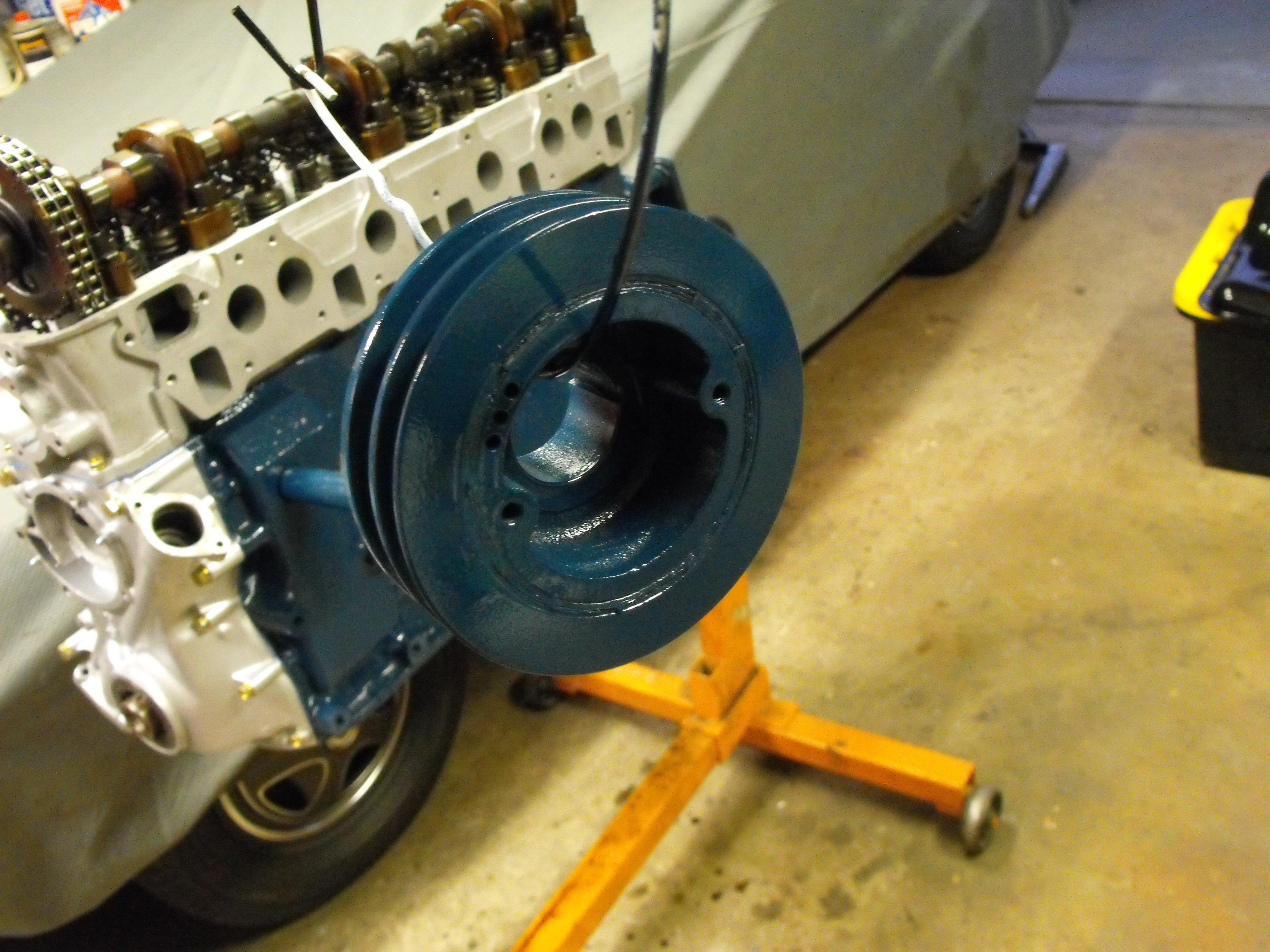

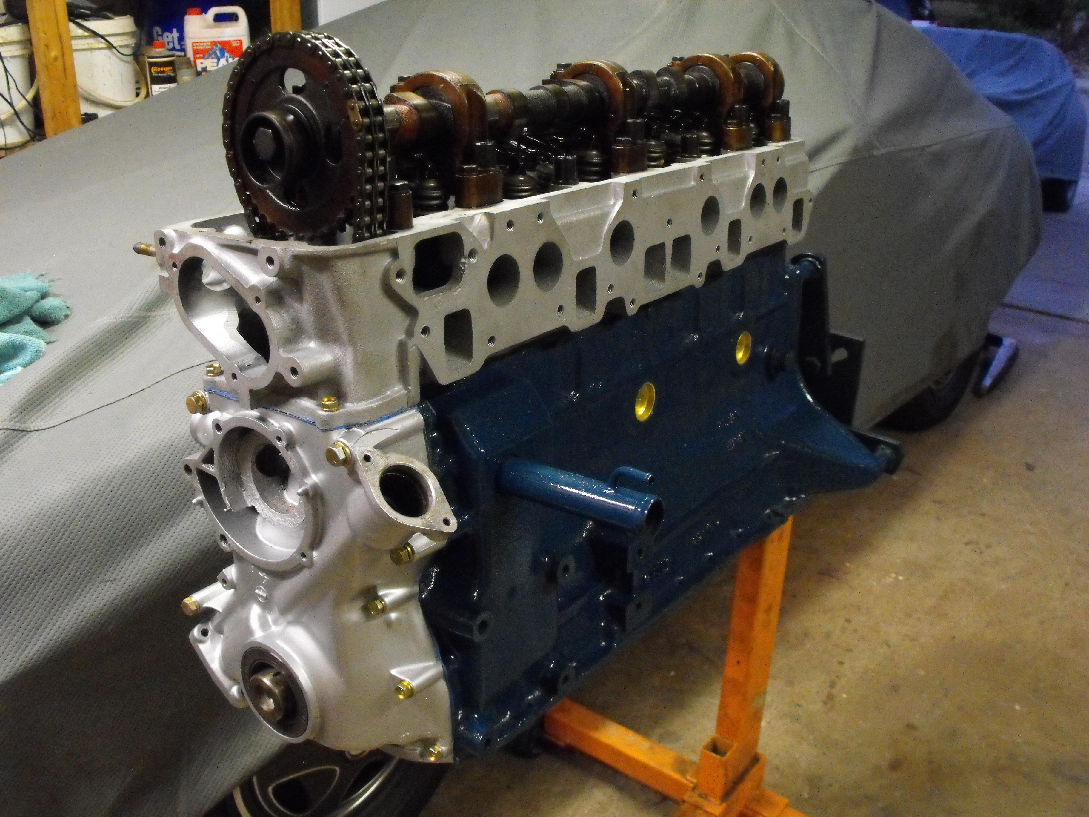

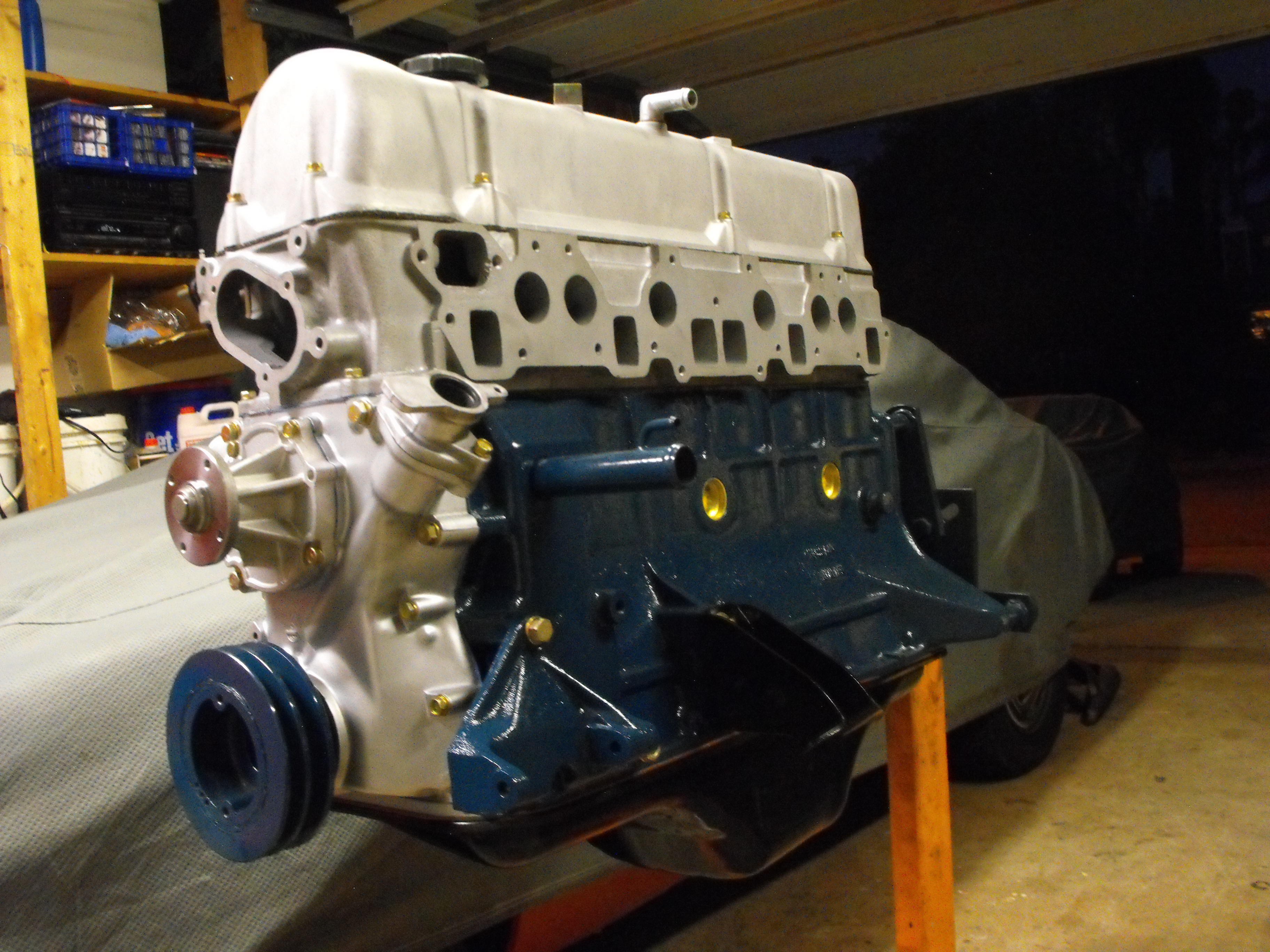

Got the timing gears and chain installed.  Also installed a new timing chain tensioner.  Cleaned up and sprayed the timing chain cover with high temp aluminum paint and got that installed.  Also got the front pulley cleaned and painted and the oil pan.  Will install those in the next couple days after they dry.
  On 8/17/2018 at 9:20 PM, 240Z73 said:
 I just met the owner of this car (very nice guy!) and would like to meet and talk to Motorman7 one of these days!  I just finished a full restoration on my 73!  Keep up the good work!
Glad you got to meet Bob.  With all the Z stuff going on, I am sure that we will run across each others paths one of these days.  Great to hear from you.
Got the Oil pan on.  Also cleaned up and installed the oil pump.  Got the distributor shaft slot lined up at the 11:20 location.

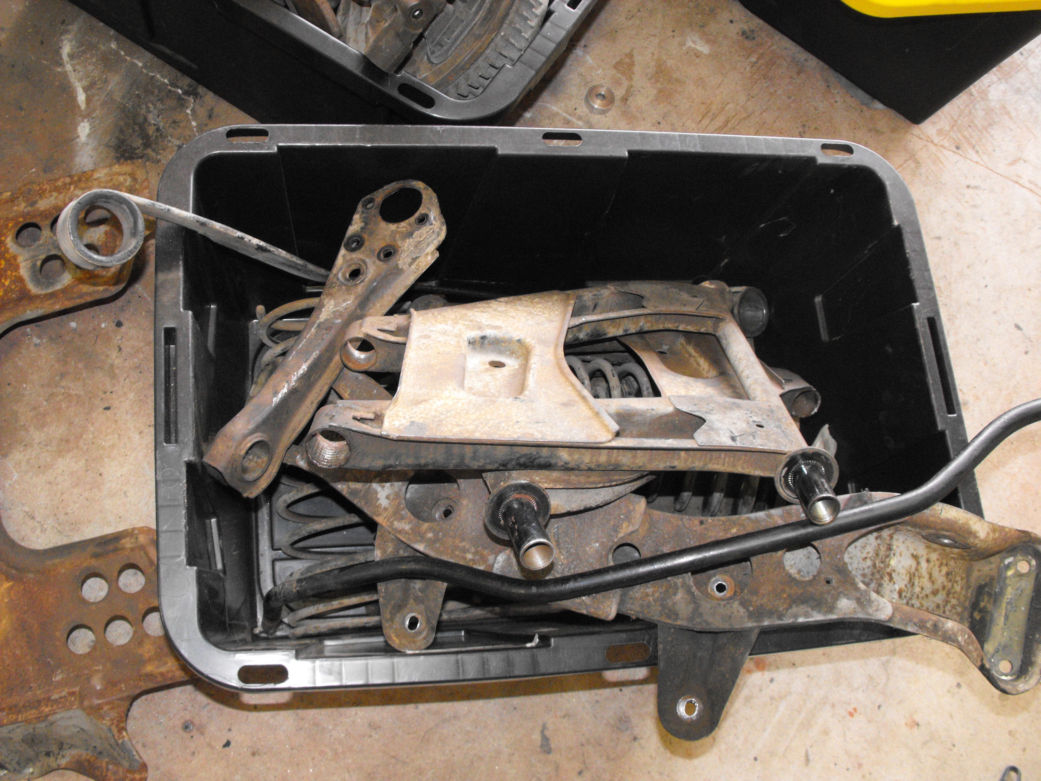

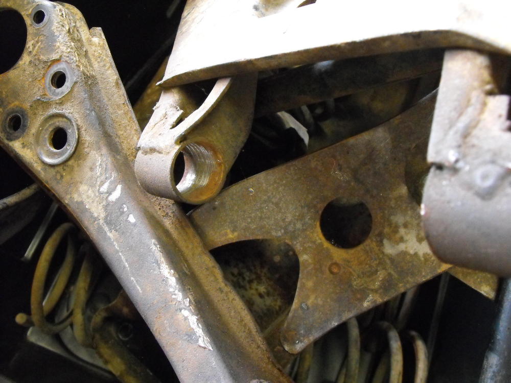

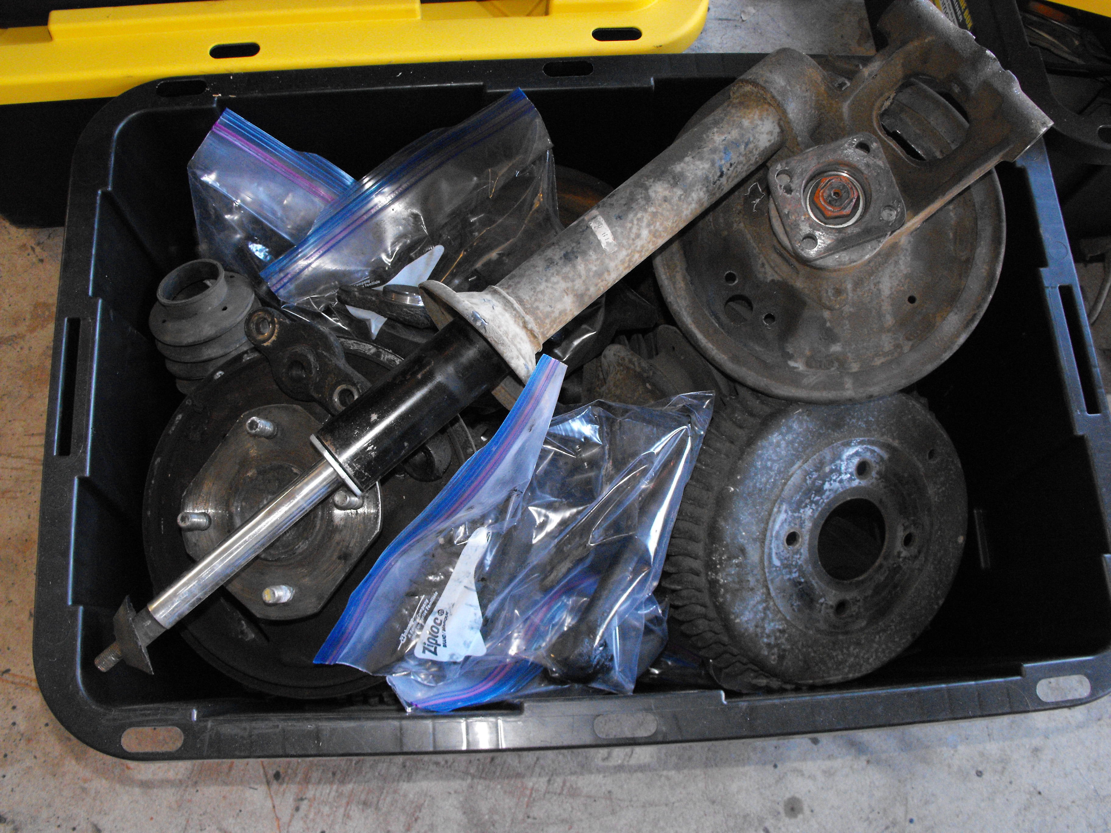

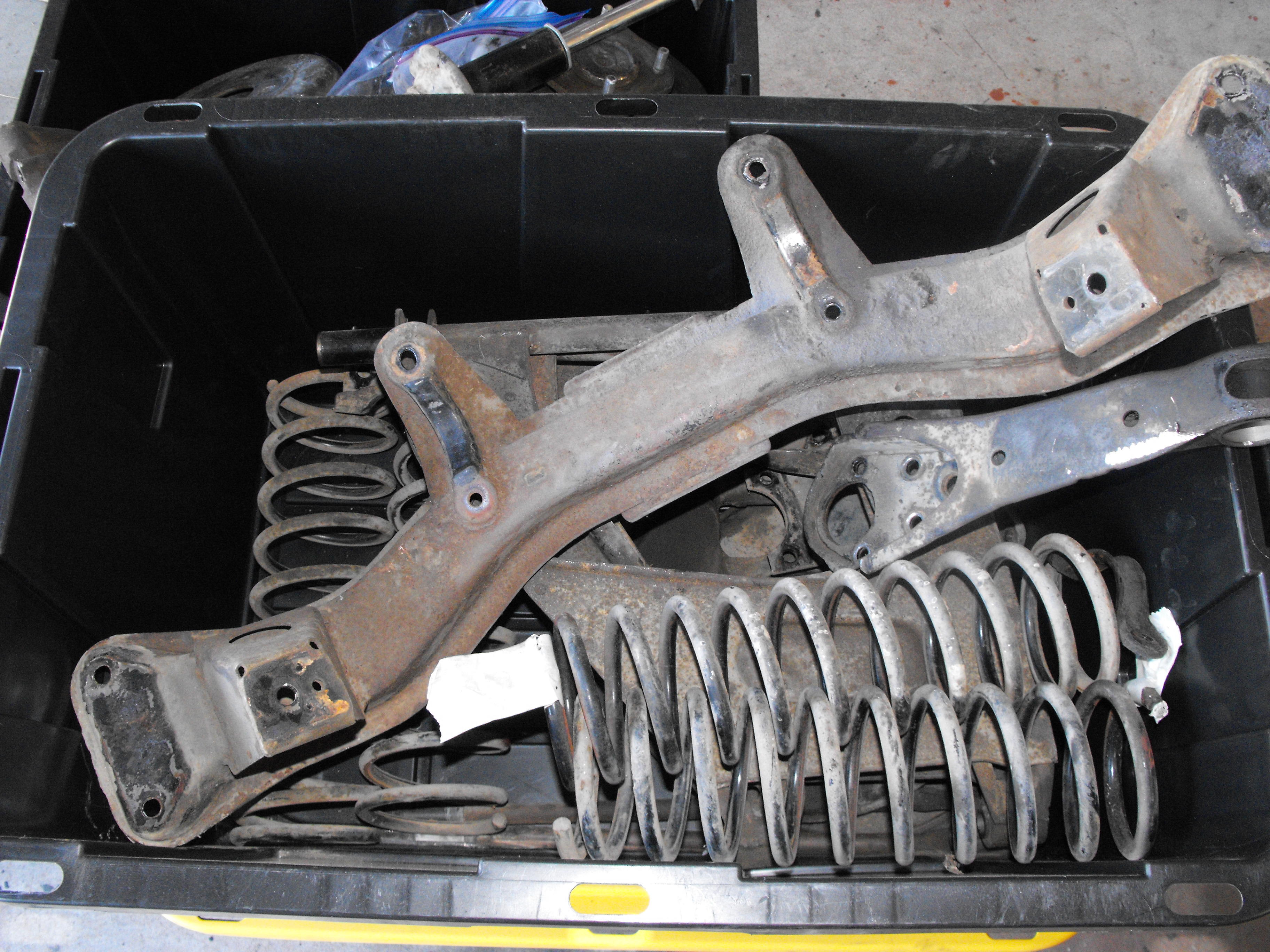

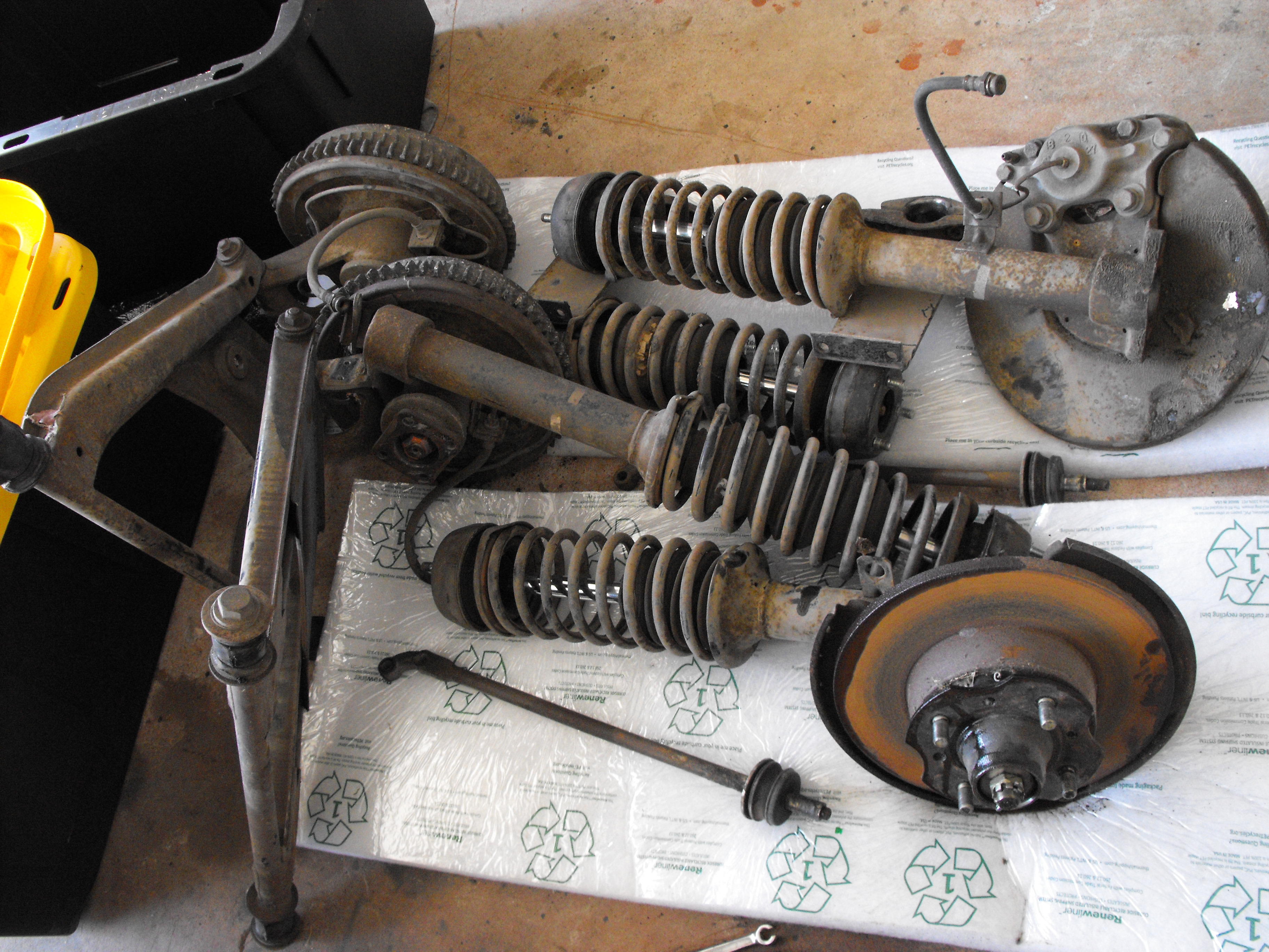

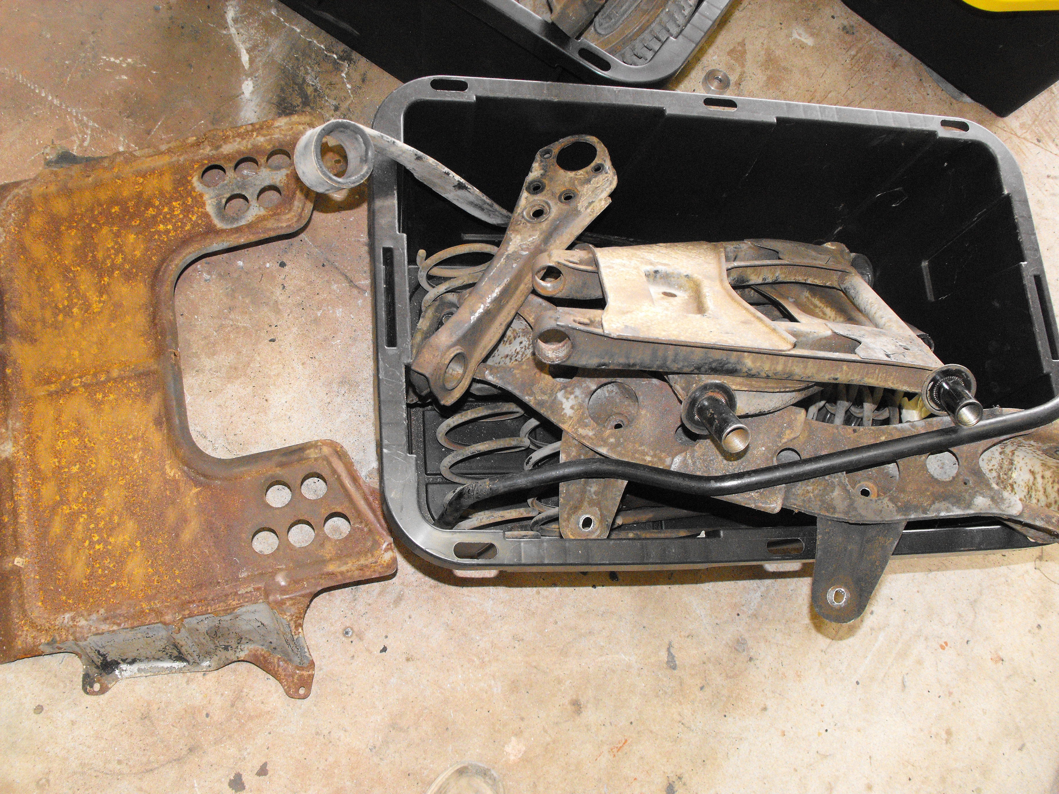

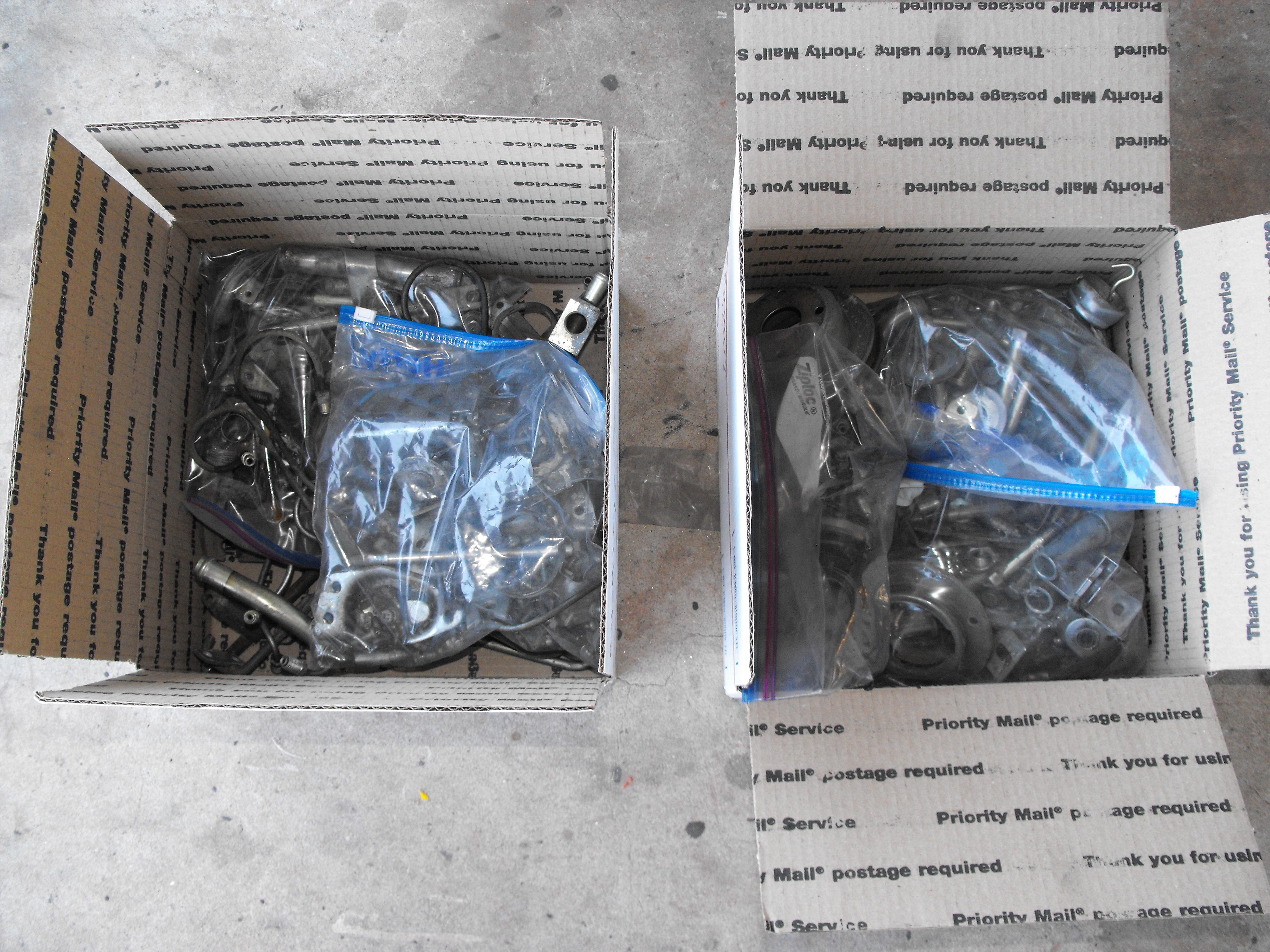

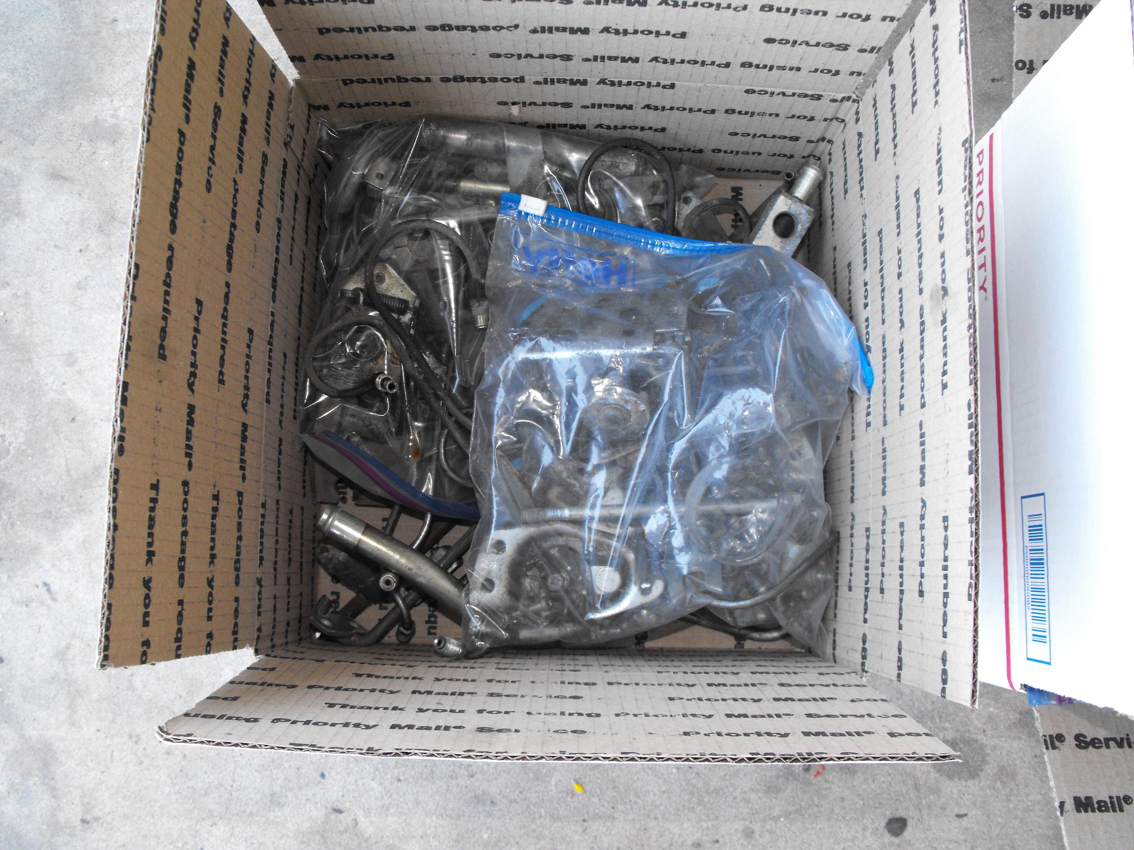

I broke down the front and rear suspension, also bagged the small stuff and sorted  components.  I have a box set-up specifically for the parts that will be powdercoated.  I did a basic wire wheel clean on about 85 percent of the parts that need to be plated.  Got those sorted (silver and yellow zinc) and bagged so I can ship those to the plating shop tomorrow.  I have two large USPS boxes full of parts to send out.  I will send the remainder of the parts out along with the longer fuel lines in a separate shipment.  Pics are below.

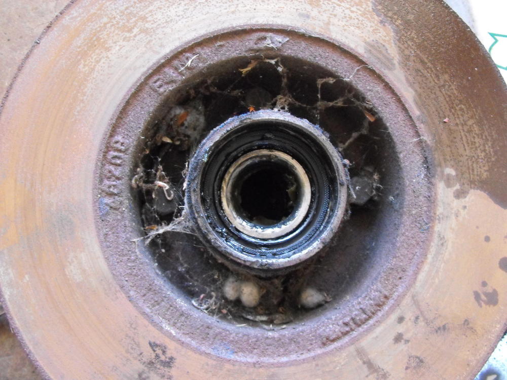

Check out the brake disc...a solid home for the spiders.
  • 2 weeks later...

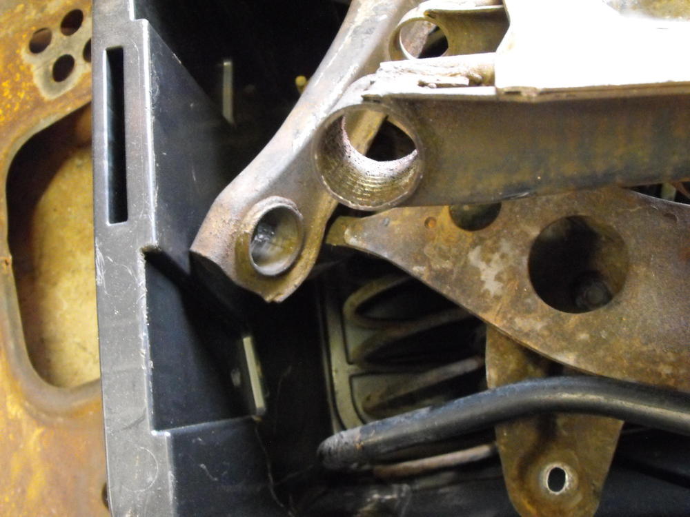

Got the suspension parts all disassembled and ready for powder coating. The powdercoater is great as they will sand blast the parts before coating.  No need to do a thorough clean on these.

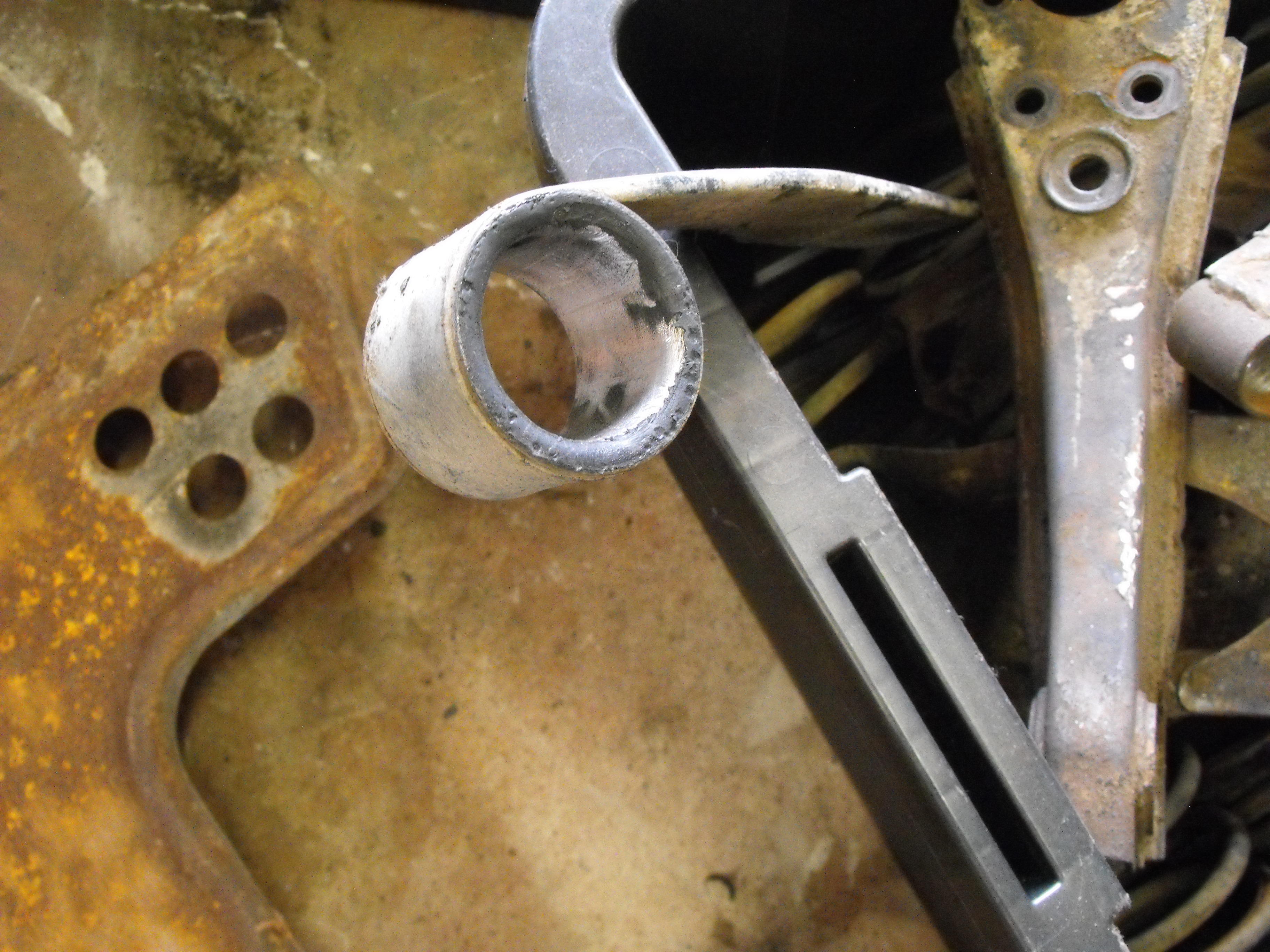

        The difficult task here was taking out the old bushings from the lower control arms.  I went to Autozone and borrowed  their U-joint/ball joint removal tool and used that to help with the bushing removal.  The fronts weren't too bad as I was able to press them out with the Autozone tool and a carefully sized 25mm socket.  The rears were not so easy.  In addition to the press, I had to roll the edges of the bearing 'inward' to help peel them off the wall.  A little PB blaster helped as well.
    So, I should have these at the powdercoaters tomorrow morning and they should be back in about a week.  KYB Shocks have been ordered and should be here in a couple days.  I will be ordering the Energy Suspension kit tomorrow so we will have all new Polyurethane bushings ready for assembly.  All fasteners have been received by the plater and should be back here in a week or so.  With that all done, I should be able to start assembling the suspension components here in a little over a week.

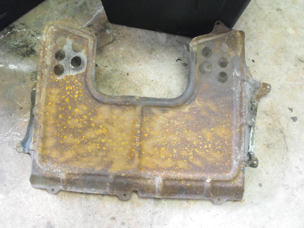

I did tap it into shape a bit using some wood blocks. Hopefully the rusted areas are not too pitted. Powder coating will cover small depressions, but not the deep pitting.

Looking forward to seeing how the powdercoating turns out, how many coats will they do?
I recently repainted my undertray, but didn't powdercoat (used VHT Engine Enamel).
https://www.viczcar.com/forum/topic/16002-what-did-you-do-on-your-z-today/?do=findComment&comment=206628
I tried to hammer it as straight as I could, but there is still imperfections. After a while I decided it was good enough, it is an undertray after all..
Will see how well it holds up, I think next time I'd powdercoat it. You don't save much money by painting yourself.
