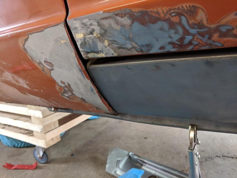

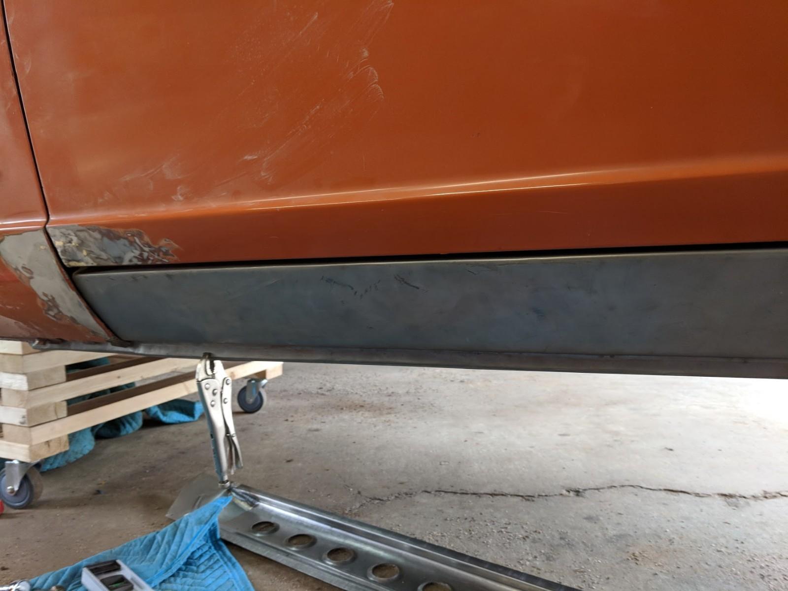

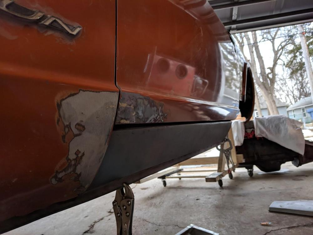

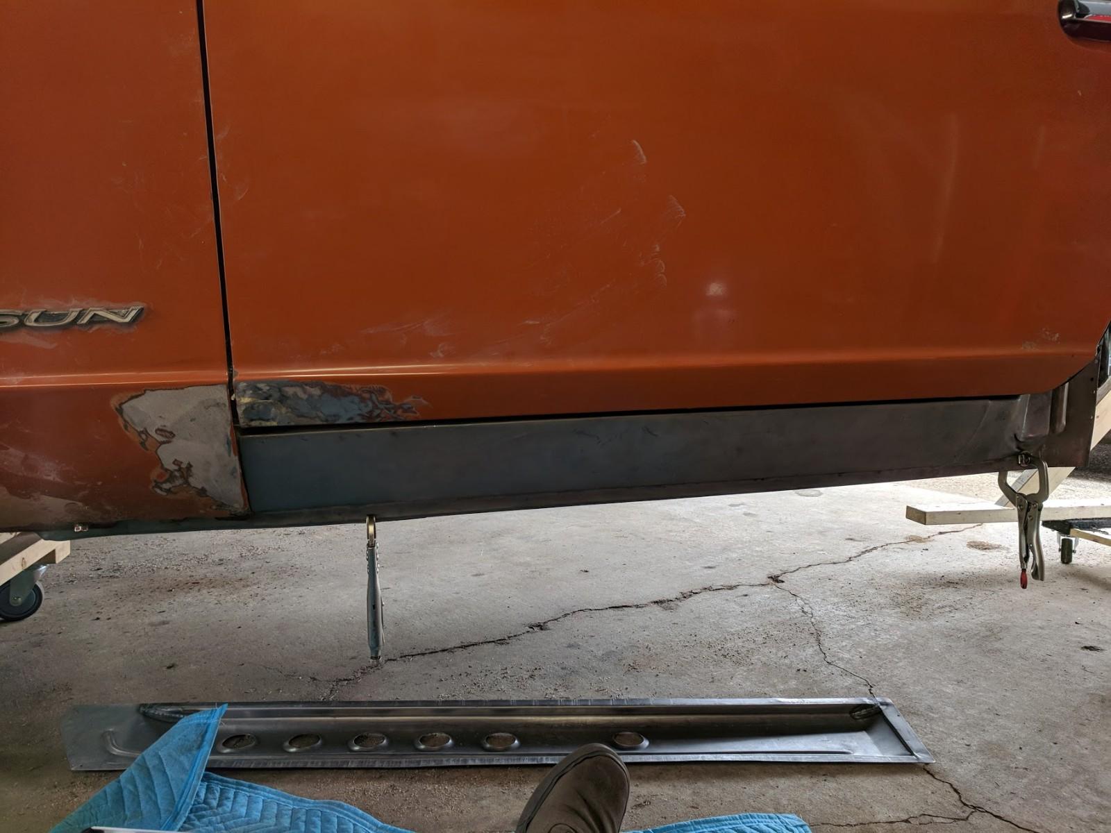

I am working on replacing my rocker panel and i cannot change the gap shown in the images attached. The driver's door and fender meet up nicely like they did previously, but the rocker panel is inset of both. Its like it's diving inward towards the trans tunnel along the length of the rocker. Anyone seen this? My only thought is to cut along the top of the rocker along it's length and pull it out to meet the door/fender and then reweld it up. Thoughts?
https://www.classiczcars.com/forums/topic/60316-tabco-rocker-panel-gap-help/
It is, that is one of the problems with Tabco rocker replacements, it's also why you find a 1/4" of Bondo/filler on those rockers replacments to take up the room.
That is probably the best way to fix it for real.  That's looking good, don't just tease us lets see the rest of the car^_^

If you bought it yrs ago then maybe it's from another batch,  the rockers they have been producing in the last few yrs tend to have this problem.

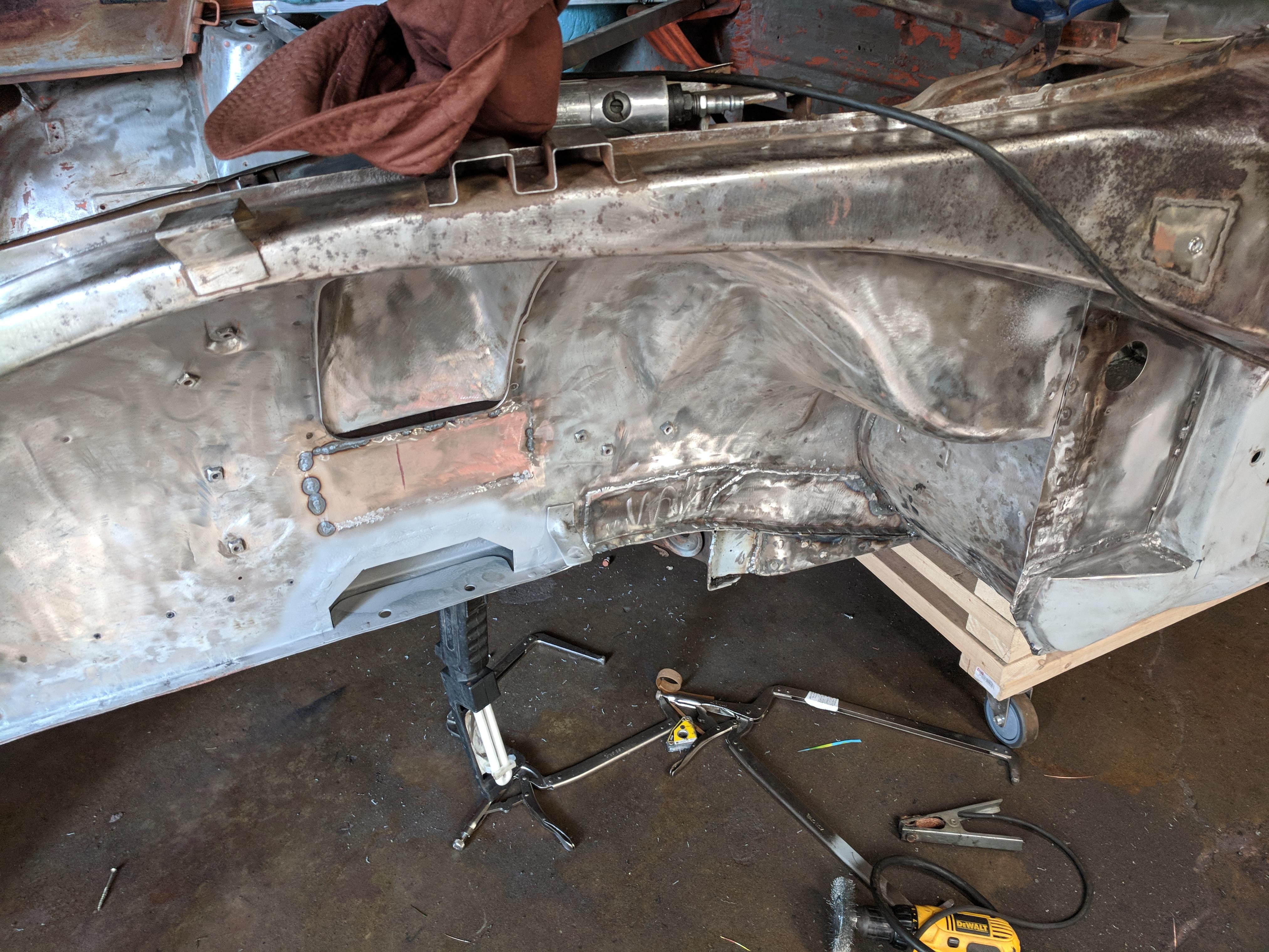

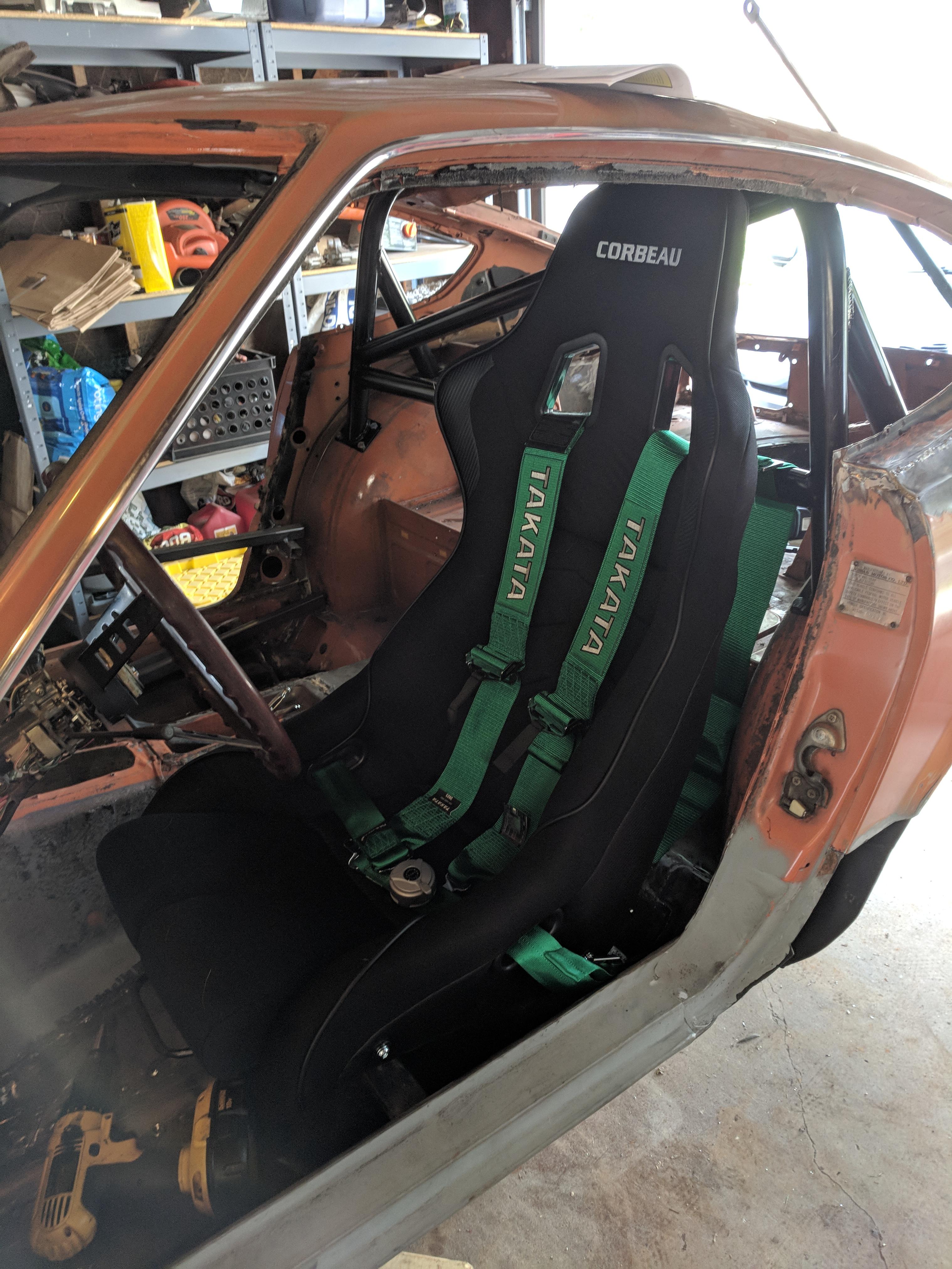

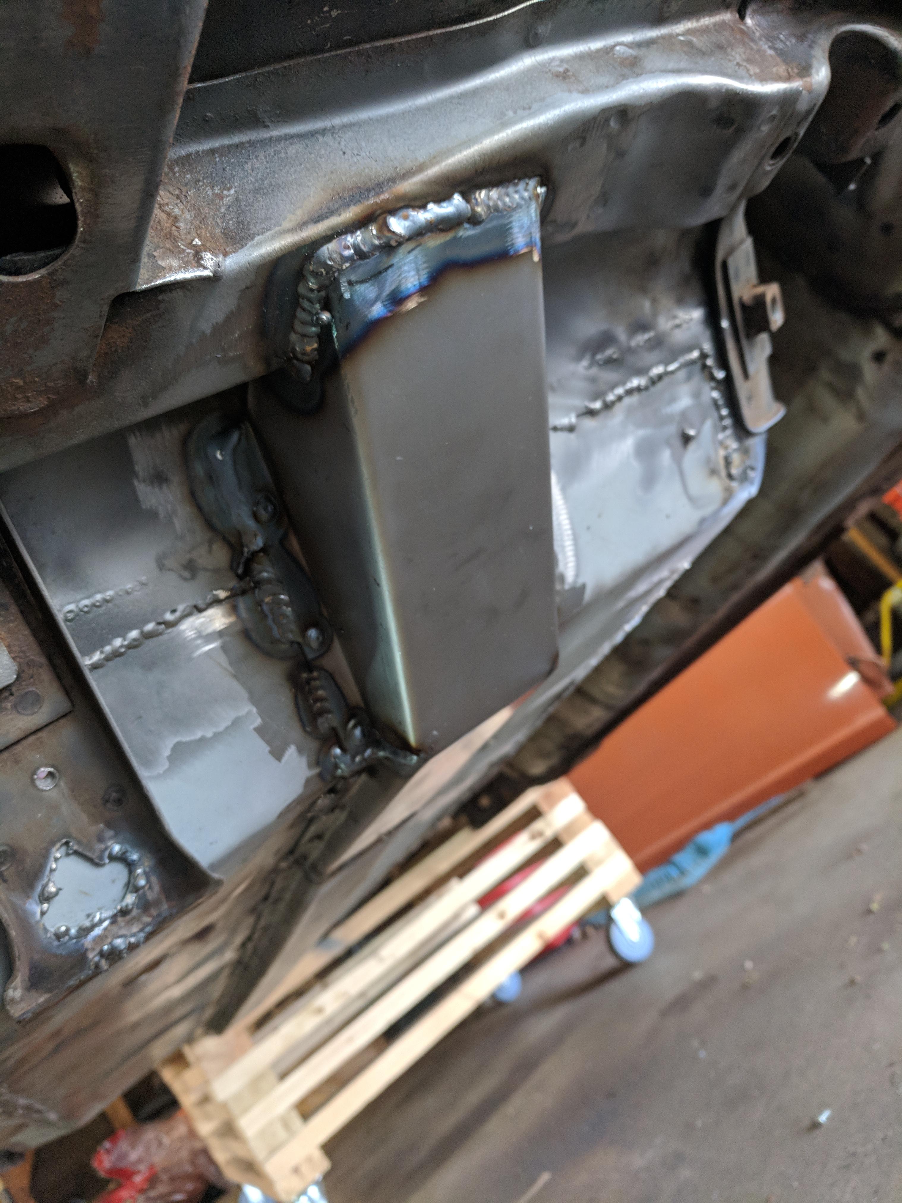

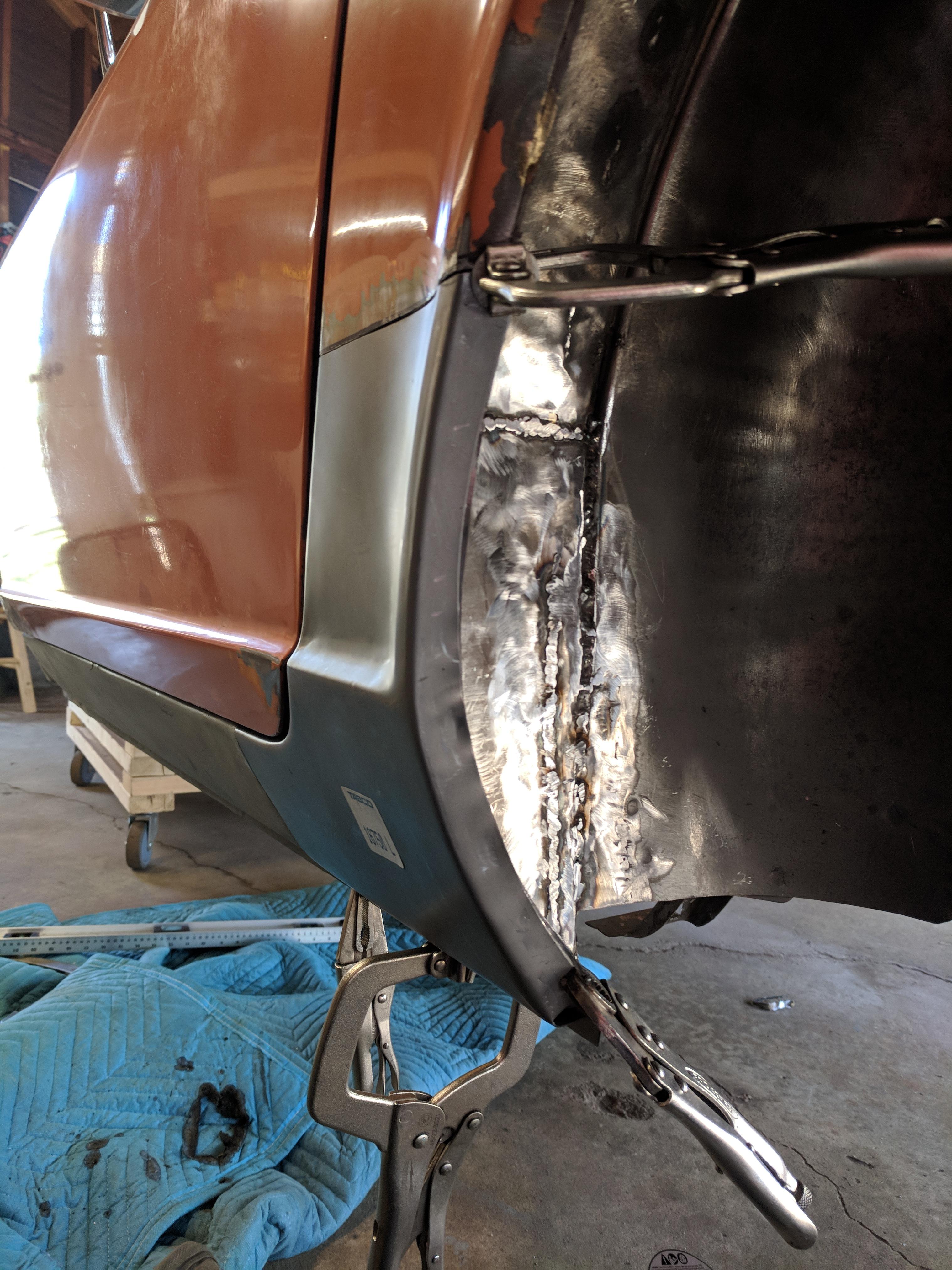

Oh good thank you. It sucks, but I'm so relieved this isn't my ineptitude causing the panel gap :). Ill have to do some cutting to get it right, but I should be able to get it close enough to reduce the amount of Bondo needed. My pictures are all over the place, but here's a few random a#$ shots of the progress.

Your work is looking really good. It will all pay off when finished. I was at a vintage race and there was a restoration shop there. In his tent was a Mustang, a Camero, a Chevelle and a Dodge Charger I think it was, displayed. I asked him how the replacement panels they use are for fitment. He said not very good. They have to cut, weld, etc just to get all the gaps correct.
So the Imports are not alone in this issue. Another thing is the car itself. That rocker may just fit fairly good on another 240Z.
A good reason restoration shop work is so expensive. Just think what it would cost if you had to pay a shop to do all that you have done so far.

I'm not seeing much ineptitude in those pics, the dogleg patch is perfect.
