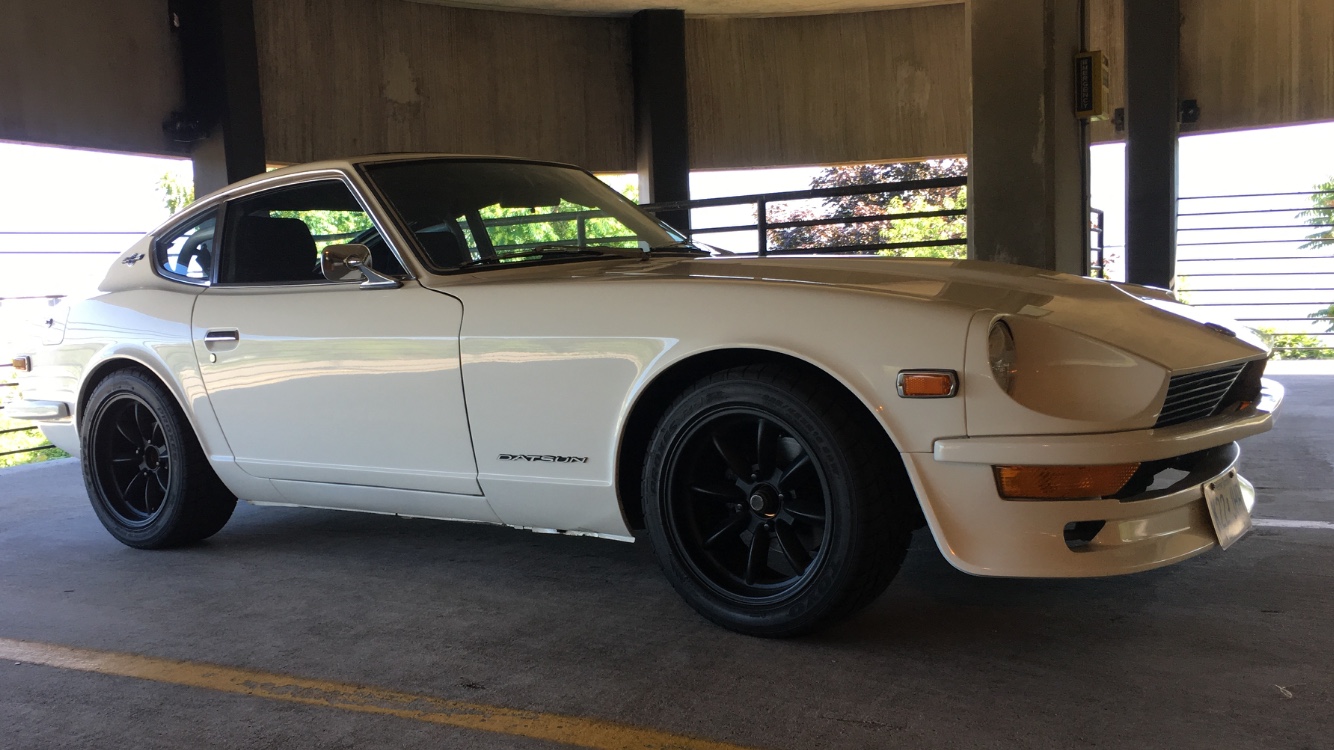

Need to lower another 1-2 inches. Also want 2-3 degrees neg camber. What are my options without modifying the shock mounts? BC coilovers? Currently on Iluminas with Bilstein springs. Thanks

With that wheel and tire set up it does not look like there is much room left to lower anymore.

Haha! Senior moment. Meant Eibach LOL. I am moving to 15 inch rims.
