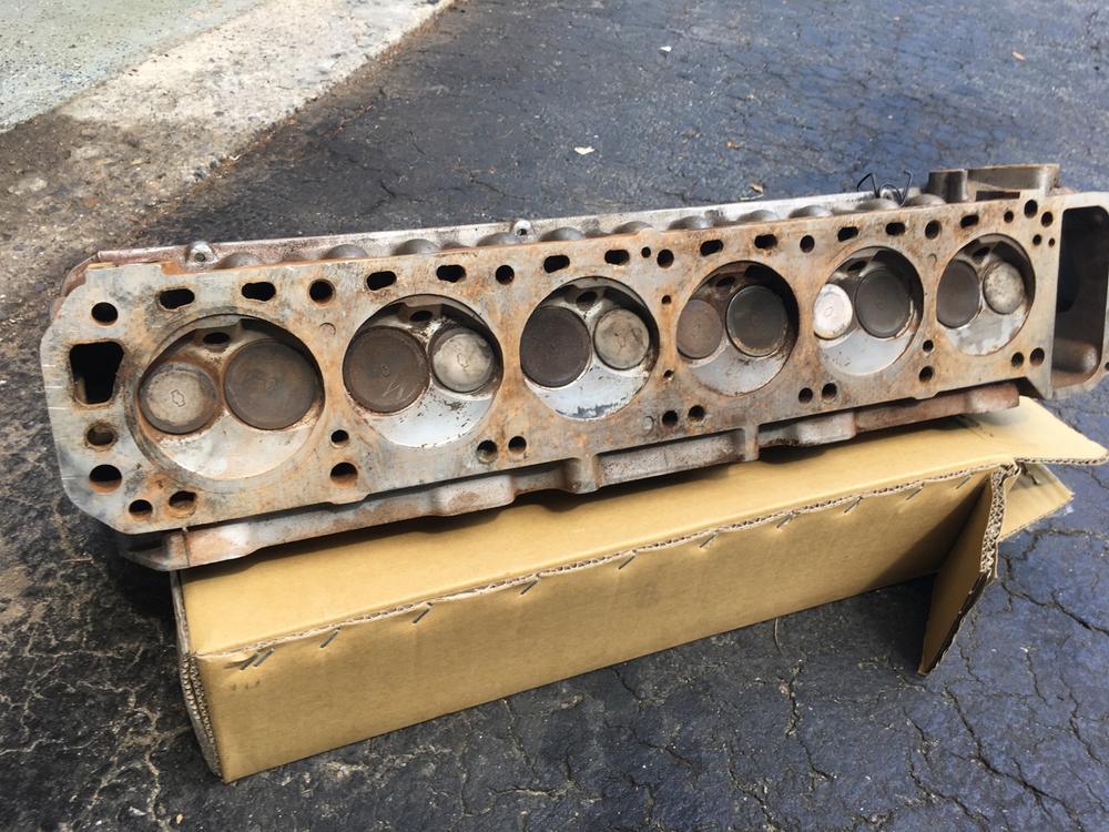

Posted July 6, 20186 yr comment_552470 I meant this N42 head. Looks ok to me but I know nothing. Am about to have it rebuilt with an N42 block I picked up. 12/70 2.6 block E88 heads Mallory DCOE40 3/2 Twice pipes Tokico 1, 3/4 in sways, ext oil cooler Link to comment https://www.classiczcars.com/forums/topic/60330-good-head/ Share on other sites More sharing options...

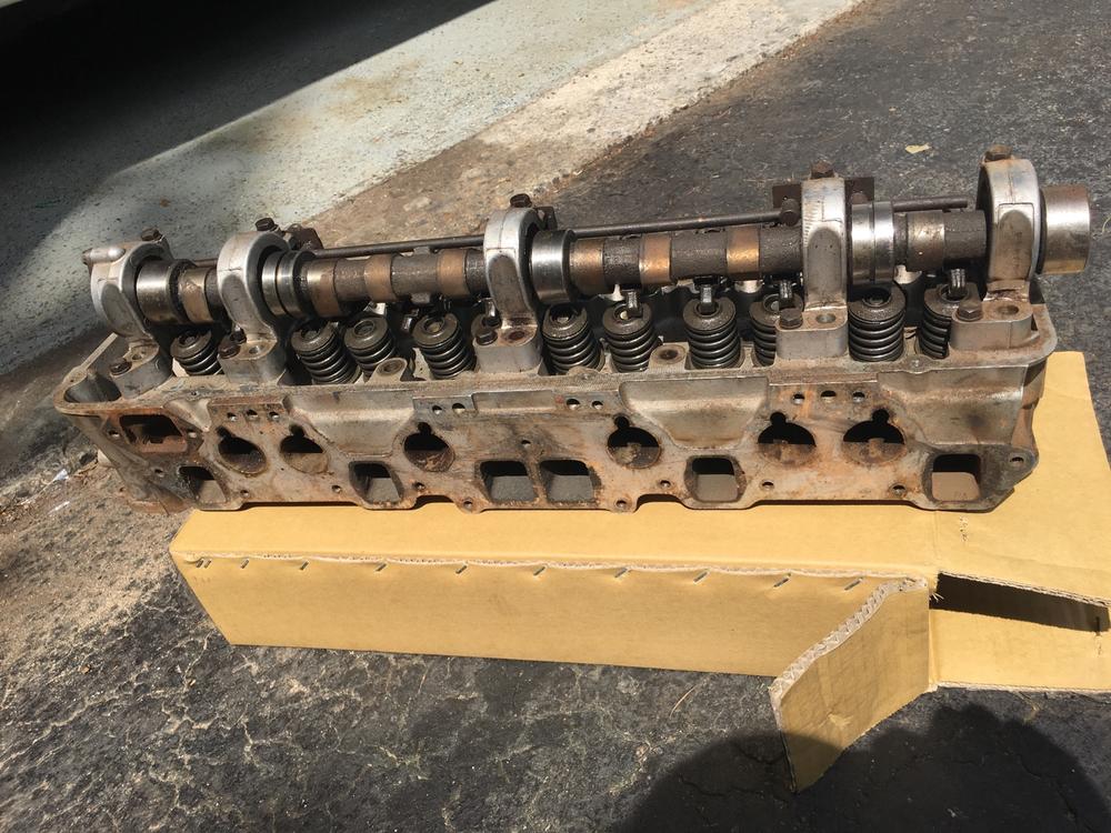

July 6, 20186 yr comment_552476 What's up with all of the missing rocker arms? Spendy to replace if they're not in the box. And the camshaft is falling out. Movement during transit? Doesn't look terrible. Link to comment https://www.classiczcars.com/forums/topic/60330-good-head/#findComment-552476 Share on other sites More sharing options...
July 6, 20186 yr comment_552477 Just to add - the head itself can get new valve guides so if it's not cracked you'll be fine, probably. That camshaft is probably good also, the surface rust isn't bad. Also just noticed an anti-rattle spring hanging of the head in the first picture. So you probably have all of the parts BUT you won't know which rocker goes with which cam lobe, assuming that they fell off in transit. That might or might not be a problem. Probably depends on the wear of the rocker arm lash pad. Endless discussion... Link to comment https://www.classiczcars.com/forums/topic/60330-good-head/#findComment-552477 Share on other sites More sharing options...
July 6, 20186 yr comment_552479 It looks good but you need to have a machinist check it out. Chuck Link to comment https://www.classiczcars.com/forums/topic/60330-good-head/#findComment-552479 Share on other sites More sharing options...
July 6, 20186 yr comment_552481 Looks good.....very little electrolysis damage on water inlets. Rockers can be sent to Delta Cams for refurbishing, cam to Isky. The head will come back from the machine shop looking like new. Link to comment https://www.classiczcars.com/forums/topic/60330-good-head/#findComment-552481 Share on other sites More sharing options...
July 6, 20186 yr Author comment_552482 Thank you all. Yes the missing parts are in the box. Cam was loosely on and moved in transit. 12/70 2.6 block E88 heads Mallory DCOE40 3/2 Twice pipes Tokico 1, 3/4 in sways, ext oil cooler Link to comment https://www.classiczcars.com/forums/topic/60330-good-head/#findComment-552482 Share on other sites More sharing options...
