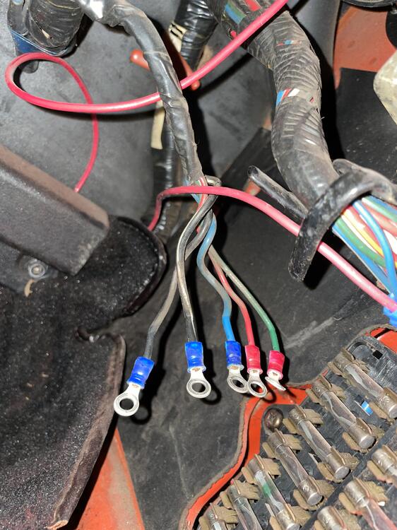

parts came in. Looking at the wiring harness (1977 280Z), it doesn’t match up to the engine (prepped for 1973 240Z wiring harness)
I’ll need an ER-EF adapter for it to work, and purchase a new negative battery terminal as the original disappeared.

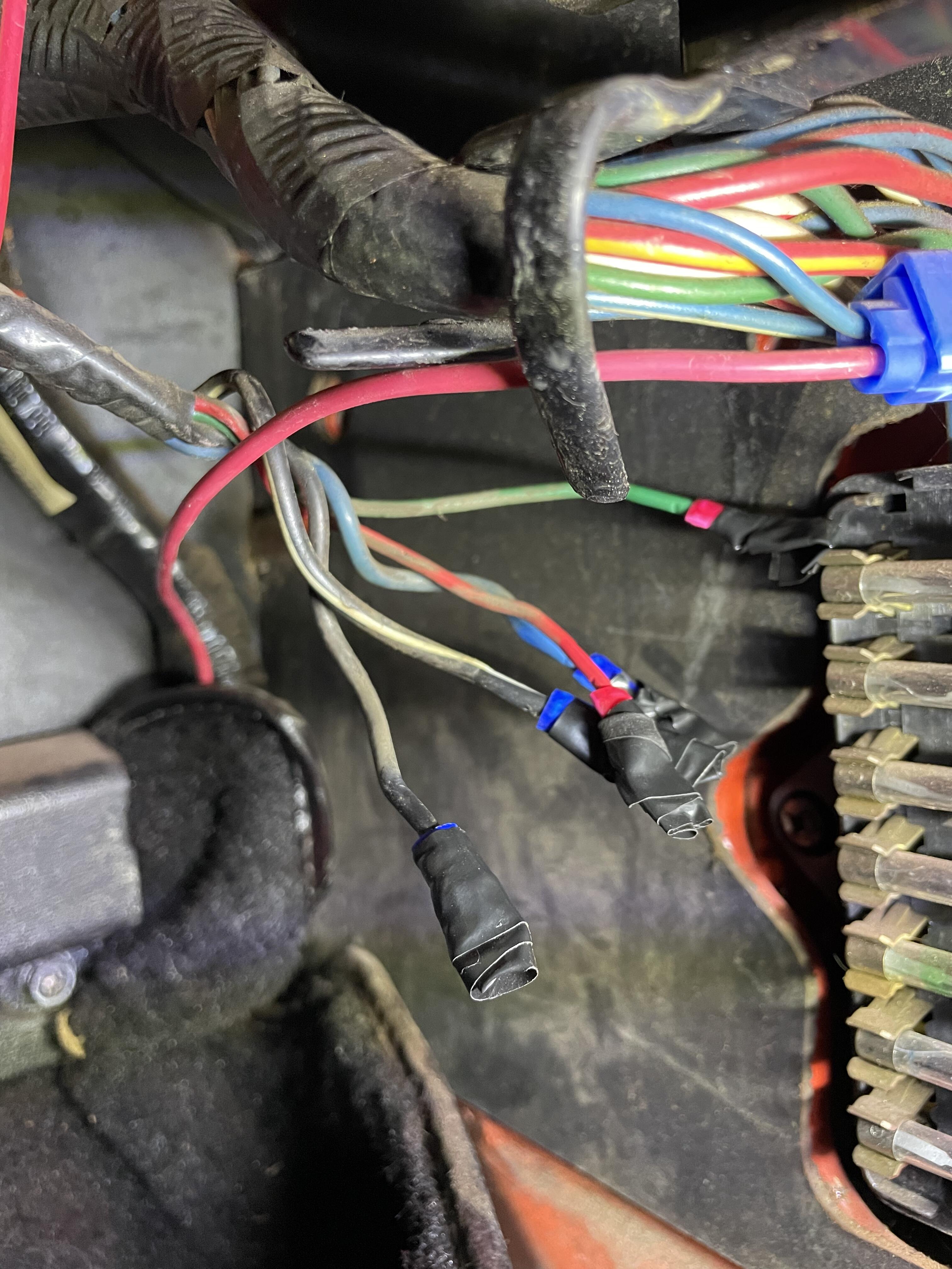

Connected the battery to test electrical:
1. front left signal is burned out.
2.reverse lights do not work (unless car needs running)
3. center console light is off in both off/on position but is on while toggling between the two.
4. antenna motor not working (father said it’s not connected)
5. parking brake light stays on.
I’ll be installing a new alternator that connects straying to the 280Z wiring harness.
fuel pump did not turn on, I’ll need to wire a relay to support it.
Edited by MM569457
Updates:
Lighting…. Some issues I’m believing comes down to relays. A relay under the passenger seat is causing the parking brake light to stay on. Dad told me he had that issues before he garaged the car. Front Side markers are intermittent, and when hazard lights are on both front signals turn on opposing each other, not simultaneously.

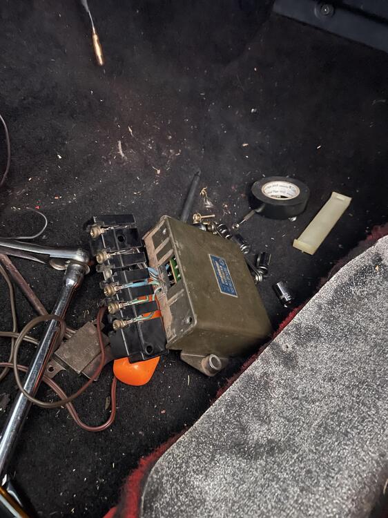

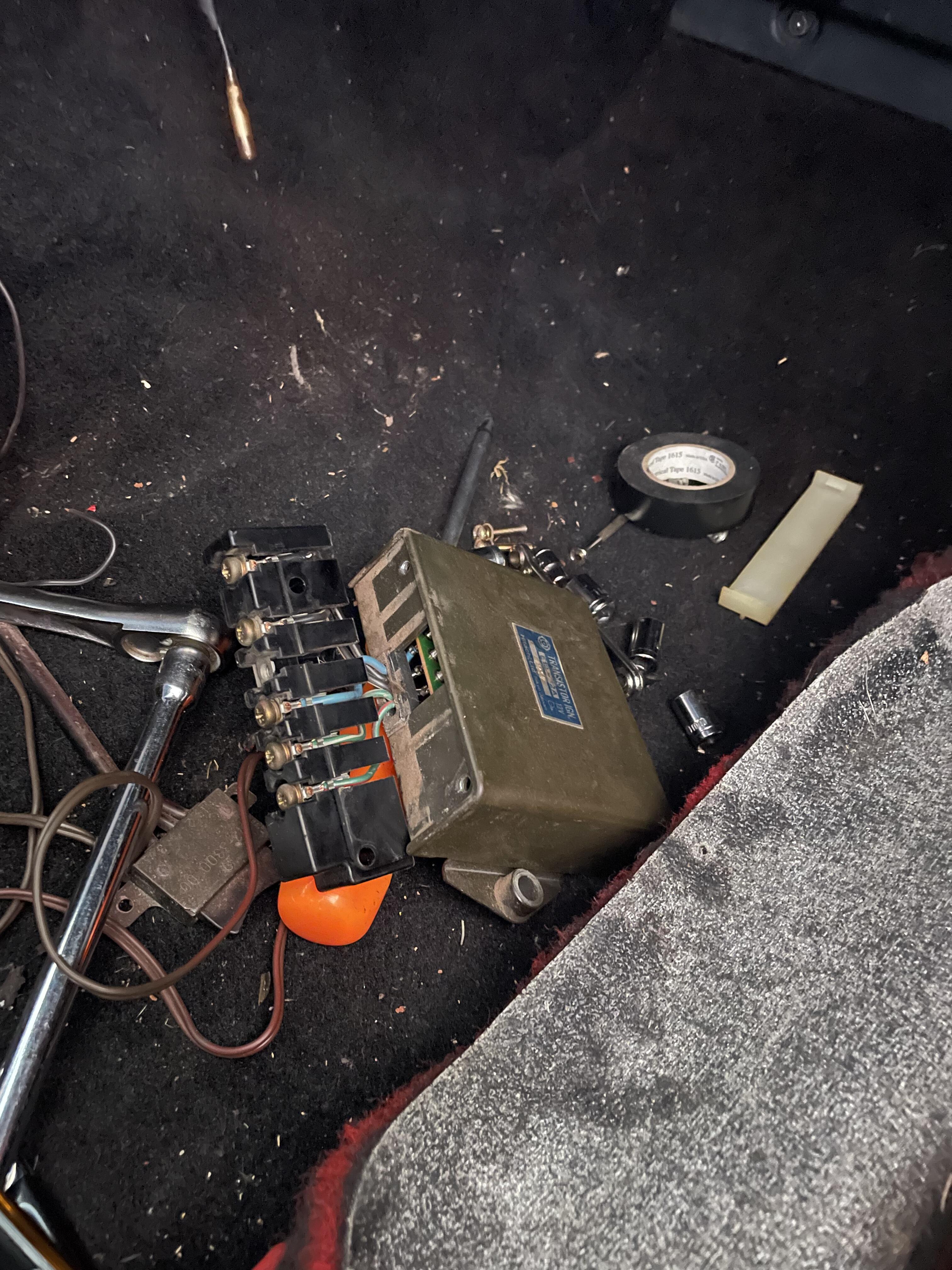

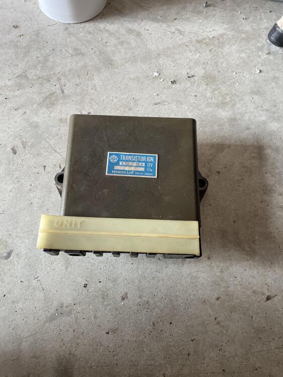

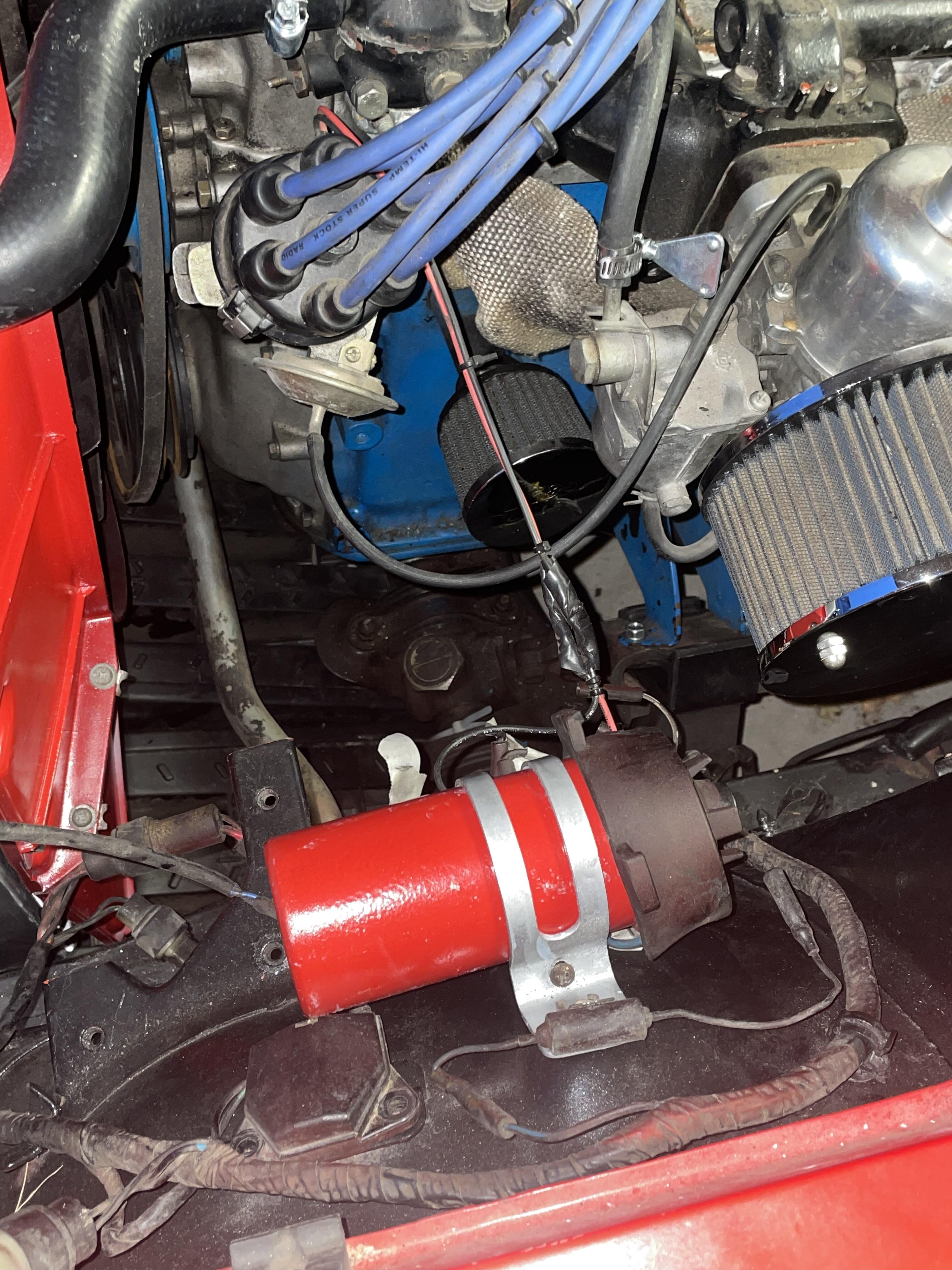

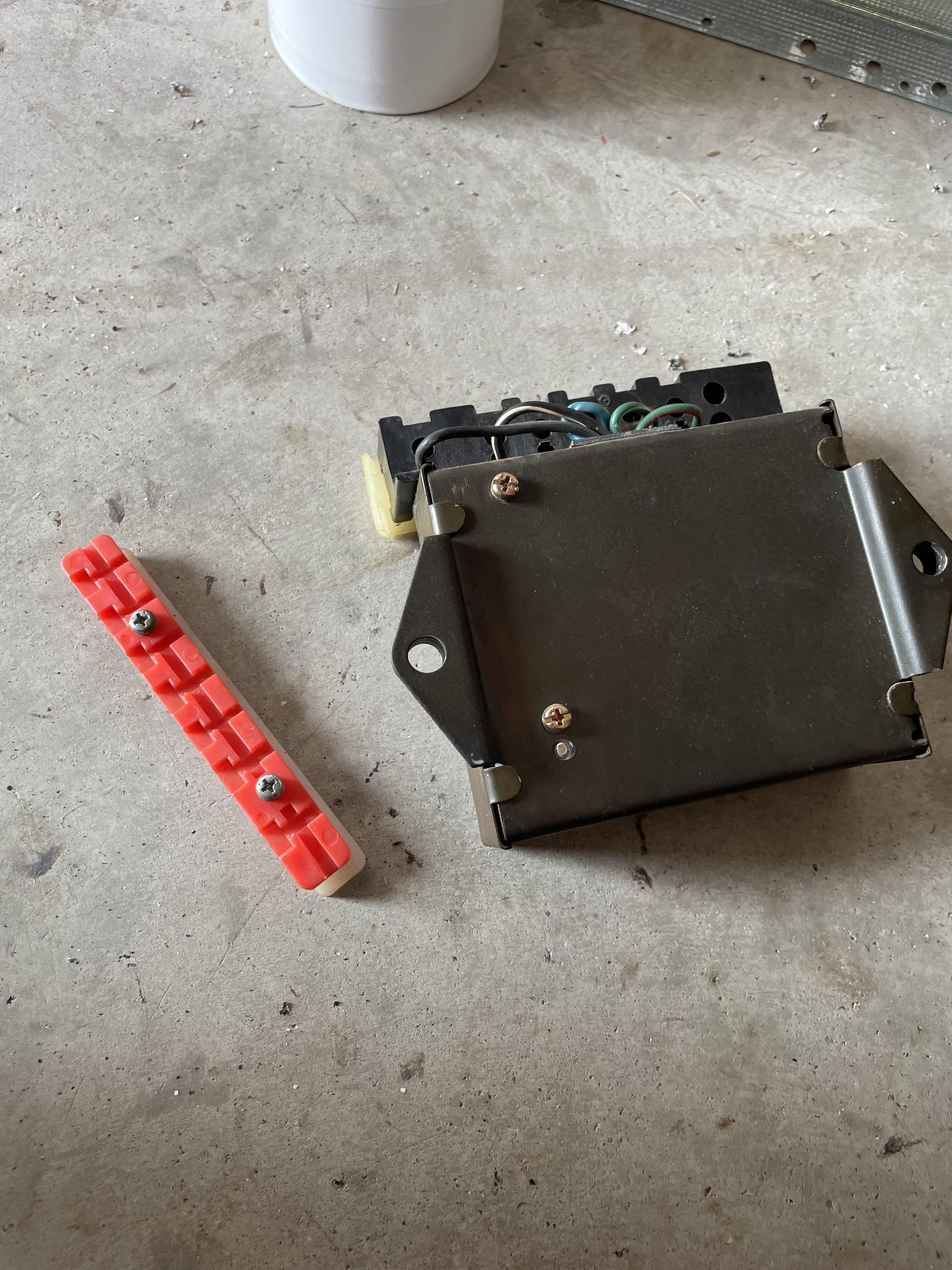

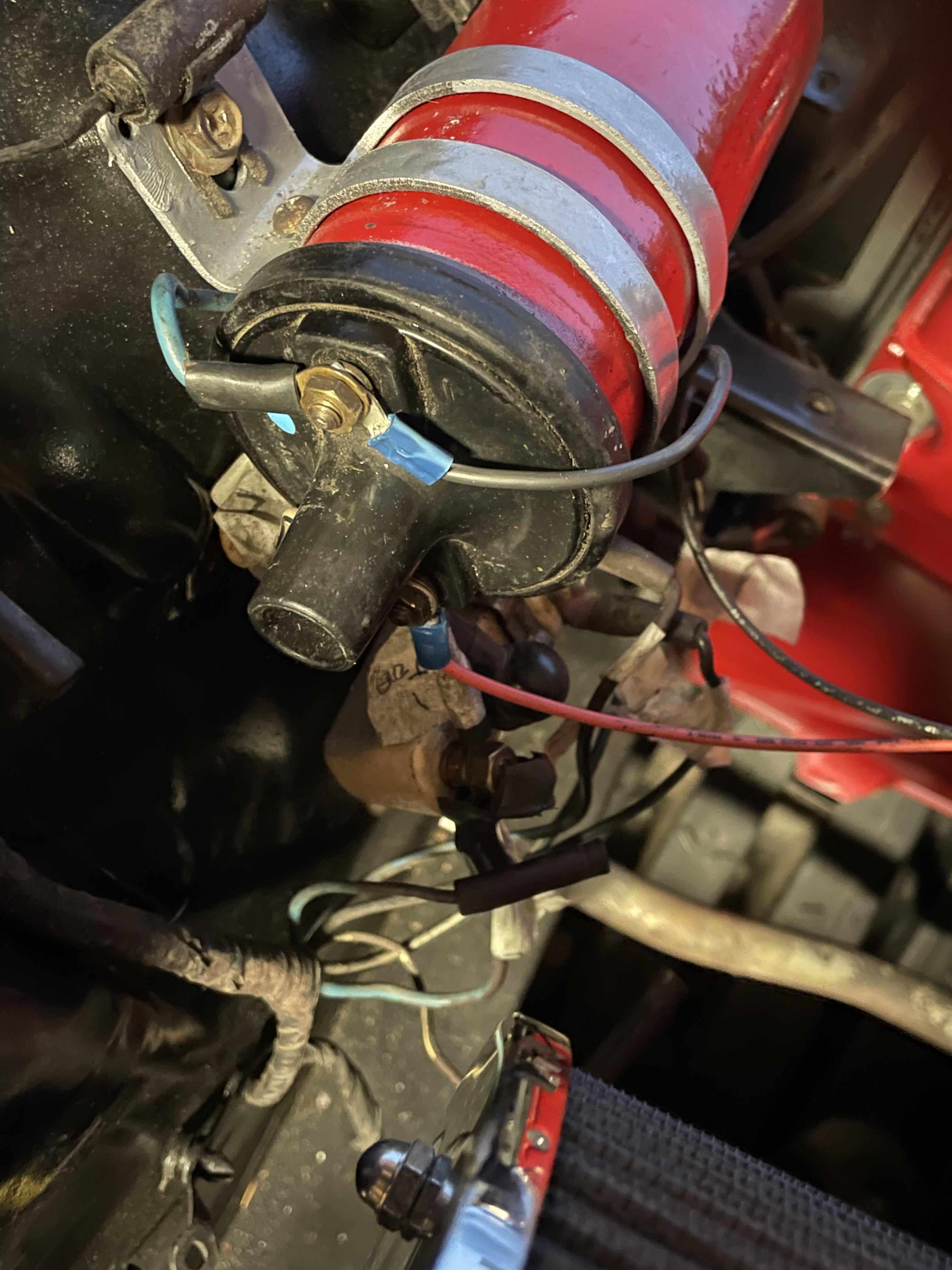

wired the ignition coil, cleaned up the resister, and connected the distributor. It is a pertonix distributor so I went ahead and bypassed the TIU and Terminal block, connecting the distributor direct to the coil.
