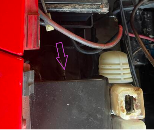

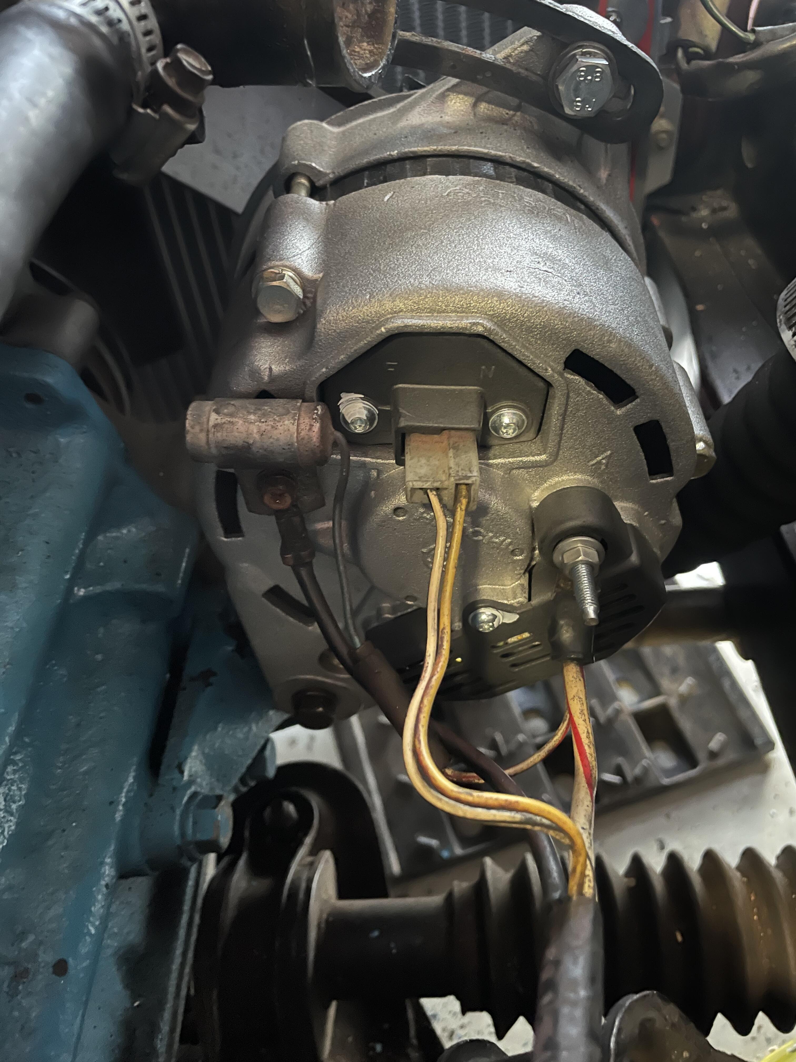

Have you examined the voltage regulator?  Just to be sure that nobody has messed with the wiring.  It should be under/inside that shelf that the fusible links blocks are attached to, protected.  A small metal box.

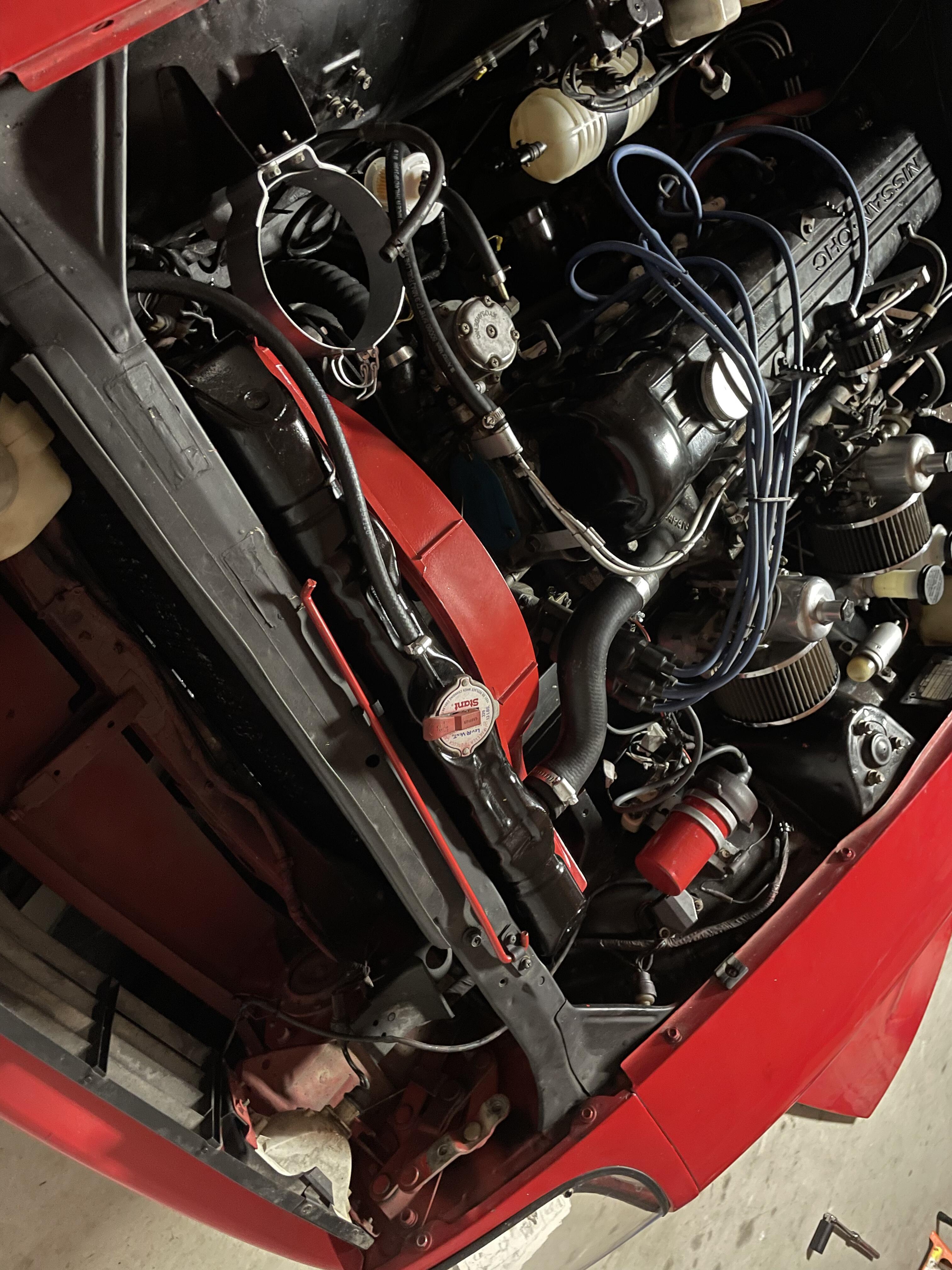

I have a few last minute cleaning items to finish before turning the engine over for the first time.

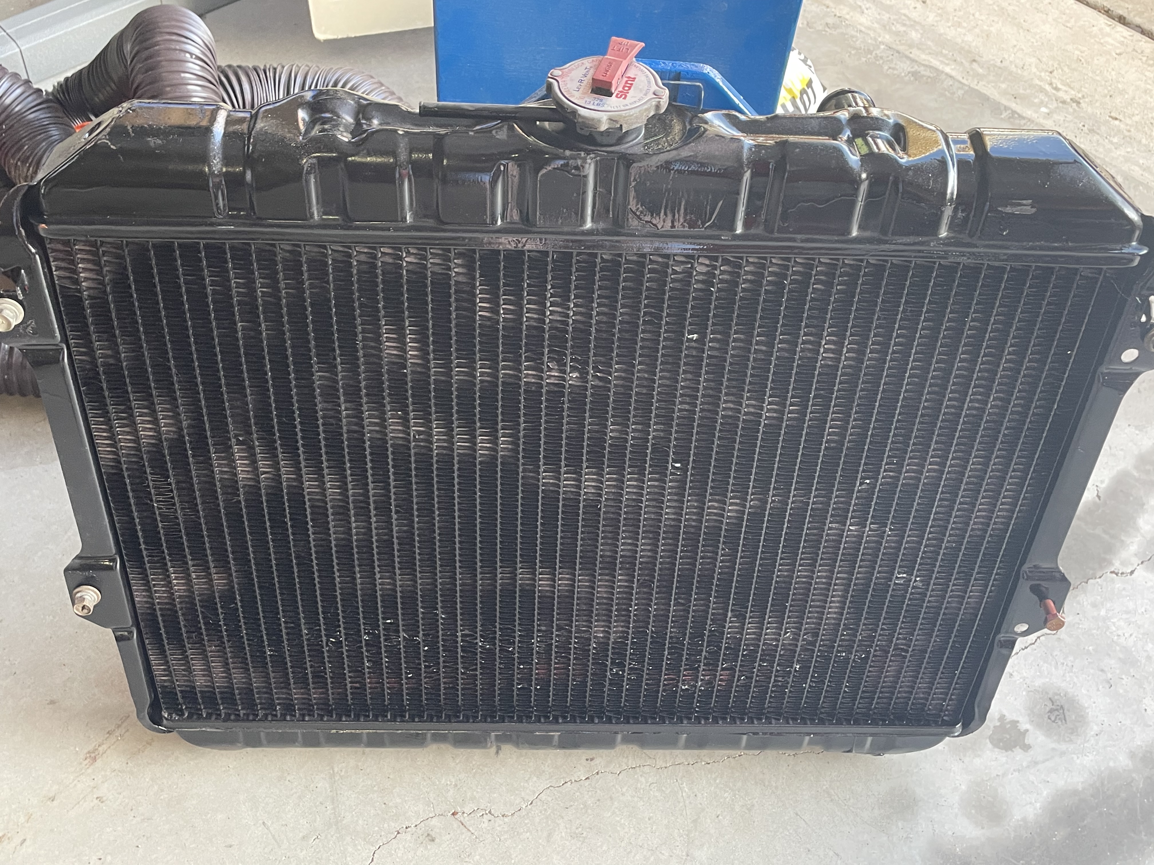

the radiator I purchased leaks. It sucks but atleast Im only out $179.

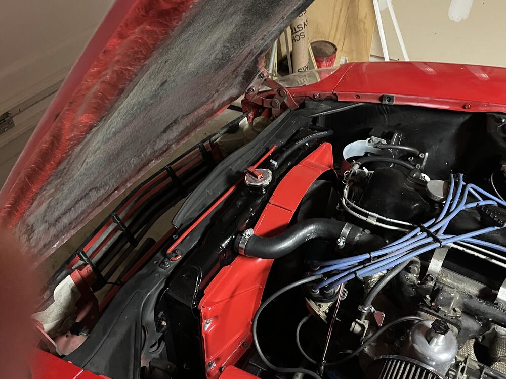

I asked dad what was wrong with the old OEM radiator, he said it’s bad because it’s old. I took it to a radiator shop for an inspection. $80 later it’s been cleaned, inspected, painted, and pressure tested as good to go.
I’ll be putting it in.
